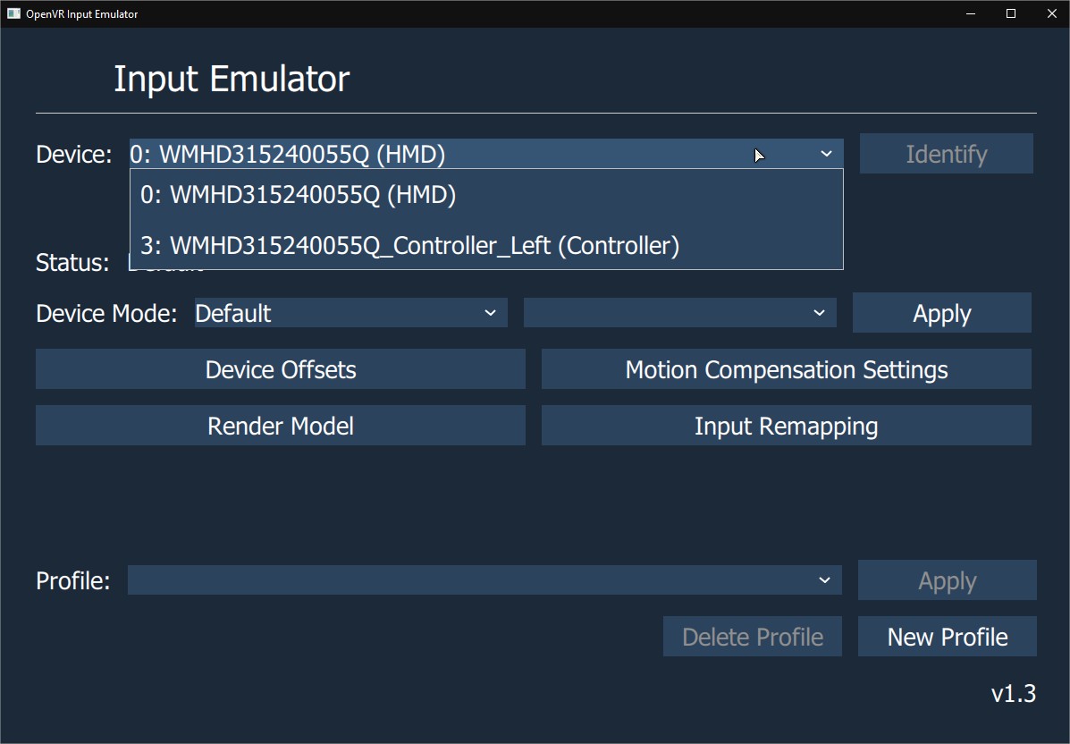

    It is not about VR without sensor but VR with motion cancellation : the idea is to remove the moving sim induced movement from your head.
    In my case, without it, when boosting in Elite, my virtual head go out of my virtual body, which is awkward and produce some motion sickness.
    However, another great dev (matzman666) has given an amazing tool : openVR advanced settings, which can be run with any openVR compatible headset (ie even the rift).
    It provide motion cancellation based on a controller, which you have to tighten to your sim, the nearer possible to your head.
    I had a go tonight, with Elite and Project Cars : life changer.
    Let me know if you need some help configuring it, it would be a pleasure to help.

    As you are on a rift, keep in mind you have to perform actions this way after the openVR advance settings installation :
    1) be sure the oculus service is running (Mine is toggled to off by default).
    2) start steamVR (right click on the steam taskbar icon, SteamVR)
    3) launch the "startdesktopmode.bat" app found in the OVR Advanced setting installation folder.
    4)Select the controller you will use for motion cancellation in the drop down menu :

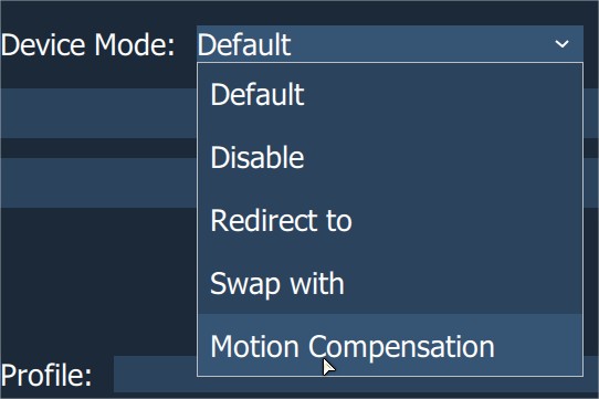

    5) Then, for the device mode, select Motion Compensation

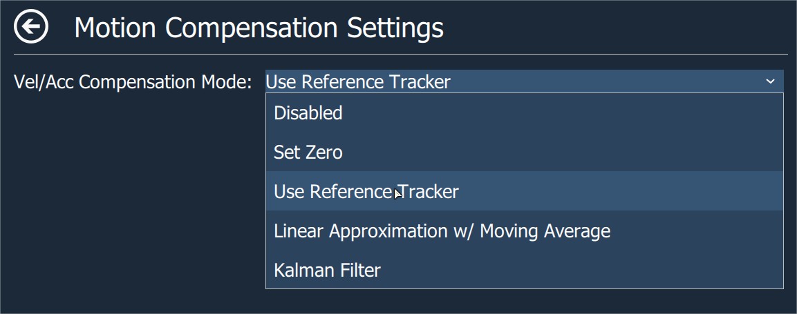

    6) Finally, click on Motion Compensation Settings, and select "Use Reference Tracker".
    Click on the top left circled arrow to come back (do not use escape or any other key, it cancel your choices), and click on the non grey-out Apply button.
    These steps are to be redone eache time you start steamVR.
