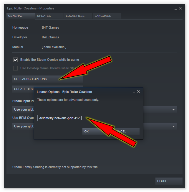

    @DarkHunter82: Here we are. I think the data provided by the game is not very accurate.
    Give the plugin a try and let me know.
    Kind regards

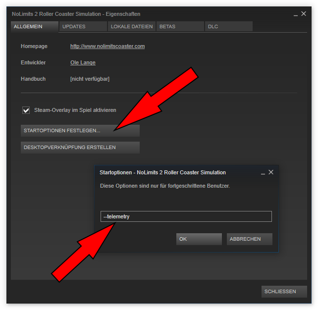

    You must specify a launch option in the game in Steam (similar to NoLimits Rollercoaster 2)
    -telemetry network -port 4123
    -telemetry network -ip 192.0.0.xyz -port 4123
    (in case the program and GameEngine do not run on the same PC).

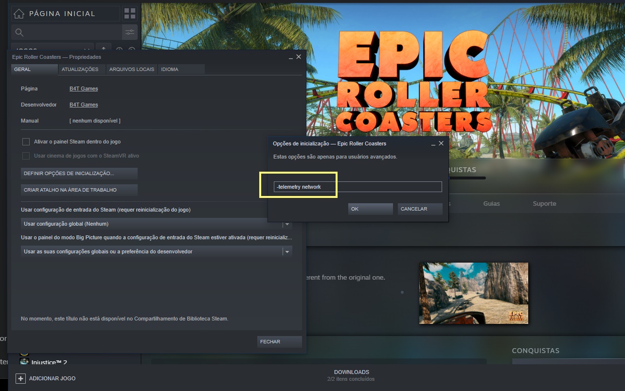

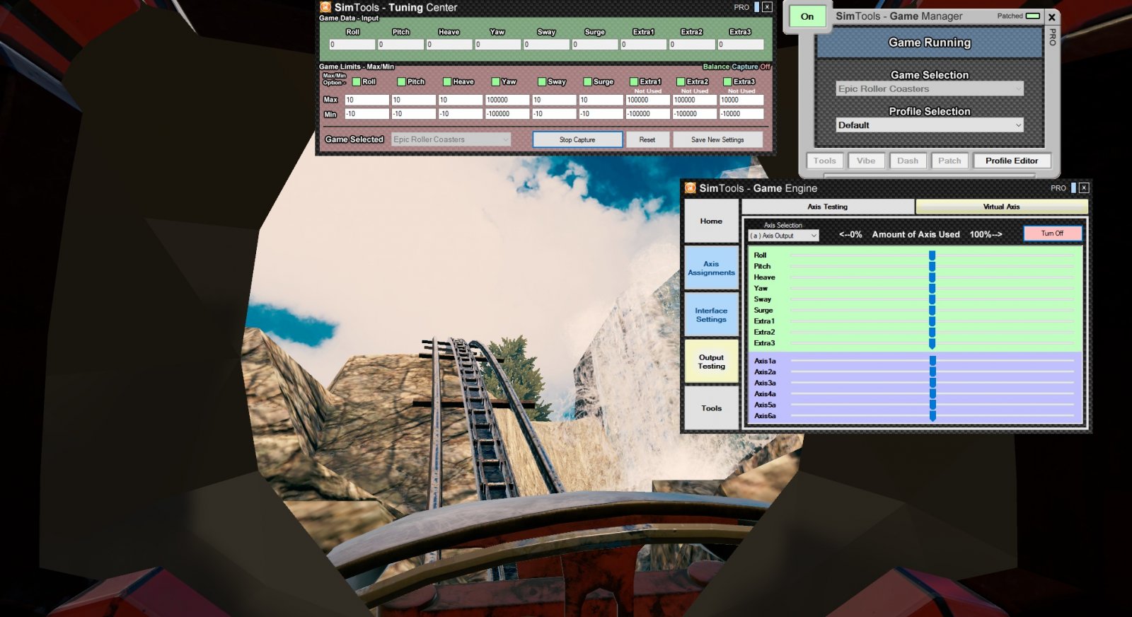

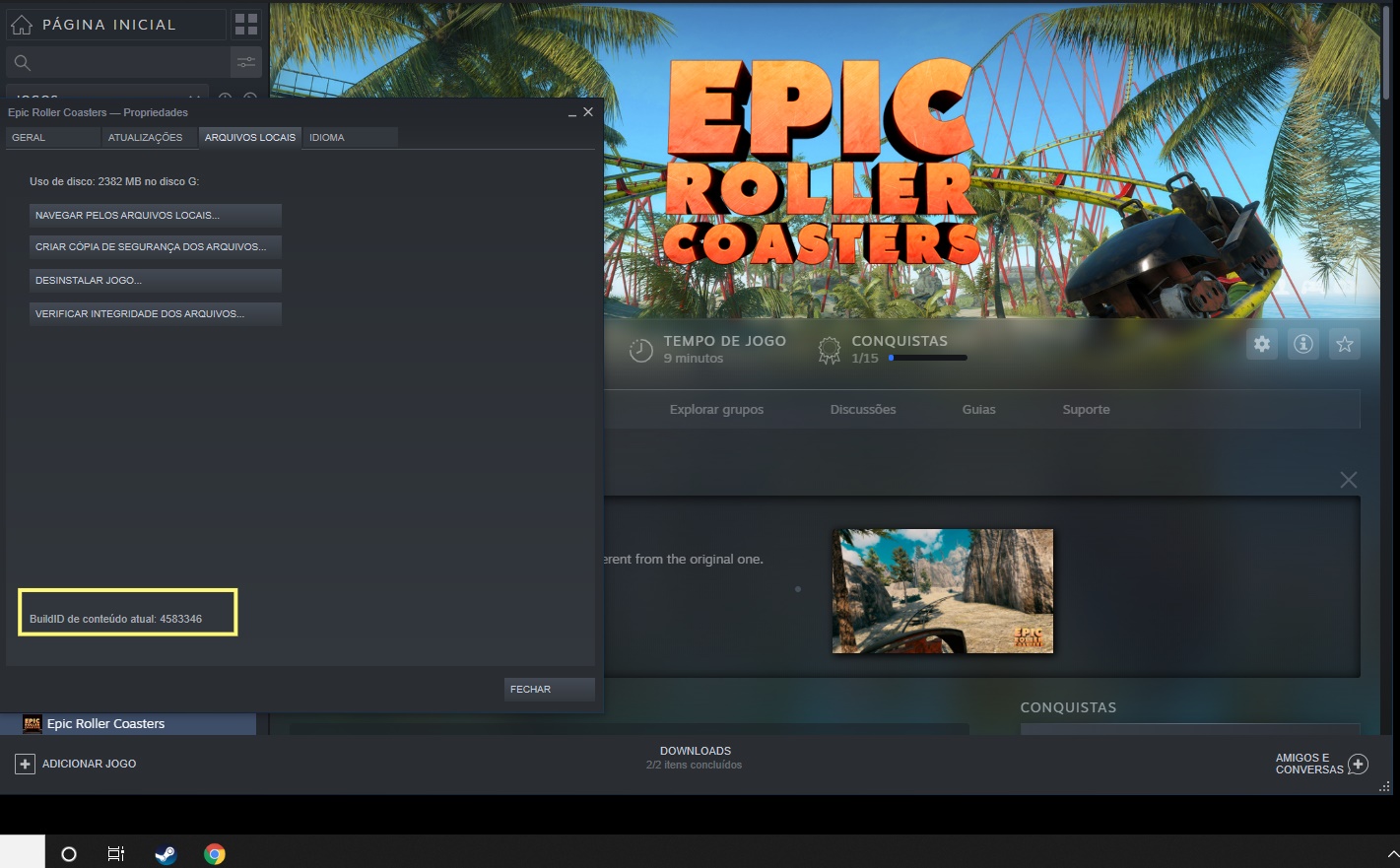

    Hello.
    Which version of the game work on?
    My version: BuildID 4583346
    In the free version and in the paid version. I put values in the tunning center, but no data is received.
    Game Runnung appears, but does not move.
    Do you need to configure any Steam startup options similar to "--telemetry" in NoLimits Rollercoaster 2?
    I await some help.
    Tank You.

    Oops!
    Sorry, I forgot to mention: you must specify a launch option in the game in Steam (similar to NoLimits Rollercoaster 2)

    It's on the same PC.
    I typed this ( -telemetry network ) and still it doesn't receive data.
    It also didn't work with my pc's ip. " -telemetry network -ip 192.168.x.yz "

    Oops, again. I wasn't near my PC when I wrote the post above.
    It's -telemetry network -port 4123.
    That should work :)
  12. Bruno Rocha
    Bruno Rocha New Member
    Feb 6, 2020
    128Coins
    It worked. Thank you
