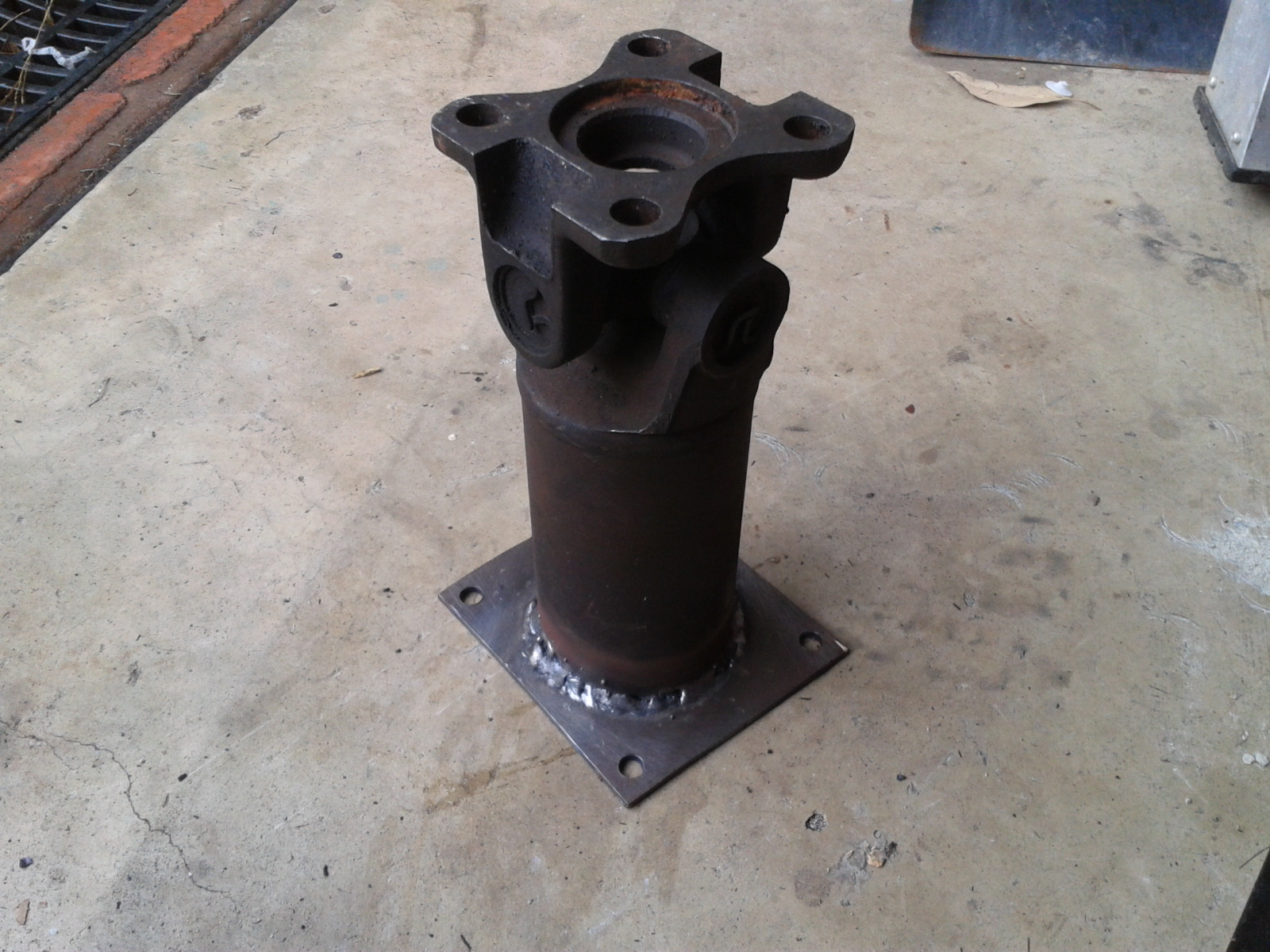

    cut down drive shaft to size from a read wheel driven vehicle is best, mine cost me $20 for a whole shaft, then I cut it to size and weld plates on the ends.

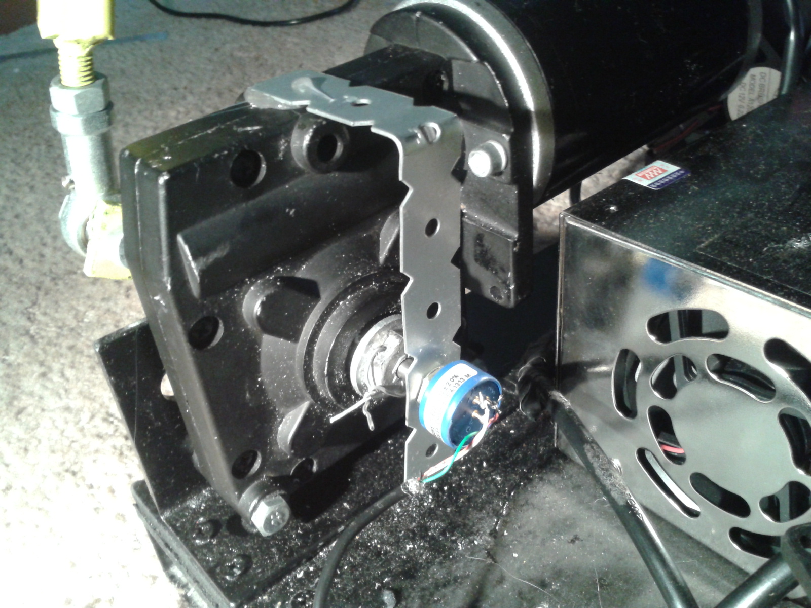

    put him on the back of the motor shaft somehow, here I drilled a hole into the drive bolt, slotted pot shaft in, drilled a hole through bolt and shaft and used a bit of wire to hold it all together.
