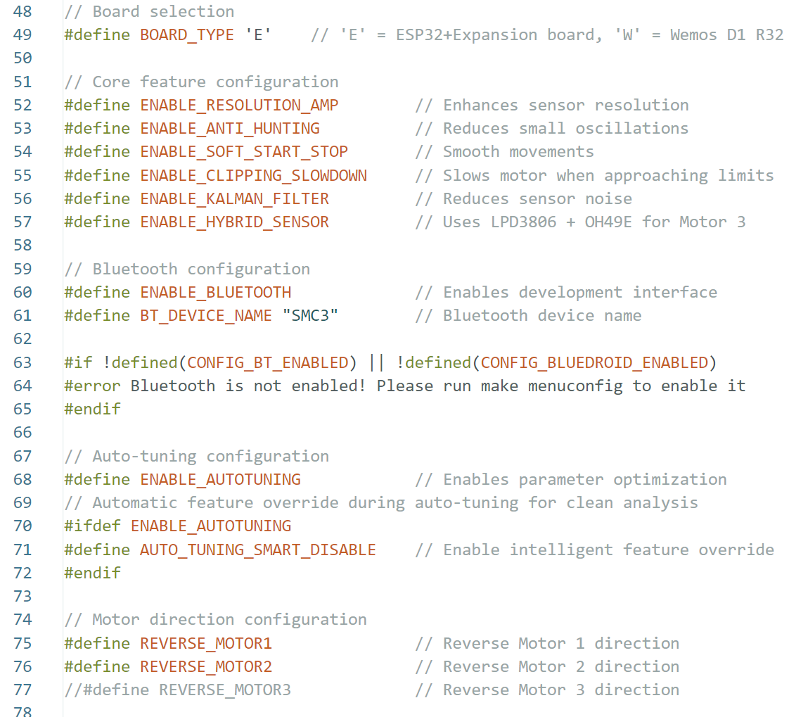

    Hello I'm from Indonesia and i excited to join this community and share my journey with motion simulation. I'm relatively new to sim racing but have been diving deep into the technical side of things.
    About 4 months ago, I purchased a 2DOF platform + Traction Loss system from my friend . I have to be honest - I'm terrible with mechanical stuff! While my friend could fabricate alumunium profile and adjust DC motre with ease, I struggled with even basic mechanical adjustments.
    The platform came with the classic Arduino UNO + SMC3 setup, and initially, everything worked great with SMC3Utils. However, as I started diving deeper into tuning and understanding the system, I began to notice some limitations of the UNO platform:
    This got me thinking: "What if we could run SMC3 on ESP32?" The ESP32 have 240MHz dual-core processor vs UNO's 16MHz, 4MB flash memory vs UNO's 32KB
    I am not good at coding, I can only make the LED turn off or on, LOL. So thanks to Claude AI, I understand a little more about what C++ is.
    But here's where the 3-month journey of frustration began...

    The breakthrough came when I stopped trying to make ESP32 "better" than UNO and focused on making it behaviorally identical. Key realizations:
    1. Preserve UNO's 0-1023 ADC range by mapping ESP32's 12-bit to 10-bit
    2. Maintain exact 250µs loop timing that SMC3 depends on
    3. Emulate UNO timer limitations rather than "improving" them
    4. Focus on behavioral compatibility, not hardware similarity
    The Final Solution
    After 3 months of experimentation, I achieved 100% behavioral compatibility:
    • SMC3Utils works identically to UNO version
    • All existing parameter sets transfer directly
    • Same PID response characteristics
    • Drop-in replacement capability
    I now have a working ESP32 SMC3 firmware that maintains full backward compatibility. And I've only been able to test it on my specific setup (Cytron drivers in the new MODE_CYTRON).
    I need your help, please test this firmware in mode 1 or 2 and please give me feedback. or maybe you want to try to develop this firmware yourself with AI then discuss it here, because it seems like it still needs a lot of features like filters, anti-haunting, soft start, etc. 107402 2.png 3.png

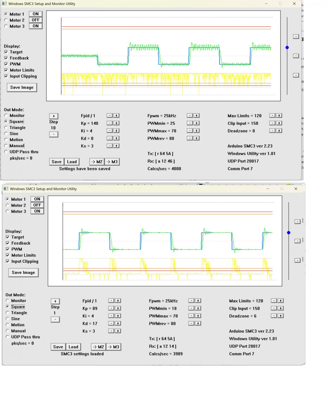

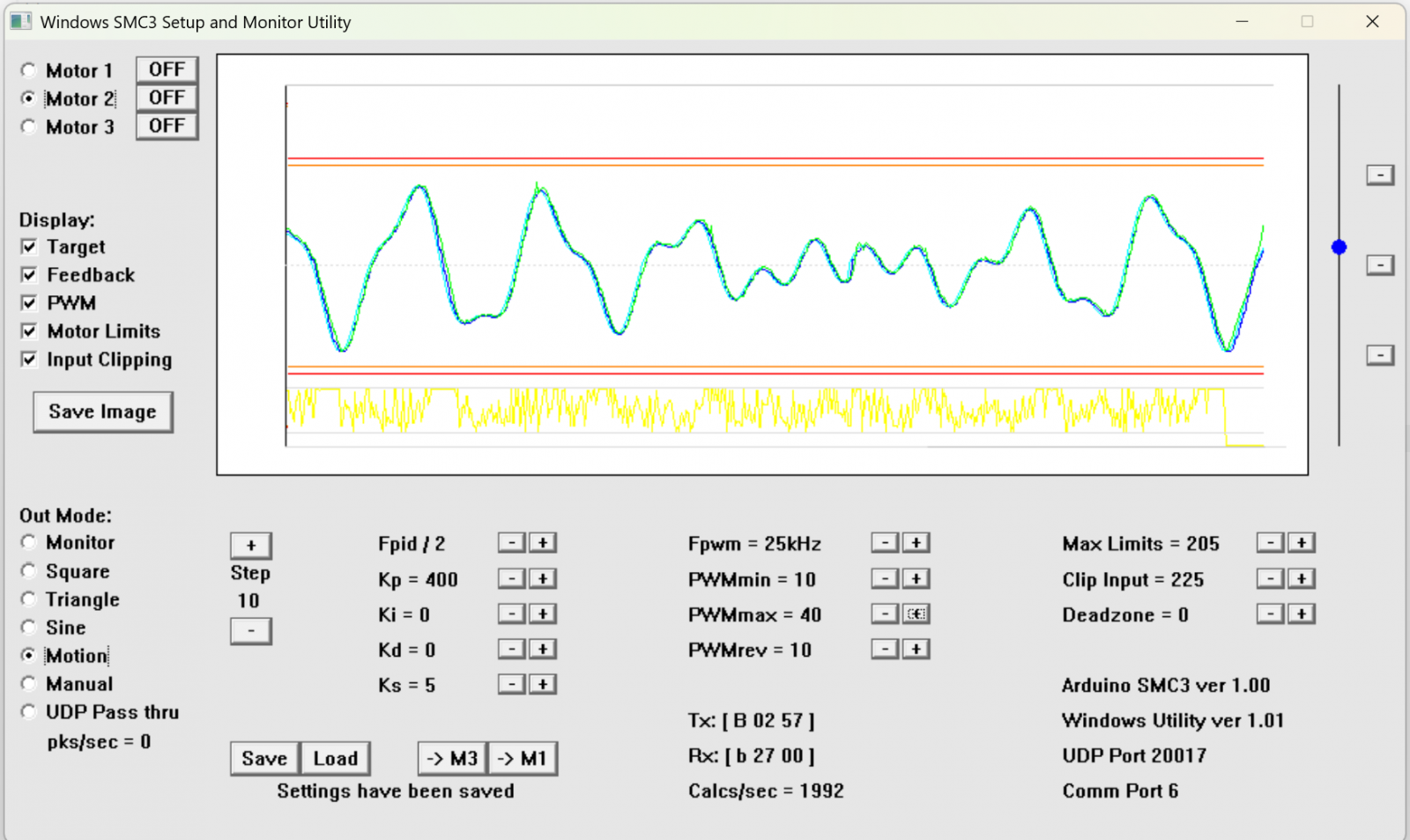

    With a lot of resources from ESP32 I'm developing the auto tune feature to setup all parameters in smc3, so we don't have to bother to set it, whatever your platform configuration should be able to set it automatically, but this is not perfect wait for it to be really stable then I will share it here
  8. azizalfirdaus
    azizalfirdaus New Member
    Mar 29, 2025
    7
    - 3Coins
    Look at the end of the video when I close and reopen smc3utils, all parameters have changed

    . Looks promising. Is there a mathematical basis for this or does it basically search for the parameters like an optometrist looking for the best prescription ?
    Maybe stick on GitHub to share it.

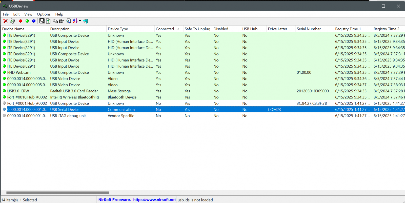

    I've downloaded your sketch to an Arduino Nano. Using a DR P3 rig with IBT-2 boards. So mode 2. I need to wire it into the control box. May be able to do it today. I'll let you know how it works. HAve you tried using Klaus Schmidinger's version 2.1 with parking and soft stop as the base for you sketch?
    EDIT: SMC3 is not seeing the Nano. I used USBDeview to verify the board is recognized. When I plug it in, USBDview shows that it's connected for a moment, then it disconnects. Thoughts?

    The Arduino Nano ESP32 and the classic Arduino Nano are distinct boards with different capabilities. The Nano ESP32 combines the familiar Nano form factor with the powerful ESP32-S3 chip, offering Wi-Fi and Bluetooth capabilities, more processing power, and memory compared to the classic Nano. However, the classic Nano, based on the ATmega328P, remains a simpler, more power-efficient option for basic projects and educational purposes.
  12. Deleted member 51784
    Oops. Guess I should have specified that I bought the Nano ESP32.

    I don't have a github account, I just try to explore Claude AI, so I determine the work logic flow and Claude AI is the one who completely writes this code, then I correct it
    This is my auto tuning algorithm, so basically it analyzes the relationship between the feedback targets by defining parameter limits such as response time, overshoot, Oscillation Count, PWM Utilization Analysis.
    This is Decision Logic Flow
    Step Response Test => Calculate Metrics (Response Time, Overshoot, Oscillations, Precision) => Performance Scoring (Speed, Smoothness, Stability, Precision) => Strategy Selection (Conservative vs Aggressive) => Parameter Adjustment (Within Adaptive Bounds) => Validation & Relationship Check => Apply to Motor & Send to SMC3Utils
    Strategy Selection (Conservative vs Aggressive) has not been implemented well in this code.
