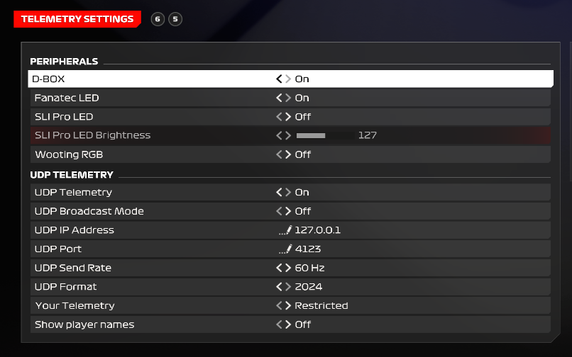

    I was surprised and happy to see the F1 24 plugin available yesterday. I had a few problems but it is working now.
    When I installed it I got “not a valid directory” warning. I decided to try F1 22 and it worked. When I went back to home F1 24 was in the menu where I had expected F1 22 to show up. I clicked run on the F1 24 icon and it started F1 24.
    Once started the feedback was not hooked up. Fortunately there is a nice telemetry menu under the game settings. As you might expect from failed install telemetry was turned off. I referred to the F1 22 settings (this has been working for the last year) and made the same settings in F1 24. This worked and when I change the format from 2022 to 2024 it still worked.
    The physics are better most noticeably there is a much better throttle profile. I turned down the feedback setting down from 45 to 40 on my DD1. Beyond that it’s somewhat subjective. I run with all assists off. Haven’t made a judgement on the motion yet but it didn’t just piss me off like F1 22 did.
    So the final telemetry settings are as follows :

    I had the same problem. Here is the fix: click the auto detect in the settings page. The from the tool bar click and hit exit from the menu in the toolbar. This will cause SimTools to go through the normal exit and save that setting. Then it works in all the games. But then MSFS is the only one that complains about the license.
    I plan to officially post settings since there aren’t any here. I would suggest to stick with roll, pitch and heave without surge or sway. Also get familiar with the smoothing filter.
