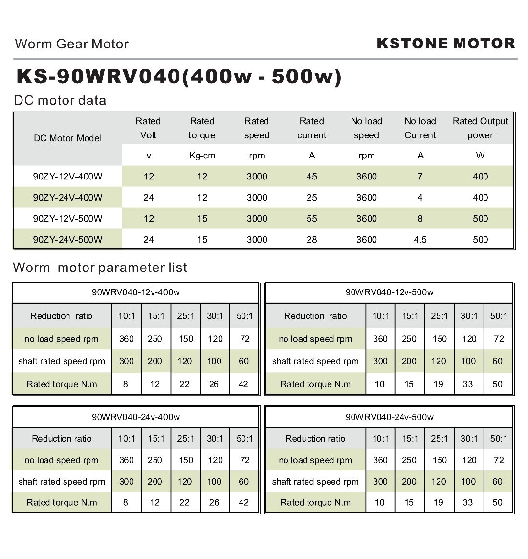

    I think the torque you calculated is too optimistic. The 500 W in the product description are rated electrical power, which is higher than the mechanical power at the output of the gearbox. Those worm drive gearboxes are quite inefficient.
    You provided a link to the motor you think about buying. If you scroll down on that page you can see a spec sheet saying the rated torque at the gearbox output is 56 Nm (for the 500W 24V 50:1 variant).
    It seems like you are using the same motors like me. I am very satisfied with the power my rig has, even though I currently only use about 330 W per motor due to issues with regenerative current.

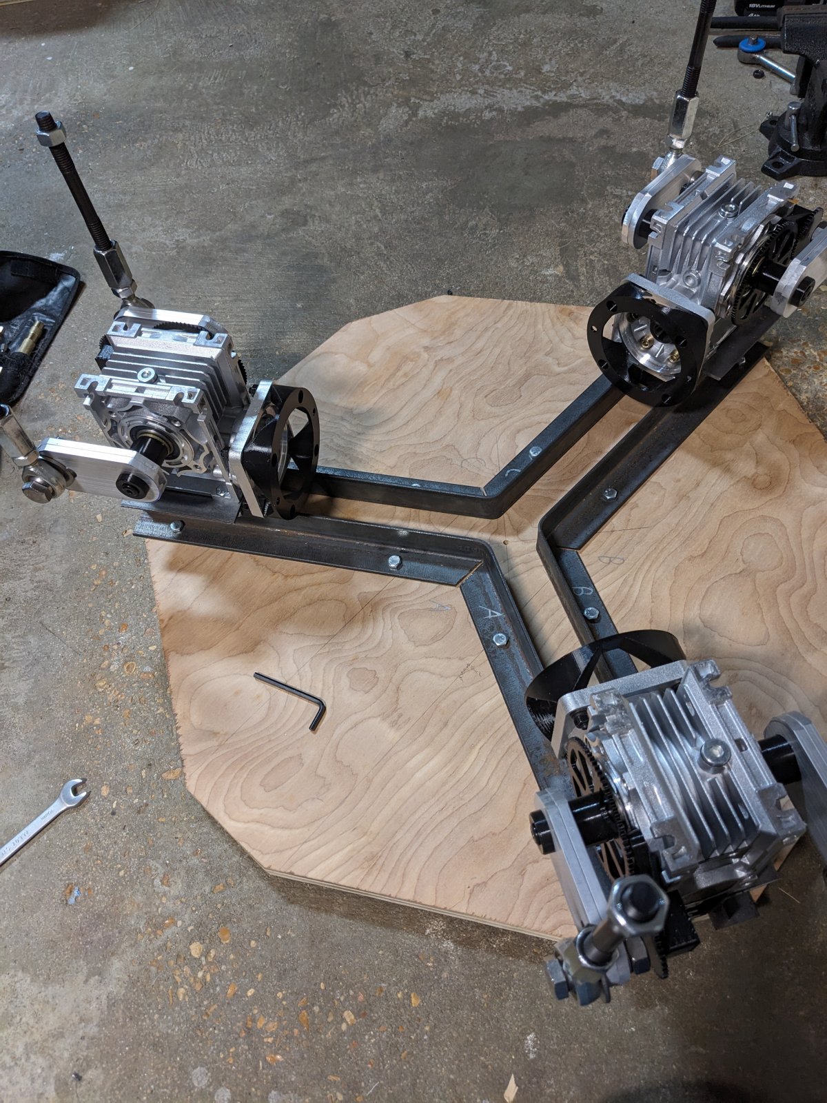

    Yes, the plan so far is to build a plate underneath it with the motors attached and metal rods between the motors and the rig.

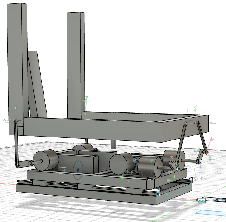

    Are you able to design your rig in CAD? It really helps to determine where you need to place the motors and whar CTC you need to achieve a certain angular travel. Virtual trial and error tends to be a lot quicker than real-world tests.

    As you are considering the same type of motor as I bought, let me give you a piece of information I wish I had before I ordered: make sure your gearbox is of the NMRV-Type, like early_m did. This is a standardized type where you can get repleacements relativley easy. The gearbox I ordered (and you are considering) is of a non-standard-type which is hard to find a replacement part for. Why would I need a replacement? Because I'm not satifsfied by the ammount of backlash my gearboxes developed after some hours of use. It's not really bad, it's just not as good as i want it to be. But I'm stuck with a non-standard gearbox, a motor with non-standard gearbox mounting holes and a non-standard motor-shaft. There's no way to put a lower backlash gearbox on my motors.
    NMRV-Gearboxes have a little more friction (thus slighlty lower output torque - 50 instead of 56 Nm for the 50:1 ratio, see attached picture) but they are supposed to have a lot less backlash. All while costing the same.
    You can open the alibaba link you posted above, get in contact with the company sales representative and ask for a low backlash NMRV-variant of the motor you are currently looking at. The representative I've talked to was really helpful.

    Well basicly I guess I could CAD give a try, I have very basic skills in it.

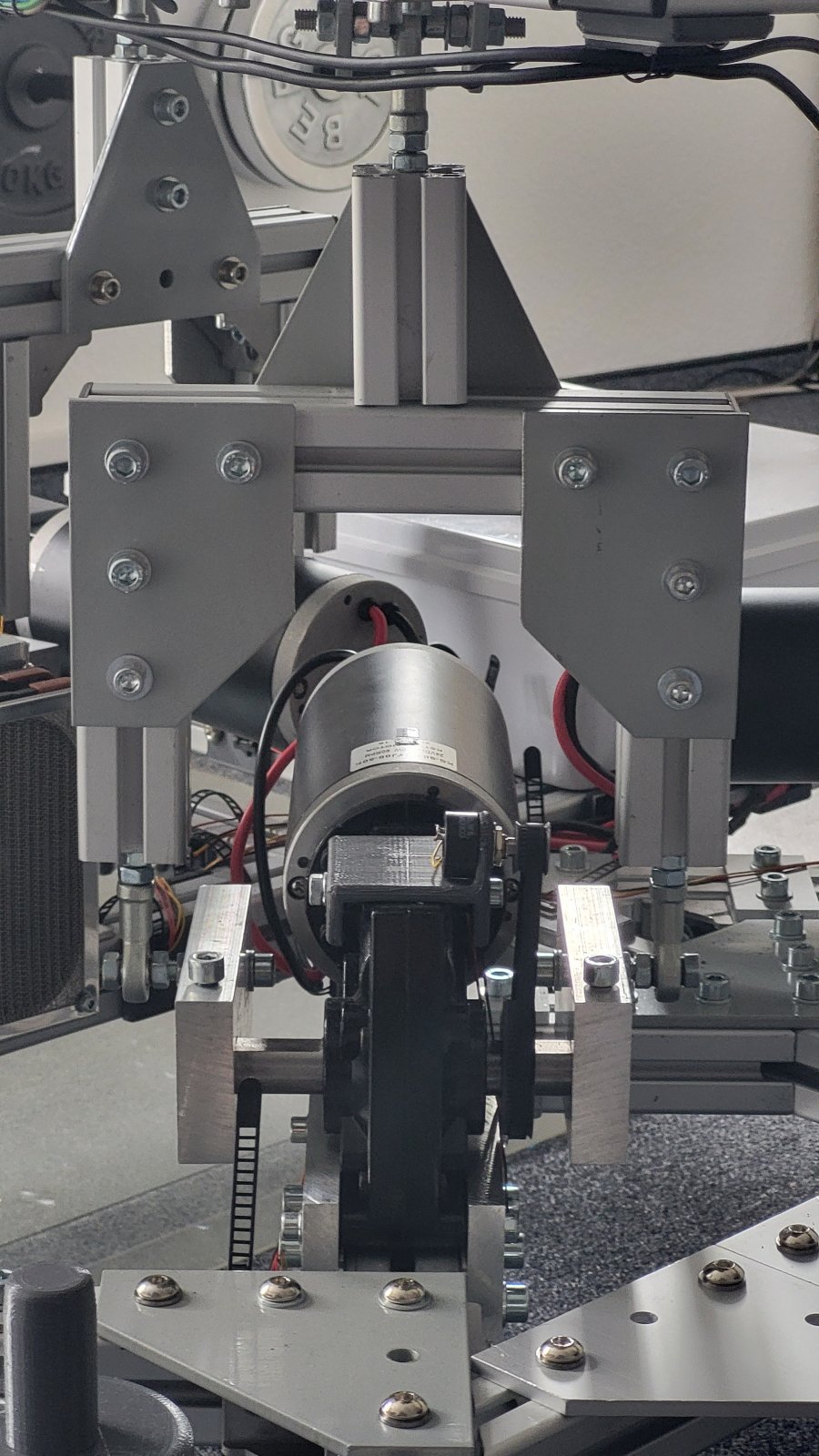

    I've seen another base plate approach at the same post of @early_m of @Michail with his CAD draft. I would go for the way you described with the triangular fitting of the motors.
    I'm just asking myself which program to use that is suitable for beginners also. And how would I derive from a CAD model which CTC I would need to use, therefore I would need to simulate the movement, right?
    I have contacted @early_m but as he is currently selling his solution professionally, he already stated that he has no time in helping people from the community with their individual needs, which is quite understandable.
    Exactly, his rig is very low profile and of course I noticed that his profiles are slimmer and therefore lightweight. And you are right, buying SimXPro might not have been a smart idea. But now I would like to make the best out of it.

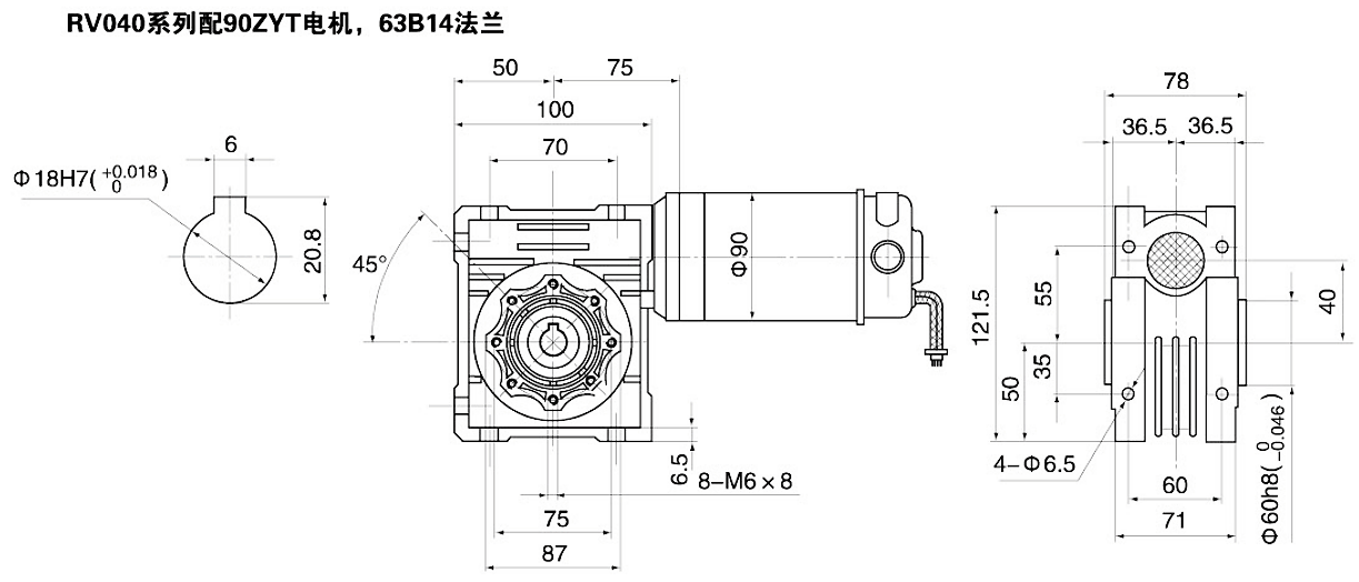

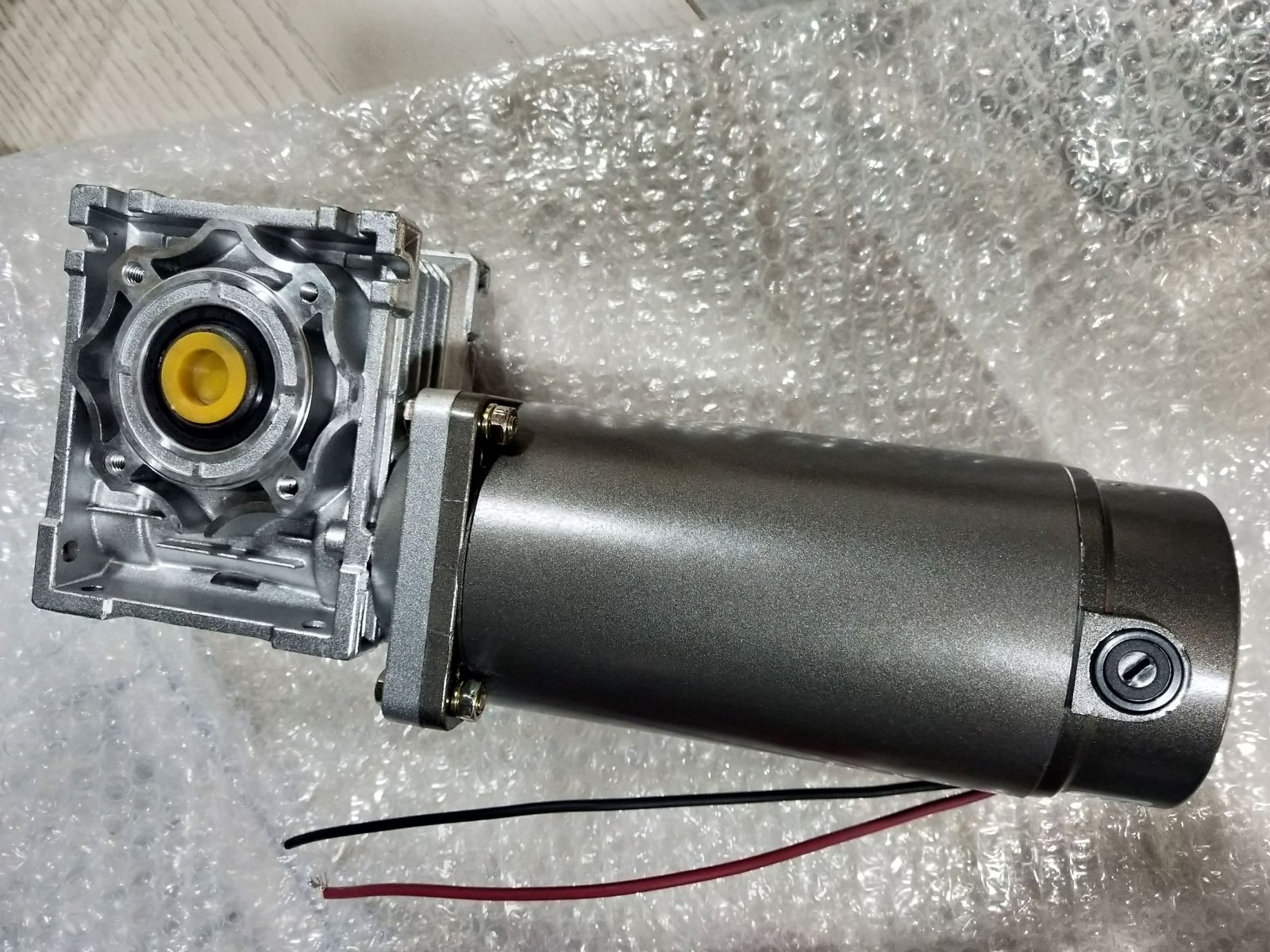

    I have an offer for the following motors:
    NMRV24V-90ZYT 500W-input speed 3000rpm, output speed 50rp/min, 1:60
    Guess that sounds quite good, no?

    About CAD software:
    Simulating motion is not necessarily a requirement. This would imply that moment of inertia as well as oscillations etc. are simulated. This would go way beyond the usual scope of a DIY motion simulator.
    I think most, if not all, CAD software today works with something called relations. Example: the motor with its cylindrical output shaft can be one part, and the motor lever with its cylindrical hole can be another part. Both can be joined by using 3 relations.
    First, the motor-saft and the hole in the lever shall be concentric.
    Second, the end of the shaft and the outer side of the lever shall be in the same plane (so the lever can not move in the axial direction.
    Third, the angle between the motor lever's centerline and the motor shall be a number determined by the user. Then you can type in different numbers for the motor lever angle and the CAD software will move the lever accordingly. If you also connect the top platform with similar relations, it will also move when you change the values for the motor angles.
    So it's all based on geometry alone. There is no actual force, torque, velocities, mass or moment of inertia. But it let's you see how much roll and pitch angle a combination of motor position, shaft angle and CTC will give you. You can also check if there are collisions between parts.
    During my study years, I came into contact with different CAD software, namely SolidWorks, Pro/Engineer (renamed to Creo nowadays) and CATIA. To me, Solidworks was, by far, the one with the most modern, intuitive and user friendly interface. That's what I use for my hobby projects today (you might want to get creative acquiring a license though, or get ready to spend a lot of cash). For my work, I sometimes have to do basic stuff in Creo and I am in awe how the interface designers managed to make it so convoluted.
    There might be other, even free CAD software that is better suited for your needs, though. Never looked into that topic.
    Learning CAD for building a motion sim might be overkill. But I guess if someone decided to DIY a sim, he has a history of DIY projects and will take on new projects in the future. CAD might be a nice tool for those, too. Also: having basic CAD skills "unlocks the 3D printing skill tree" which can turn out to be very, very valuable for a lot of projects - including the motion sim (think mounts for electronics and accessories).

    In was suggesting to use a higher powered motor assuming you would keep the ratio and speed constant. So higher power means higher torque. And you will need that to achieve as similar performance as early_m, because your top platform is heavier.
    The specs of the motors you've come up with are looking good. Is there also a 1:50 ratio option? It probably won't make much of a difference, but early_m also used 1:50 if I remember correctly. If your ratio goes too high, you will have more torque than you need while not being as fast as you want to be. It's just very hard to tell beforehand where the threshold is. In theory, you can compensate a high ratio thats too high by using longer motor levers. Longer leavers also mean more maximum heave travel, but some say backlash might get worse.
    You see, everything is connected to everything, there is no objectivley optimal solution. If you optimize too much for one thing, another thing will get worse. It might be a good idea to stay close to what's proven to work unless you have additional time, money and nerve to spend on experimenting. That's why I suggest keeping a similar ratio (and thus speed) as early_m, and only compensate your higher mass with more power (and thus torque)

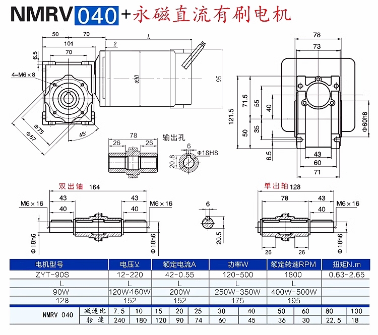

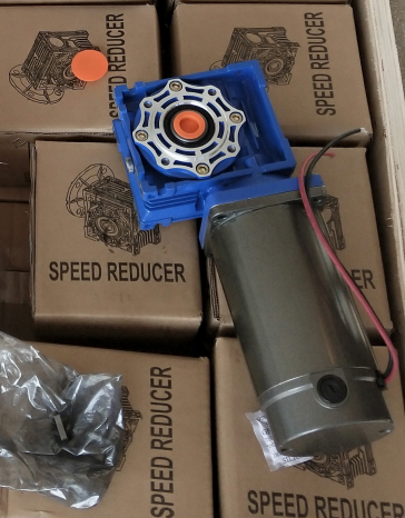

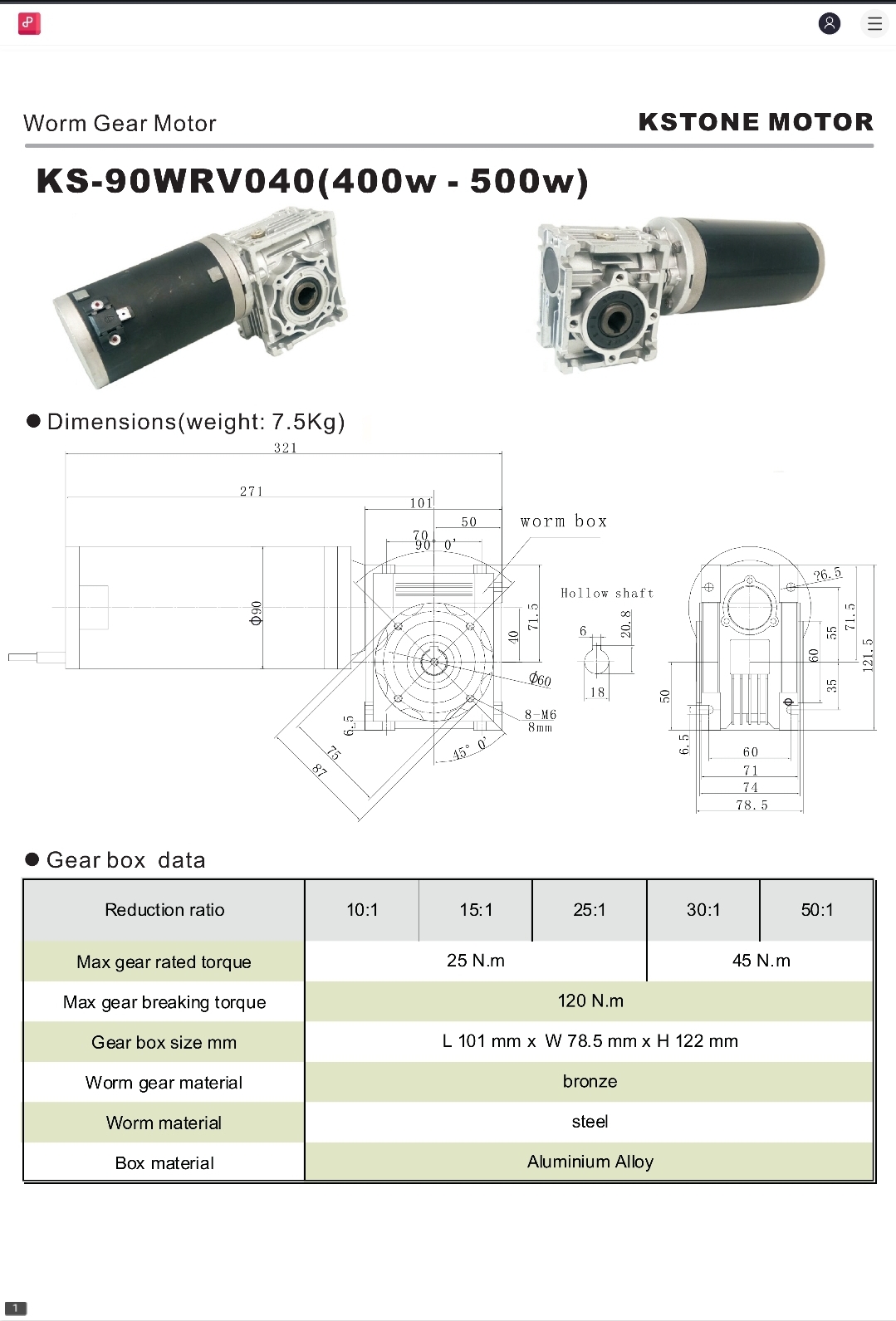

    Regarding the motor: Yes there is a 1:50 version available but @early_m has 1:60 motors.

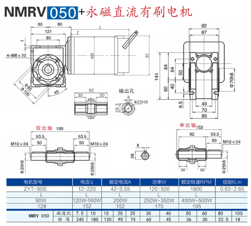

    The sales representative first offered me a NMRV40 motor (the one I've mentioned above) with a torque (500W) of 2.65N.m, the output torque is related to the speed ratio, and the final output torque is about 150N.m
    He then offered a NMRV50 motor (500W as well) saying that it would be much more stable at its rotation as the NMRV40 has a smaller gearbox and a shorter service life. Both versions can reach 150N.m. but NMRV50 gearbox carries 150N.m more smoothly.
    The specs of NMRV50 is attached.
    Is there anything I could do, to further make sure if the motors are a good fit for my project, before I order?

    Ok, if early_m has 1:60, I would recommend you follow that lead. Your rigs are quite similar after all.
    I agree, you should use the NMRV50 gearbox. Bigger gearbox means lower specific load on the teeth, so lower wear and lower backlash after long term use.
    Do the motors come with a shaft or do you need to acquire them separately?
    If they come with a shaft you should make sure they are long enough for your purpose (usually this can be customized without additional cost). Also, think about how you will fix the motor levers to the shaft, as this affects if you need cylindrical shafts or a D-Cut.
    BTW, the 150 Nm are most likely stall torque, so they are more of a marketing figure. After all, they are 3 times as high as the 56 Nm rated torque of the motor you looked at before.

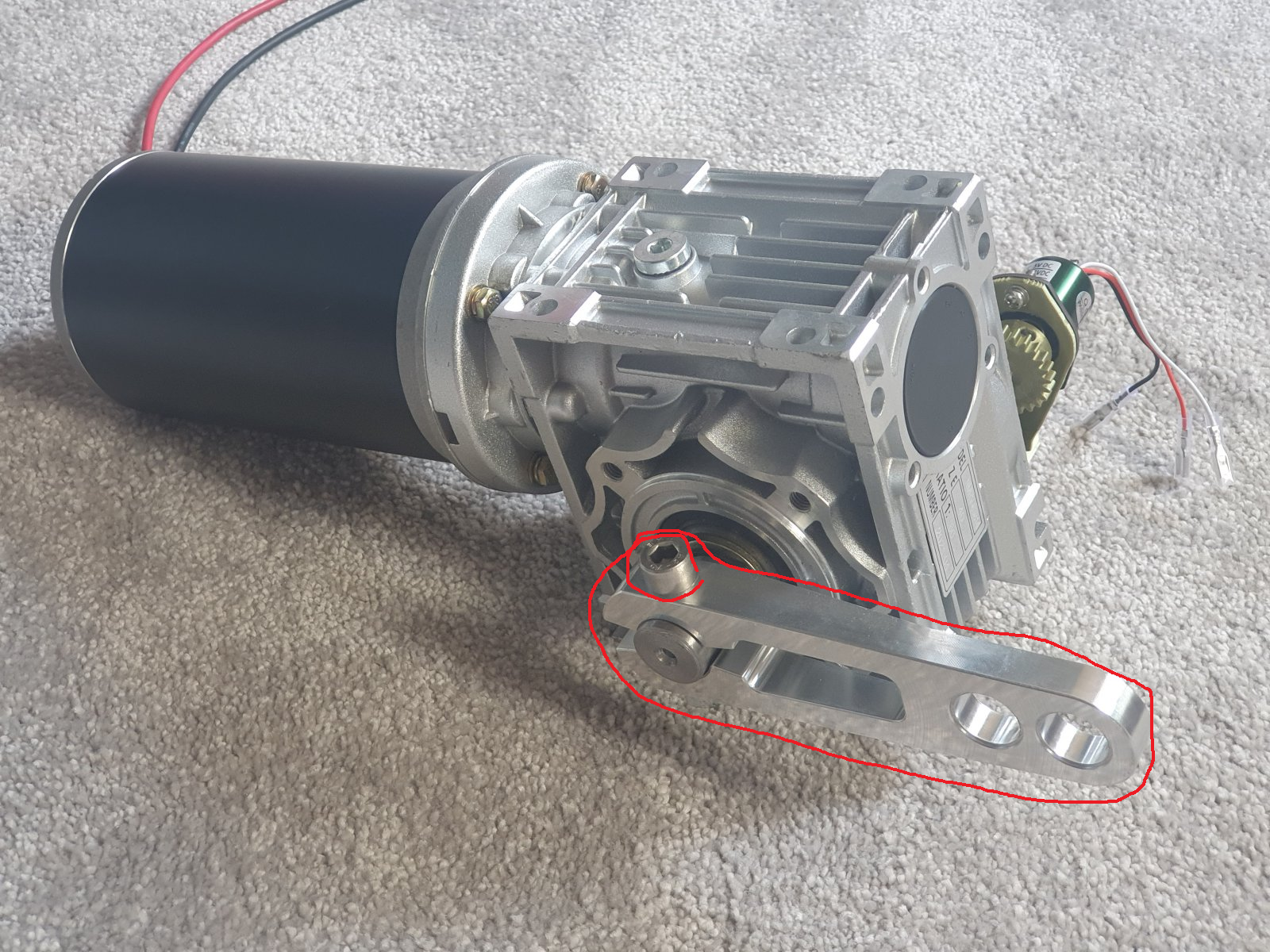

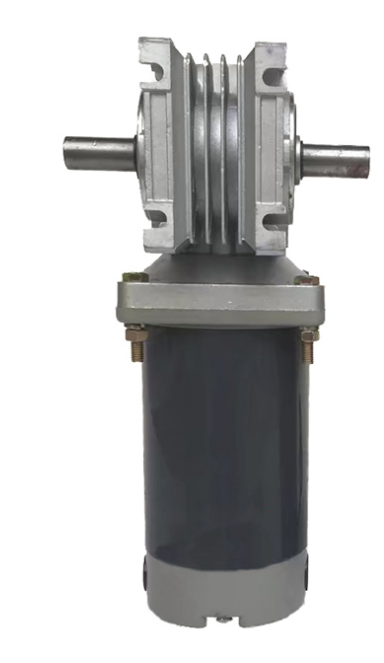

    The motors come with a double shaft. The technical drawing says it has a M10x24 screw hole on the outer end. For the length it says 50 each, I guess thats 5cm for each shaft.
    Do you have a source for good levers?
    I love the ones of simukit, but as I said they are not available.
    The ones that I found are using teeth to grab the shaft, but I don't think that this fitting is strong enough?!
    https://amzn.eu/d/09q2Rvls
    https://amzn.eu/d/03sJDnu9
    At @early_m solution it seems that the screw goes through a screw hole right through the shaft, right?

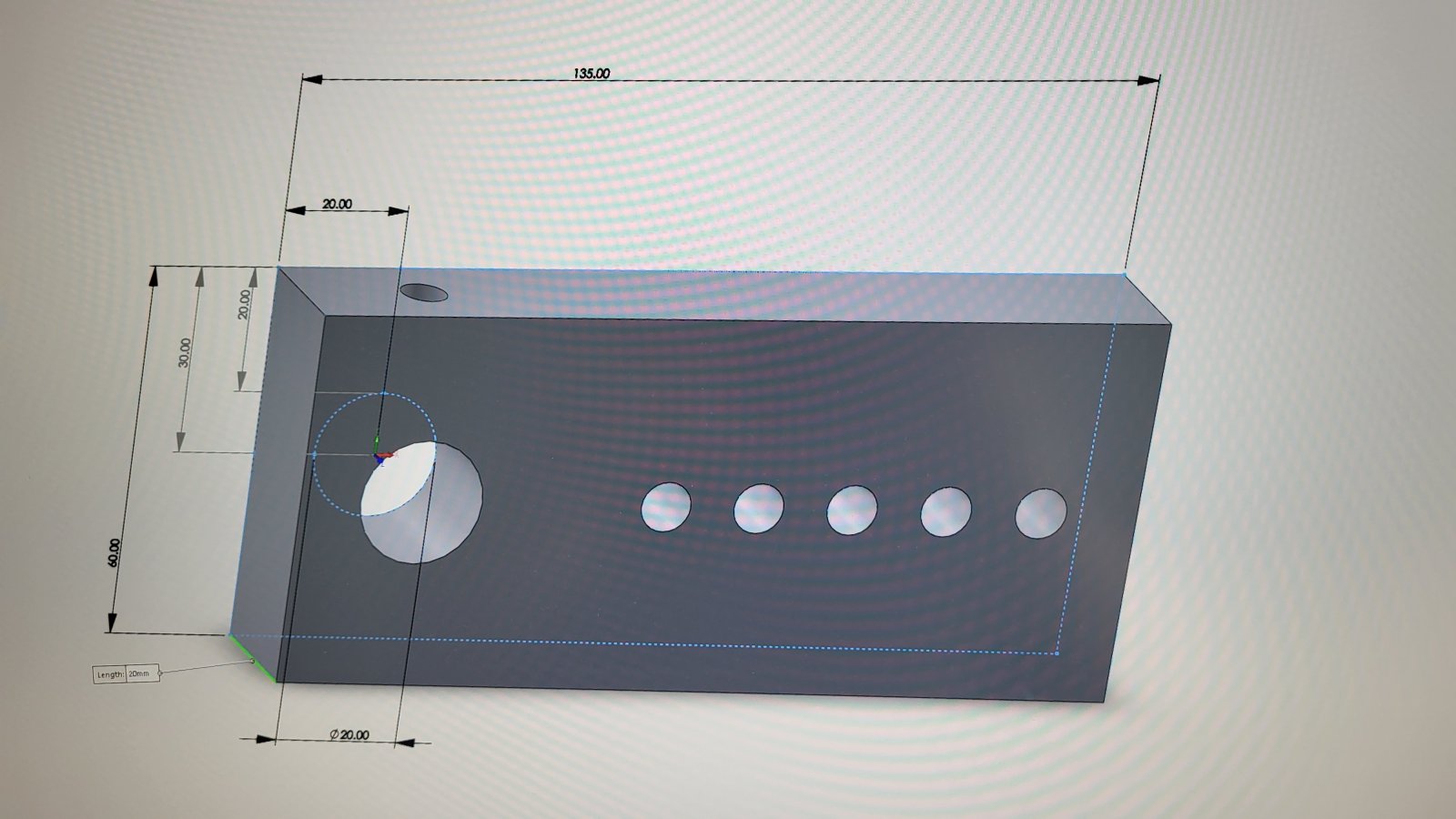

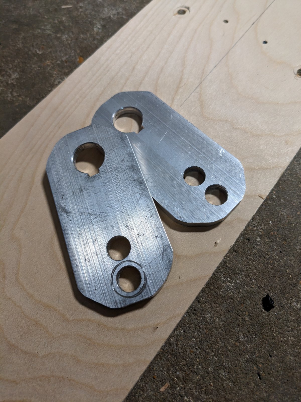

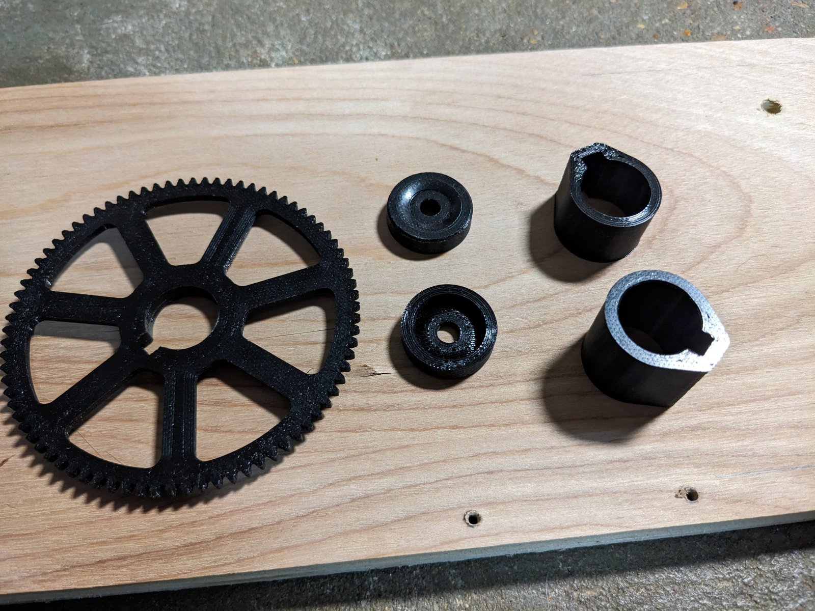

    About motor levers:
    The shafts you've linked on Amazon are about 30 mm long, so CTC will be less that that. I think you might have overlooked that, as I can not see how one could achieve any substantial angular travel with a CTC so low.
    Sourcing suitable motor levers is not easy. From what I've read on this forum, lots of people have them custom made. They either have access to a CNC mill (or know somebody who does) or get them manufactured in China (via Alibaba I guess).
    I've built my levers myself, based on some aluminium blocks that I ordered from Ebay. For tools, I only used a common drilling machine, drill stand, drills and a tap. I guess that's quite commonly found hardware found even in basic workshops. Alternatively, all of it can be bought by like €/$ 100...150 in good used condition.
    I described the process to make the levers on the first page of my build thread. Just look for "drill" and you'll find it. I'm too stupid to provide a dircet link.
    I recommend not using the measurements I presented in the mentioned post in my build thread, though. The lenght of the tap was too short and couldn't stand the torque I needed to apply on the screw. For my second, working, iteration, I used the measurements found the picture I attached to this post.
    The motor lever concept I used works best (requires?) a motor shaft with D-cut.
    I am under the impression that levers with clamping concept and cylindrical shafts are more common on this forum. early_m also went that route. One could also make them in a basic workshops out of a simple aluminium blocks. You would need an electric hand saw and blades suitable for cutting aluminum.
    About motor shafts:
    I agree, it looks like early_m has a hole in the motor shaft in a radial direction. I think that is a good solution. Question is if you can get your hands on such a shaft. Drilling it yourself with basic tools like I mentioned above might turn out to be a challenge. Turing lots of aluminium into chips is easy, doing the same with steel can turn difficult fast.
    You should be sure about the lenght of the shaft that comes with the motor. Ask for a drawing if in doubt. They should have no trouble providing one.
    Also, be sure the shaft is as long as you need it to be. On my rig, the minimum shaft length was dictated by the connector thingy (the one that connects the motor arms with the top platform). More precisely, it was dictated by the corner brackets I used. I needed a shaft that's quite long in order to not have the bracket collide with the motor, when the motor lever moves down. Check the attached picture.
    Its really easy to check for such collisions if you have a movable CAD representation of the seat you want to build.

    Sourcing or fabricating the lever arms can be tricky. On my first seat I was going to make them just like the ones shown in the previous post out of 12mm thick aluminum. I had planned for the screw to set down in the keyway slot on the gearbox shaft. Somewhere I changed my mind and instead bought some 300x50x6mm pieces of aluminum off of Amazon and fabricated some that didn't use a set screw. I used a few basic shop tools, drill press, band saw, hand files, and a belt sander. You could use simpler tools, but it would be much harder to keep things aligned.
    The first set I made still had some alignment issues, so I had to make a second set. I used them in pairs on each side of the gearbox.
    I used some hand files to make the key slot, which was a lot of effort. Getting that keyway straight from one lever to the next was the really hard part. I 3d printed a sleeve and a cap to go on the shafts to hold the levers in the correct place.
    Overall, I would say the ones shown in the previous post would work great and be far easier to make if your gearbox shaft has a flat or a keyway in it.
  15. _cOdaC_
    _cOdaC_ New Member
    Dec 20, 2023
    29
    161Coins
    I‘m impressed that a 3D print could hold the lever… Did you use 100% infill PLA?
    The work you have done is tremendous.. wow.
    I found the following link that was quite useful in addition to your infos.
    Having a look at the technical drawing, I could use the solution of @noorbeast or @Nick Moxley.
    Both would require some welding.
    The Shaft has a M10x24 screw hole at the end of the shaft and a key slot.
  16. Gefahren
    Gefahren Member
    Mar 9, 2024
    55
    Electronics Engineer
    Central Mississippi, USA
    395Coins
    +66 / 0 / -0
    The 3d print is just a spacer sleeve that fits on the shaft and then an end cap to keep the levers from moving in or out on the shaft. They really don't have any load on them, the torque is transferred thru the key on the shaft.
    Here's a picture of the pieces after I removed them from one of the Gearboxes.
    Hope that makes it clearer what I was talking about. I don't think you could 3d print anything reasonable to take the torque that is on the lever arms or shaft.

    Long time no update, so finally I have some good and some bad news.
    Good news first:
    I've ordered 3 x NMVR50 Motors with 3000rpm, 500W, 1:60, 24V and double shaft each at Alibaba and the merchant :Xuzhou Yinxin Electromechanical Equipment Supply Station
    Costs:
    NMRV50-60:1 90ZYT-24V-500W-3000rpm 3 x 125USD = 375USD
    Double Shafts customized 3 x 9USD = 27 USD
    Couplers (fo attaching the lever) customized 6 x 9USD = 54 USD
    Good thing is they arrived safe and sound.
    First bad thing: They only accept UPS Express Saver which is extremely expensive with 270USD (keep in mind that the weight was ~30kg); delivery was within 3 days.
    Now, one even worse thing happened.
    I've wired up the first motor following this tutorial only thing I didn't do is attaching capacitors to the sabertooth 2x32.
    I've followed each step from setting up the baud rate for the sabertooth to 115200 up to step 17 with increasing PWMmax. With every 1-step increasing PWMmax I could hear a silent "click" sound. At around 18 the motor started so rotate very slowly. When I clicked on 19 the motor stopped suddenly. Since then I can not achieve any more to get the motor running. Increasing PWMmax has no effect, I hear no clicking sound. Restarting the Arduino didn't help, restarting SMC didn't help, swithing the motor off and back on didn't help.
    The PU Input measures 24V on the sabertooth, the Arduino measures 3,3V at the sabertooth but no matter how high I go with PWMmax (max was 50) the connection to the motors remain at 0V.
    Any suggestion how I can get the motor back running? Any tests I can execute to find the root cause?
