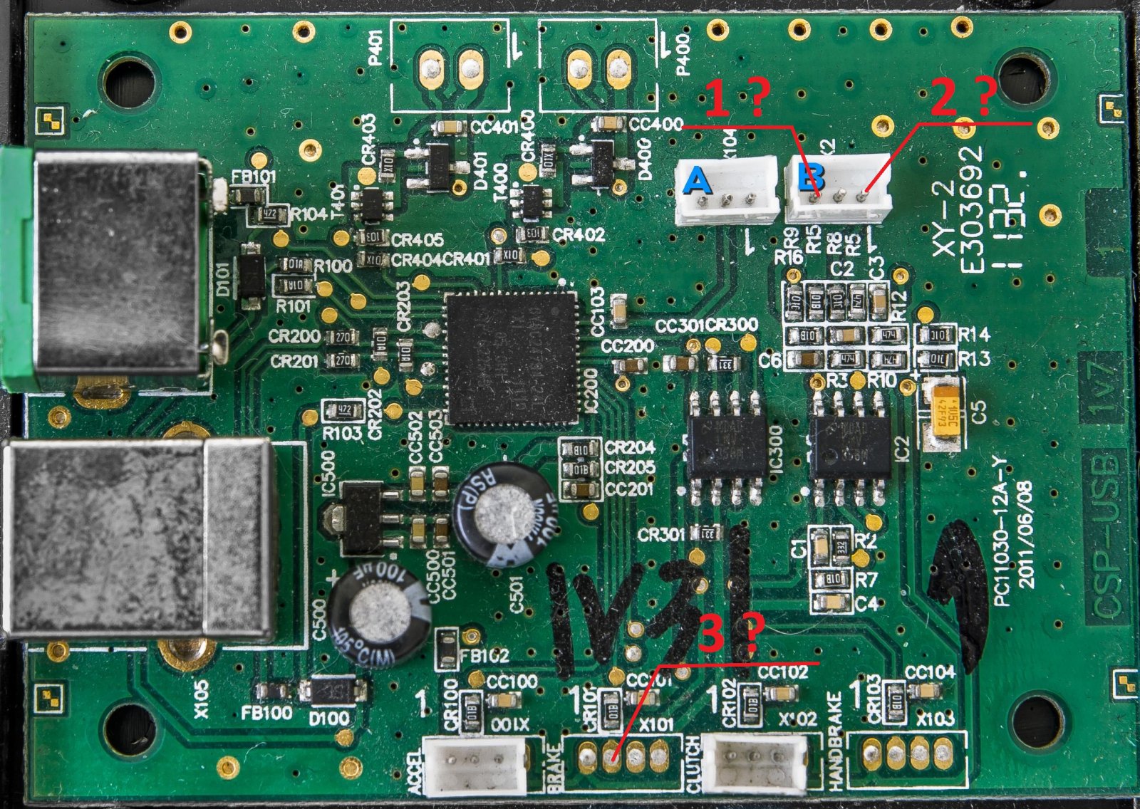

    Good evening. Recently my fanatec csr elite pedals brake pedal stopped working. The brake works on a load cell. Today I diagnosed and replaced lmv358l signal amplifiers, and 3 resistors 01B and one 01C.
    After all these manipulations, the voltage on the signal channels B+ and B- of the strain gauge equalized and the pedal started working. But it takes a lot of effort. For this I am asking for help.
    Maybe someone has such pedals and he has the ability to take measurements voltage on 1, 2, 3 contacts relative to the ground, on the not pressed and pressed pedal?
    Sorry for my English, I use a translator.
