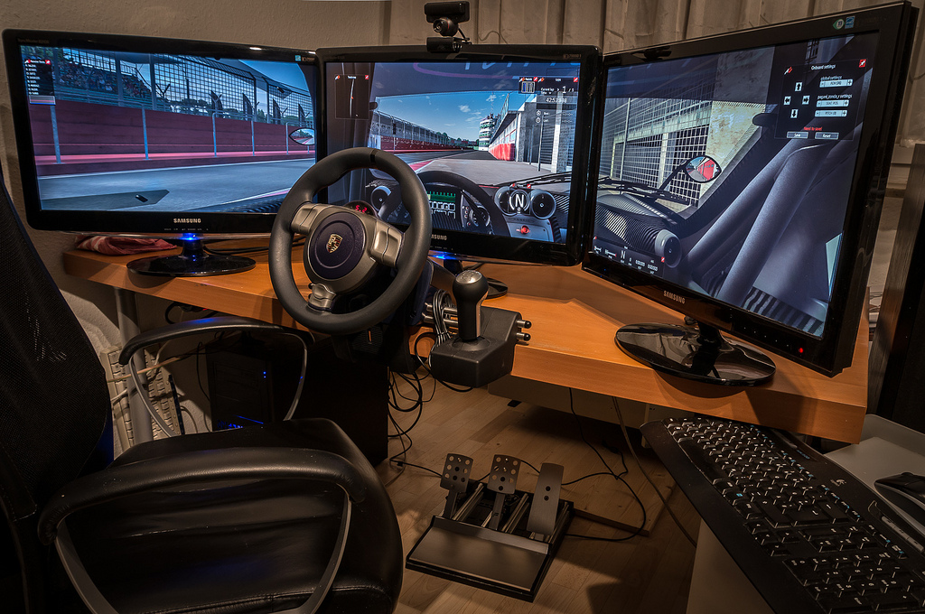

    I'm Martin form Germany and I want to build a motion rig. I really like this forum and what some users have done here. I read the forum for some time now but it's hard to find the infos I need and to make the decisions of what fits best for me and maybe I have to big demands?
    This is my gaming gear so far:
    I play racing simulators (simbin games and Assetto Corsa) most of the time and I would like a fast and accurate movement. Even vibrations should be delivered by the motor or actuator, if possible? I read that the scn5 is very good in this but not the strongest and to expensive for me. I want 2 dof with 2 Motors and the whole platform to move, not only the seat.

    Hello Marty. Nice setup you have there, do you have pics of that on insidesimracing.tv ? It looks familiar.

    Maybe I posted a similar picture on insidesimracing.tv but I'm not very active there.
