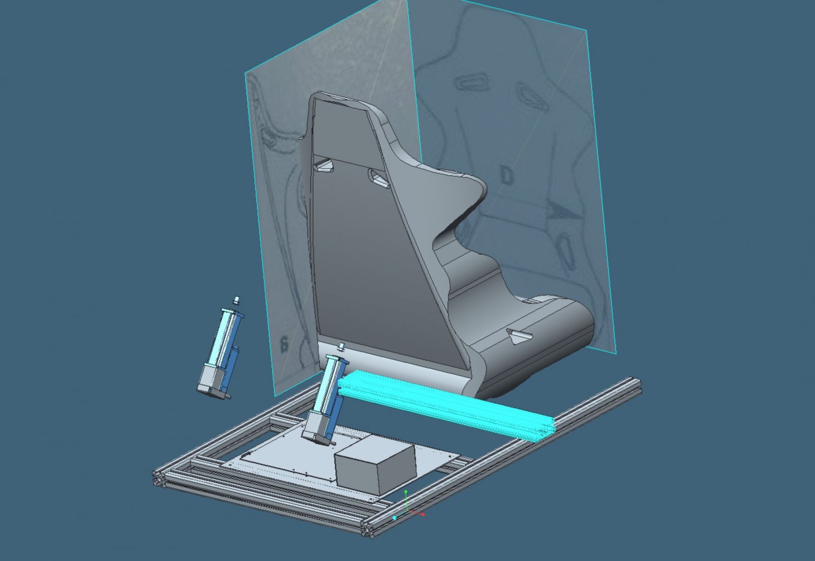

    I study Mechanical Engineering in Austria and I am here to share my project with you and may find some new ideas.
    As the title suggest, I and two other students will build a Sim racing rig as our final year project,
    which is quite a privilege in my opinion.
    We split up the project into 3 parts:
    Front part (Monitors, adjustable pedal and steering wheel position)
    Rear part (Cylinders, PC, PSU etc.)
    Design
    I think this is quite interesting, since we have (of course) calculate all the joins, junctions etc. which doesn't
    really happen normally.
    It has to meet special requirements however, since it has to represent the school in the best possible way.
    These are:
    Easy to transport
    as cheap as possible
    light
    good looking
    realistic (may serve as a simulator for a driving school later)
    Not wider than 90cm
    reliable
    Integrated PC
    Until now, we were mostly planning and deciding which way to go.
    In the end we decided to go with SCN5 Cylinders and an aluminum frame, since we were able to get a discount for educational purposes, and we have loads of aluminium profiles liing around at school.
    I have already got a kardan universal joint for the seat, as well as steering links with "ball joints" for the cylinders.
    Probably the biggest challenge is the programming, since we have to do it all our self.
    We will use Assetto Corsa and pCars as software.
    I am responsible for the rear part of the construction of the rear part so here is my progress.
    Feel free to criticize.
    UPDATES follow soon.

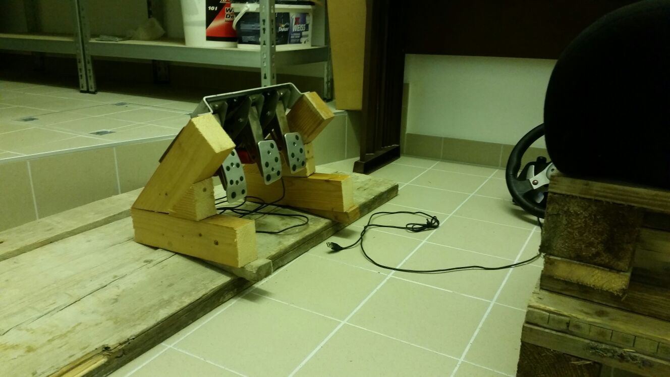

    As far as progress goes:
    .)Study
    We made a little Study with 10 participants, from 1.50 to 2.05m height. The result was quite astonishing. We wanted to mount the Pedals upside down and expected,
    that shorter people would like to have their pedals higher, which was wrong.
    It turned out, it was personal taste only. What we definitely figured out was, how far away the Pedals have to be in average, and how far we have to move them back and forth.

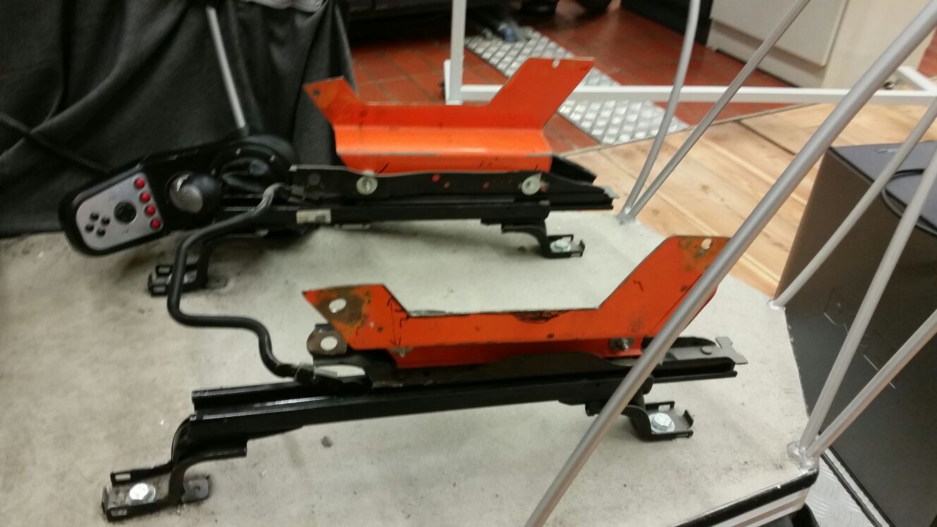

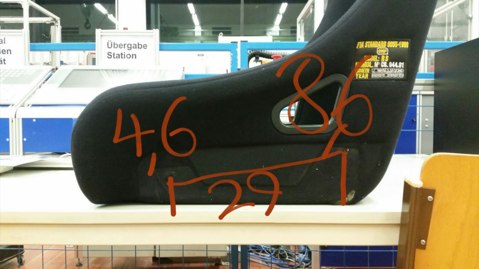

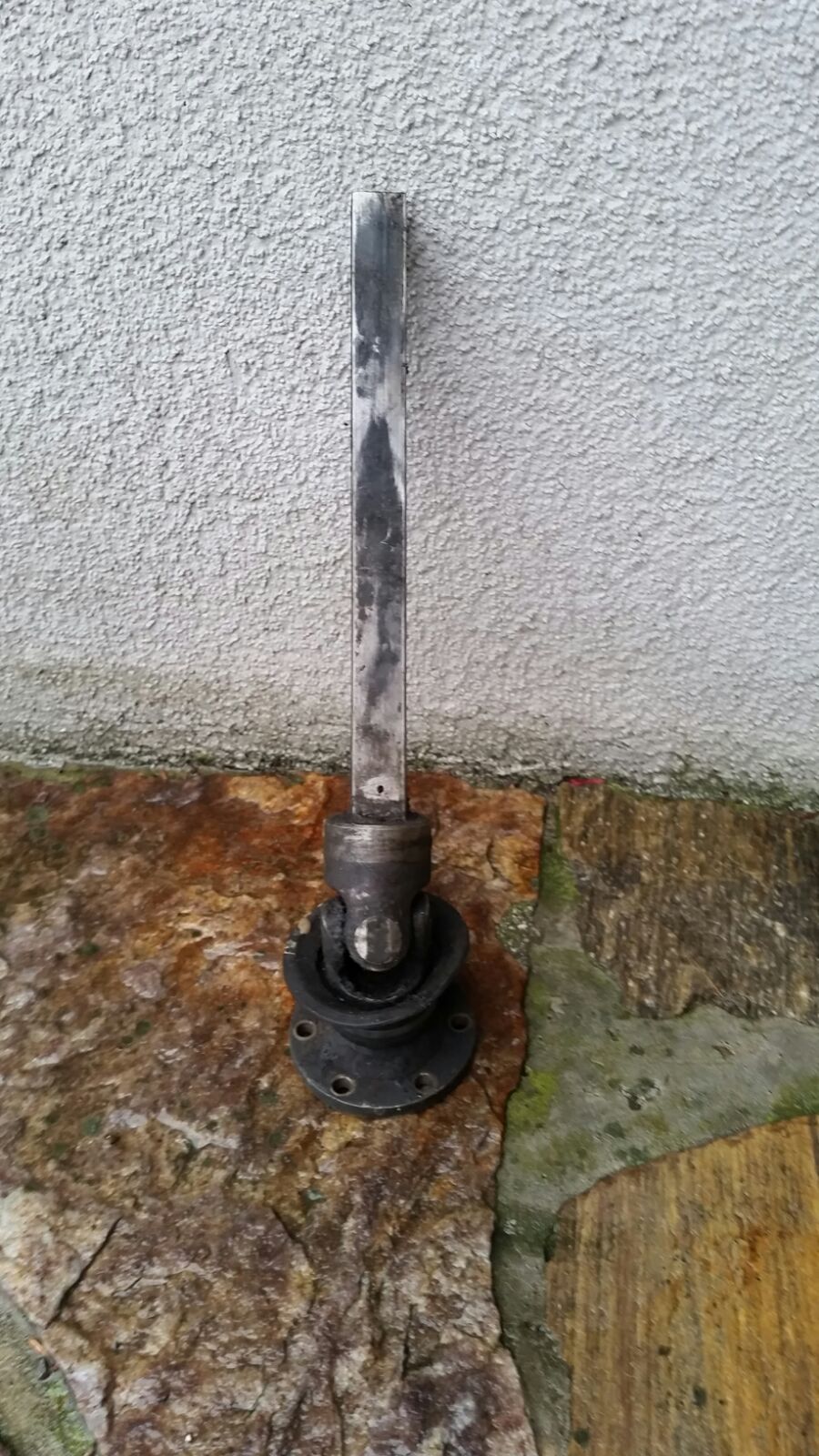

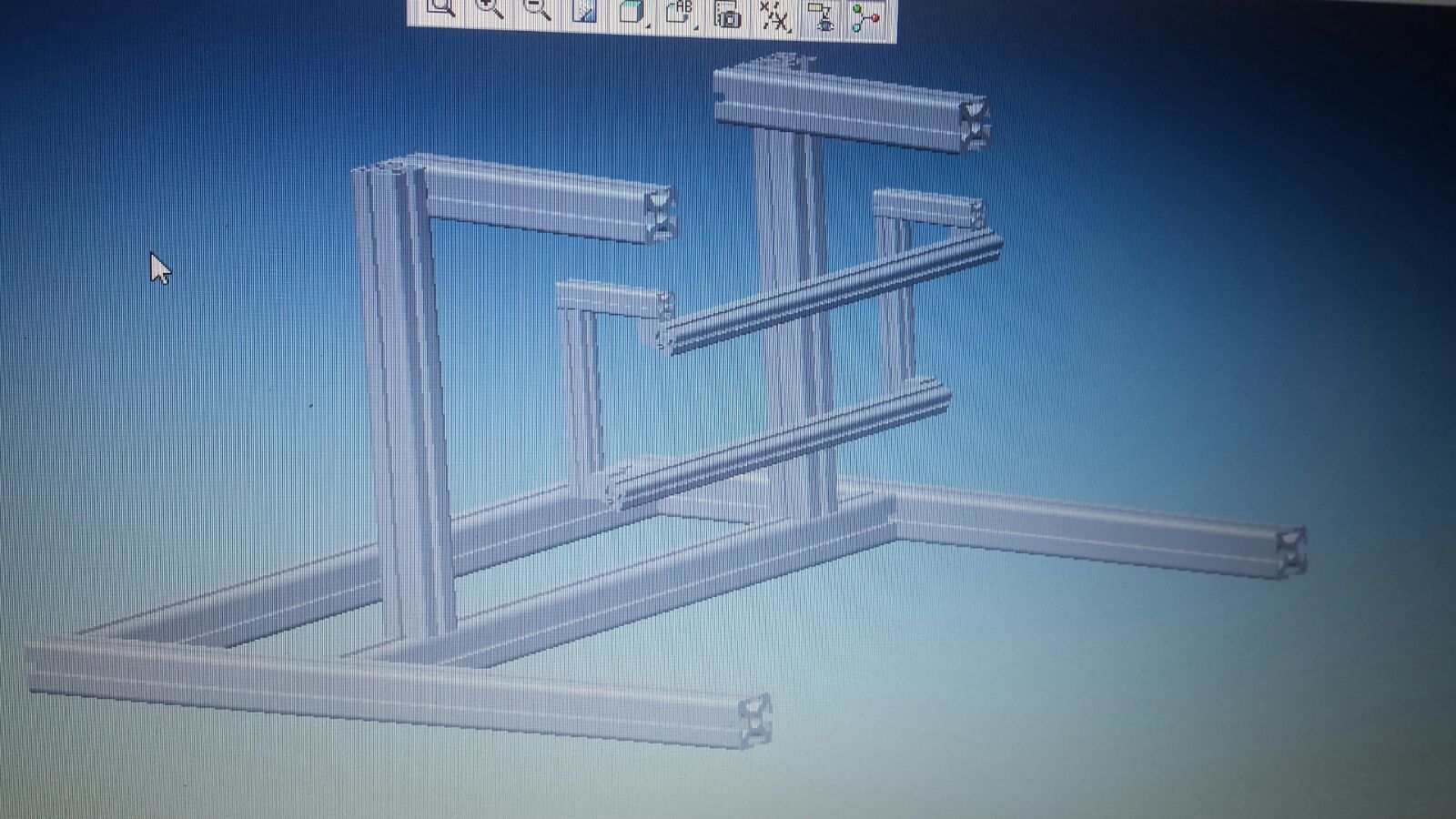

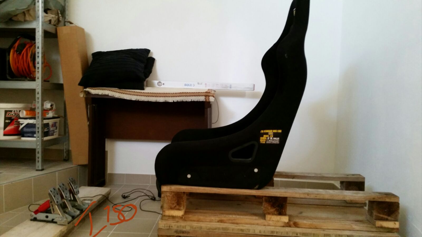

    .)Construction/Design
    As we need to have adjustable pedals, we wanted them to be adjustable as easy as possible.
    I came up with the idea of using the seat rails of a car, and use a pull spring to pull it to the nearest position possible when the safety is released.
    It can be released by pulling on a cable, while sitting (probably near the gear leaver for ergonomic reasons)
    Furthermore, I made the whole profile assembly under the seat. I still have to calculate, if I need an enforcement at the kink.
    So here are somePics;)

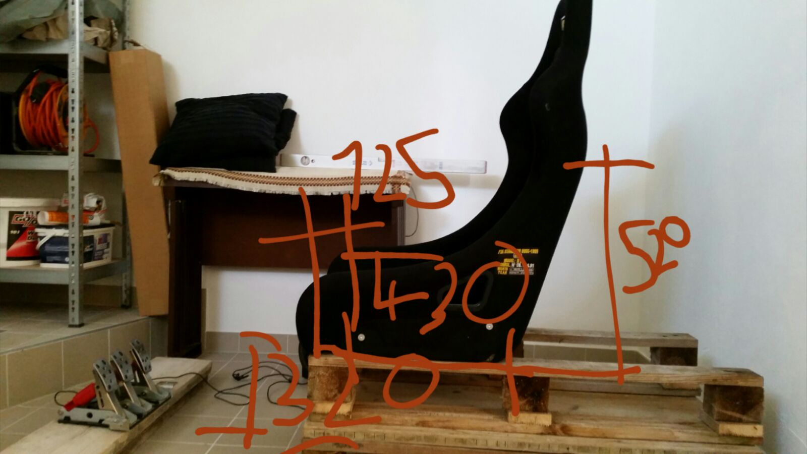

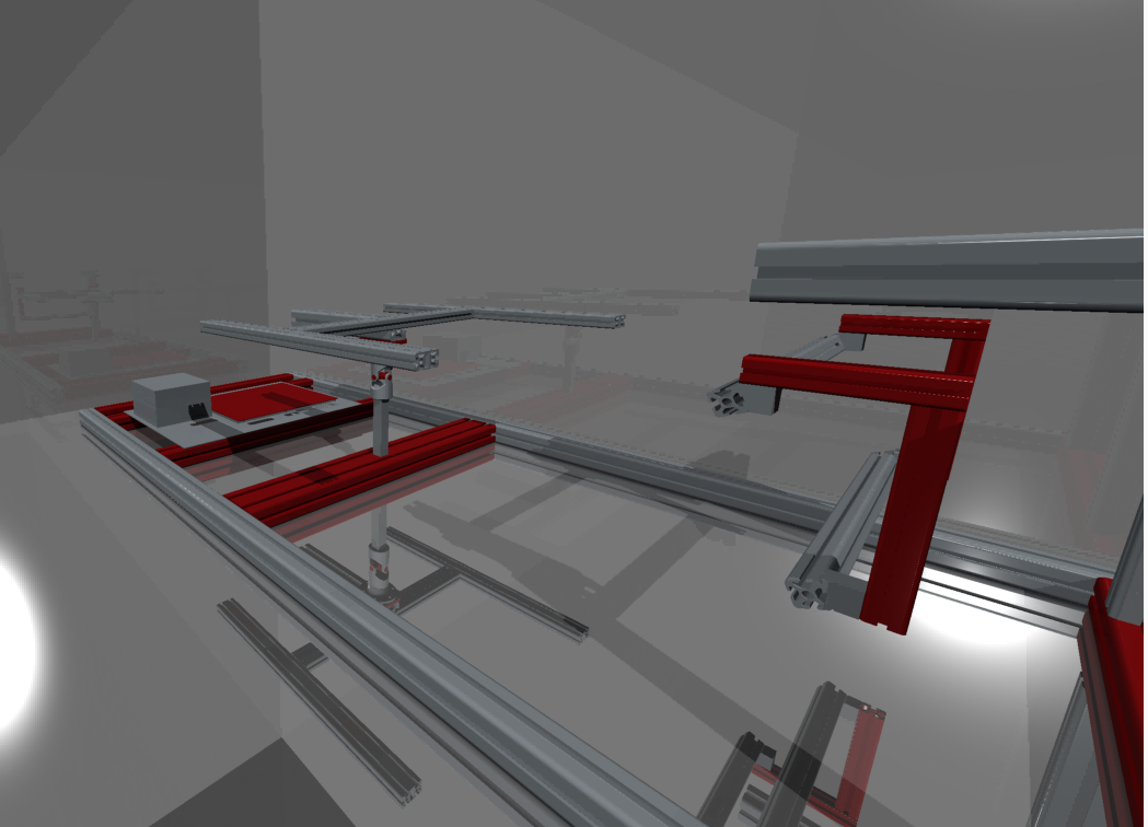

    1) We had to make kind of a presentation, since "the day of open doors" is coming soon.
    2.) The seat we are using (some measures) OMP RS form 1995
    3.) The rails we are going to use from a "old" project.
    4.) Pedal construction used for studies.
    5.) Progress on the Pedal mount
    6.) Some more measurements of the model (just approximately)
    Best Regards!

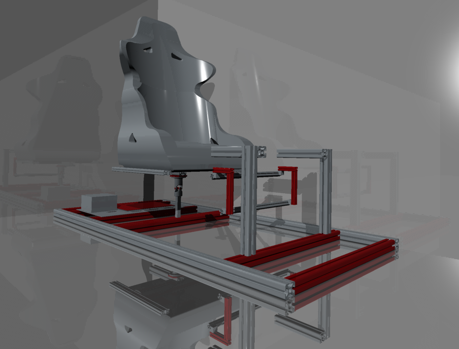

    EDIT:
    Some more renderds;)

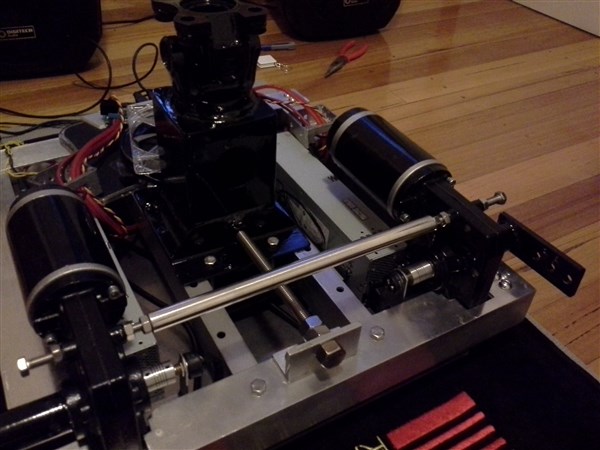

  18. noorbeast
    21,159
    148,640Coins
    +10,909 / 54 / -2
    JRKs are easy, on the setup side follow @eaorobbie's steps, just set the Integral Limit to 10,000 not 2000: http://www.xsimulator.net/community/threads/playseat-to-2-dofseat.5401/page-2#post-56352
    For configuration follow @bsft's guide to JRKs and SimTools here: http://www.xsimulator.net/community...-set-up-simtools-jrks-and-write-profiles.112/
    Make sure the JRKs have a heat sink on the big chip and 12V fan for cooling.
    With respect to your renders nice job, but do move the uni joint up to be as close to the seat as possible: http://www.xsimulator.net/community/faq/universal-joint-placement.108/
    Use something like 6mm angle iron to mount the DC motors to the frame, they are capable of considerable force and need to be very secure. I run a bar between my motors so they become a structural part of the frame.
    There are different ways to attach lever arms to DC motors depending if they are solid or hollow shaft: http://www.xsimulator.net/community/faq/how-to-attach-levers-to-wormdrive-gearboxes.182/
    There are a number of ways to attach potentiometers but by far the easiest is to use flexible couplings with Hall sensors: http://www.xsimulator.net/community/faq/how-to-connect-protect-a-potentiometer.13/
    There is plenty of other useful information in the build section of the FAQs, such as wiring kill switches and how to find the balance point of the rig: http://www.xsimulator.net/community/faq/building-resources.12/category

    @noorbeast @bsft , thank you very much!
    To adress your points:
    1.) JRKs: We are learning to program those in a few months time I think so, that will come in handy ;)
    2.) spledid work on the guide @bsft, we will see we are allowed to use X-Sim/Simtools though... Maybe we have do this on our own, I'll let you know.
    3.) Thx for the advice for the heatsink, wouldn't have thought about that.
    4.) I tried to move the universal joint as close as possible to the seat, but I can't get it any further in the current configuration. I'll maybe rework it.
    5.) I probably enforce the frame where needed in order fix them properly.
    6.) Hall sensors, interesting, we just learned about thouse :p, would have used potentiometers, but they could be a nice alternative in terms of reliability.
