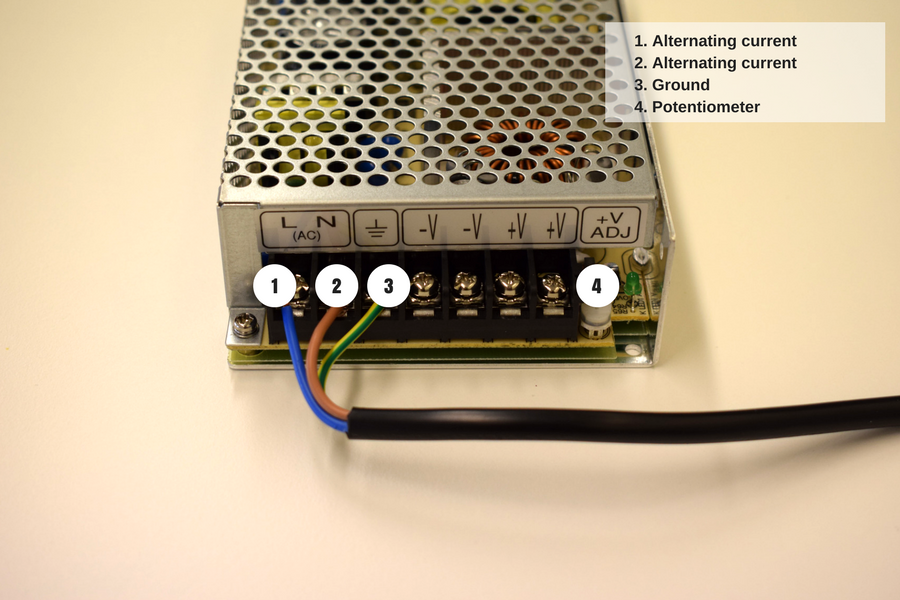

    i have this https://www.ideahellas.gr/product/trofodotiko-500w-12v-40a-gia-led-kameres-klp-andowl-q-d40a-asimi
    what need to power it? i dont see a PORT for cable like pc PSU
  12. noorbeast
    21,157
    148,628Coins
    +10,909 / 54 / -2
    Where are you located in the world?
    You will need a power plug and cord for whatever applies in your part of the world.
    That gets wired into the PSU, which changes whatever the voltage is that is used for appliances in your part of the world to 12v.

  16. gingercat
    gingercat New Member
    Aug 16, 2014
    8
    Software Engineer
    Nr Lancaster, UK
    131Coins
    DC motor, SimAxe, Arduino
    In that pic above, live and neutral appear to be connected the wrong way round - at least here in the UK live is brown, netural is blue. Not sure if it matters for that PSU.
