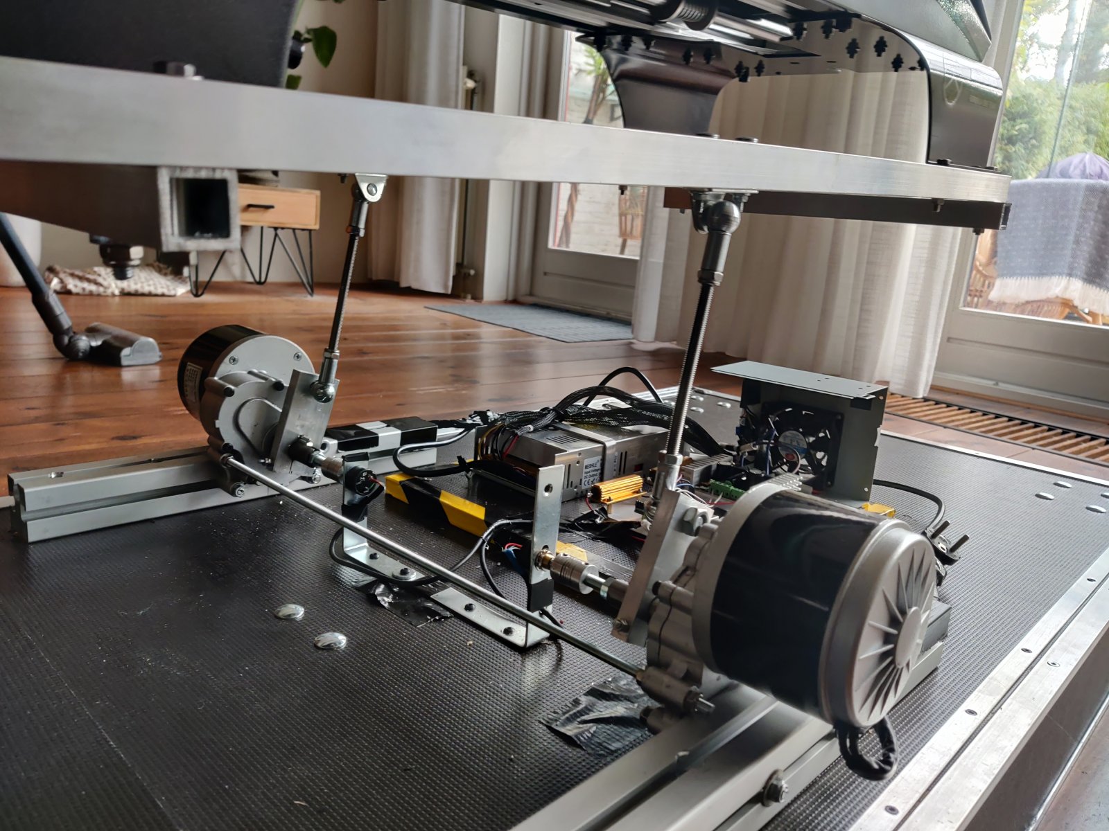

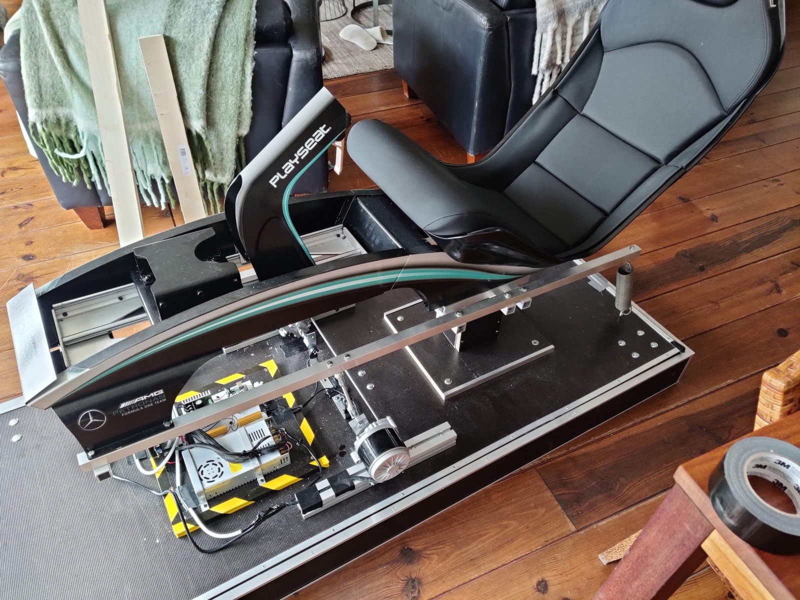

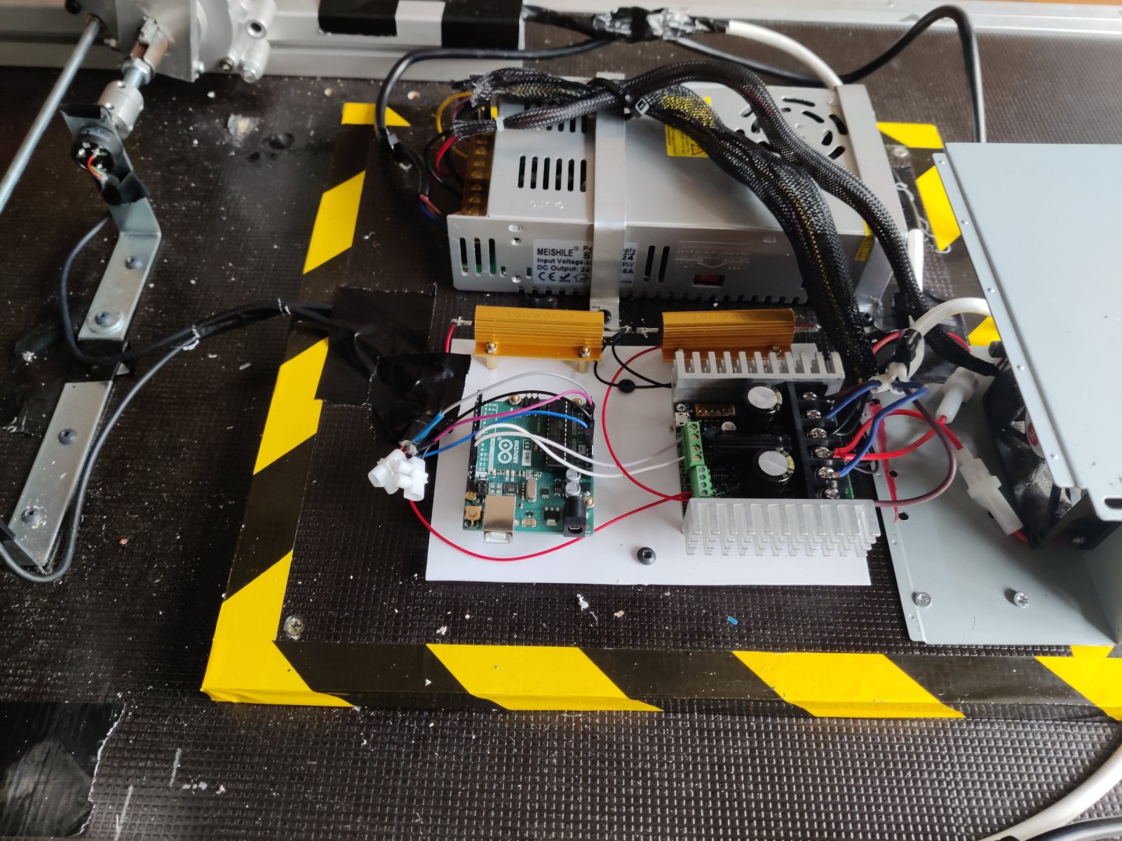

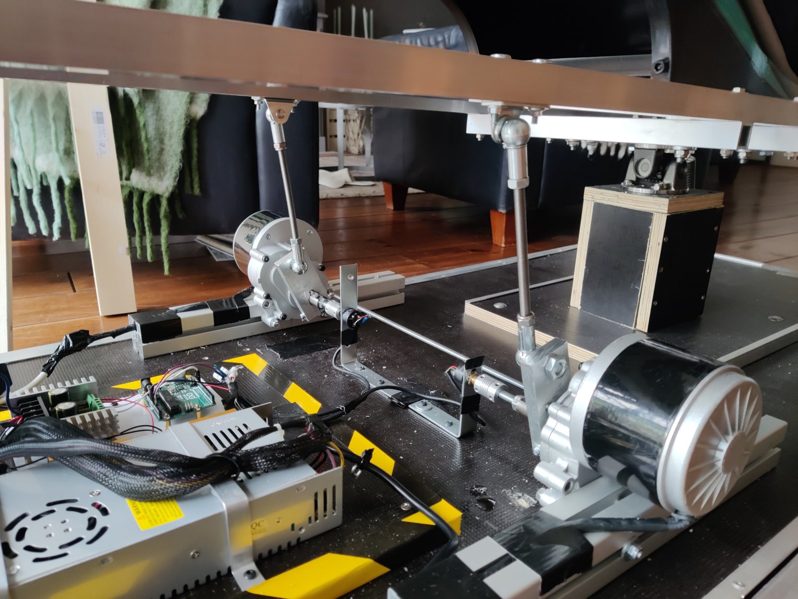

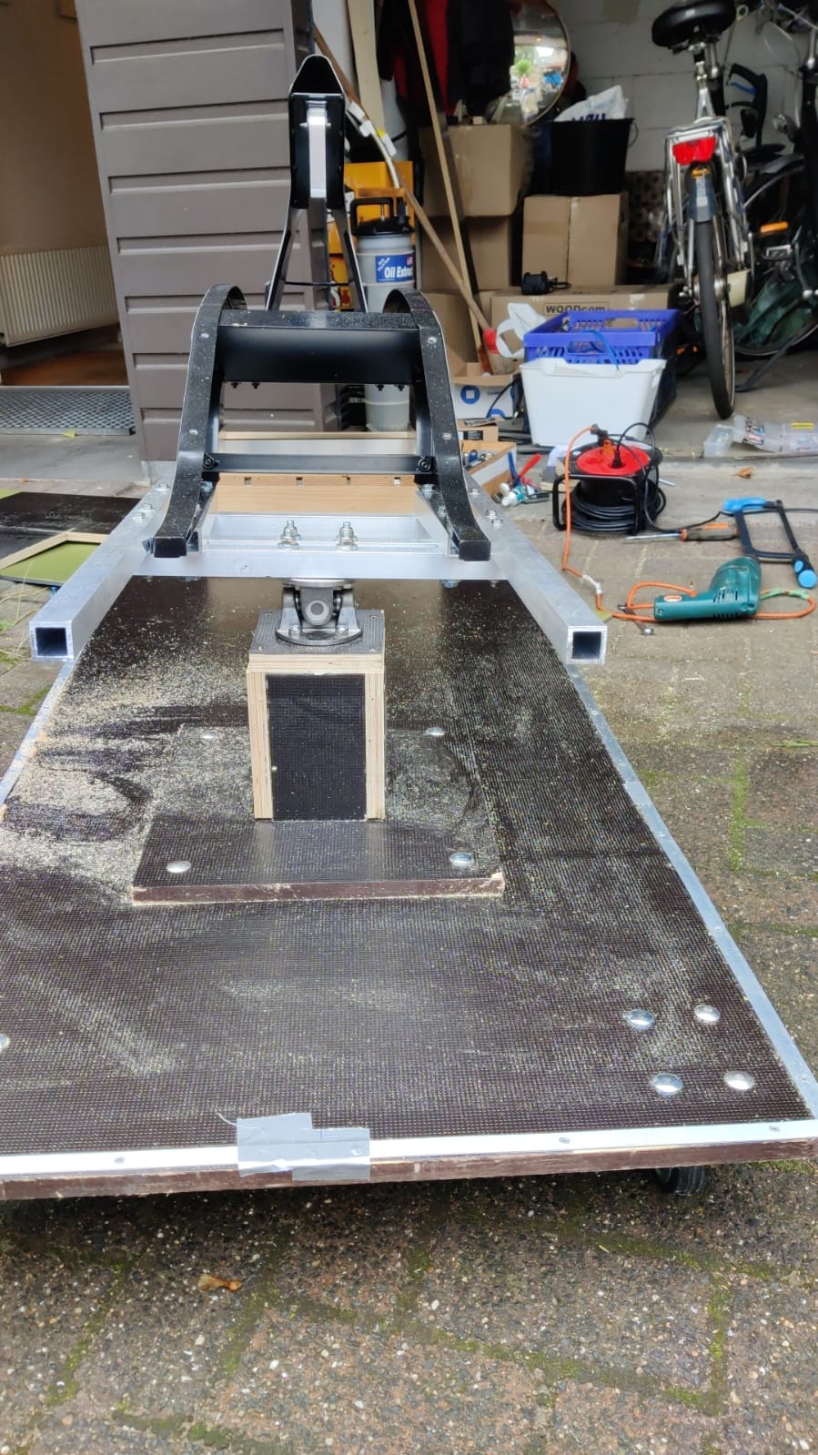

    This is our first step in creating a Racesimulator we can tranport. It is still to heavy but we first wanted to test if it is possible and if it could carry and move weigth of 160KG in total.
    used components
    Ardunio R3
    SaberTooth 2x32
    600 watt power supply (24Volt - 25 Amp)
    2 resistors Mdurian 100W - 4 Ohm
    2 motors 24volt-75 rpm 250 Watt
    2 Hall sensors
    Playseat F1 Pro
    Used Sketch and wiring Thanks @BlazinH

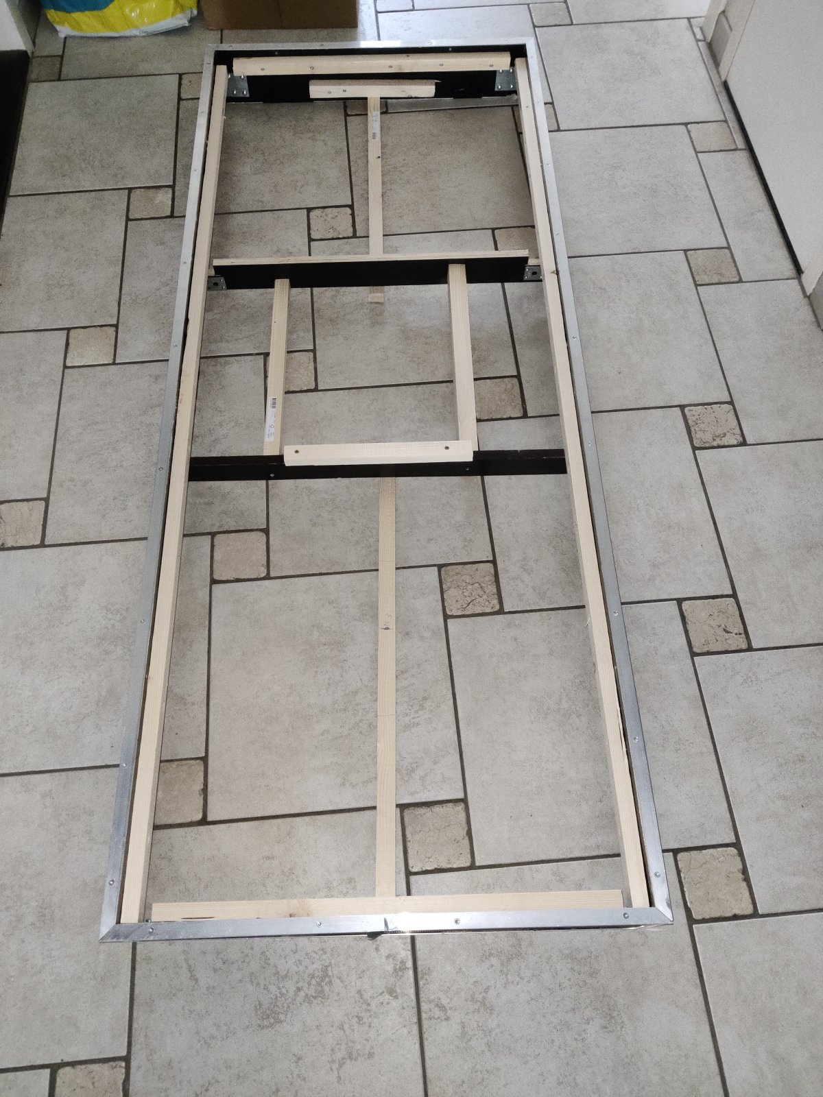

    The whole unit is lifted in the frame and secured with Safety Pins

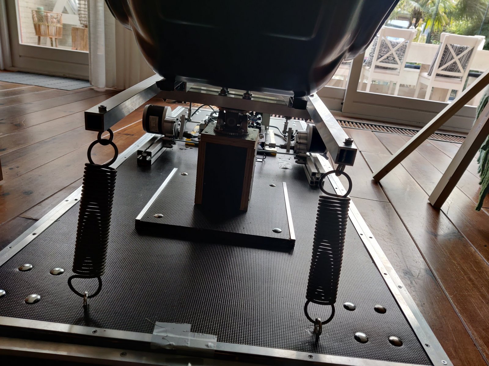

    The two springs at the back compansate for the downforce of the have footpedals (200mm stretch out and 380NM) (watch you fingers
    Footmount for the chair

    3DOF, DC motor
    Looks good.
    What are the resistors for?

    just to besure that when the motor generates current back to the powersupply things are not breaking down. It is recommended when you don't use batteries.
    from the SaberTooth documentation
    One major improvement in the third generation Sabertooth motor drivers is the addition of the Power outputs P1 and P2. These can be used with an appropriate resistor to dissipate the regenerative current generated when the device slows down or stops. This allows the use of power supplies without batteries or capacitors to absorb the regenerated energy. A calculator on the Dimension Engineering website will assist with choosing appropriate resistor packs. At least one of the power outputs should be configured as a voltage clamp when using a power supply.

    I understand. I have IBT-2 and no resistors. I use 24V power supplies. The most wirings, wich i saw in the forum, have no resistors.

    correct but the IBT-2 didn't work for me. During playing the game one of the engines stopped when moving fast from left to right and back. the only thing that helped was moving over to SaberTooth 32 everythings work like a charm.

    oh yes. i read, that the BTS make problems with 24V. I have adjustable power supplies als let that work at 18V. According to the datatasheet, 19V is no prblem, too, but all over them it can give problems.
    Sabertooth is the better decision there

    I tried with lower voltage between 18 and 22 volt. Same result, one of the motors stops without any cause. Exactly the same setup with SaberTooth, no problem
