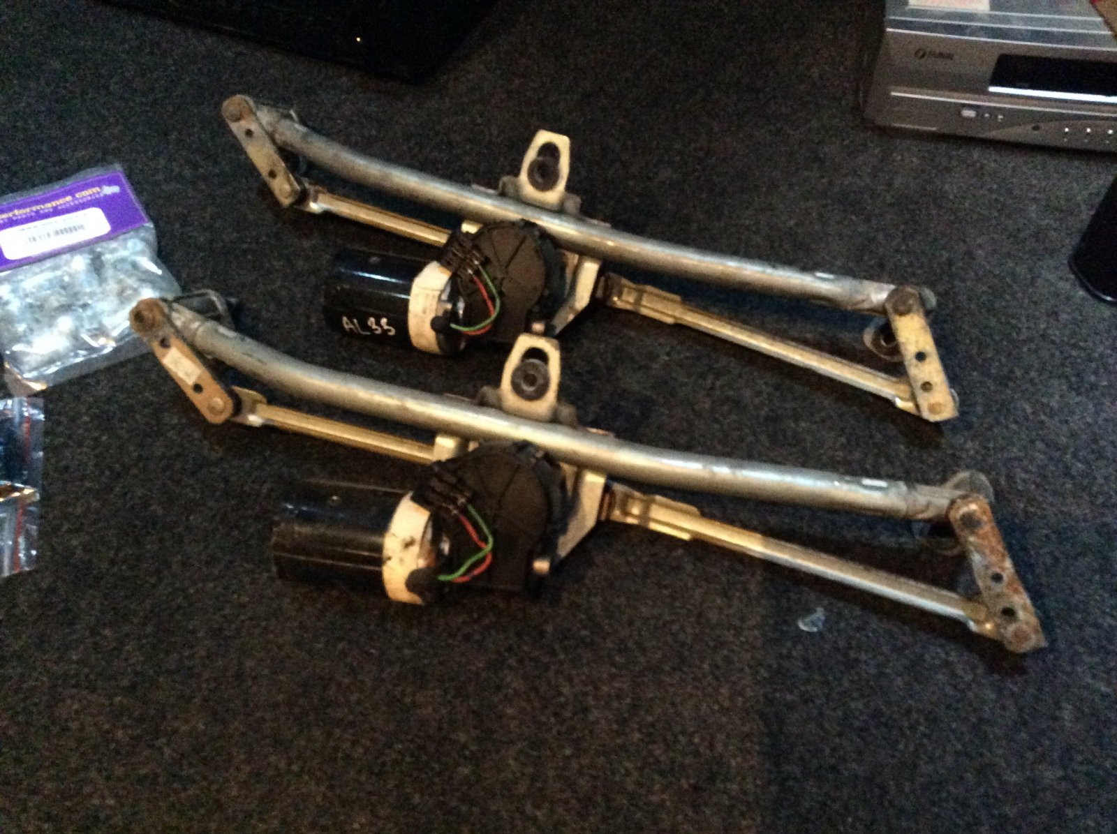

    Hi all, just wondering if these parts I'm about to order are going to be any good. They don't have to last all that long as I will be upgrading once I get to grips with things just want to do it as cheap as possible for now.
    4x http://www.ebay.co.uk/itm/141353558028
    2x http://www.ebay.co.uk/itm/331220546114
    http://www.ebay.co.uk/itm/141306525371
    http://www.ebay.co.uk/itm/161262305272
    http://www.ebay.co.uk/itm/251060570083
    http://www.screwfix.com/p/bzp-threaded-rod-m12-x-1000mm-pack-of-5/98942
    A few other bits to get like a cheap arc welder and scrapyard driveshaft.
    Thanks for looking,
    Cheers,
    Craig.
  2. eaorobbie
    20,431Coins
    +1,684 / 23 / -2

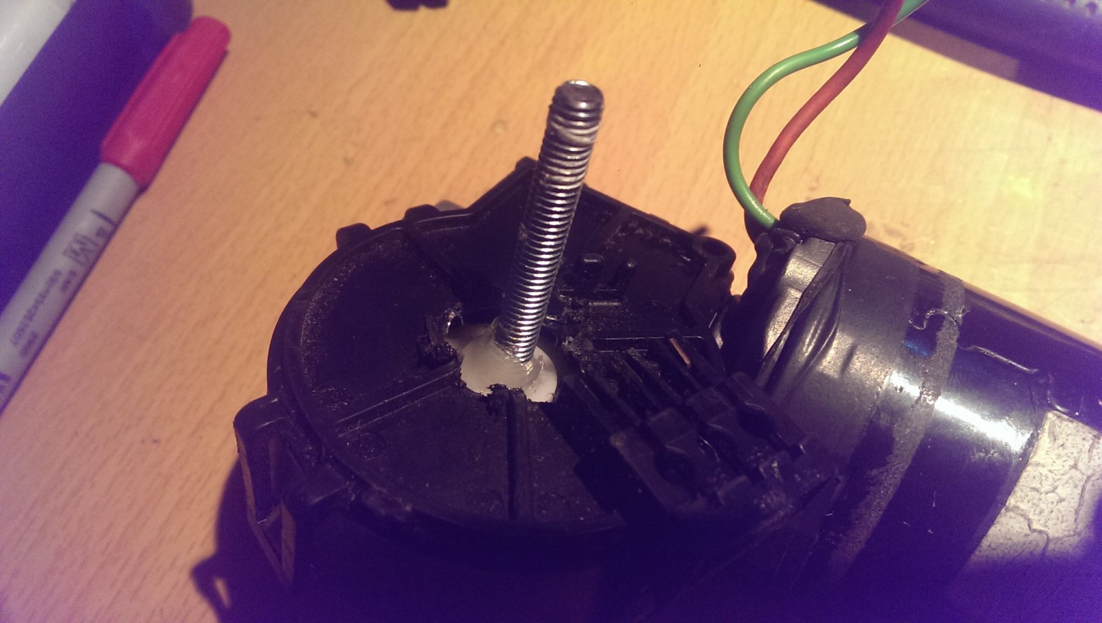

    All looks good Craig. @SilentChill , just beware the wiper will need modification as they run the earth through the body of the wiper so this will be needed to be removed before using for a simulator. Or when the motor goes in reverse it will send 12Vs running the through the frame and anything like a set of pedals even the Ard (through the pot connections) will get a back 12v shock , normally frying them good.
    Next I would find some pipe to sleeve over the M12 All Thread , tends to bend with sharp motion changes (done that one myself- ah what!!) so a sleeve over it will help it immensely.
    Apart from that mate all looks good, would recommend you look into @RufusDufus code , a very nice app that makes it easier to setup, a few now have used this now successfully with all the same components you propose.
    Happy Building.

  9. mugge66
    mugge66 Member
    Jun 11, 2014
    80
    Denmark near Copenhagen
    167Coins
    +26 / 1 / -0
    2DOF, JRK
    Hi
    when mounting the threaded 12mm rods to these a good idea is to put some grease on the thread and also a mount an extra nut, i did the same and it took away some cranking sounds. Will post a picture later. :)

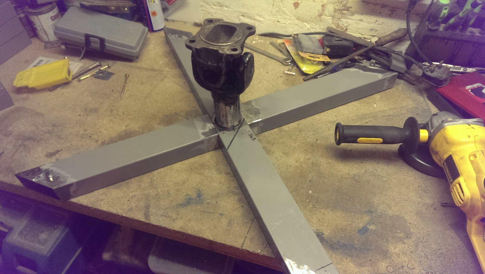

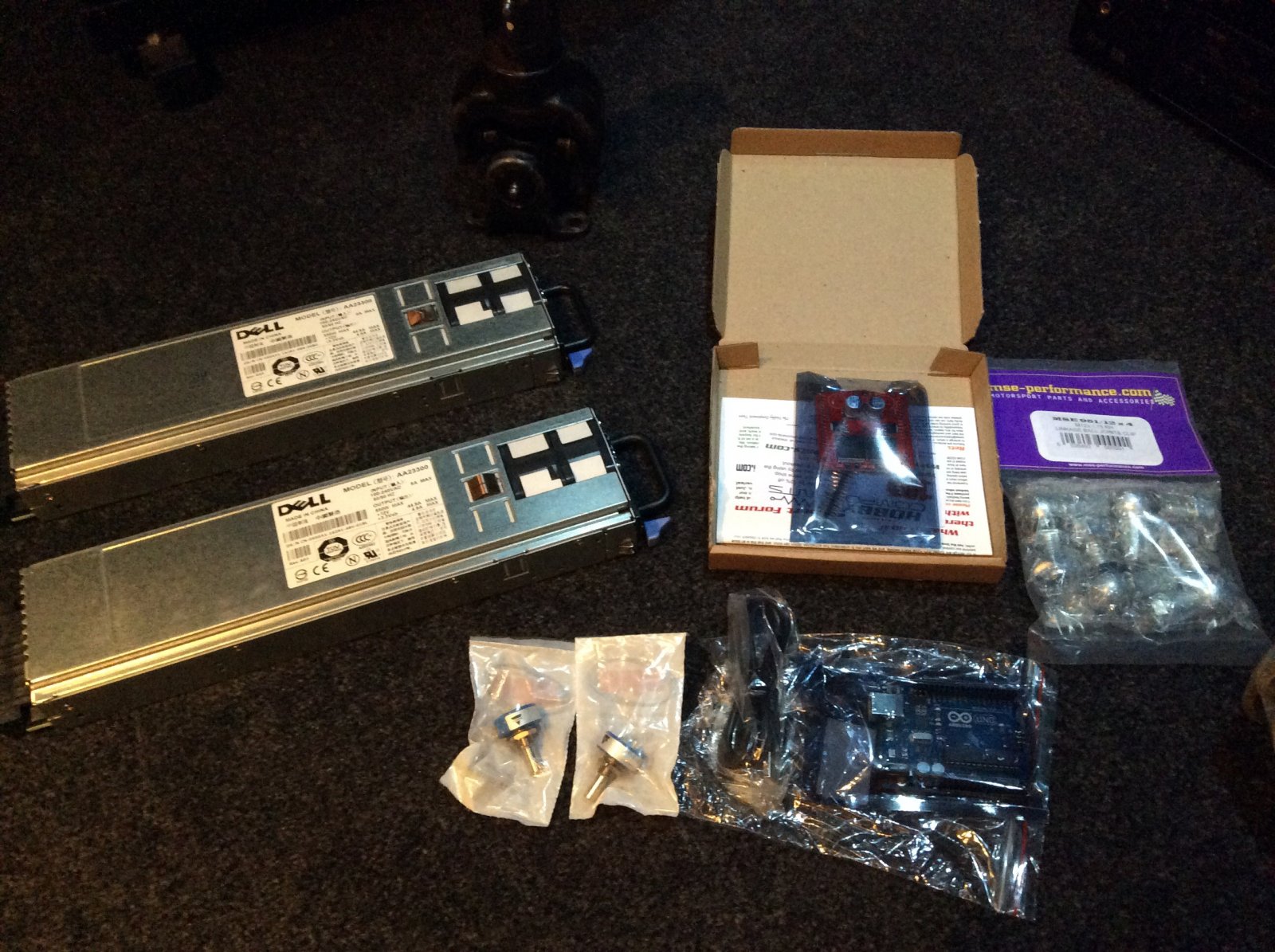

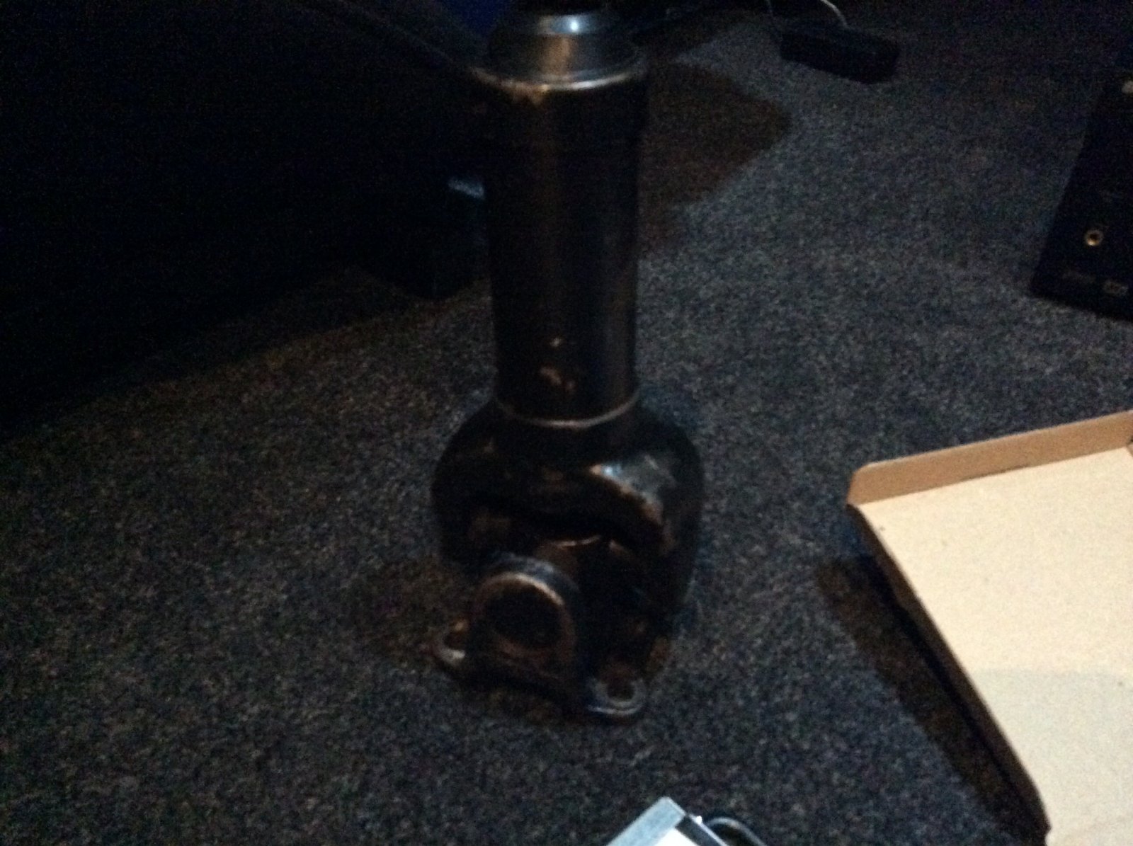

  11. SilentChill
    2,643
    20,557Coins
    +3,487 / 34 / -0

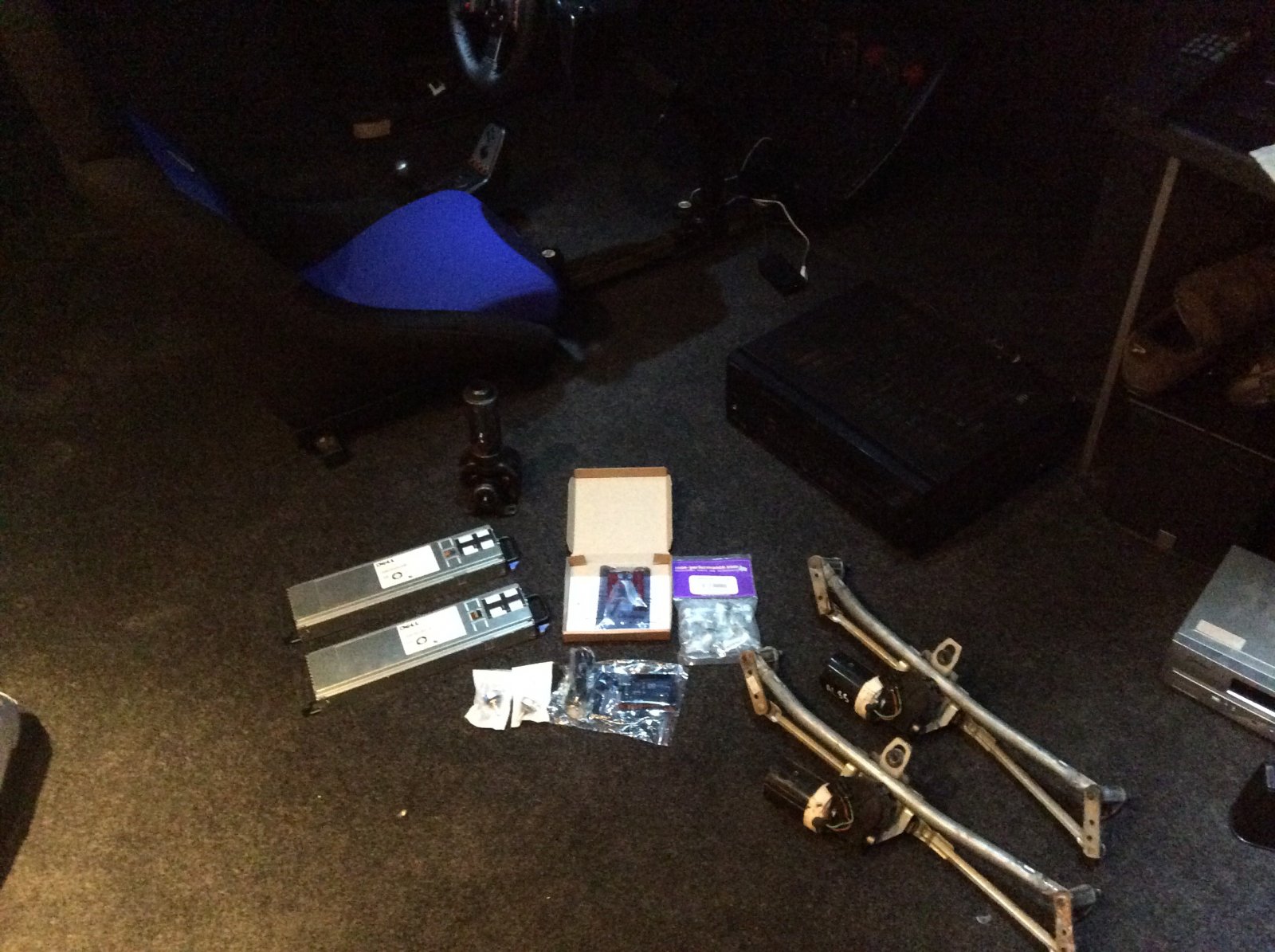

    Ooooo exciting stuff has arrived lol :oops:
    Picked the UJ from a local scrappy only cost me 5 squids :thumbs

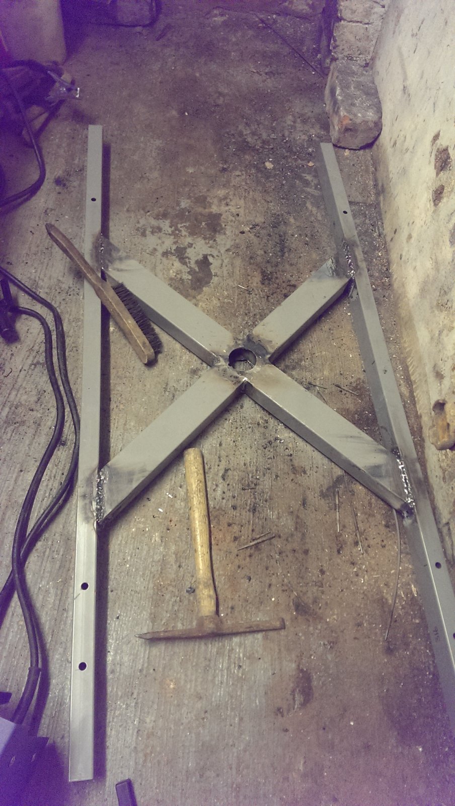

  17. SilentChill
    2,643
    20,557Coins
    +3,487 / 34 / -0

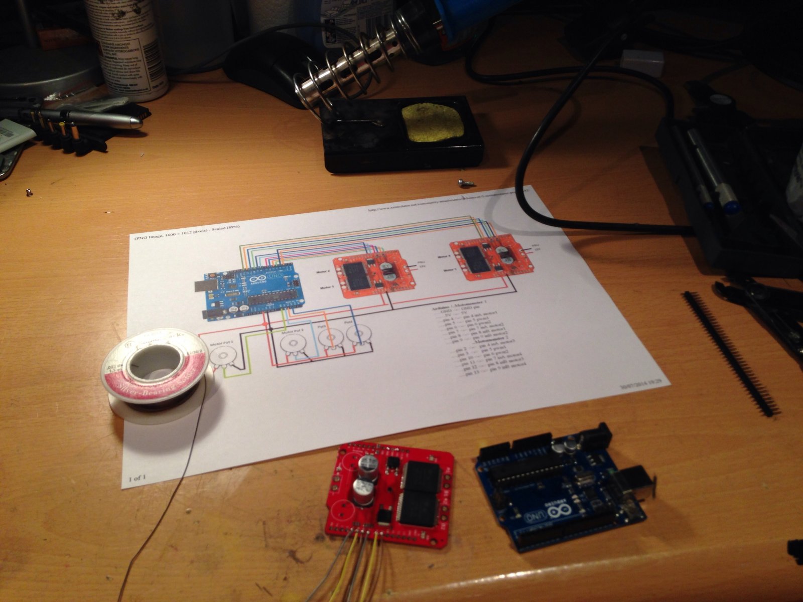

    Let's get soldering
  18. SilentChill
    2,643
    20,557Coins
    +3,487 / 34 / -0
    Just a quick update, I built the SIM out of wood just to test everything whilst ibwaited for my welder to come . Just as well as my motomonster was dead on the second motor forts motor worked fine. Should have a new one tomorroowow

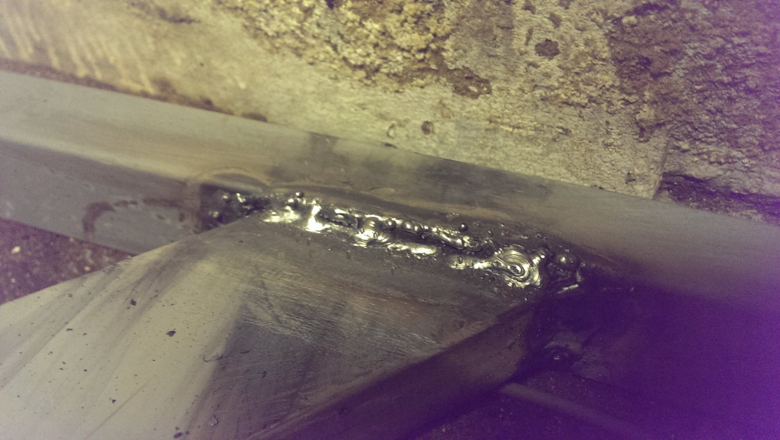

  20. SilentChill
    2,643
    20,557Coins
    +3,487 / 34 / -0
    I seriously need to watch more YouTube vids on how to weld, seems it's a bit harder than siliconing round a window frame Lolol
