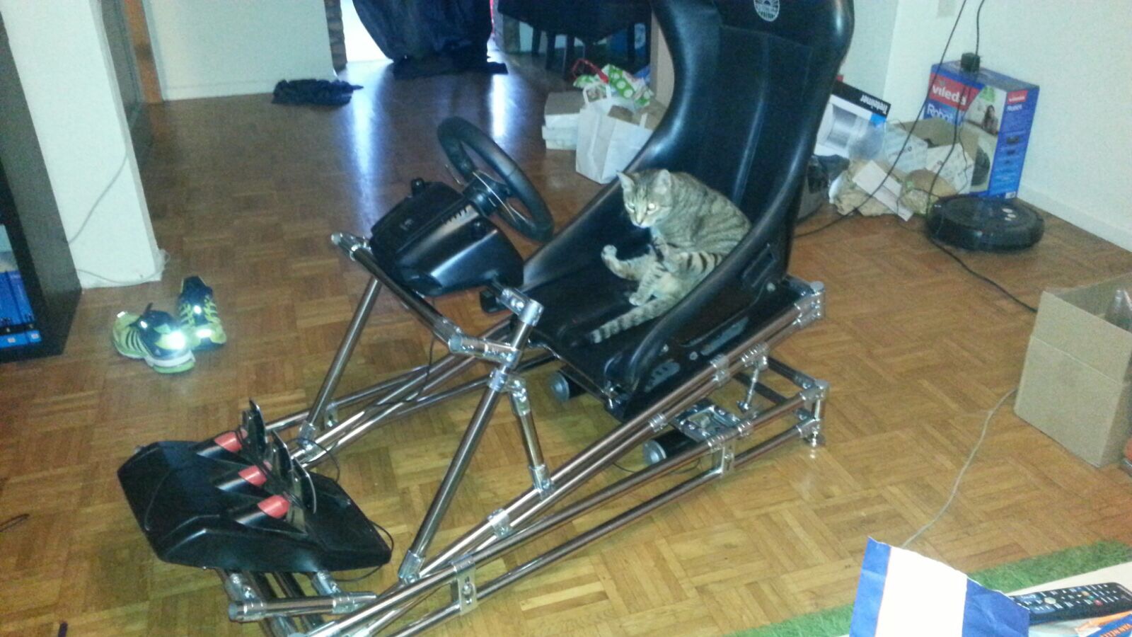

    My name is Tim and I'm working on a 2DOF Arduino DC-motor simulator.
    This project is a combination of 3 of my biggest interests: (sim) racing, arduino and (embedded) electronics and generally building things.
    I came across SimTools a while back and started playing with the idea of making my own motion sim. After some basic research I got some motors, a controller and grabbed an Arduino and got the software running in no time.
    The power supply and the motors (120W 24v) are from Simukit, the controller is a Monster Moto I had lying around. After many hours of figuring out why the motors wouldn't turn, I realized the controller cuts off at
    around 16v... A computer PSU got it working and a Sabertooth is on its way.
    At 12v it works, but just lacks in power.
    For the frame I'm using a pipe joint system. It lets me play around with dimension and move about with all the components. It's stainless steel, so well strong enough.
    I'm at the finetuning-stage now, both in hardware and in software. The motors and pivot points have moved further back since I took the picture but I can't really move on untill the Sabertooth arrives.
    Oh, and never mind the cat. She seems to like the chair while it's stationary.

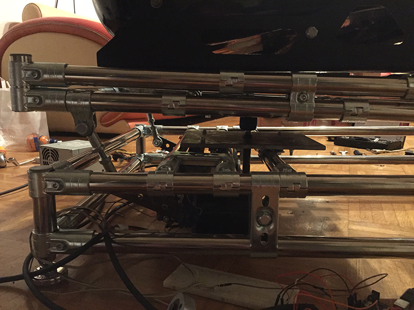

    Just an observation, for a full frame design you have small design leverage with the current motor placement.

    Here's a photo of the current placement. The motors are moved back some 10 cm and the linkages are a bit longer. Also, the motors moved inwards a bit to limit the rotation. I'm using a ball joint from a car's steering rack so it tends to rotate. Maybe I'll have to replace it, but it's pretty much gone with the current lay-out.

    That latest photo shows the connect poit all the way back, which is a significant leverage improvement from the first posted picture :thumbs
