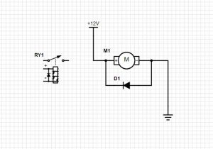

    I’m currently putting a 2dof rig together
    Can anyone tell me if a fly back diode is going to be needed using ibt2 controllers ?
    And if so how to install?
    Are they needed between h bridge and psu ?
    Or between motor and h bridge
    From what I can find it looks like they go between h bridge and motor connecting motor leads with the fly back between
    I’m using 24v psu and don’t want to use a battery on the circuit
    I will be running a good amount of amps to drive the motors. Is this something I should be concerned about or not with ibt2 drivers wired as described
    21,304
    149,495Coins
    +10,947 / 54 / -2
    Fly back diodes are not normally used.
    But be aware other members have reported running IBT2s at a full 24v can cause reliability issues, so many drop the voltage down a bit.
    It is also worth testing IBT2s before use, as members have also reported faults with brand new IBT2 boards.
