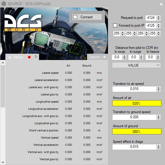

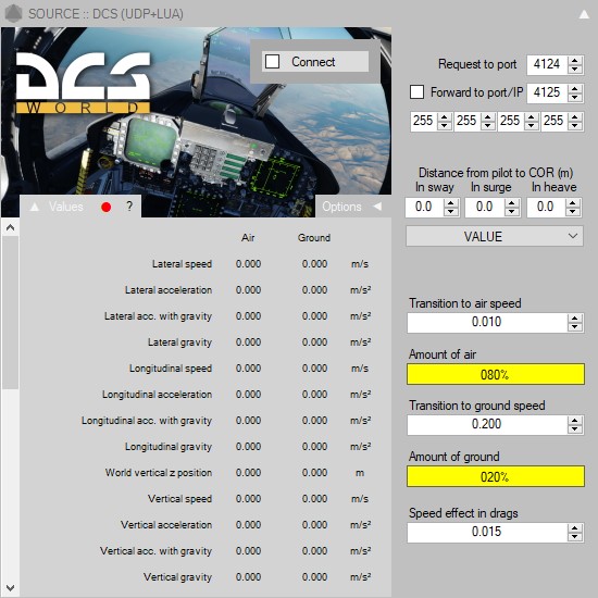

    I encounter the same problems as deadlymanager. However, 3.4.2 still works, with its original AND latest LUA of 3.5.1.
    Have tried about all you suggest. Deleted all SimTools and Simshaker files in Script and Hook, run a repair and check of DCS installation, changed port #...

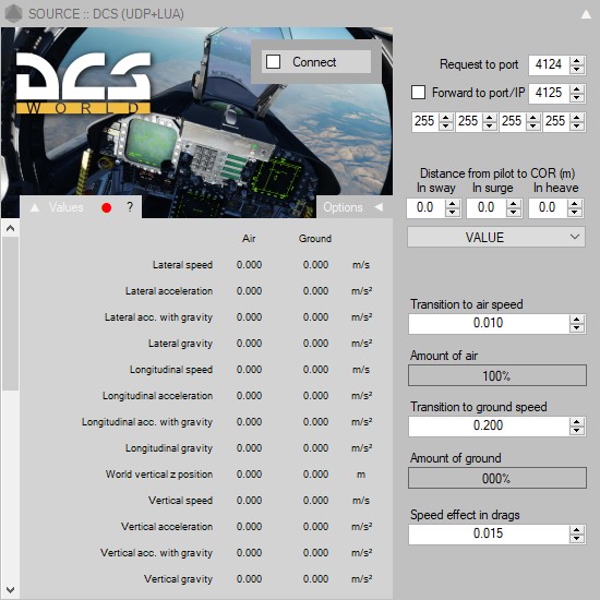

    What happens is this: Source starts like this:
    on connect click only the balance of 'amount of air/ground' changes, 20% in every click, so first click looks like
    and fourth click like
    Hope this helps!

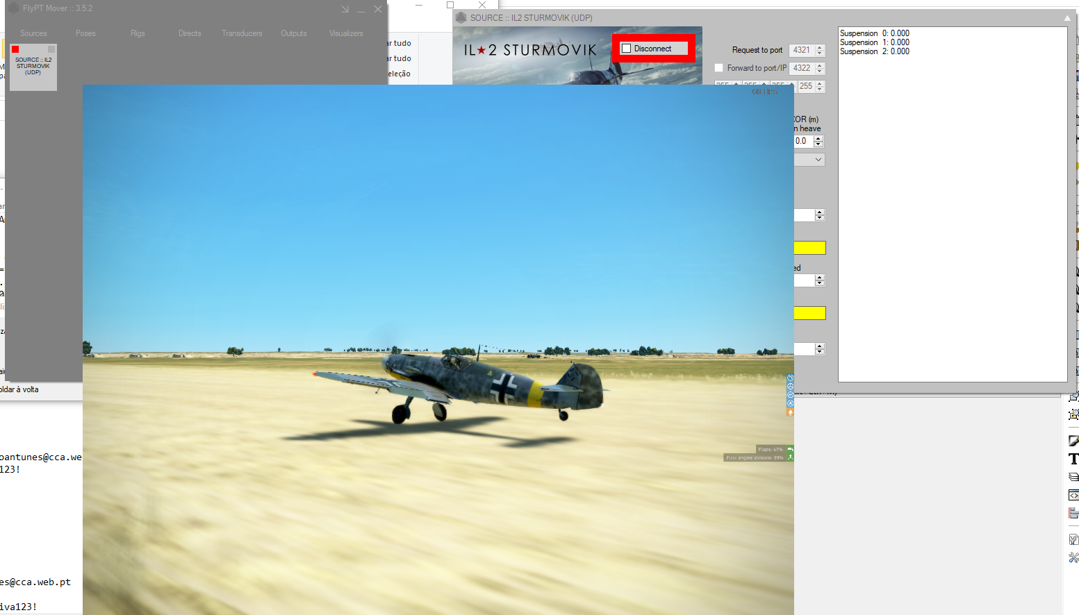

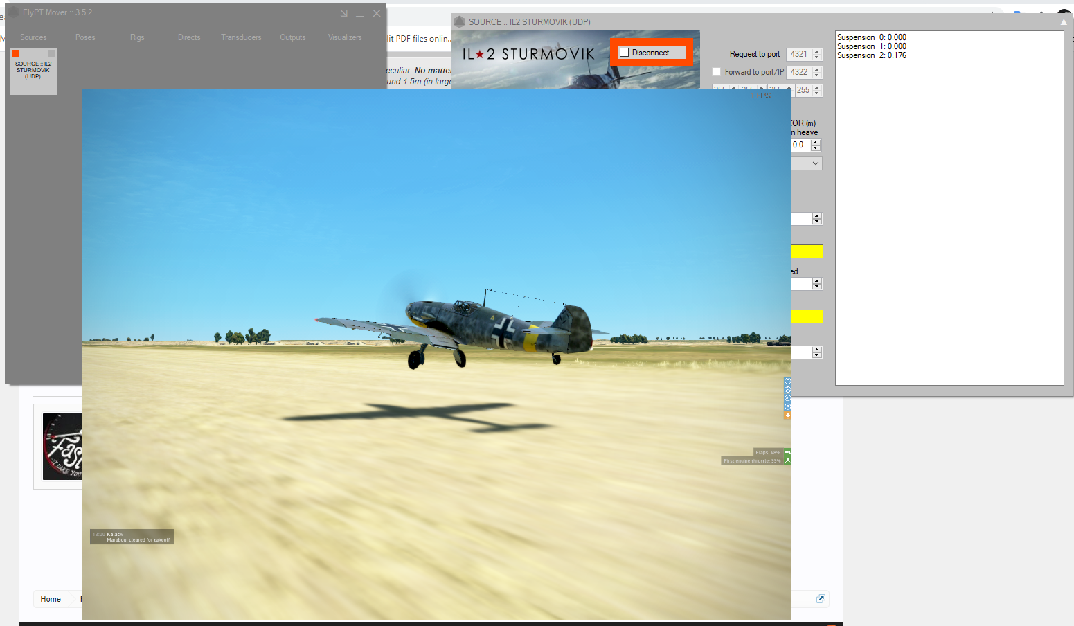

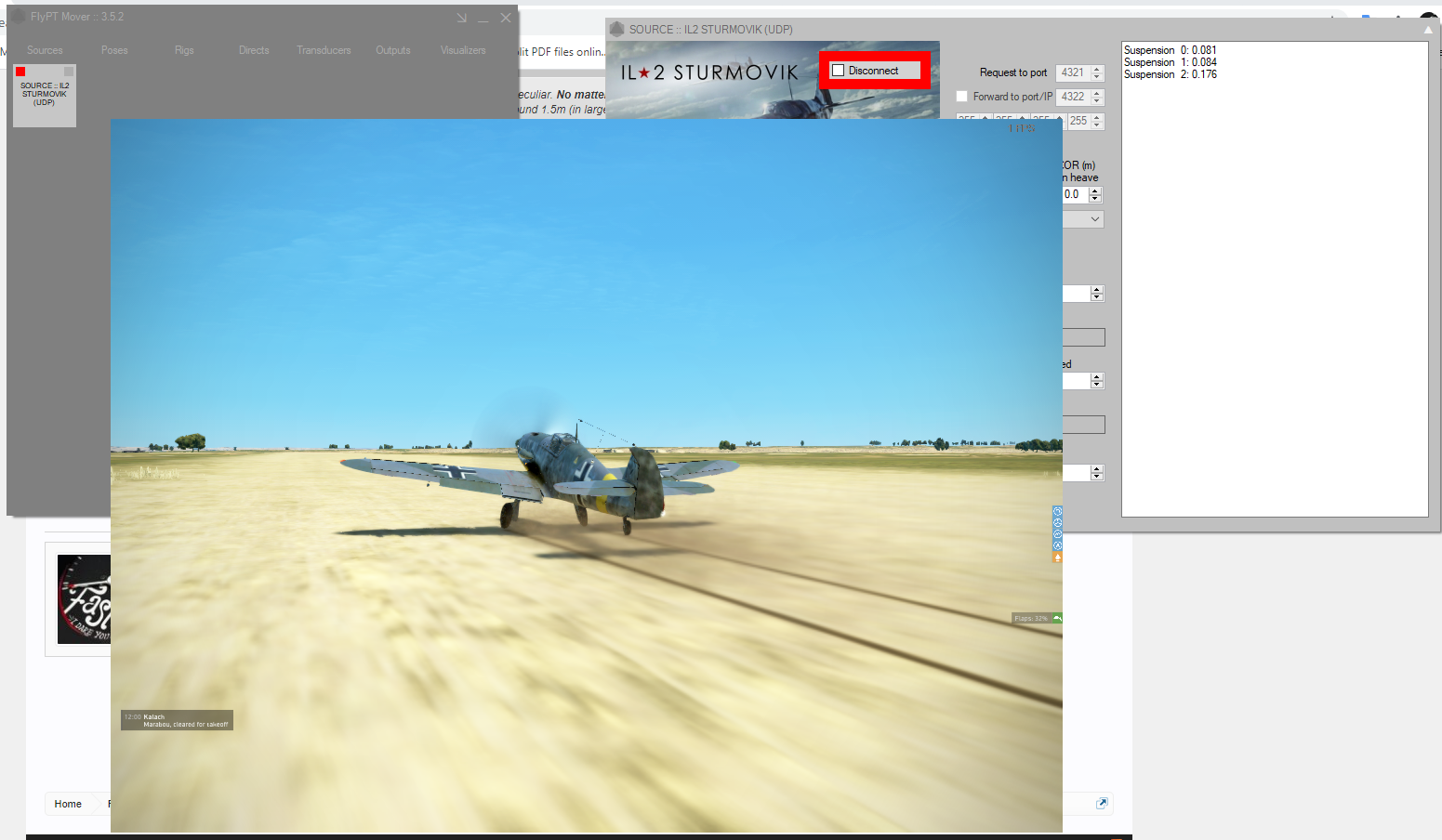

    +2,707 / 17 / -0

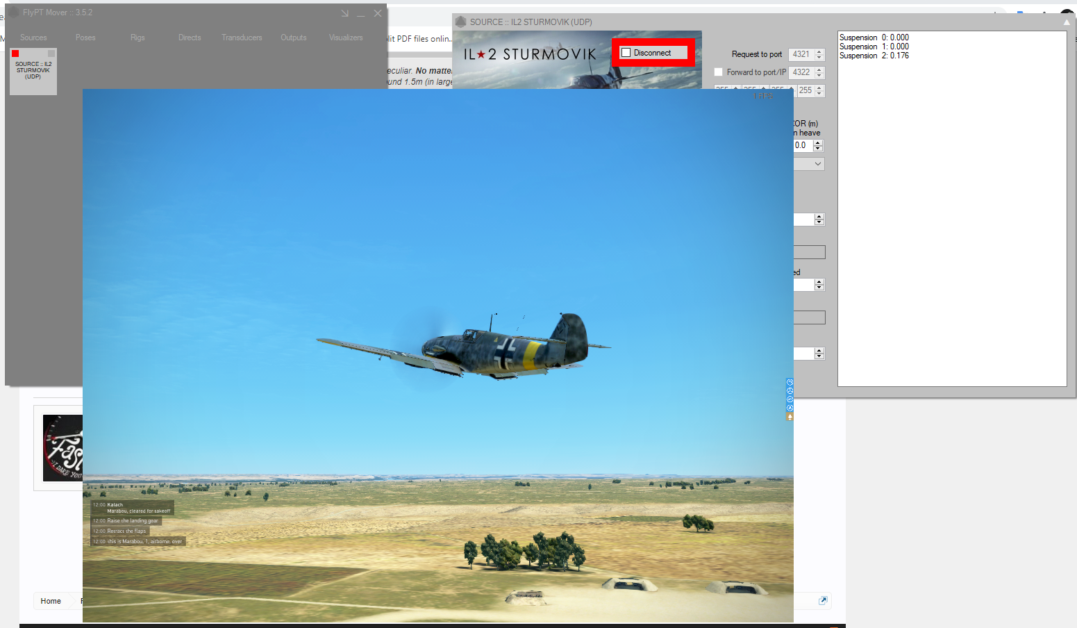

    The values are high, like 0.176 for a rear wheel, when we have the front wheels at 0.01.
    Still on the track (lifted rear wheel):
    In the air with landing gear:
    In the air with retracted landing gear:
    Same mission restarted, now with value zero... :

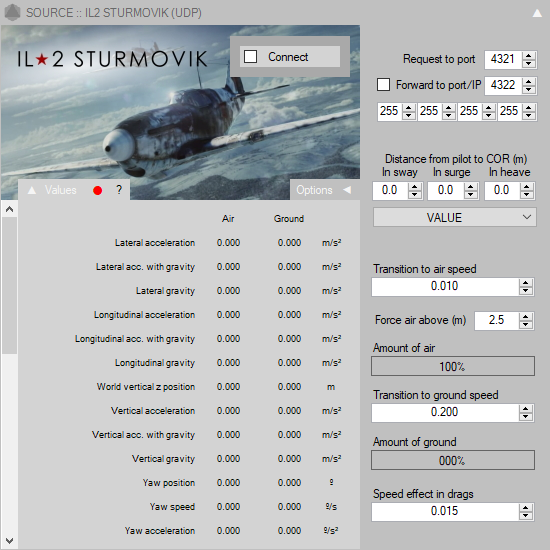

    Done:
    Now we can force air above a specific altitude above ground.
    Could it be they have more data available beside this?
    We are still missing so much info.

    Mover 3.5.2
    Downloatd at: https://www.flyptmover.com/downloads
    - Removed message showing when sharing setup (was for debug).
    - Replaced the DCS Lua. Please update the file. There was an error in the file and a bug in Mover, now solved. DCS must connect now.
    - Setups now save the data used for sharing (not the password), so when opened the info is there.
    - Solved problem caused by some chars when sharing setups.
    - Updated links in Thanos output.
    - CSPLINE and LSPLINE with 3 decimal places in the fields.
    - Review of IL2 air/ground. It's now working correctlly on my tests.
    Added a force air altitude. You can specify that above a specific altitude, ground to air is forced (default is 2.5m).
    This avoids a problem in the suspension data of IL2 forcing ground sometimes.
    - Replaced AWAY filter by the WASH filter.
