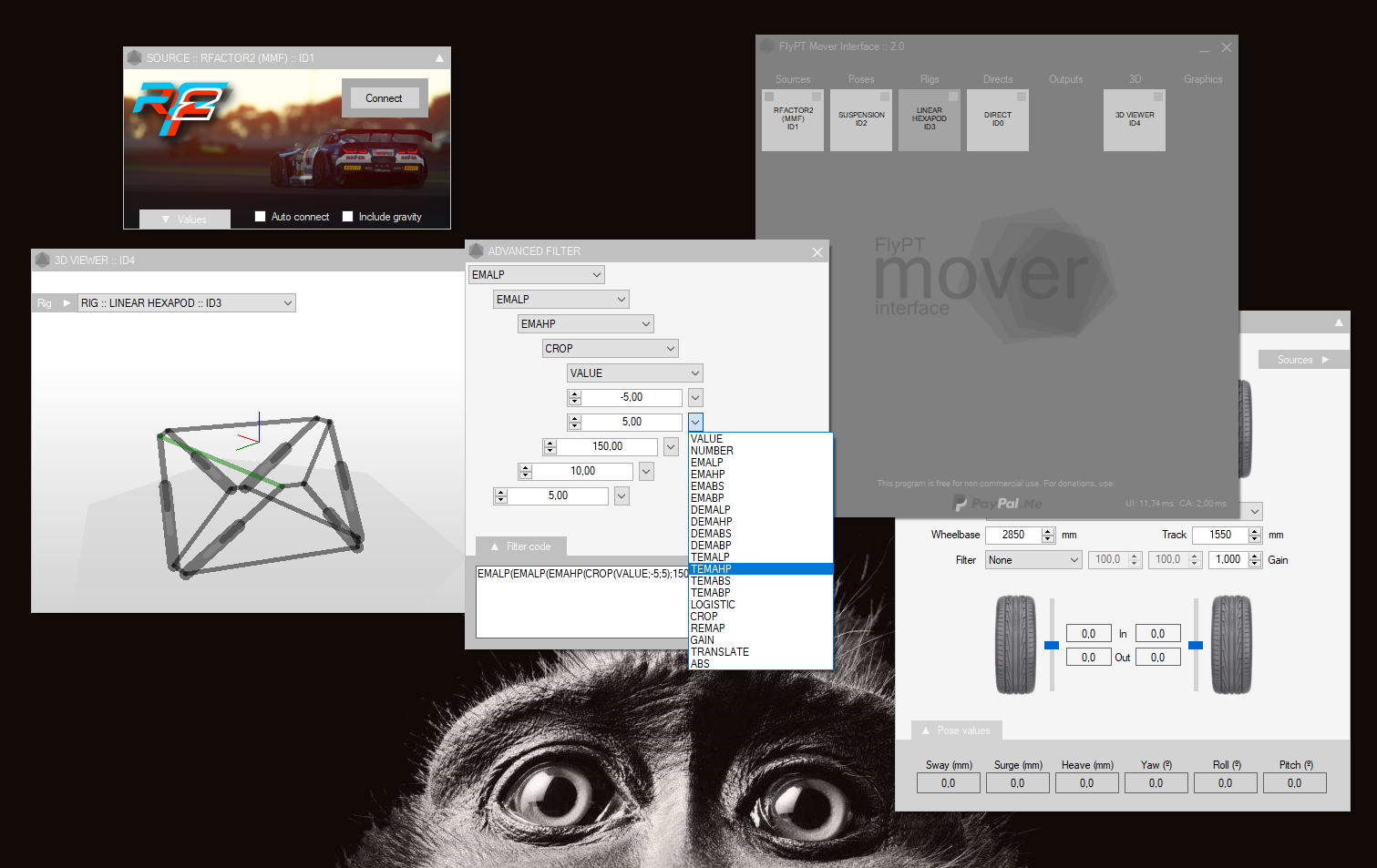

    FlyPT Mover 2.2
    Go to first post for download.
    Changes:
    -New feature in XPlane11 ground source
    -Corrections on Dirt Rally sources (directions and units corrected)
    -Corrections on RFactor2 source (directions corrected and suspension accelerations removed data was suspension load)
    -Corrected problem where "keep on last possible position" was not working
    -Added auto start in outputs
    -Added Motor torque and Stall variables to sources
    -New spike filter added to the advanced filter

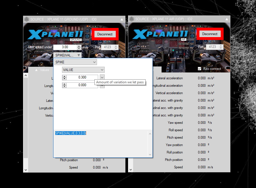

    @hexpod,
    Here's the new version.
    It's not going to work perfectly, but it's the first step.
    Stall can't be used for now, but it's already there.
    Same with motor torque.
    In the ground source of XPlane, you can filter the accelerations (can't choose for now) under the speed specified on the source. Sem nome.jpg
    In filters we have the usual ones, but there's also a new filter.
    The spike filter as three fiels:
    #1 the value to filter
    #2 the amount of value variation we accept - If 10, we accept variatos up to 10, they pass, the others are filtered with field #3
    #3 the amount of the value variation we want to pass - For example 0.5 means we let pass the value received, but only half of it. Zero doesn't let pass any value. It stays with the last one.
    Results: In the next post...

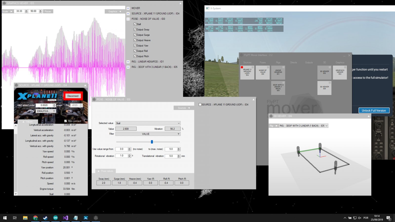

    Added a new module to generate pose noise from a value:
    This gives us the stall feature you requested.
    All seems to work, but there's a small problem with connections on the XPlane11 source.
    I'm working on it. When solved, I will post a new build.

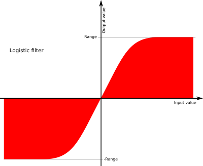

    -Added a new pose module: "Pose from noise of value". Generates noise from a selected value:

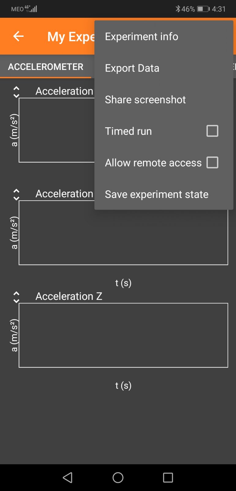

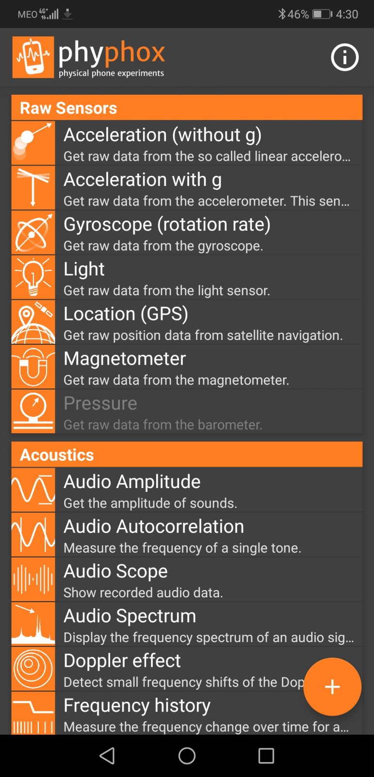

    How to use PhyPhox:

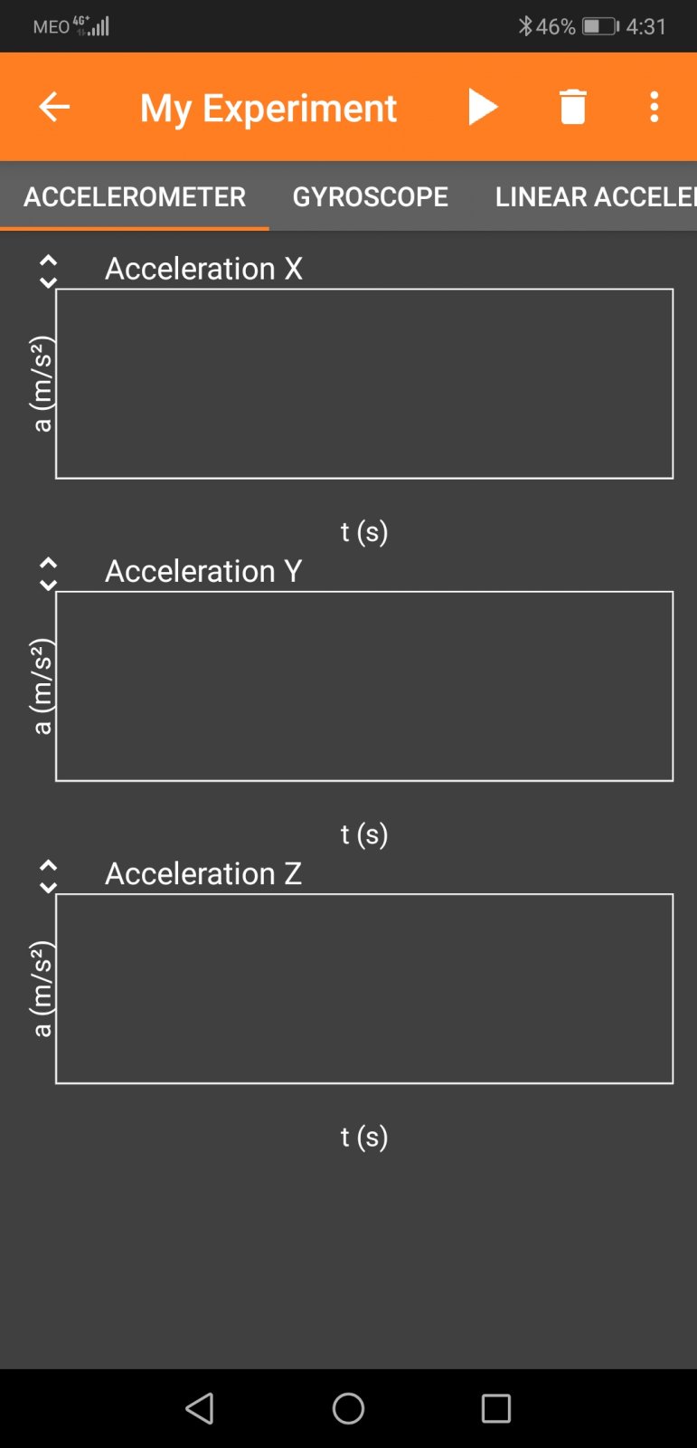

    PhyPhox is an Android and IOS(?) application that allows us to store and send data through Bluetooth and network to the PC.
    For more info, please visit: https://phyphox.org/

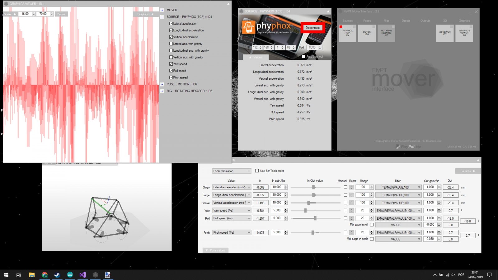

    With this source, you can capture data from the phone and reproduce in the rig the movements of the phone.
    It sends linear accelerations (with and without gravity) and rotational speeds.
    Since we receive speeds, we have to use filters to make the rig stay at least some time at the rotation we put the phone.
    Please use as a base the setup file I put inside the zip in the examples folder. (File->Open or drop in Mover)
    To setup the phone:

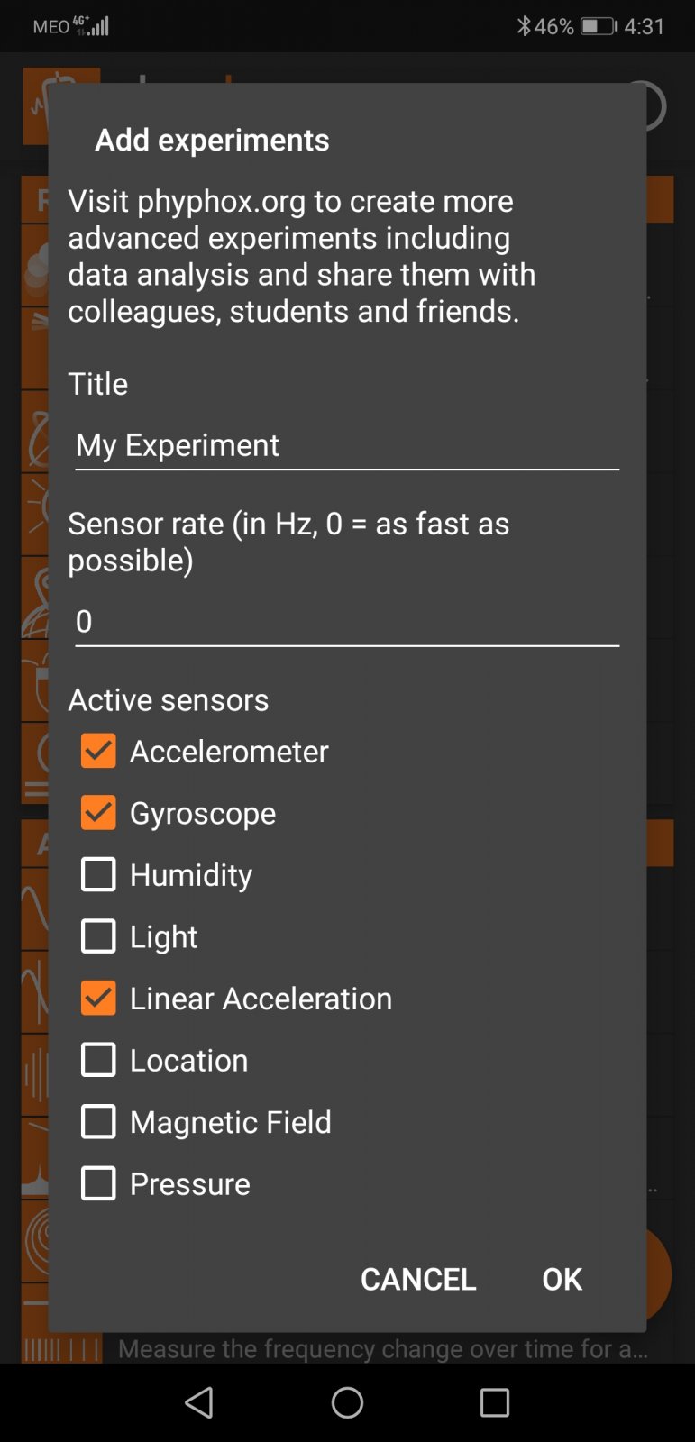

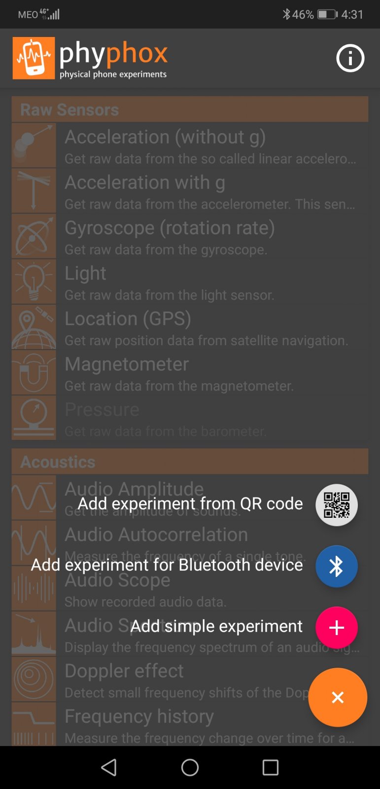

    #1 Instal an open PhyPhox
    #2 Press the + circle in the lower right circle
    #3 Press Add simple experiment
    #4 Check Accelerometer, Gyroscope and Linear acceleration.
    If you want to, click on the "My Experiment" to change it's name. You can call it FlyPT Mover.

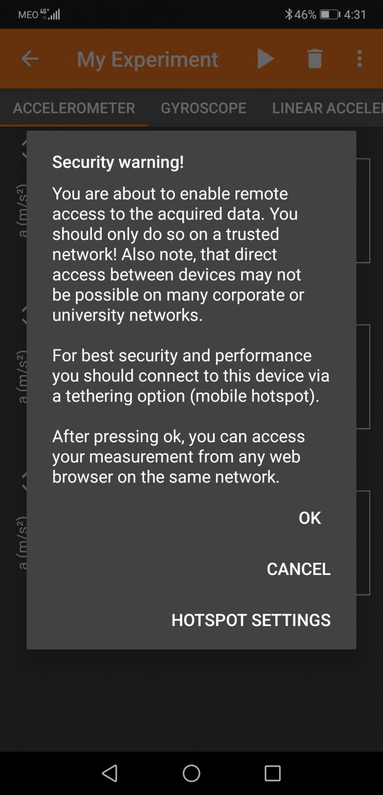

    #5 Click on the 3 dots on the top right

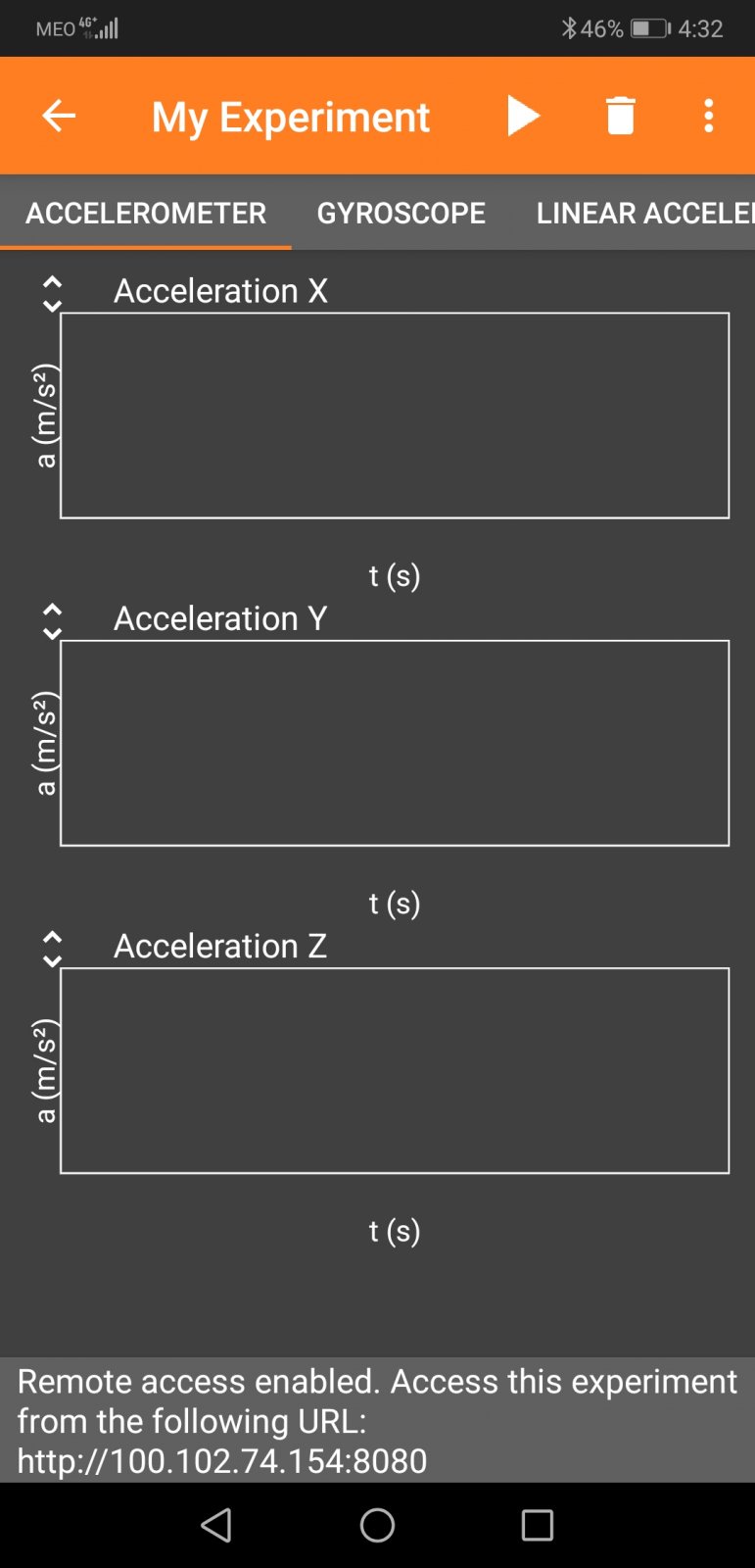

    #6 Check allow remote access

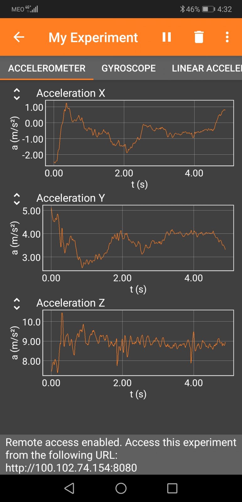

    #7 Accept the security warning
    #8 It should appear the IP and port used for communication.
    Use those values in the FlyPT Mover source.
    #9 Now press the start button at the top, and you are now sending data to the indicated address.
