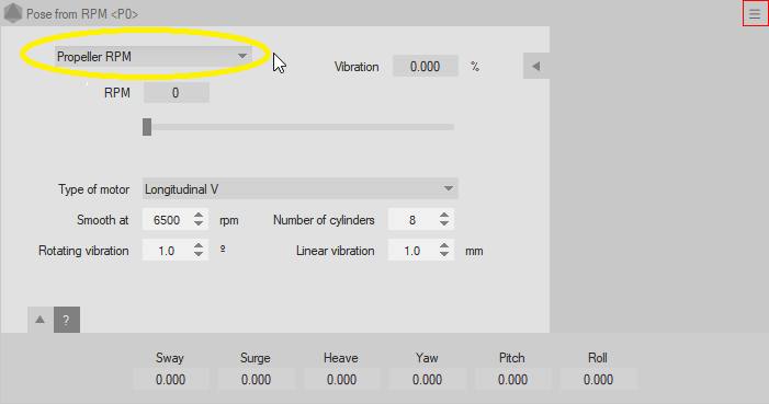

    I also have a feature request:
    Would it be possible to have a choice-box in the "Pose from RPM" window so we can select the source for the RPM value? Currently it is fixed to "Engine RPM" which is perfect for car simulation. But for a helicopter the engine runs at around 50.000 rpm and thats not useful if I want to simulate rotor vibrations (usually 400 to 600 rpm).
    A filter/operation field would be even better than a simple engine vs. propeller selection. This way I could experiment with my own variables or formulas.

    Yes it's possible, that's the reason to have propeller rpm. It's missing on the UI.
    It would allow the use of both at the same time.
    And I will add a filter/operation also.

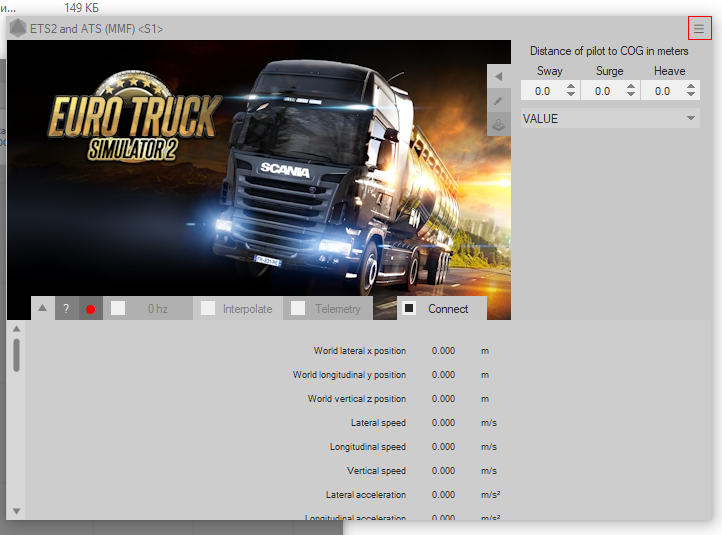

    Hello, while building my 2DOF platform, I encountered a problem with my ETs2, which I used to test the motors and connected. The FlyPT_ETS2_AMTS_MMF.dll file stopped working after upgrading to the new version. Everything worked fine with it before. Now, the connection indicator isn't even lit. upload_2025-11-17_19-12-14.png

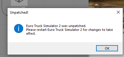

    There's a new dll.
    In the source window, you have a button to patch ets (pen icon) at the top right. This is going to install the updated dll.
    Before. Not sure, but i think you can keep both dll, they use different memory files.

    Sorry for my English, I'm using a translator. Yes, I did as you said, thank you. But it still doesn't work, and I don't even know what it's related to.
    I also don’t know how to respond to your message specifically, so I’m sending it separately.

    Do it again to put the new patch.

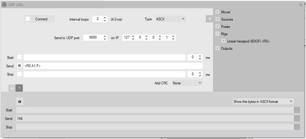

    Hi @pmvcda! Currently I am working on the CAN-bus-communication between FlyPT mover 3.7.0.9 (UDP-output) and my Odrives via an ECAN-E01S. In order to get the right CAN-masseges, I had to make a python-code, that makes the right packages. This is working now. BUT my current problem is the handover between the FlyPT mover and the CAN-bridge during starting or disconnecting the outputs. The problem is, that the UDP - output values do not follow the real movement of the real rig. The real rig is going down to value 0 (zero) during the transition time, but the sent position of the UDP output stays in the middle of the actuator range (the driving-position). Pls. see following screenshot. The same thing is with the 3D view. this stays also in middle-position.
    This behavior can cause big jumps from zero to middle-position. Also introducing an aditional transition time in the CAN-bridge was not able to solve this problem.
    So my kind request for a modification is, to send the real rig-positons (optional) in the UDP output!
    Thanks! Wickie

    Can you try the latest 3.7.0.17?
    Should be solved.
    Download link is in the first post of this thread
