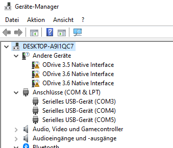

    Hi @pmvcda
    I have a consistent problem with Mover3.7 recognizing the correct USB-ports. Maybe this is a Problem with my PC, but maybe not.
    Although I saved mover with the COM-ports, at next start of my PC, Mover tries to connect to com 16 instead of the correct com 3.
    For information: there are no hidden connections
    Maybe you can help?
    Thanks!!

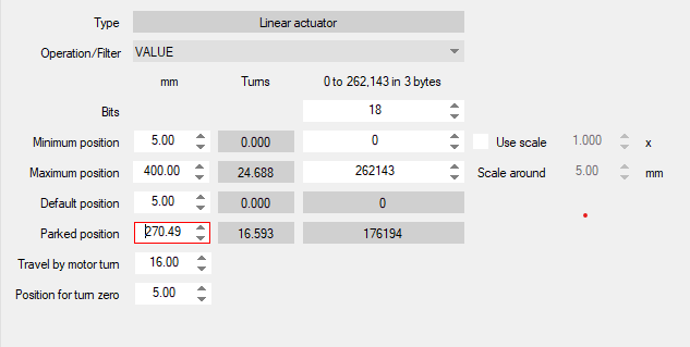

    Hi @pmvcda!

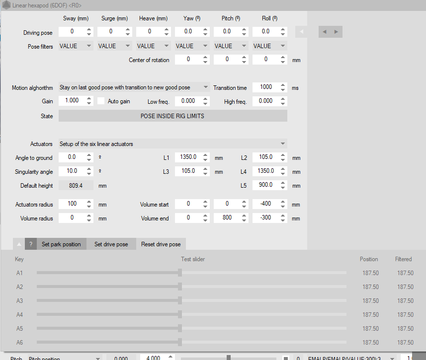

    Again I have one Topic, I kindly want to ask you for checking:
    I found, that I can not set the parking-position permanently.
    I tried to do it in two different ways:
    1: I moved the actuators to my prefered parking-position near the full retracted postion. Then I pressed the "set parking position "button" in the rig-window. Then saved.
    2: Inside the rig-window I open the actuator-setup pop up window and adjusted the parking-position with help of the up/down arrows manually. Then saved.
    In both situations, the parked position is not saved.
    Edit: It seems, that saving-funktion is a wider topic: I also cant save changes in other windows??? Hm...
    Edit2: I double checked everything, bootet my PC, started the mover.exe directly from the directory where the settings files are, but no success....
    Edit3: I get quite often frozen Mover-windows with the new Mover

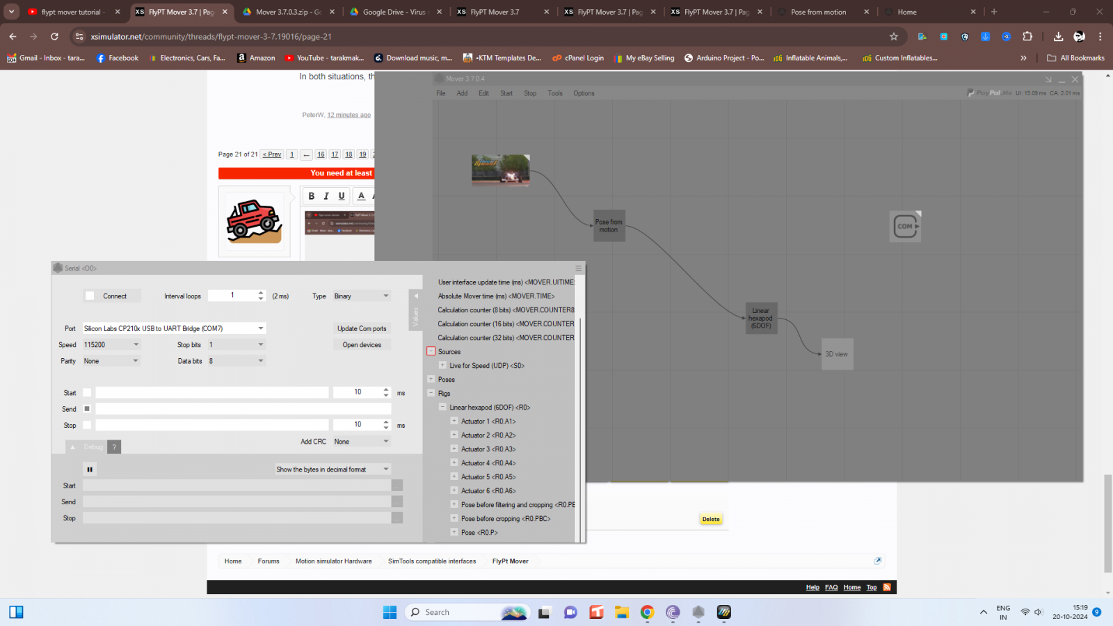

  5. Tarak Makwana
    Tarak Makwana aimbug Gold Contributor
    Mar 14, 2024
    - 1Coins

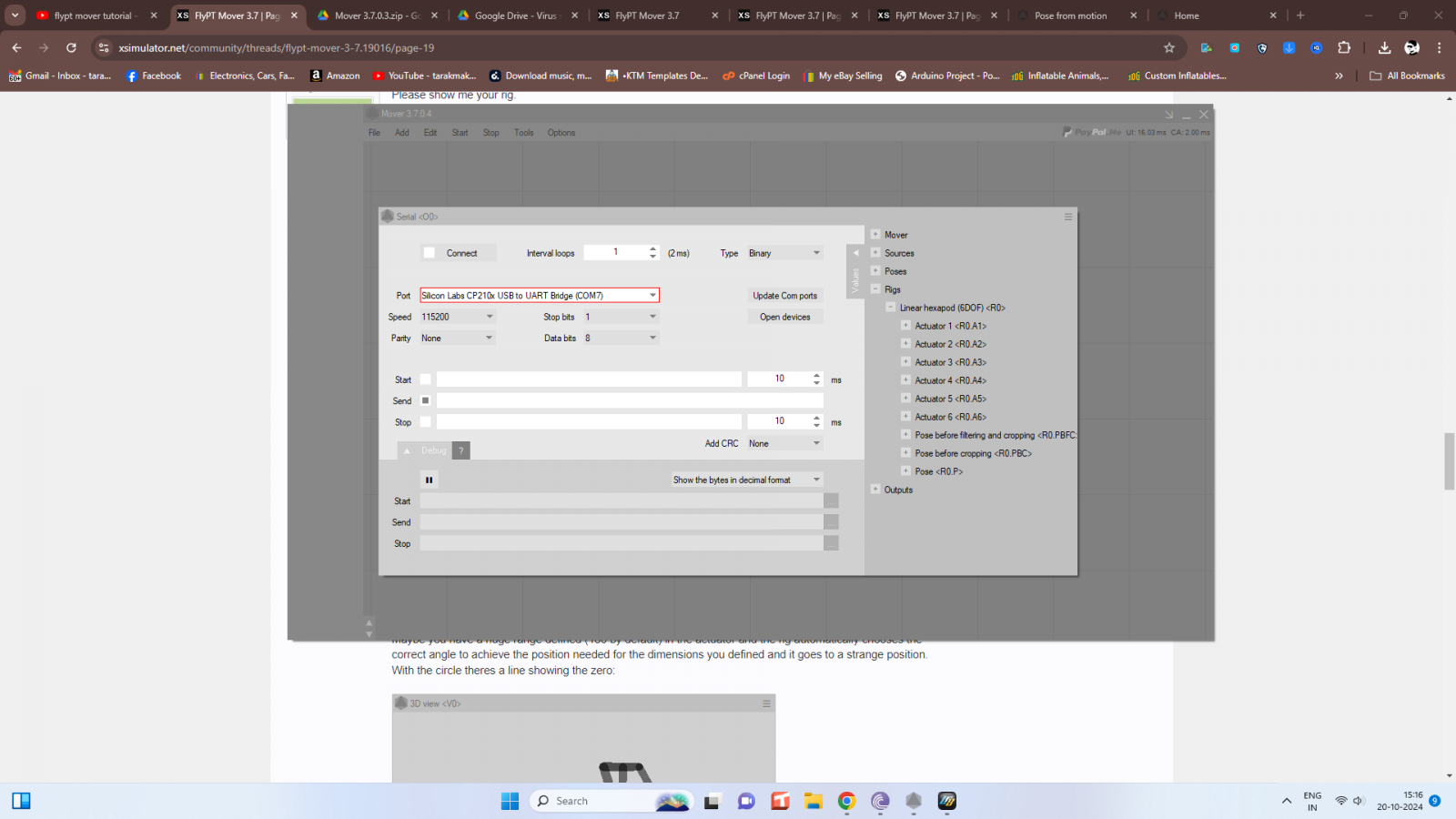

    Please help me
    i am using the linear hexapod 6Dof what values i have to put in send i am confused
    here is what i did
    using esp32 setup com 7 and com 5

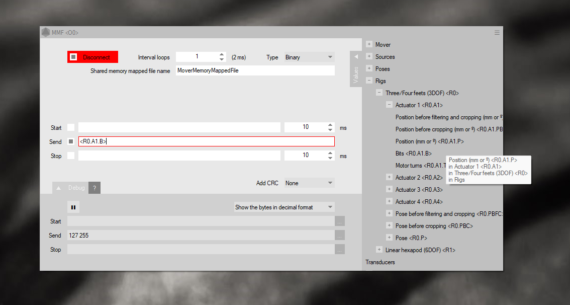

    The new output strings
    Mover 3,7 uses a similar output string to the previous Mover.
    But there's still some significant differences.
    Here's some examples of old Mover to new Mover strings:
    This is for rig R0, you might have others defined (yes you can have more than one, one for TL another for pitch/roll...)
    ESP32 FlyPT string (binary and actuators 15 bits)
    In Mover 3.5.2 for board 1:
    In Mover 3.5.2 for board 2:
    In Mover 3.7.0.x for board 1:
    In Mover 3.7.0.x for board 2:

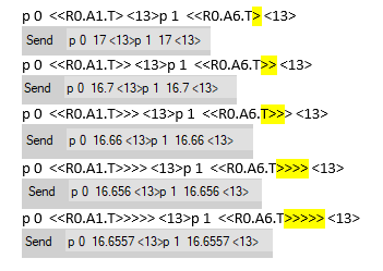

    Official ODrive firmware (decimal/ascii with motor turns)
    This firmware uses turns and the 5 > gives you 5 decimal places to increase the resolution.
    This allows you to use the full resolution of the encoder (e.g. max. 8192 cpr for the quite common AMT102).
    (by @PeterW testing here: https://www.xsimulator.net/community/threads/flypt-mover-3-7.19016/page-21#post-251496
    SMC3 output string (decimal/ascii and actuators 10 bits)
    In Mover 3.5.2:
    In Mover 3.7.0.x:
    Thanos output string (binary and actuators 16 bits)
    In Mover 3.5.2:
    In Mover 3.7.0.x:
    You might not have actuators 7 and 8, replace any actuator not in use with <0><0>, it would be:
    In Mover 3.5.2:
    In Mover 3.7.0.x:
    Motion4Sim Direct Mode output string (binary and actuators 24 bits)
    In Mover 3.5.2:
    In Mover 3.7.0.x:
    You might not have actuators 7 and 8, replace any actuator not in use with <0><0><0>, it would be:
    In Mover 3.5.2:
    In Mover 3.7.0.x:
    Motion4Sim can use CRC check now, for that, select CRC-16 and the string should be (remove last two bytes):
    In Mover 3.7.0.x:
    Motion4Sim Position Mode output string (binary and actuators 24 bits)
    In Mover 3.5.2:
    In Mover 3.7.0.x:
    P0 would be the pose, you can also replace P0 with R0 of a rig
    In Mover 3.7.0.x:
    Notice that Axis1a is replaced with a variable of type R0.A1.B where:
    R0 is the key of the rig module
    A1 is actuator #1 of the rig
    B means bit value (P would be position in mm or º and T turns of motor)
    For more info on variables, see this post.
    You can use the treeview on the right to check all the values you can use on the string and drag/drop them on the string field.

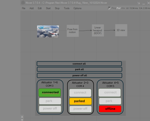

    I want to make a proposal for the user-interface of the outputs. Please see this only as a suggestion and possible improvement (from my point of view) and not as a criticism of your wonderful software!
    During testing I sometimes I wasnt happy with using this buttons/windows.
    Why?
    => On the main page you can not see which actuators (Numbers) are connected and to which COM-port they belong. To see this, I have to open the window. Some times I have to move the windows around to be able to completely see the whole window, sometimes it is hidden behind some other windows. Sometimes its simply fighting for the limited space on my screen.
    => Once set all the settings in the output-window, I can see no reason, why to open this window again and again, only to start the outputs
    Maybe this is stupid proposal and I didnt understand your user-interface; but maybe not ;)
    So this is how I would propose to show the COM/outputs-Windows:
    (Proposal for three COM-outputs for three Odrives in a 6DOF):

    sir my actuator goes all the way up i used this values
    <255><255><R0.A1.B><R0.A2.B><R0.A3.B>
    <255><255><R0.A4.B><R0.A5.B><R0.A6.B>
    please if possbile can you send me the .mover file or setup for LFS

    Well, it's on my list to add multi outputs for serials, not only because of rigs using more than one controller (mine), but also because of belt systems, fans...
    I did nothing yet, but i need to. The idea of it being in the diagram is for 4.0, where everything is visible on the diagram.
    What i'm considering also is a viewer (my prefered solution for comercial reasons) module connected to the selected outputs to show everything and have the connect/disconnect there. Could be like your design, seems good. Outputs still exist, but you don't need view them

    Hi all Odrive-users who want to use the official Odrive firmware. This firmware sends the position in turns !!! So, to get the full resulution of the encoder (e.g. max. 8192 cpr for the quite common AMT102) you have to set the correct output-string that enables enough decimal places. This was discussed some times before here in the chat, but I still was not sure about the correct string.
    So in order to be 100% sure, I tested the outputs like following. I increased the ">" step by step from 1 to 5 and had a close look to the resolution (see: https://youtube.com/shorts/vKHpJgJGMDo?si=0nq0FZB-Lp1QMiRy).
    I saw that the resolution increased from "super rough" to "super smooth".
    here is the output-test-sequence you see in the video.
    So the last output-string ist the best in my opinion.
