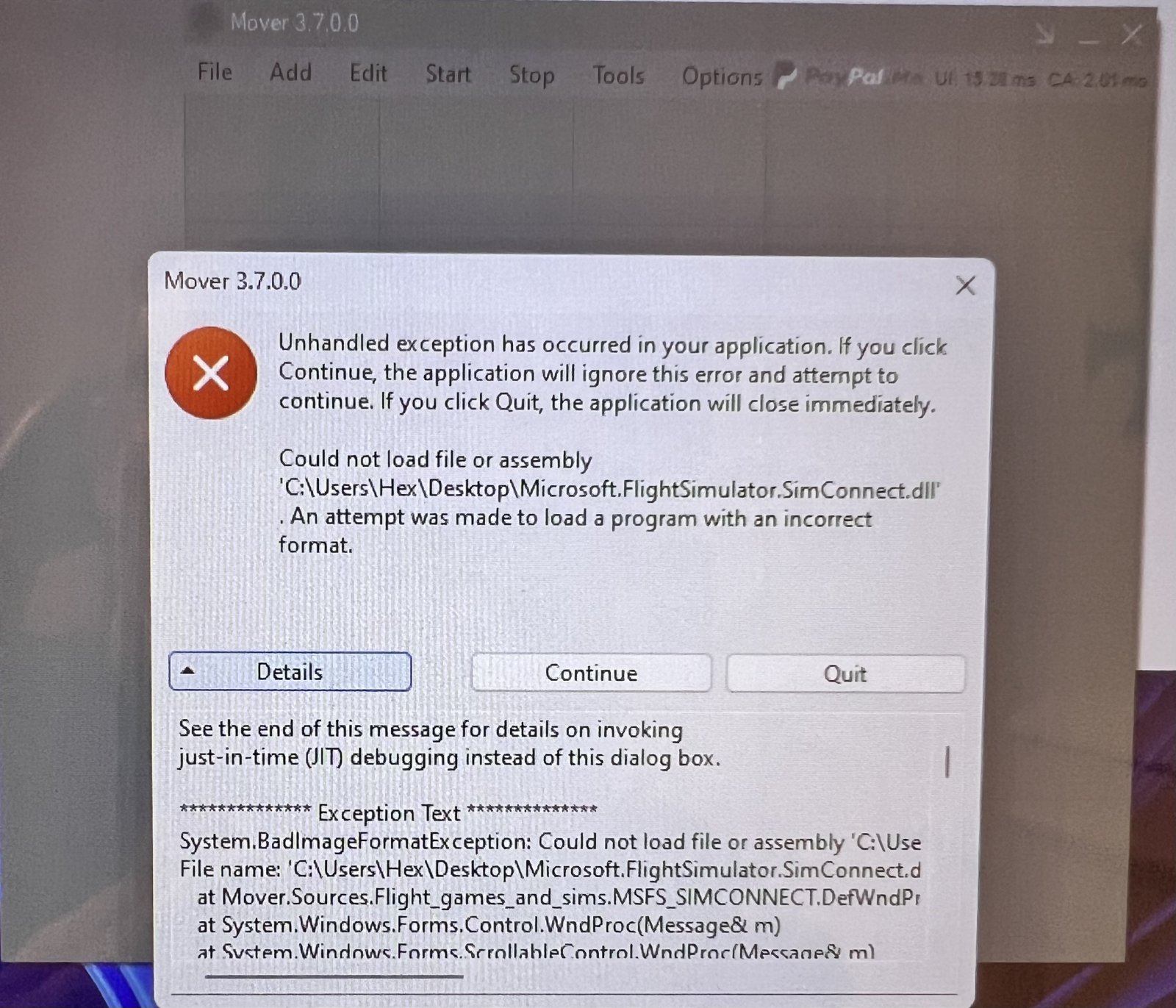

    should the download include more than the exe? when i try to add MSFS source it crashes becuase it cannot find simconnect.dll. I tried copying one into the folder but still no luck.

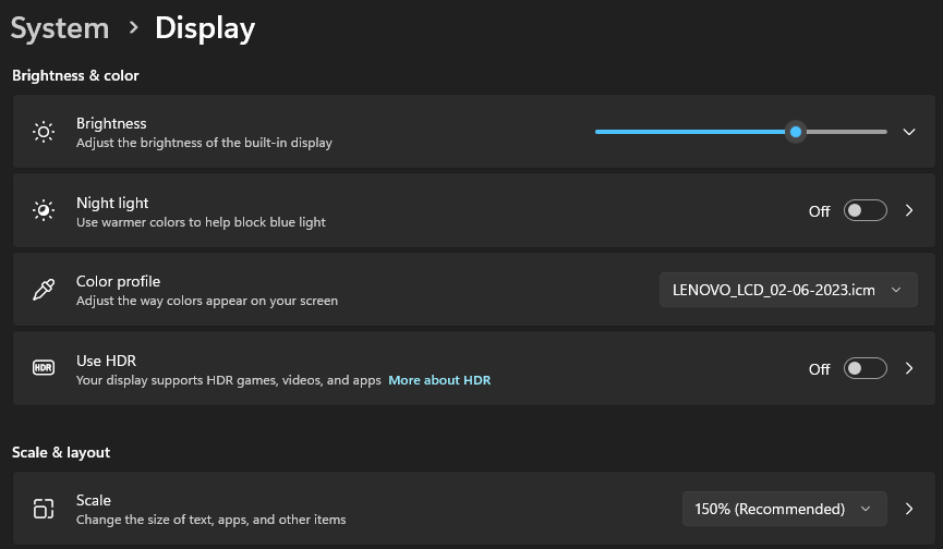

    Set Scale to 100%, start Mover, everything looks good/location of fields and sizes are correct.
    Shut down Mover, change scale to 150%, start Mover, add a Pose or a Source, position and size of fields is incorrect.
    Also, if you load up a previously saved setup the monitor positions will be incorrect/changed once the scale is changed.

    Simconnect problem, you can try to put in the same folder the dll
    Not sure it will solve, I'm having problems to include it in the exe

    I'm not doubting you, but on my side it's ok, tested in two PC's
    Can someone else try please

    Only thing is that I have a dual monitor setup, one is a 4k built-in (laptop, running at 150% scaling) and an external ultrawide running 1440p at 100% scaling. So this could be why I'm seeing the problem maybe?

    I will try on my rig tomorrow. I use two screens, one ultrawide.

    didnt work, also tried renaming it to 'Microsoft.FlightSimulator.SimConnect.dll' as shown in the error message

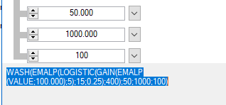

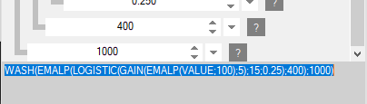

    poking thru some of the filters, seems the old WASH took 3 inputs while 3.7 only has one:
