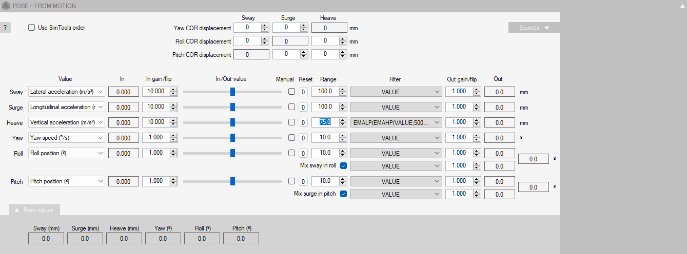

    In the modules of pose, put the filter in this field (heave filter):
    Change also the range in blue to 75:

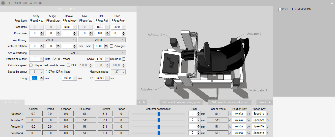

    In the rig:
    Change the one in blue to 75mm of range

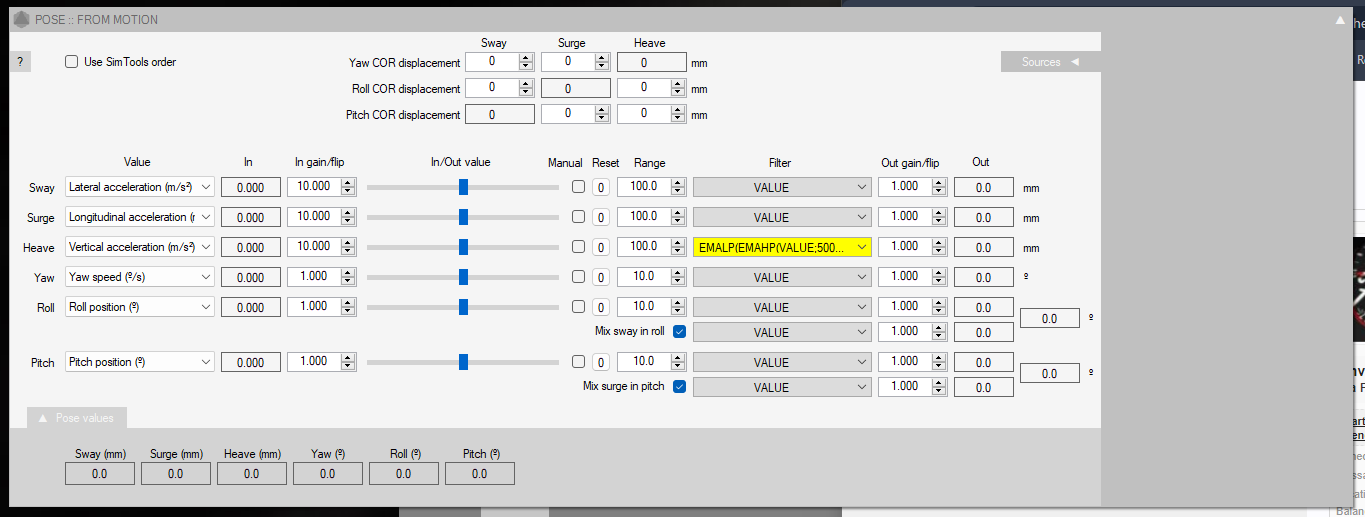

    I've been experimenting with the high-pass and low-pass filters, and it feels like a double-edged sword. When the helicopter touches down, I want the rig to absorb the impact without a harsh jolt, even though a real crash would be severe. Ideally, a crash should produce a thump rather than a jarring sensation.
    I've noticed that increasing the high-pass smooth while lowering the low-pass helps mitigate the harshness, but it affects the heave. The collective pull should be noticeable up and down, but without a jarring effect during a crash. I tried the 500/500 setting for air and ground, but it still results in a hard impact. I've also ensured that air is separate from ground. So ground isn't checked off in both poses. Additionally, in the L1 and L2 I put in the actual values of how far apart the actuators are spaced.
    Additionally, I've realized that the roll isn’t as pronounced as I’d like, and I’m unsure what adjustments are needed to enhance it. On a positive note, I had a lot of fun tweaking the RPM prop; it shakes when you start the helicopter until the RPMs stabilize, which is really cool.
