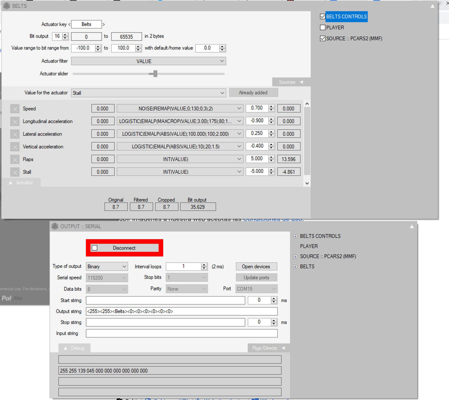

    Hello Gwiz, Thanks for the help...
    I have copy the setup of someone that has the same type of belt, and when I connect it to the Thanos board use to work... I just leave the things that I think are related to the belt and connect it to the Mega.. but nothing happened..
    I should have 2 buttons for regulating the initial tension of the belt, that's why there is stall and flaps
    What I'm doing wrong??... Sometimes the servo moves... but is just once in a while, buttons don't work.. just a few times had moved... If I connect it to the game... nothing happened
    THANKS!!!!
    P.S Picture is attached.. hope it uploads correctly

    Can you get the servo to move smoothly or at all with the actuator slider? Try increasing the Interval loops to 5 and see if that makes any difference. If you can get the servo to move over it's full range with the actuator slider, everything else will follow on from that and you will be able to get it responding to the game with the correct settings but the slider has to work first. If the servo moves with the slider but erratically, the bit range may be incorrect.

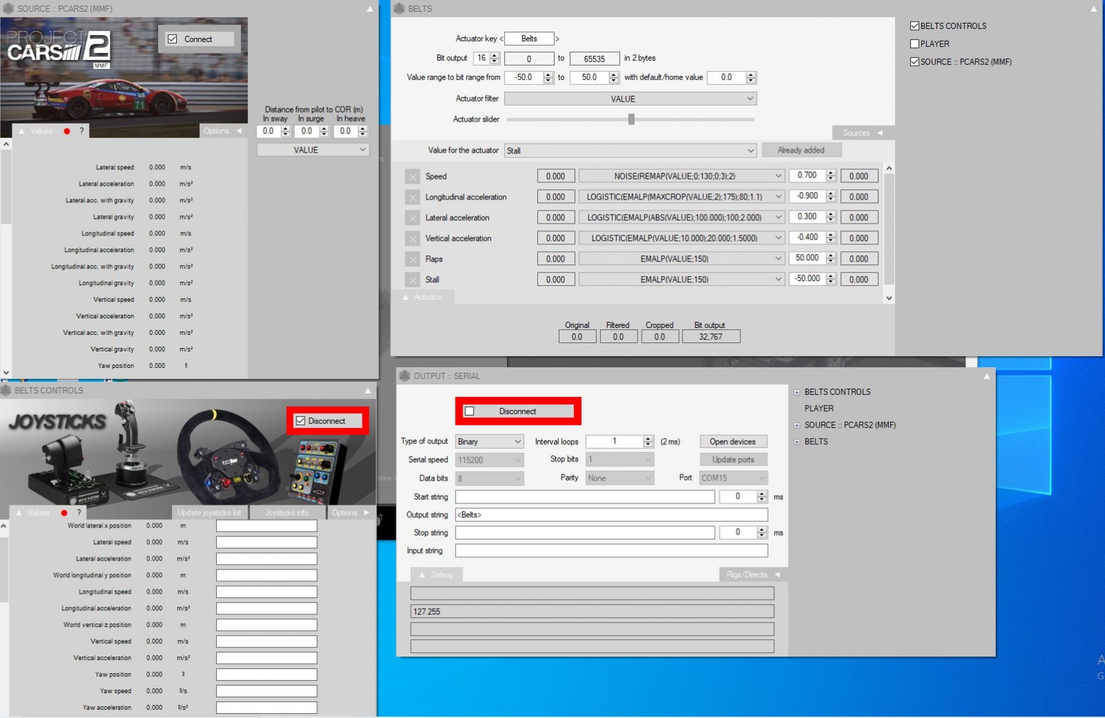

    -Can you get the servo to move smoothly or at all with the actuator slider? -> No
    -Try increasing the Interval loops to 5 and see if that makes any difference. -> that would be "Value range to bit..."? I have changed it up to -5000 and 5000... if it is the value of flaps and stall, I have also changed to near those values.. and nothing....
    Actually dont know what else to do...might be the Mega coding? It is intended to actuators... but this has to work with thise settings.. it should move!!!
    Im 100% lost...

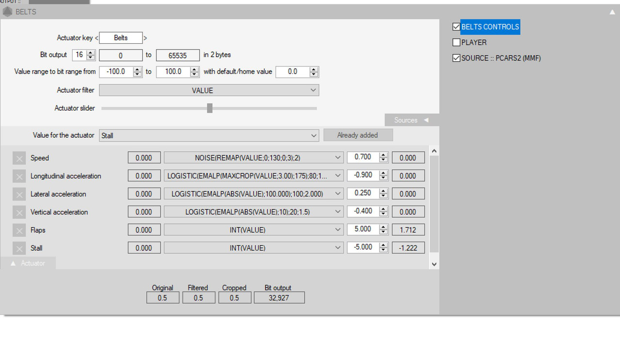

    Here goes a few pics.. Still not working... sometimes.. from time to time while I change values... it moves a bit...
    But without logic...
    Thanks!!

    Hi Rolo, Depending on what Arduino sketch you are using, I think it is expecting the values from FlyPT to be in a different format. Try changing the Output string to:
    <255><255><Belts><0><0><0><0><0><0>
    I haven't used the code by Cubexxx on the other thread, but it looks like it requires a couple of 255 values followed by 4 values of 2 bytes each (Belts will give 2 bytes). If this doesn't work, let us know what arduino sketch you are using and we might be able to figure it out from there. Assuming, this format is correct, you could also try <255><255><0><0><Belts><0><0><0><0> or <255><255><0><0><0><0><Belts><0><0> etc. This will likely work depending on what arduino pins are expected on the sketch to be used vs which ones you have connected.

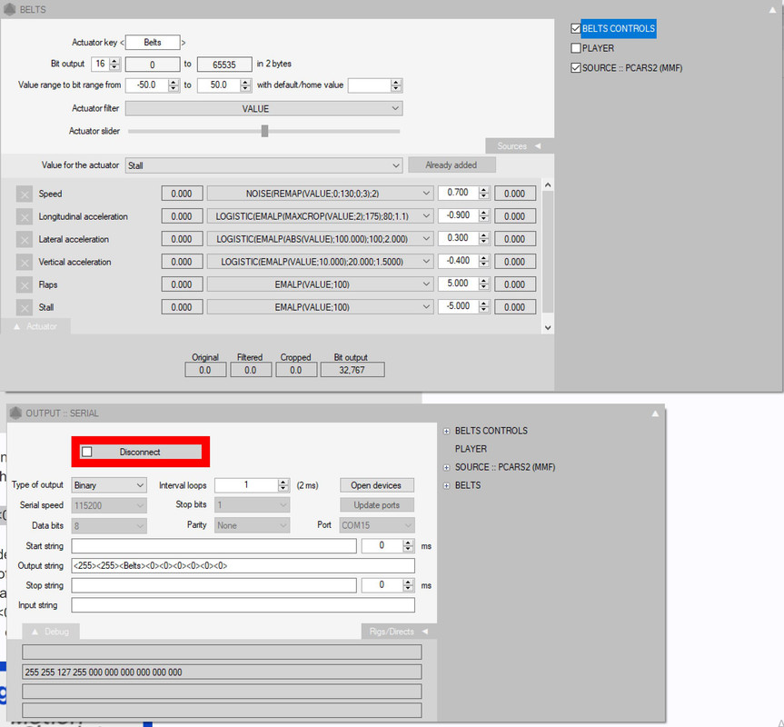

    Could also try <Belts><0><0><0><0><0><0><0><0>

    WORKING!!!!!!!!
    Thanks!!!!
    Now the second step... I have defined 2 buttons... one that tightens the belt and the other that loosens it....
    For that I define stall and flaps... they work, but when I release the button, they come back to the original position, how can I make them stay in the position and not turn back??
    Done!!! INT filter did the work.... Now I will try it... If I die suffocated is because I did something wrong
    Thanks... and sorry for the so inexpert questions!
