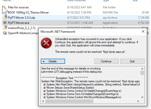

    Hi! New to FlyPT. Is it possible to use it offline (no Internet access).
    I´m getting a .NET error after starting it.
    21,337
    149,687Coins
    +10,954 / 54 / -2
    Can you please post a picture of the full .NET error.
  15. deadlymanager
    deadlymanager Member
    Mar 29, 2019
    38
    8Coins
    +22 / 0 / -0
    Just twice ignore this error and all be fine.
  16. eduardo.magnetto
    eduardo.magnetto New Member
    May 23, 2018
    8
    Buenos Aires
    83Coins
    That´s what I´m doing. But its not a nice solution, specially if I want to minimize interactions to start a simulation.
    Thanks anyway!
  17. eduardo.magnetto
    May 23, 2018
    8
    Buenos Aires
    83Coins
    Check image and the complete message below.
    Thanks!
    System.Net.WebException: The remote name could not be resolved: 'flypt.dynip.sapo.pt'
