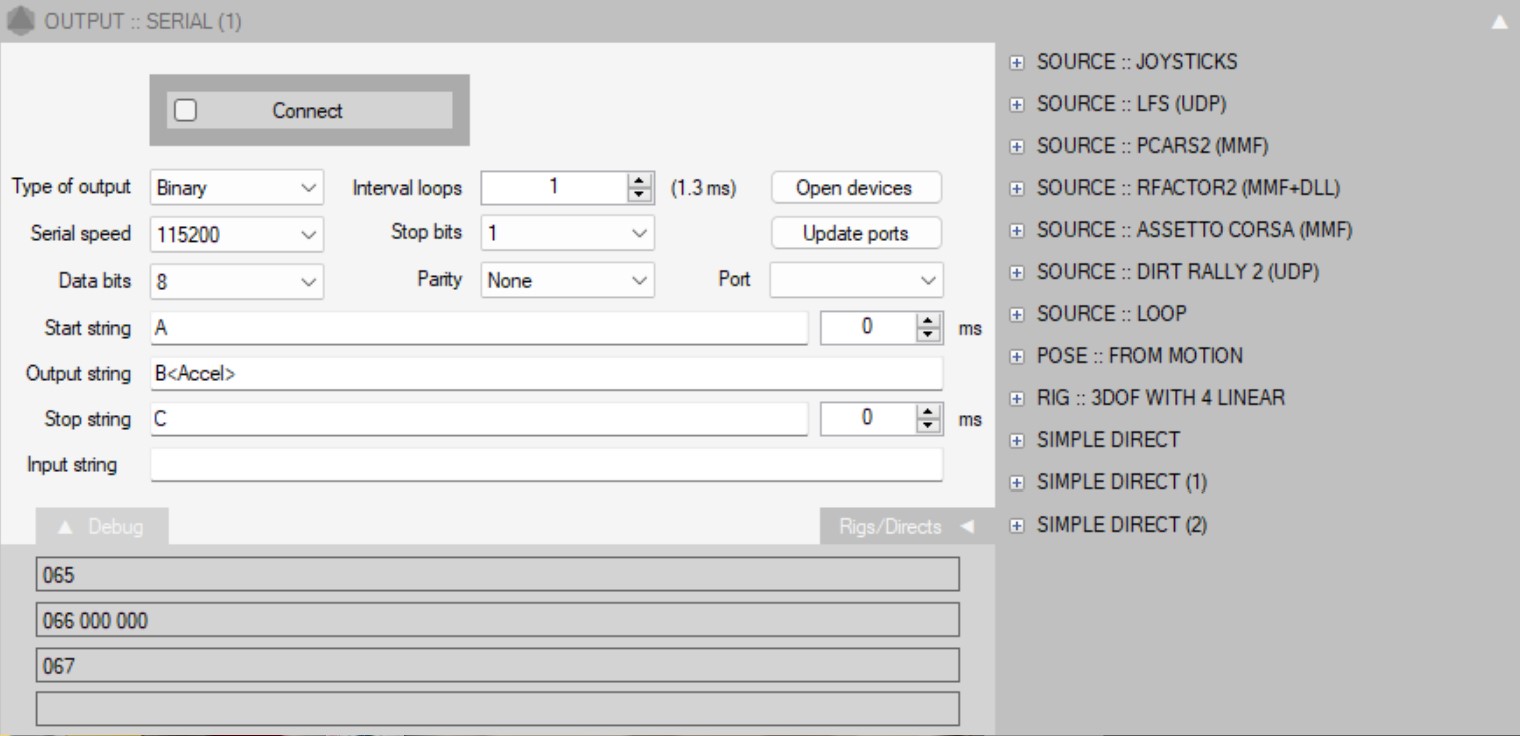

    hey @pmvcda ! I am working on a control box for my seatbelt tensioner, and latter my actuators (SRT80). I am using an arduino that connects to FlyPT through the Serial module :
    I want the control box to be able to "click" on connect. So I made my control box acts as a keyboard, and press "s" when I push on a button.
    But it doesn't work well... it shows a "error while trying to connect to serial...". When I click on "OK" it connects...
    I think that FlyPT starts to send datas before the arduino being ready to receive them... It's weird because the code is minimal :
    Code:
    Keyboard.press('s');
    Keyboard.releaseAll();
    It does the same if the control box acts as a joystick...

    oooh my bad...it was the second arduino that wasn't the right one so the connection failed :/
    I'm looking forward for the new versions :)
