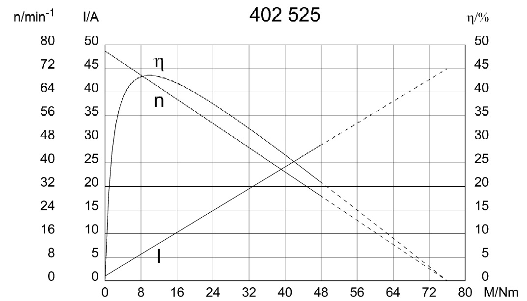

    I dont write it wery well :( .Stall torq. is how mutch torq. you have to apply to stop motor, than you have continuous and peak, you can have cont. stall torq. (for long time you dont burn motor) and peak stall torq. (for short time or you will burn it). For example DC servo (not RC servo) will have 0,2 Nm cont. and 2 Nm peak so you can overload motor to 2 Nm and with faster RPM moment will fall down. So wipers motors has for example 4Nm (in nominal RPM) but to stop them and hold you will need 24 Nm. RC servo have 2,5 Nm but that is for stall so if servo rotate it has mutch less torq.
    on this picture you can see curves for 8Nm (at 70 rpm) wiper motor, you can see (line n ) as rpm is go down torq. bigger (unil dash line (48Nm) its cont. but after that its peak).
