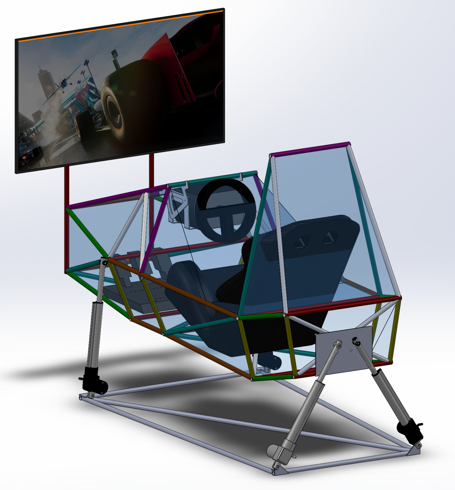

    As our senior capstone project, my team is building a motion simulator to lower vehicle operating costs and allow others such as prospective students to experience driving the vehicle. The design is nearly complete, featuring a full space frame and fairing for accurate look and feel, and force feedback and control loading wheel and pedals. We are currently designing mounting patterns for our 4 actuators.
    Image 2: SolidWorks Drawing of Space Frame and Approximate Actuator Positions

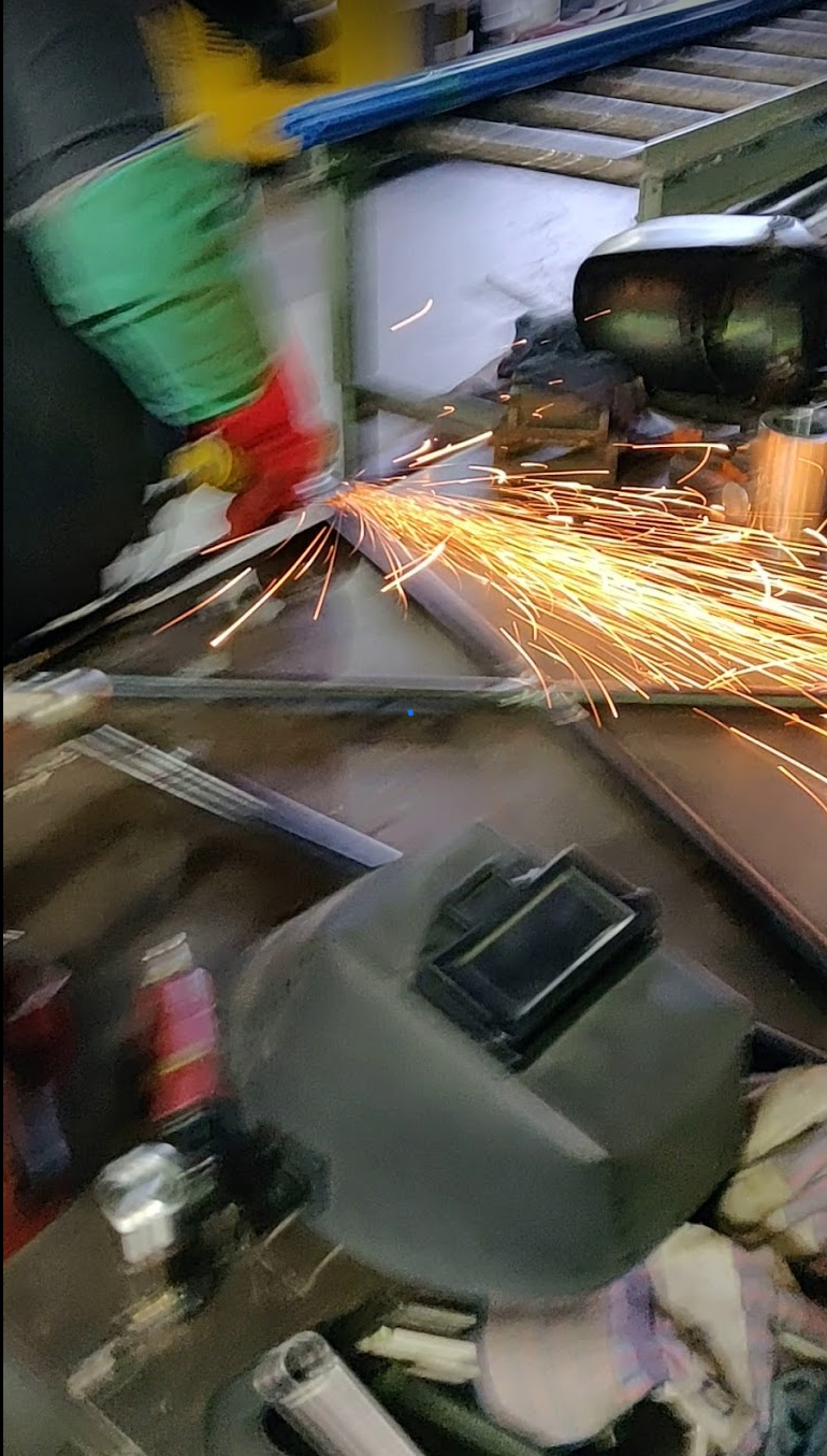

    We are beginning to fabricate the chassis, using 1/2" (0.84in.) steel piping, and will attach a PVC foam fairing once it is complete. We plan to use an Arduino Mega PLC with a 4-channel H-bridge shield to control the actuators.
    Image 3: Preparing a Section of Piping for a Weld

    It sounds like there will be a fair mass to control, what actuators are you planning to use?

    Yeah the ones depicted in image 2 are completely inadequate unless you're building a sloth simulator :D.

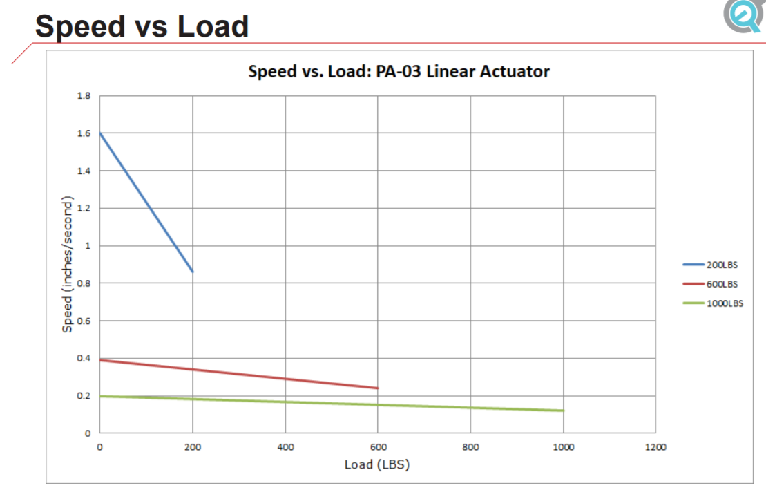

    The actuators are Progressive Automations PA-03. They can hold 200lb dynamic load each, with speeds between 0.9 and 1.6 in/s, depending on loading (see photo). The simulator, fully loaded with a 95th percentile male driver, is round 400lb, with the cg closer to the front actuators, since the rear are mounted at an angle. I agree they are not ideal, but we could not find anything better, given our budget.

    I would suggest you refine your project priorities a bit more specifically and be realistic about what you can and can't do within your budget.
    Is the priority good motion or external rig aesthetics? If it is the former then take a leaf out of the racers handbook - parts left out cost nothing and cause no service problems. In other words ditch the heavy cockpit and instead create it in VR as a game mod (depending on what game you plan on using), where there are no performance consequences. So build a traditional seat shaker or light weight full frame design.
    If the external aesthetics are the priority then at least minimise the mass, use carbon fiber or aluminum for the frame. I appreciate that has a cost implication, but that tends to be the trade off in motion sim building.
    If you can't or won't consider those two options then the quickest and cheapest way to throw power at it, to move that sort of mass, would be to look at AC motors: https://www.xsimulator.net/community/faq/vfds-and-3phase-motors.9/category
    Or perhaps on the DC side powerful winch motors: https://www.xsimulator.net/community/faq/dc-winch-motors-for-motion-simulators.151/
    You could always build actuators: https://www.xsimulator.net/community/faq/diy-linear-actuators.248/
