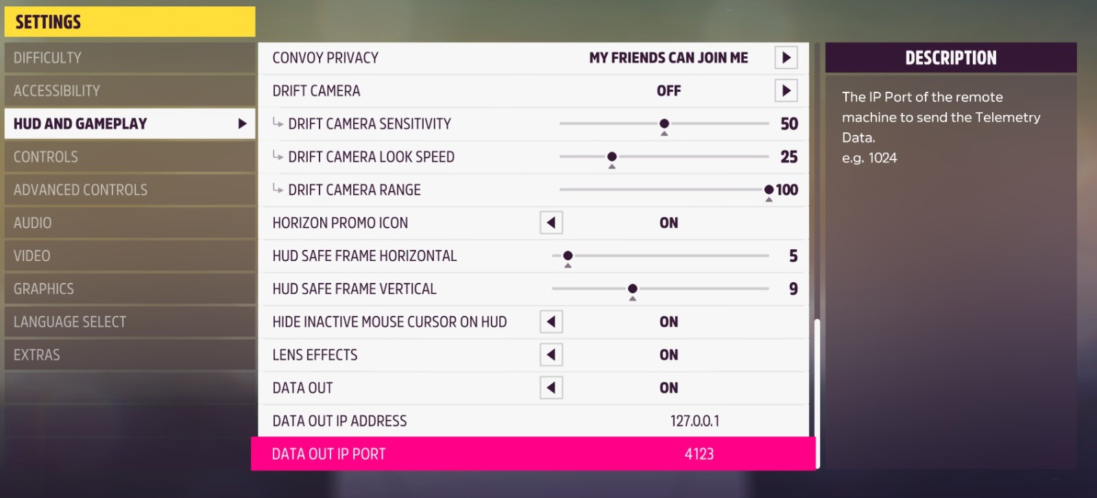

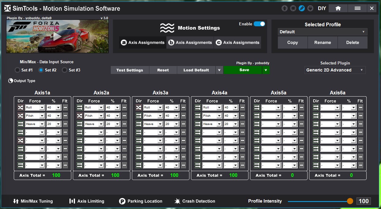

    Hello guys first time here and new to motion. I have aproblem with forza h5
    And sim tools there is adelay like 10sec to the movement and if i stop the car. And exit the menu. The motion keep moving
    All other games work fine only this with forza
  2. yobuddy
    51,367Coins
    +5,202 / 19 / -0
    I have only seen this happen when the UDP relay is setup for the game plugin, and all packets are sent back to simtools in a endless loop. If using the UDP relay, make sure you are not sending the data back to port 4123.
