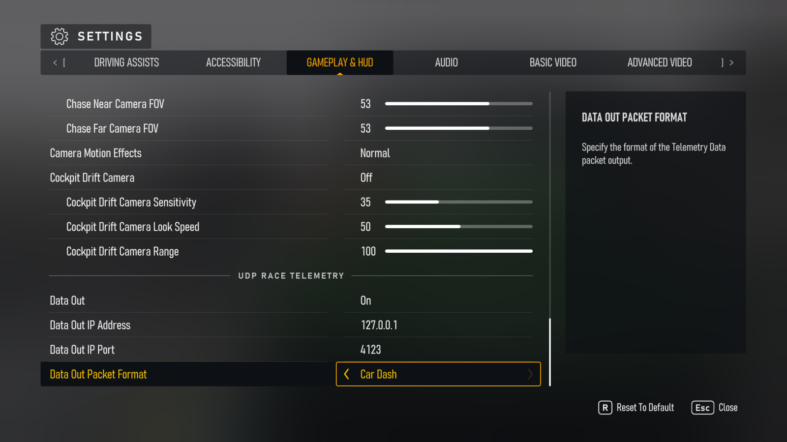

    no patch needed, Telemetry settings in FM: Data on, IP 127.0.0.1, UDP 4123, Format Dashboard

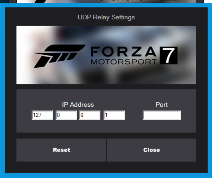

    Clear the ip and udp in the Plugin. Only in FM 127.0.0.1 and 4123. Then it works fine
    I use Simtools V3beta

    how u clear the ip and udp in the plugin in v3? don´t see the option

    I see now, let's try

    click on the network-symbol and press reset

    Forza horizon 5 works and also fm7 but no luck with forza motorsport m, it's not detected by simtools v3, u reset and then close? Or reset and put IP and port, and then close

    when u say "FORMAT DASHBOARD" its an option in simtools? or it is in forza motorsport ? couse in forza i only see the ip, the port, and two options: SLED or ACELERATION.

    Here's the settings & Im using Gamepass so the game is through Microsoft. Works well...... well better than the game :D
    They need to sort out their optimization, lets just say.

    i got the spanish language, so i think the problem is i have to put dashboard and ingame is called car aceleration maybe

    Yeah, I think there are only 2 options so just try it and give it a go. Worked for me with no messing about.
