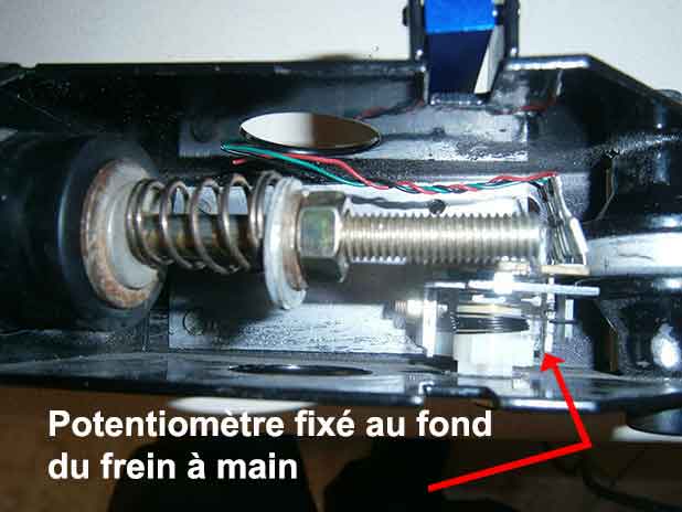

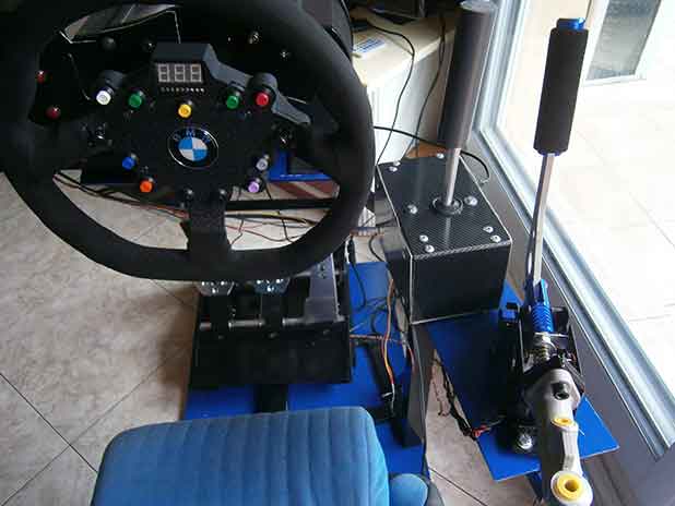

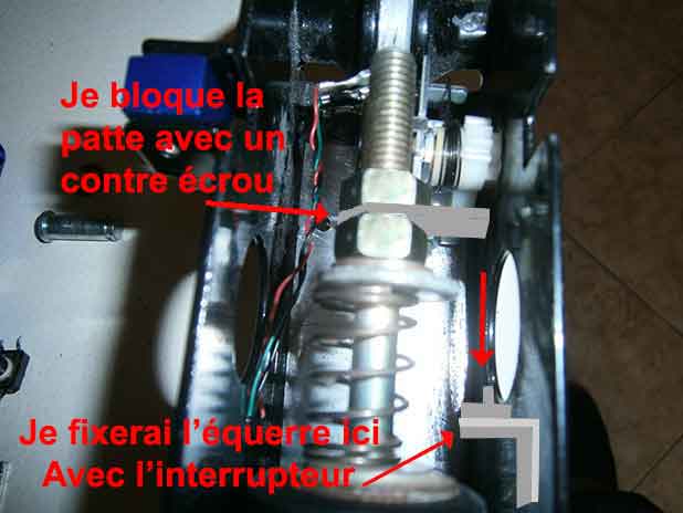

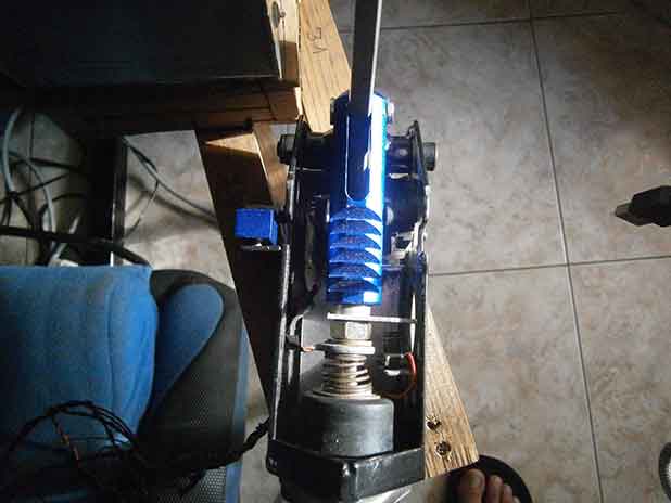

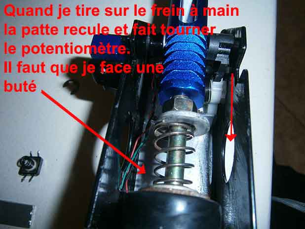

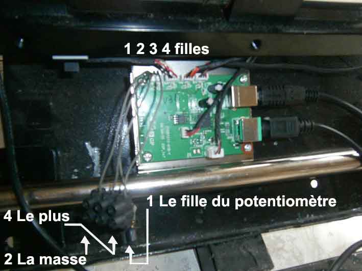

    hi, I made a vertical handbrake with a potentiometer and switch.
    Why a potentiometer for games like richards burns rally, which handles analog and switch to other games.

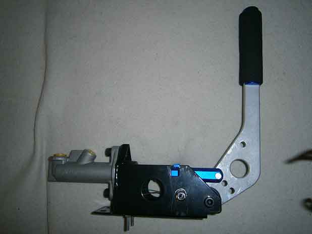

    I bought a brake on http://www.leboncoin.fr/equipement_auto/645047021.htm?ca=21_s

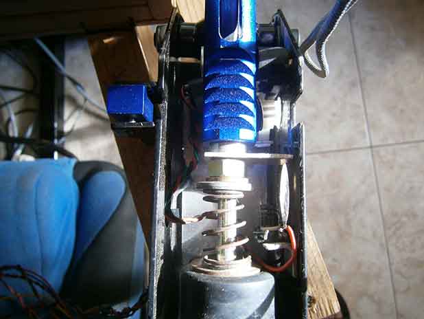

    and I adapted my equipment inside.

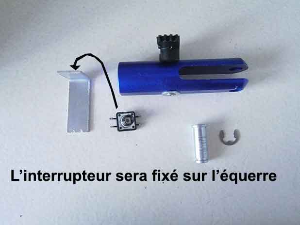

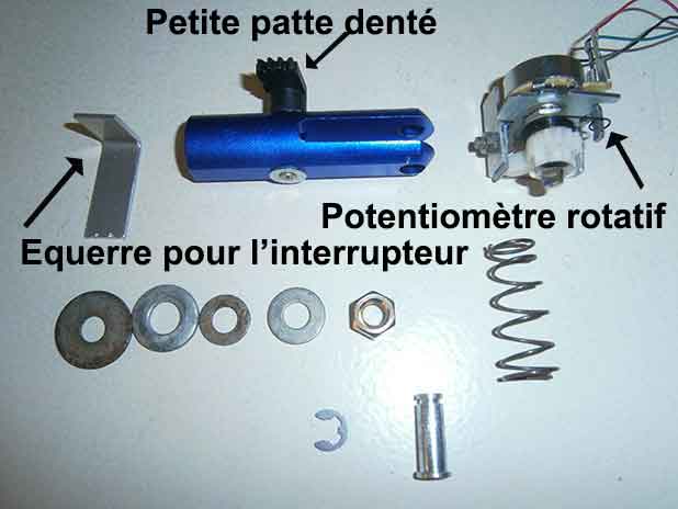

    I got a potentiometer in an old pedal with his system and a push switch in a computer store.
    A small plate and the aluminum electric wire.
    Here's the timeline here
    It reads all the clubsport pedals FANATEC v2
