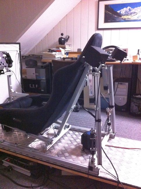

    I'm in the process to make my Frex 2 DOF 2 SCN5 motion seat to work with XSimulator:

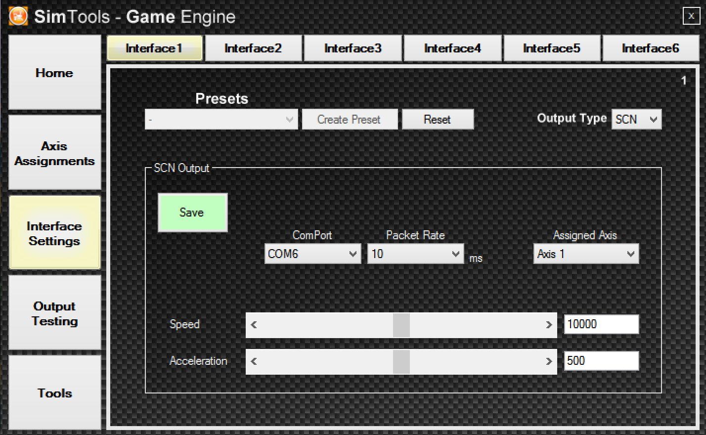

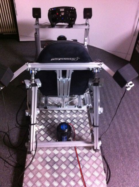

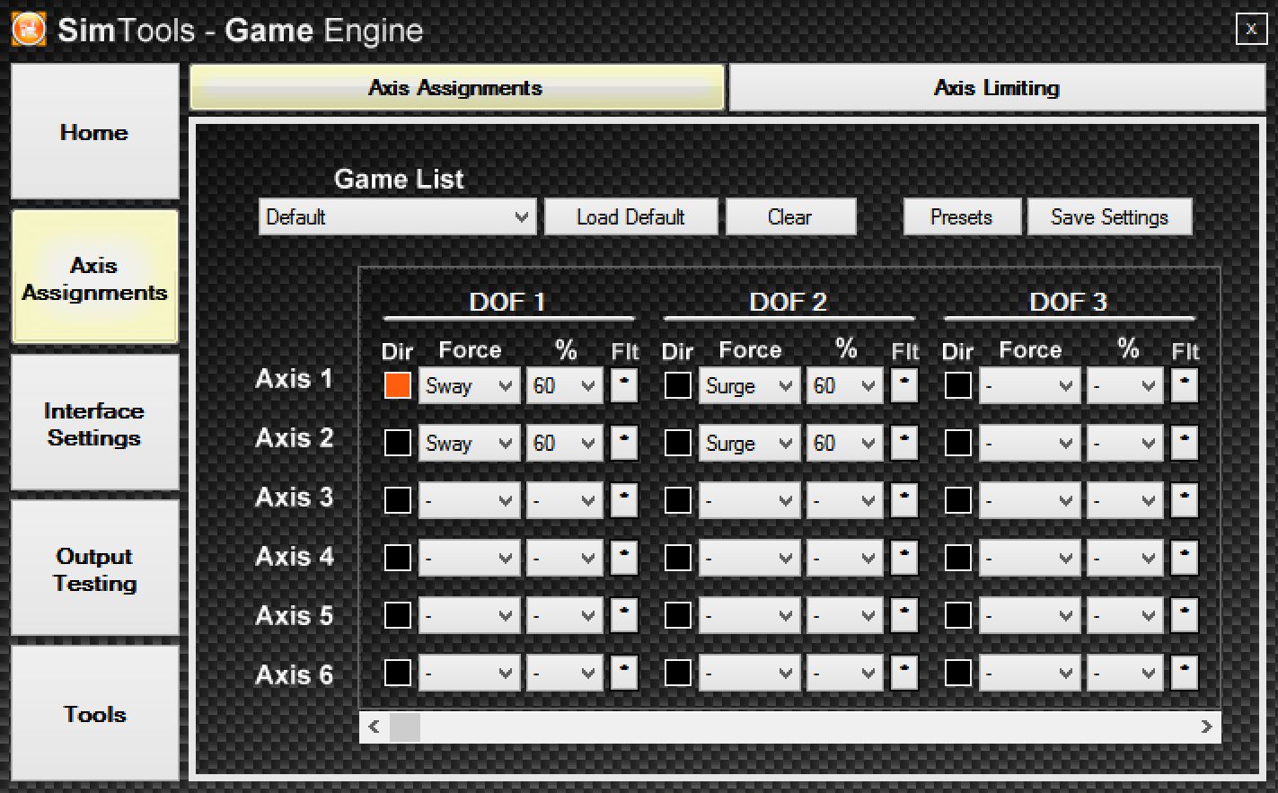

    I have added sway and surge motion to axes 1 and 2

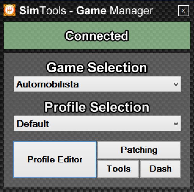

    21,044
    147,962Coins
    +10,883 / 54 / -2
    You need to do an Axis Assignment for Automobilista, the picture you posted is the Default, which works for testing but not for game. Each game has to have its own Axis Assignment.
    Have you patched the game for motion and if so to what install path?
    It would normally be Steam_Install_Path\Steam\steamapps\common\Automobilista\Plugins
    Once you do get it moving then you need to develop and tweak the motion profile: https://www.xsimulator.net/community/faq/steps-to-create-a-motion-profile.228/

    I have Assigned the axis for Automobilista and patched the game for motion.
    I've used the following dir to patch the game: D:\SteamLibrary\steamapps\common\Automobilista
    Its working now :)
    Thanks!
