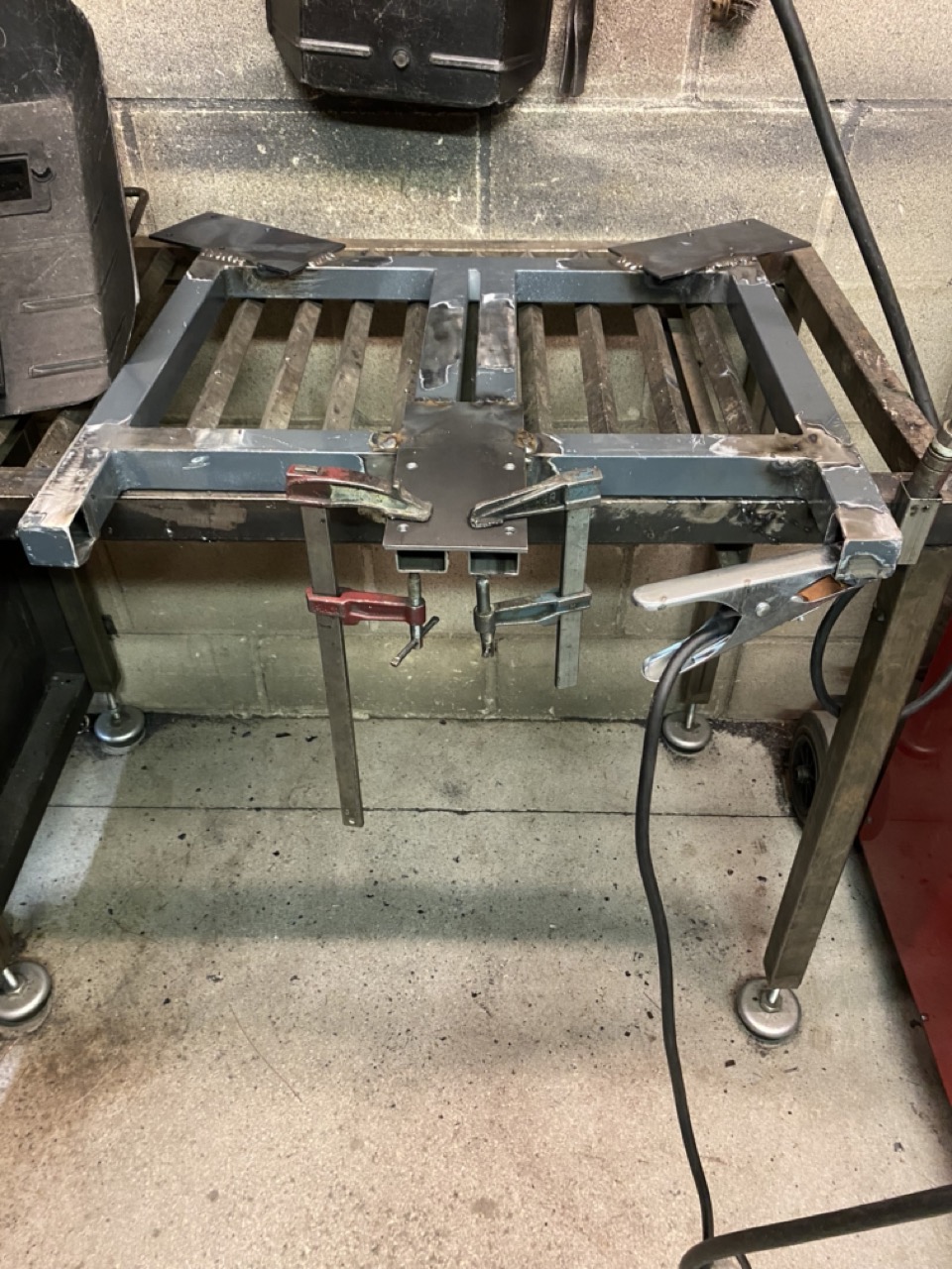

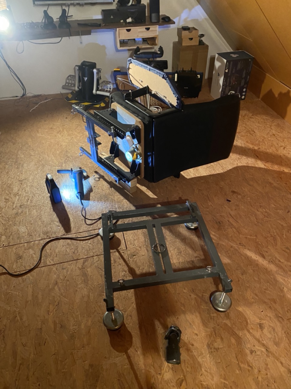

    I started cutting the universal joint of the prvios 2 DOF rig.
    Next I modified the base piece to incorporate the three new motors with some metal working and welding.

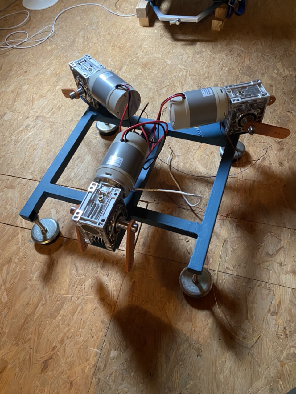

    IMG_3028 a mida gran.jpeg IMG_3044 a mida gran.jpeg IMG_3270 a mida gran.jpeg

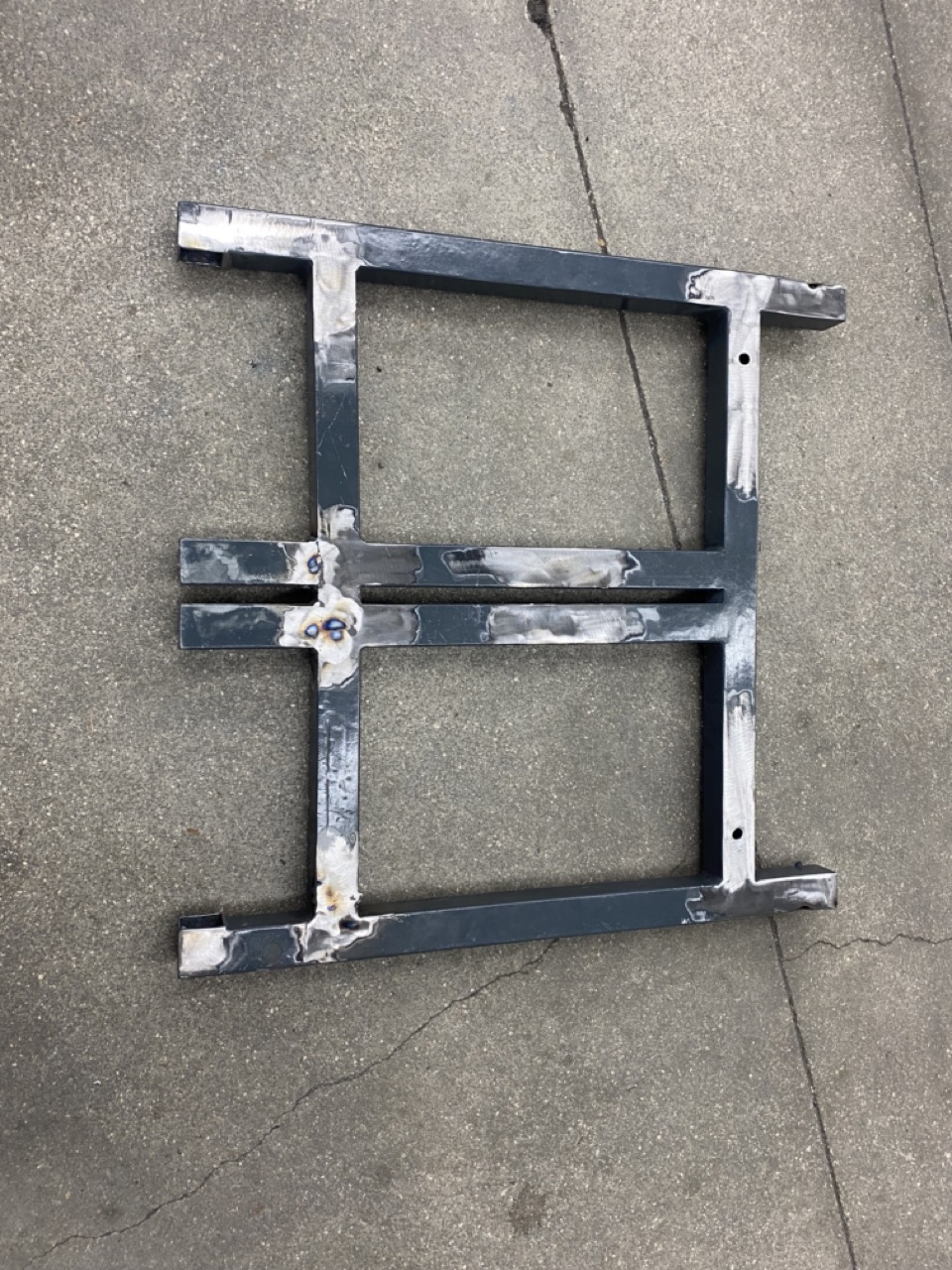

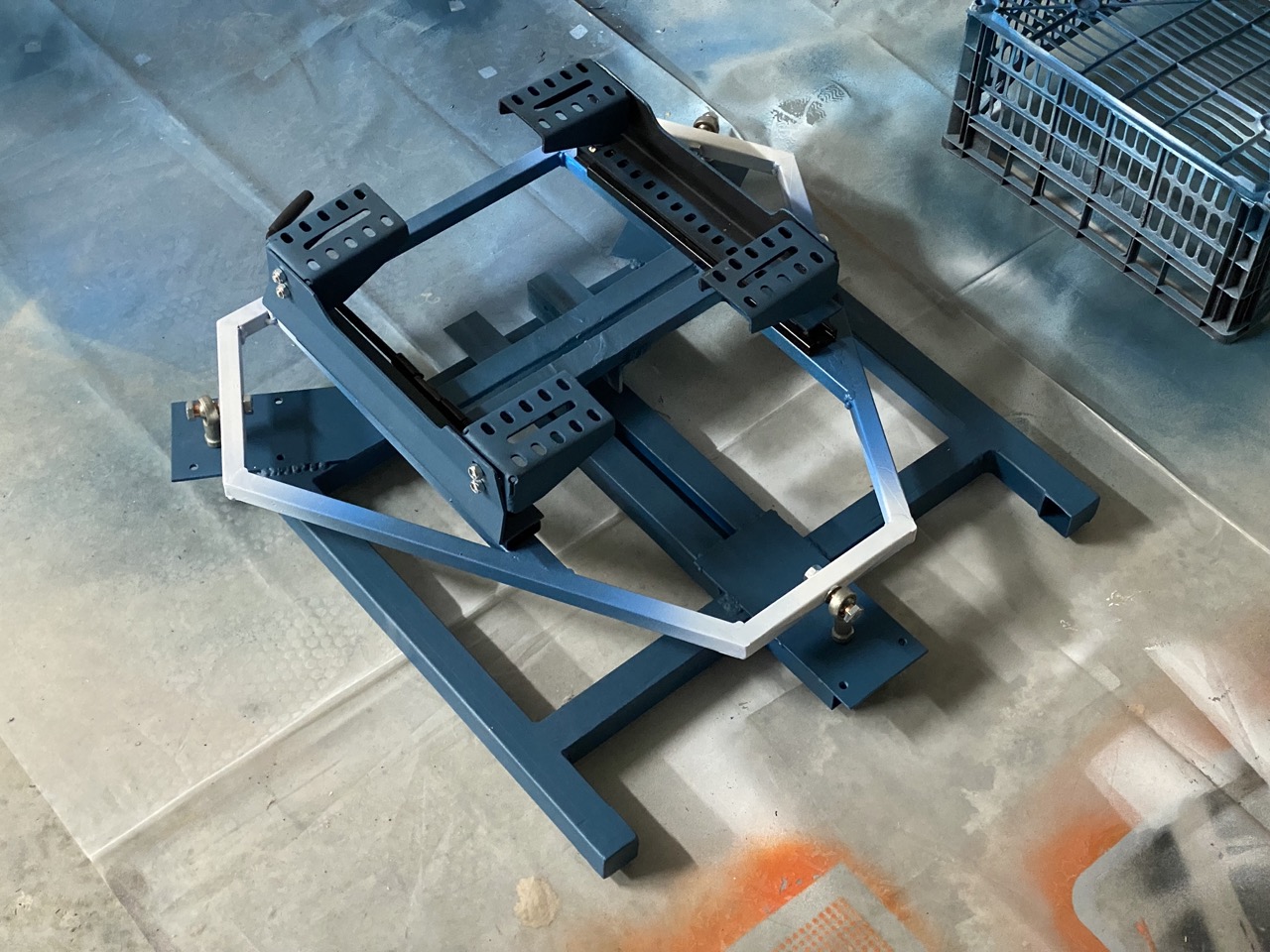

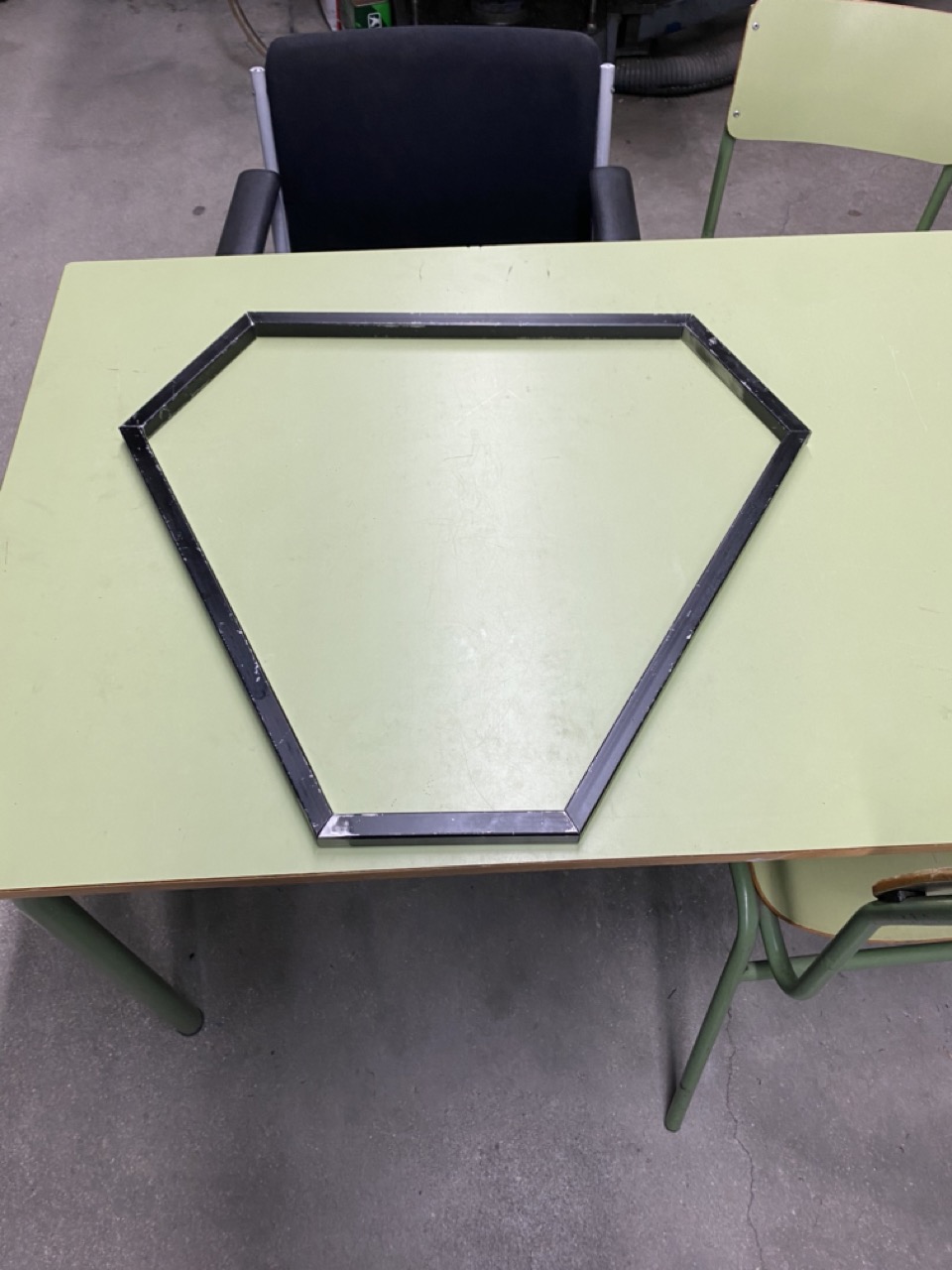

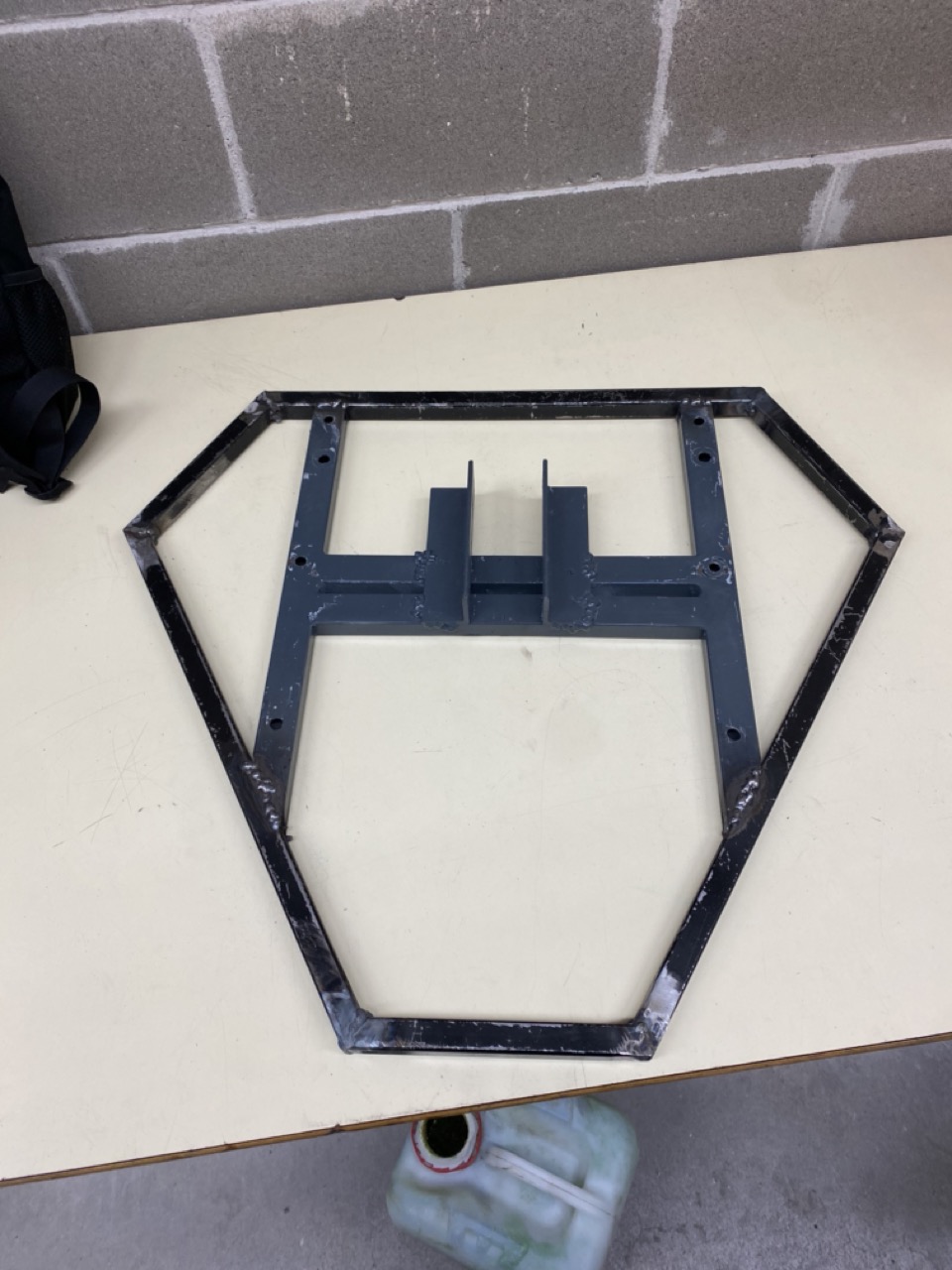

    Also was time to make the upper structure that will support the chair and the controls. That “H” in the center is also recicled from the old rig.

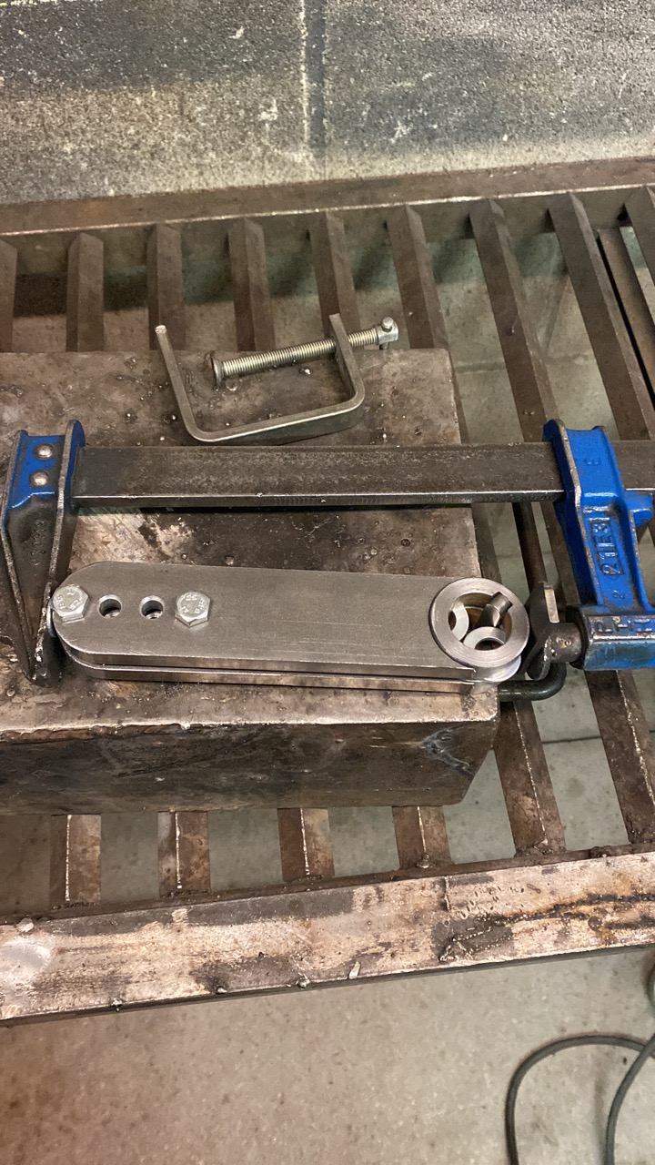

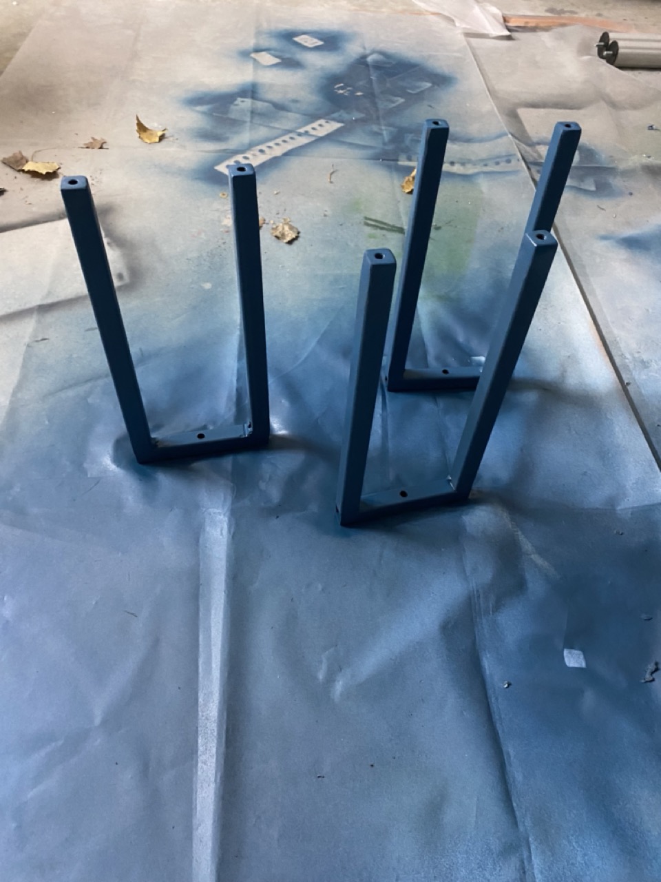

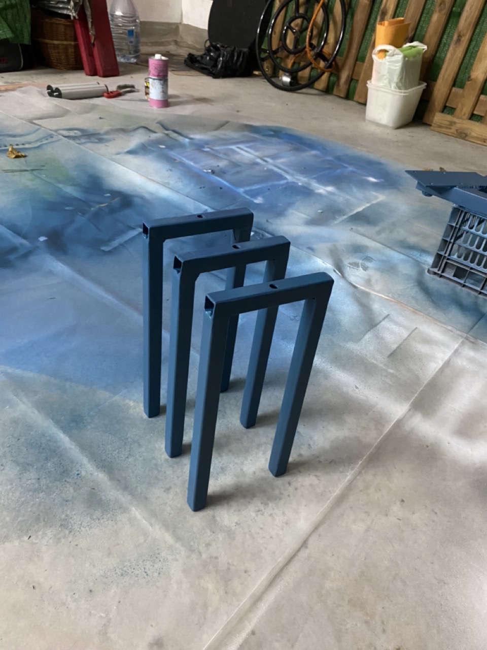

    The cranks are made of 25mm squared tube.

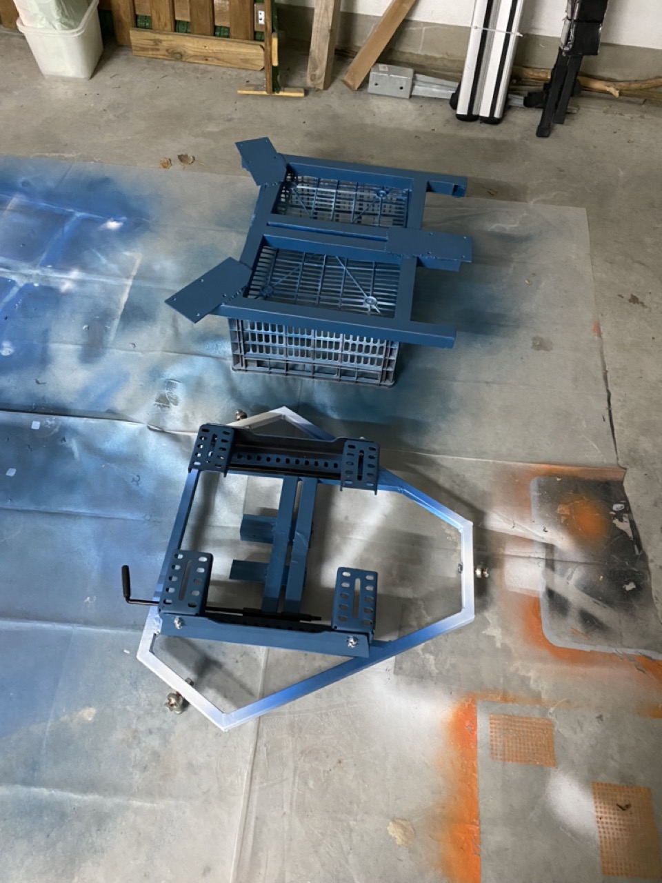

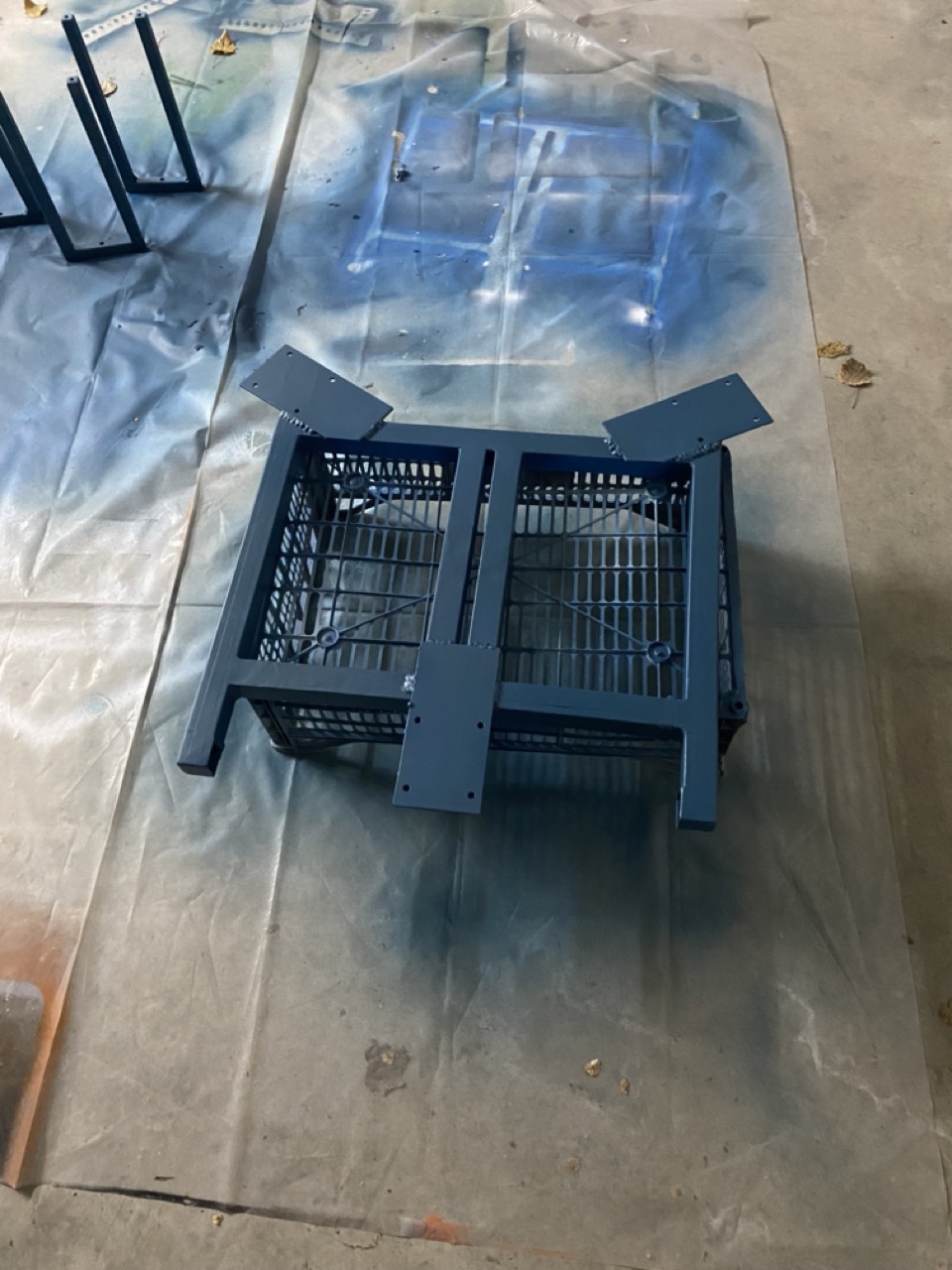

    After some painting job the main pieces are almost done.

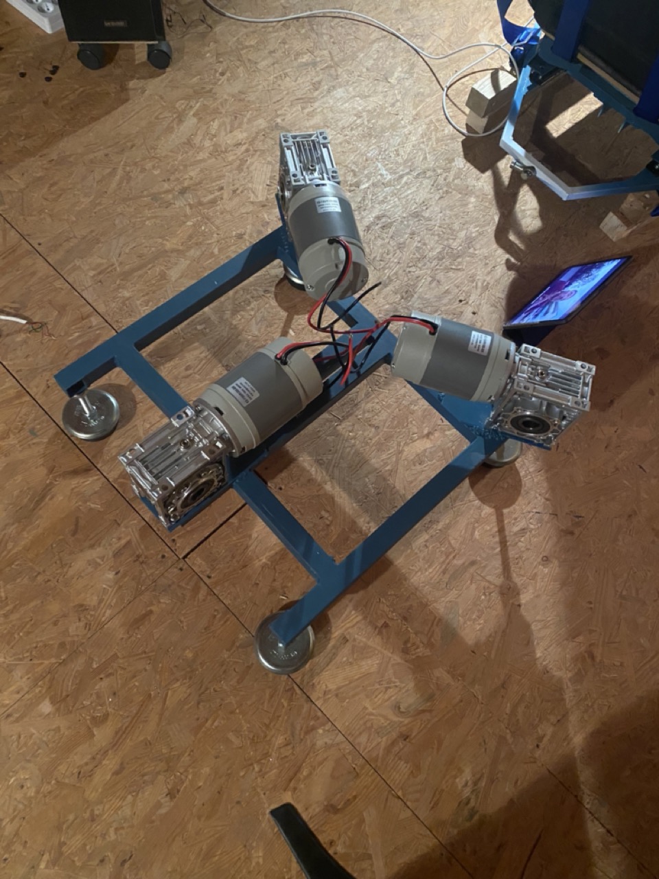

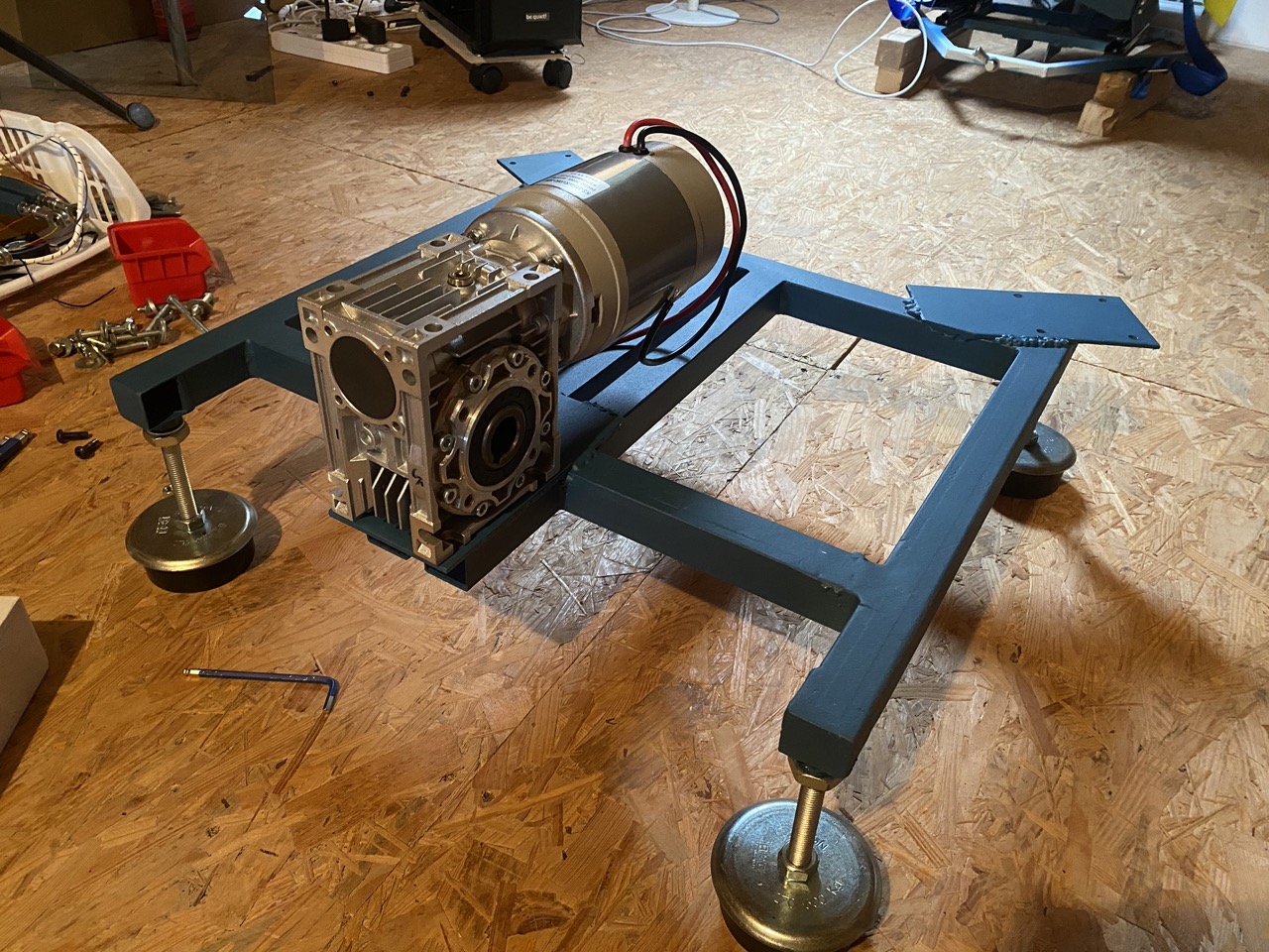

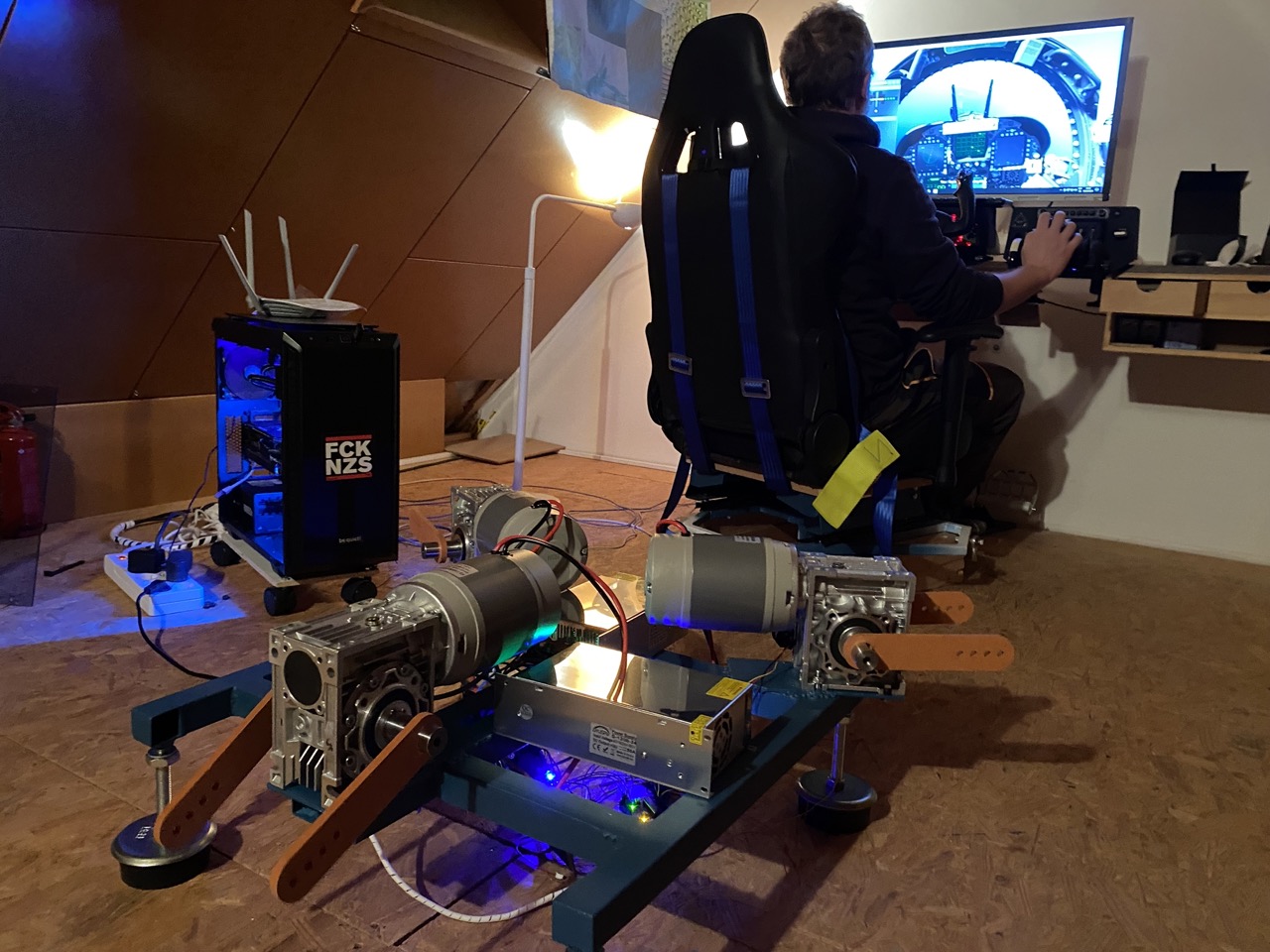

    After two months the motors arrived few days ago and instantly I started to install it.

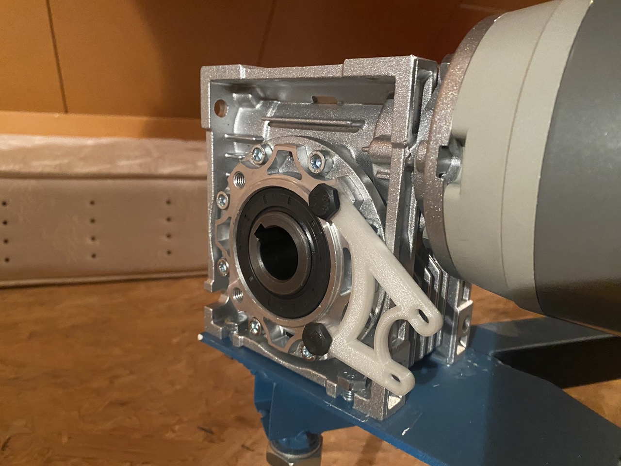

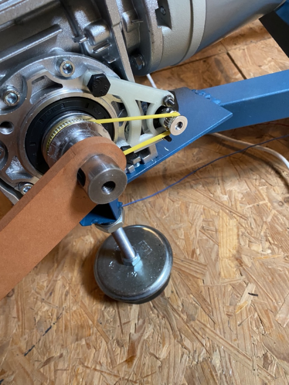

    With a 3D printer I print the Hall effect sensor suports. I also made some MDF levers for testing while able to made the "real" ones.
    IMG_3375 a mida gran.jpeg IMG_3381 a mida gran.jpeg IMG_3380 a mida gran.jpeg

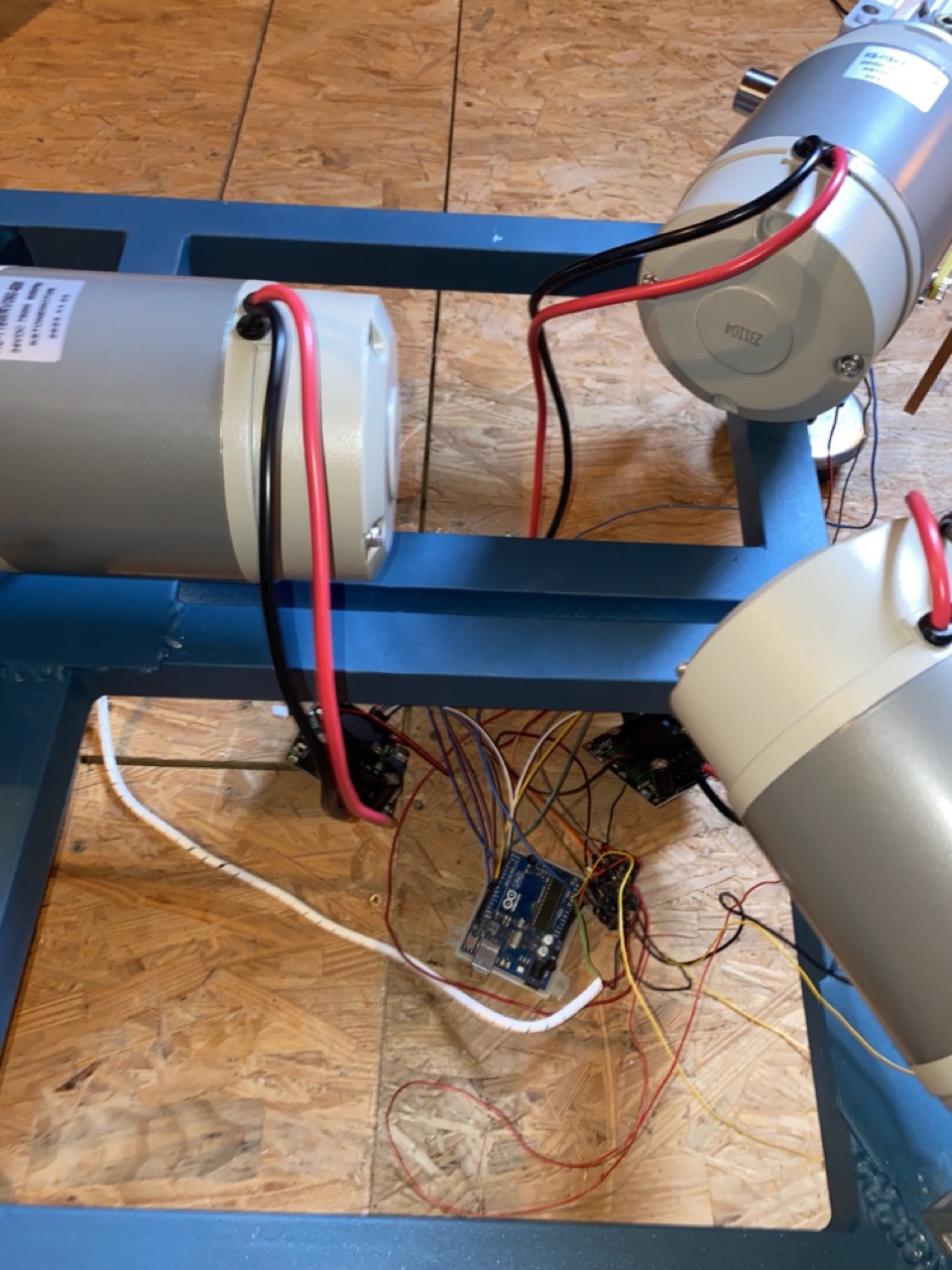

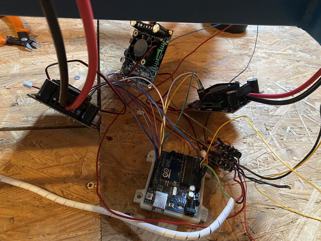

    Time to electronics. At the moment all the electronics are thrown like that coz always can come some problems and in this way is easier for me do the changes.

    A problem I detect now is the motor noise. Is a rumbling-like noise and my though it is caused by electric noise.
    In SMC utils I can see the yellow line is very very noisy and I think it is the cause of the problem. I will made a better electronics installation soon when some electric sorts arrive (magnetic clips and cable managment)
    The controller boards also get very hot when I put some load, around 50 Kg up on the chair

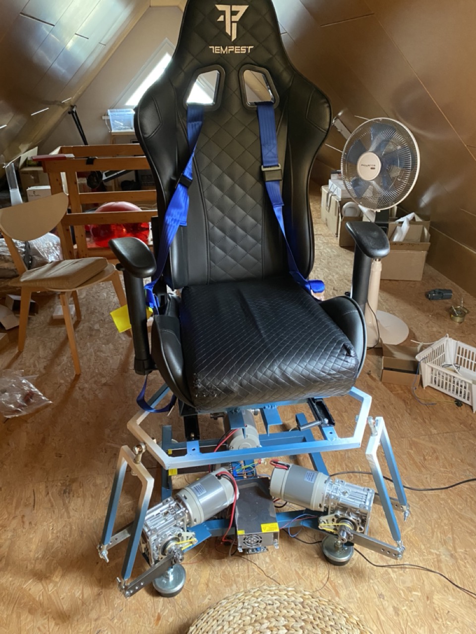

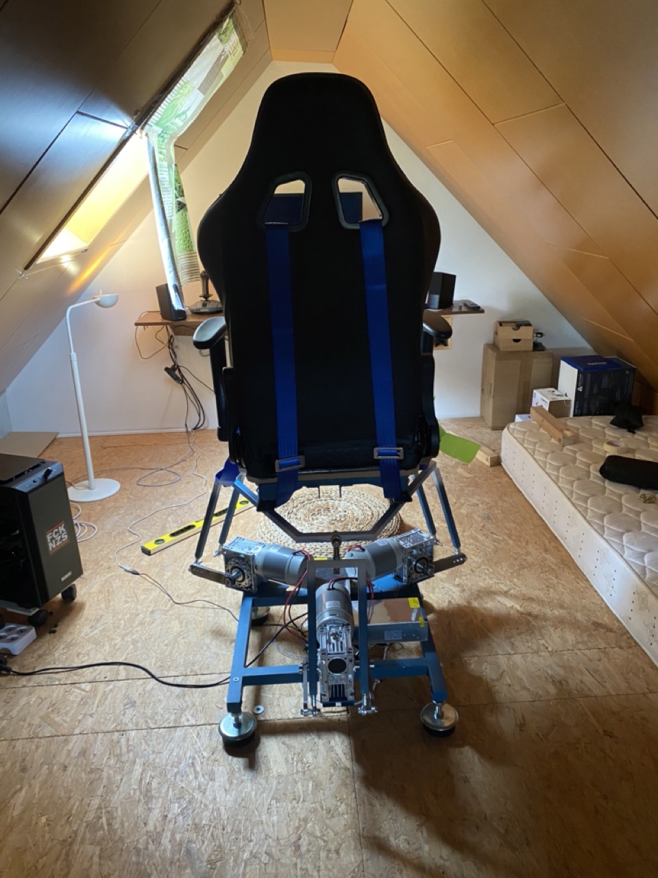

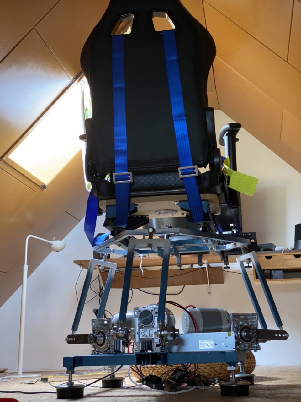

    Continuing the build and after made the new levers I was able to join the cranks and upper structure. I install the chair too and some motion tests with load but still with temperature problems
    D6C74D96-17F5-464F-84BD-836417663B7F a mida gran.jpeg IMG_3461 a mida gran.jpeg IMG_3463 a mida gran.jpeg IMG_3464 a mida gran.jpeg

    Is it the motors or control boards that are getting hot?

    Hi Noorbeast. Thanks for the reply. The problem is with the boards and some load, with the rig empty the boards only get warm but with load the boards raise the temperature up to smell bad, the motors at the moment works well.

    Well, I rewired all the electronics with protected cable and way more tidy and the problem with the noise go away 90%. I'm still waiting for magnetic clips so I think it will be the icing on the cake.
    Well, in the other hand the temperature problems stills as one of the board literally burned yesterday. I don't know but I think buying that kind of boards is a lottery. I'm searching sabertooth boards but is very very hard to find it and the ones I can see are very expensive, 200€ per board (I need 3).
    I already wrote to these board seller to see what's happening with my "100A" boards that can't manage up to 30A.

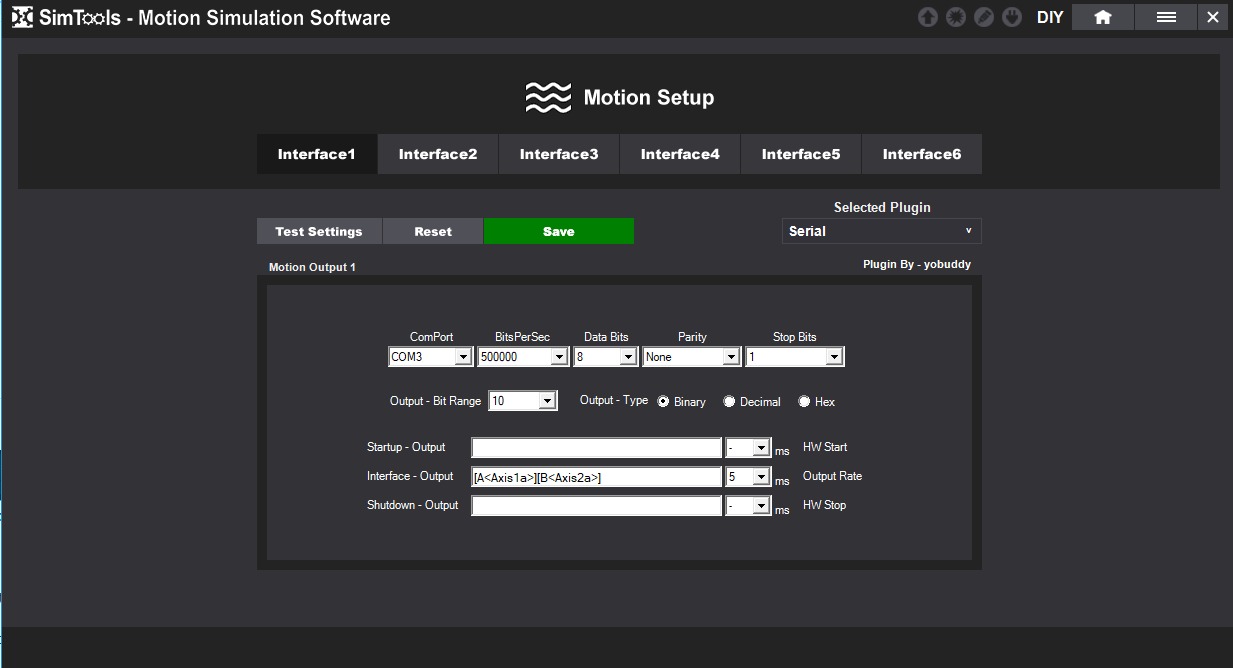

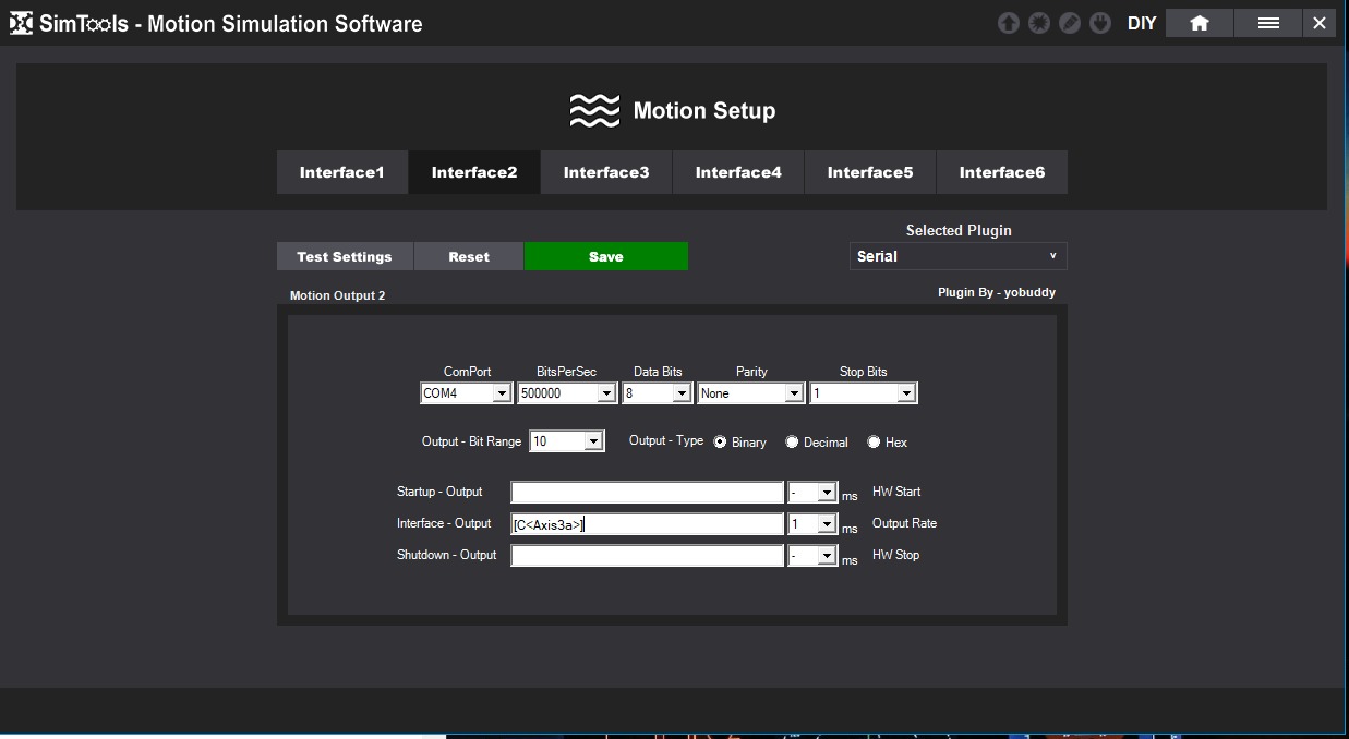

    Yeah, finally I already get Simtools working, I didn't read well the instructions and I was trying to validate the license with the first code, now it is working.
    I'm having the same result with Simtools, after read the user manual I don't know how to configure the serial interfaces to work with two arduinos.
    WhatsApp Image 2024-02-29 at 15.23.18-2.jpeg WhatsApp Image 2024-02-29 at 15.23.18.jpeg
    I asume the interfaces config is as the screenshot shows but actually I don't know why to be honest o_O
    Thanks!
  17. Josh_Possa
    Josh_Possa Active Member
    Jan 25, 2021
    110
    Catalunya
    505Coins
    +32 / 0 / -0
    2DOF, 3DOF, DC motor, Motion platform
    I think I get (I find actually) how to configure it. Changing the ''[C<Axis3a>]" to "[A<Axis3a>]" in the second interface.
    Tomorrow I'll test it
    Edit: Yep, problem solved, now both Arduinos and all the motors are working.
    Interface 1 (to Arduino Mega) Output : [A<Axis1a>][B<Axis2a>]
    Interface 2 (to Arduino UNO) Output: [A<Axis3a>]
