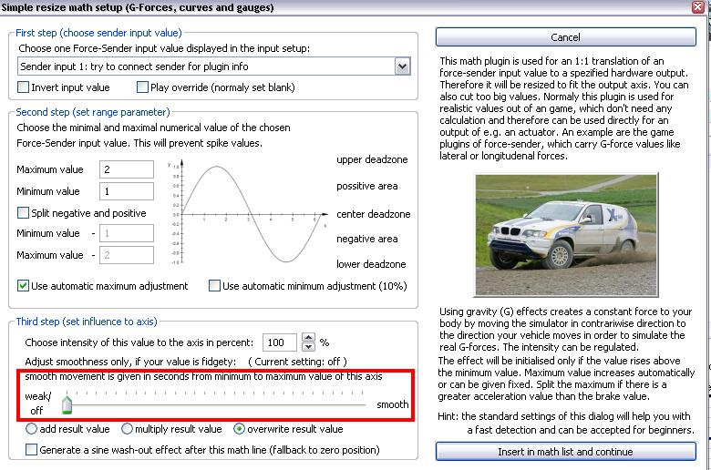

    You could try to add smoothness to the bank effect while keeping the SCN5 accelleraton on a level that fits for carrier take off accell simulation.
    Though I have to admit, that adding smoothness did not worked well for me. At least for car accell g-forces (I dont like kick-in-the-back feeling while shifting).
    Maybe it works better for bank effects. Try it...

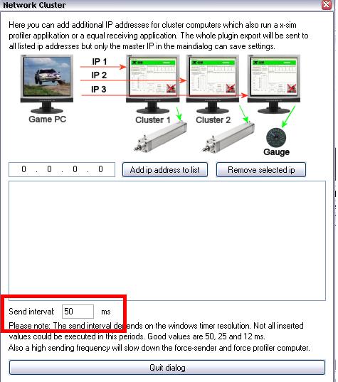

    Btw, depending on your hardware performance you are able to speed up the Force-Sender output.
    Default is 50ms afaik. Not that fast...try 10ms, or faster if your hardware can handle it.
    regards

    I'm not sure what you mean by this. What math plugin would I use for this?
    I really like the idea of this feature! It would be great for racing simulations......but for this exact problem, I really think this is just a Band-aid (cover-up) for the real problem that the plugin is not updating fast enough. Otherwise, it seems to me that I would experience these jerks in the racing simulations I use as well.
    Well, I have to believe that this is set correctly on my machine as I do not have the same problems on any racing games. I will try to experiment with it though.
