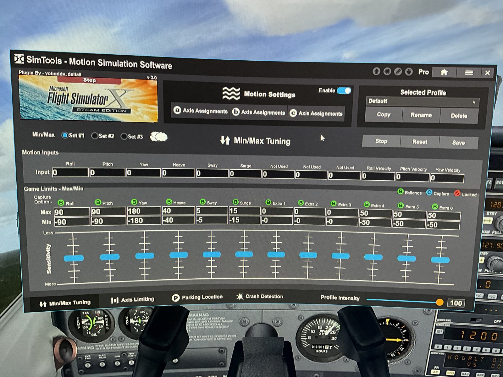

    Box FSX motion not working when dropped in FSX Steam plugin.

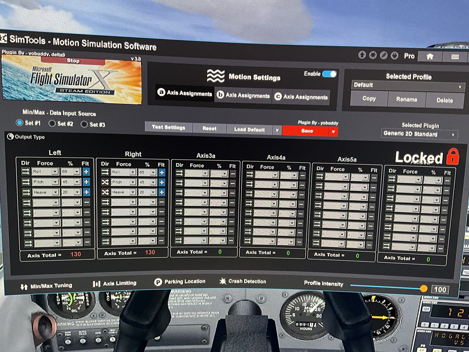

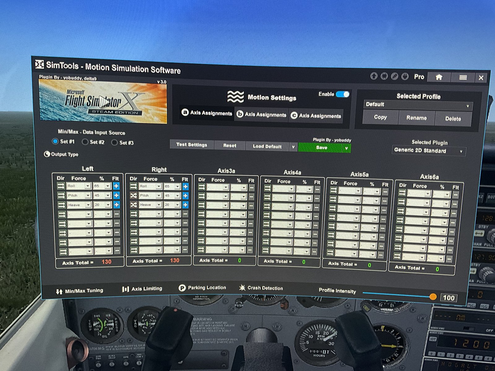

    Here are the settings

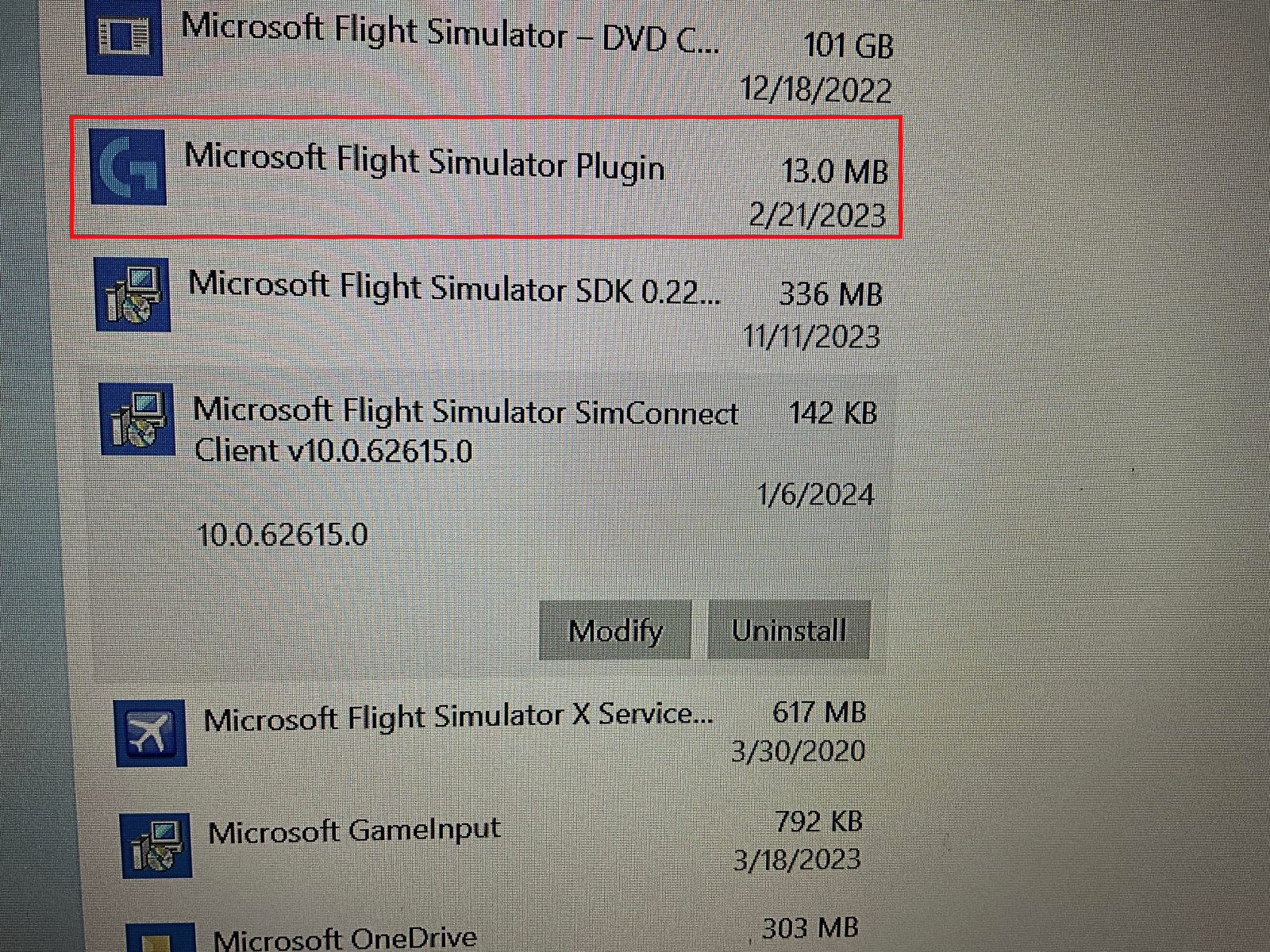

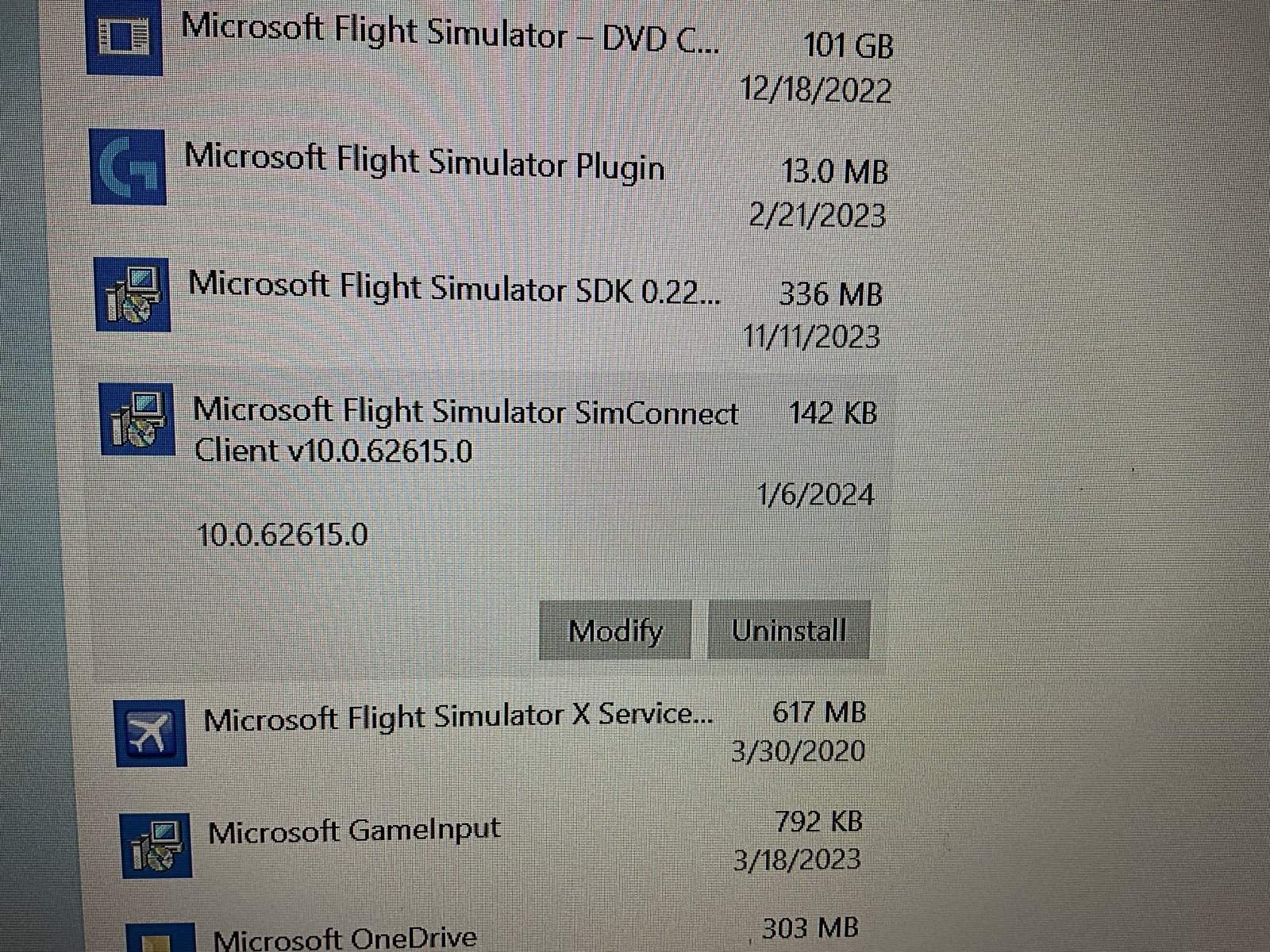

    Here is the simconnect version you want to use with the plugin.
    It gets auto installed when installing the plugin, but if other versions are already on the system, it may not be used or installed. (It's v10.0.62615.0)
    If your system has other versions installed, please remove them from the system so we know the correct version is being used. Both the box and the steam version of the game has been confirmed working, so this should fix your problem buddy.

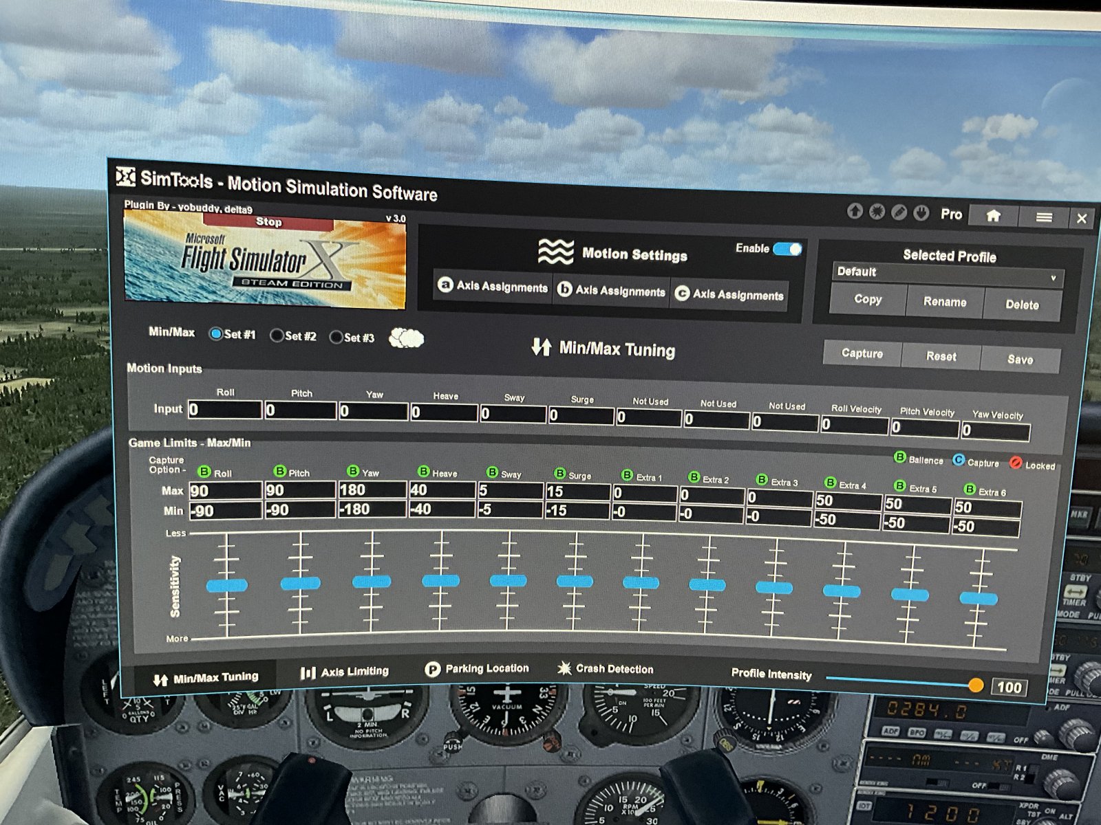

    Yobuddy, I did the plugin reinstalled then dropped the FSX .exe launch with no problem but still no motion. Here are the screen shots of the setting

    Please install this simconnect version and give it another go.

    Yobuddy I deleted the simconnect installed the last one you sent still no motions and the settings I sent

    The first simconnect I posted is the one for fsx, the second one is for Prepar. (but we have both installed so I sent you both)
    You do have some stuff installed that I don't thou.
    What does the plugin listed below do?

    That is for my flight radio from Logitech

    It is possible the flight radio uses a different simconnect than the plugin does, as it looks to be a hardware device that communicates with the game?

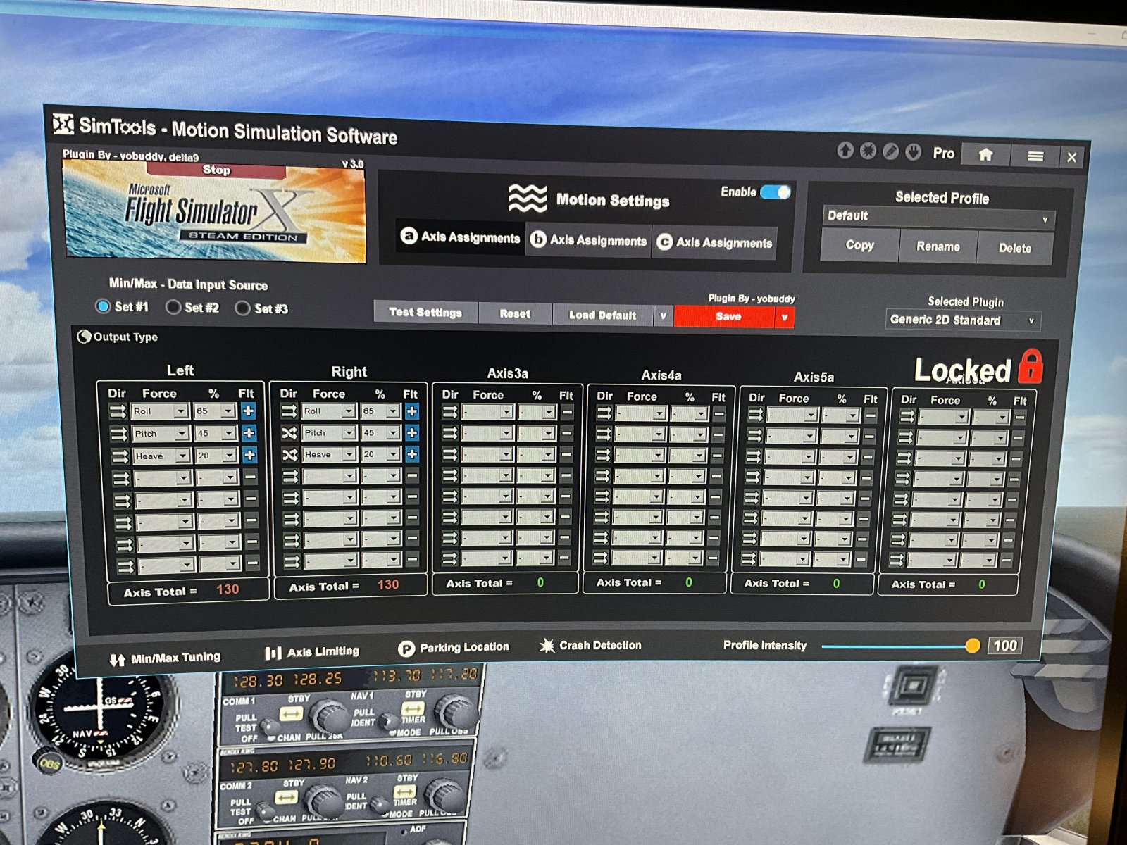

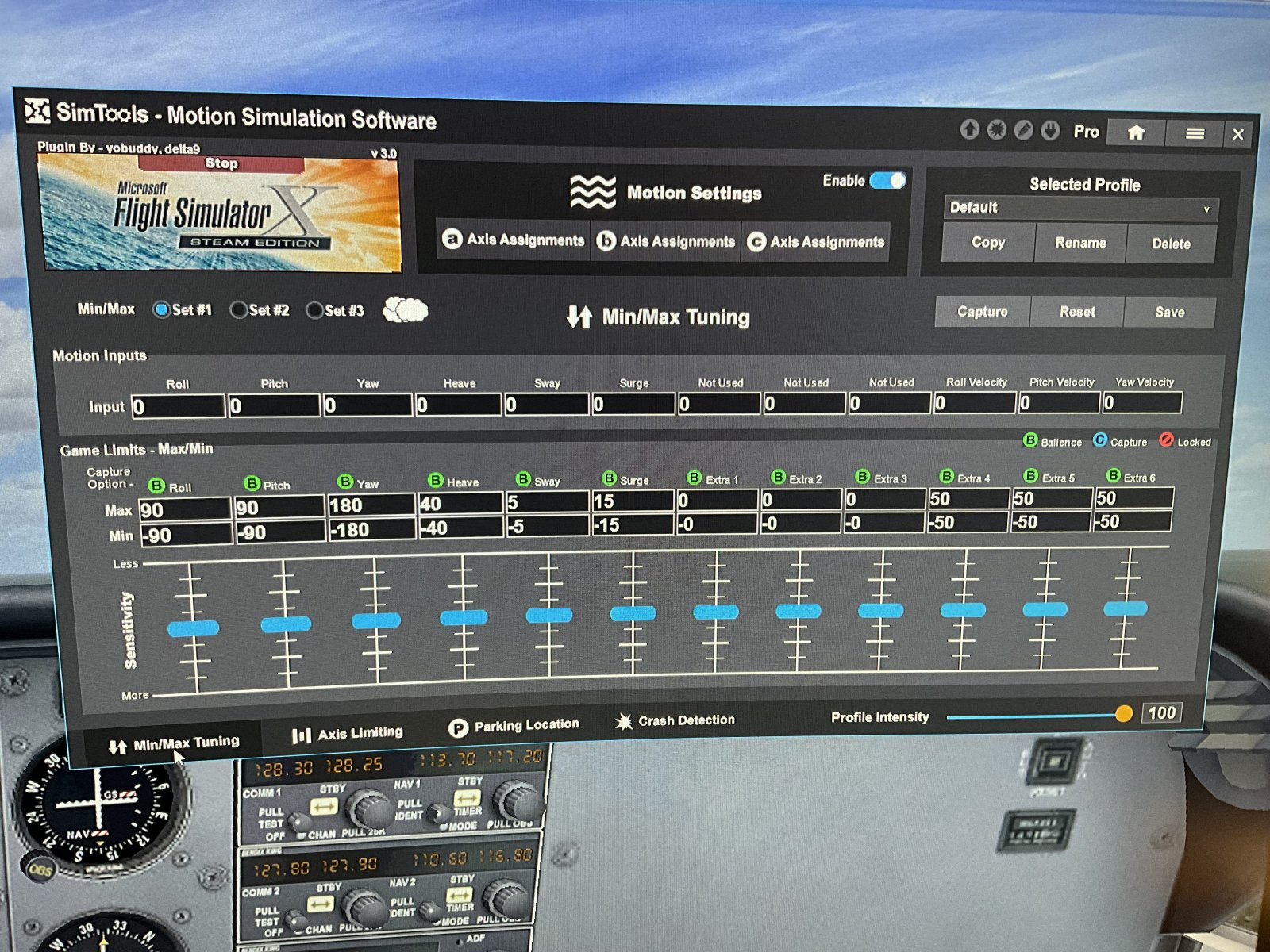

    I purchased FSX Steam it works with simtools got motions but when dropped Box FSX on the FSX banner lost the motions of the rig. See attached files
