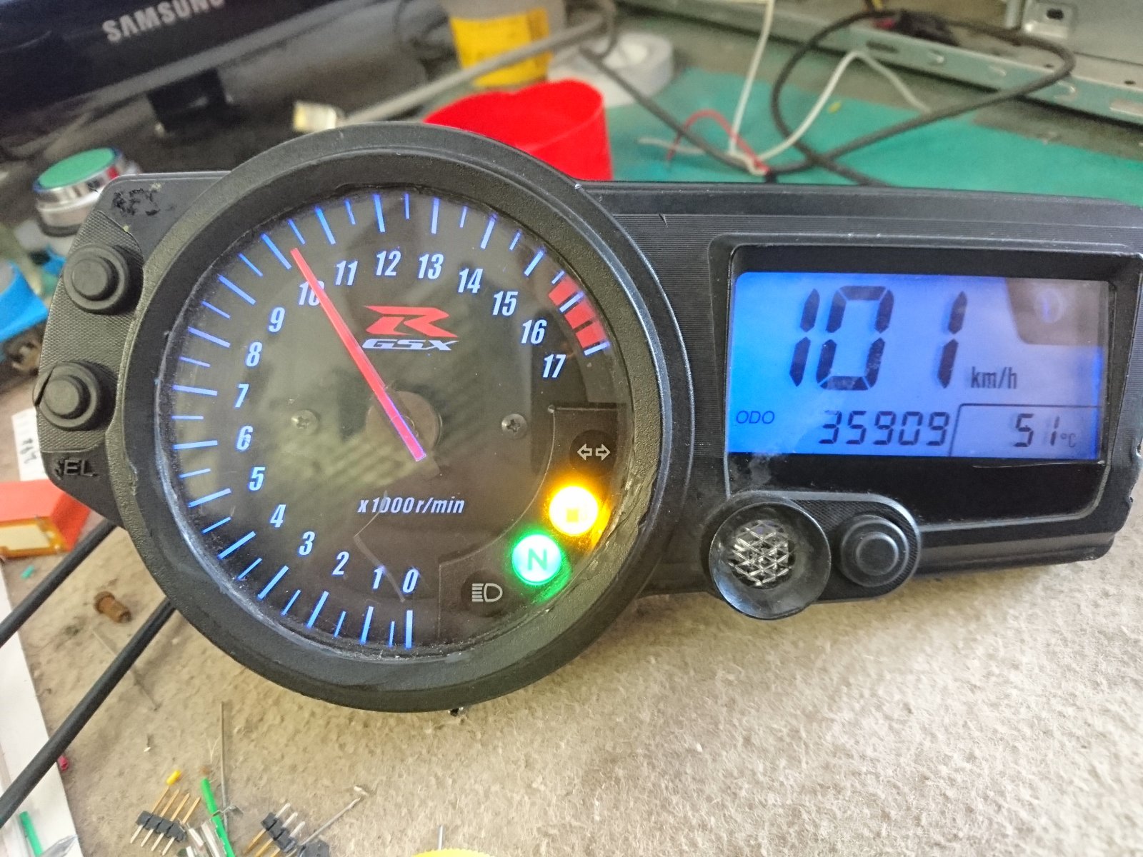

    I tried it and it doesn't work. The app starts to produce a windows sound. Exactley the same as if you woul enter an invalid equation.
    Here is my work in progress dash. Still need to addthe neutral light and fuel light:) oh and gear indicator. That won't be a problem:)
    This one works over Wifi on Project cars and PS4 (big thanks to all of you that made this possible)
    And the dash is from an Suzuki GSX-R 600 2005
    The CHEC sign is there because the das uses a serial line to show temperature and error codes. This is currently my top prority. It almost works ;)
    And this one is from a year and a half back.. It uses a Yamaha FZ600 2000 dash. This one works over USB but now i will be swaping for the GSX-R ;)
    BIG THANKS TO EVERYONE HERE THAT MADE THIS POSSIBLE!!!!!

    Finally got everything working:) the bigges headache was the temperature. Originally the motorcycle ECU does the measuring and sends the temp data via serial line. The comunication wasnt the problem. The problem was that the dash has a thermistor table inside so the value is not linear (it is kind of logarithmic). So I needed to implement the Steinhart-hart equation. An now the value is spot on ;)
    The only problem now is timing. I think i will need to have one processor for the RPM, one for the Speed and one for everything else. I will ne how it goes :)
