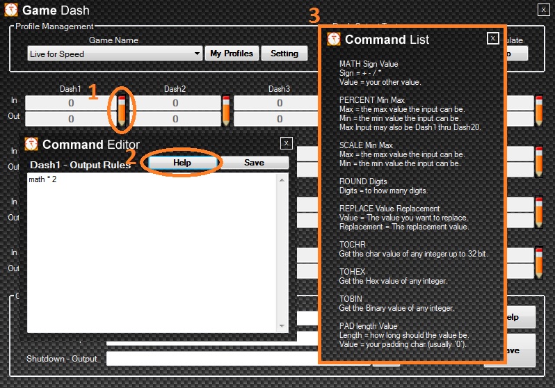

    hello!
    is there any documentation regarding the Game dash functions? MATH, ROUND, PAD?
    My problem is how to convert Boolean to byte. True = 1, False = 0
    thank you!

    Simraceway. Im using the dash program to extract varous data from the game... But i'm stuck at Shift UP and Shift DOWN variables... The GAME DASH sends tgem as TRUE and FALSE.. And since everyhing that is sent ro my arduino is in integers, i'm looking at ways to change TRUE and FALSE to 000001 and 000000 so i don't need to change the program so much :) the dash is in work in progress so i don't have any pictures yet:) when the project is complete i will post an article here on the forum;)

    @tadythefish, use the Replace function.
    Like this,
    Replace True 000001
    Replace False 000000

    @tadythefish, All the commands are all shown in Game Dash itself.
    1) Click a pencil
    2) click Help
    3) Popup shows all commands.
    Is that what you are looking for buddy?
