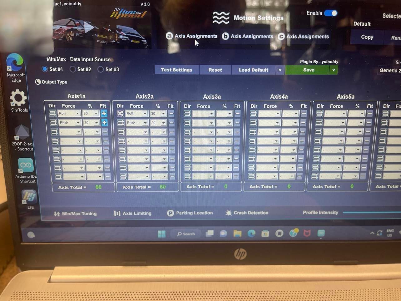

    Have spent several days running and debugging code to run motion on rig. All Arduino code works perfectly and all motion functions work in simtools when testing . When you then go to game LFS and start a race rig does not move , leave game and go back to interface setup/axis testing and move all sliders rig does as told. Any ideas appreciated

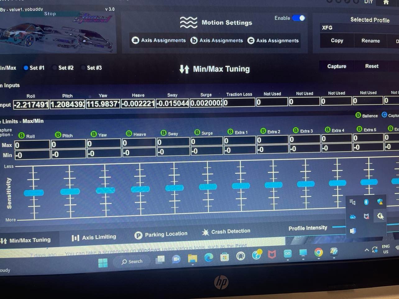

    Looks like you need to capture then refine Min/Max values as game data is present but everything is set to zero:

    If you select the Default profile for the game, you should see some Max/Min settings.
    Or while the game is running, click the capture button and after you drive around a bit, click save.

    Thank you gentlemen for all your help , the beast is alive and now the learning begins :)
