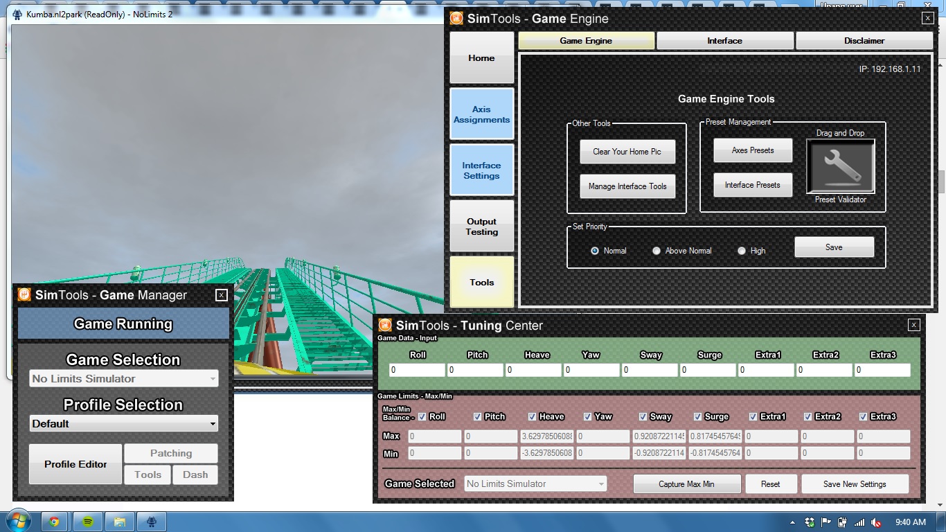

    Hi everyone,
    We are starting a simulator project that will use inputs from the No Limits 2 and SimTools softwares.
    Unfortunately, I cannot seem to set up the two to communicate correctly because no values are displayed in the Game Data Input in Game Engine. I would like to ask for assistance in addressing this problem.
    Thank you

    Can you post pictures of you Interface and Axis settings as well.

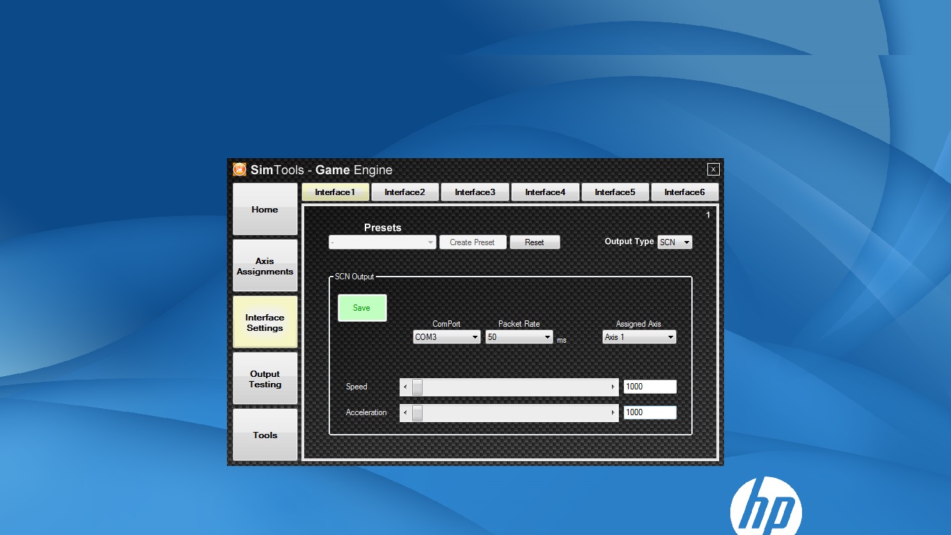

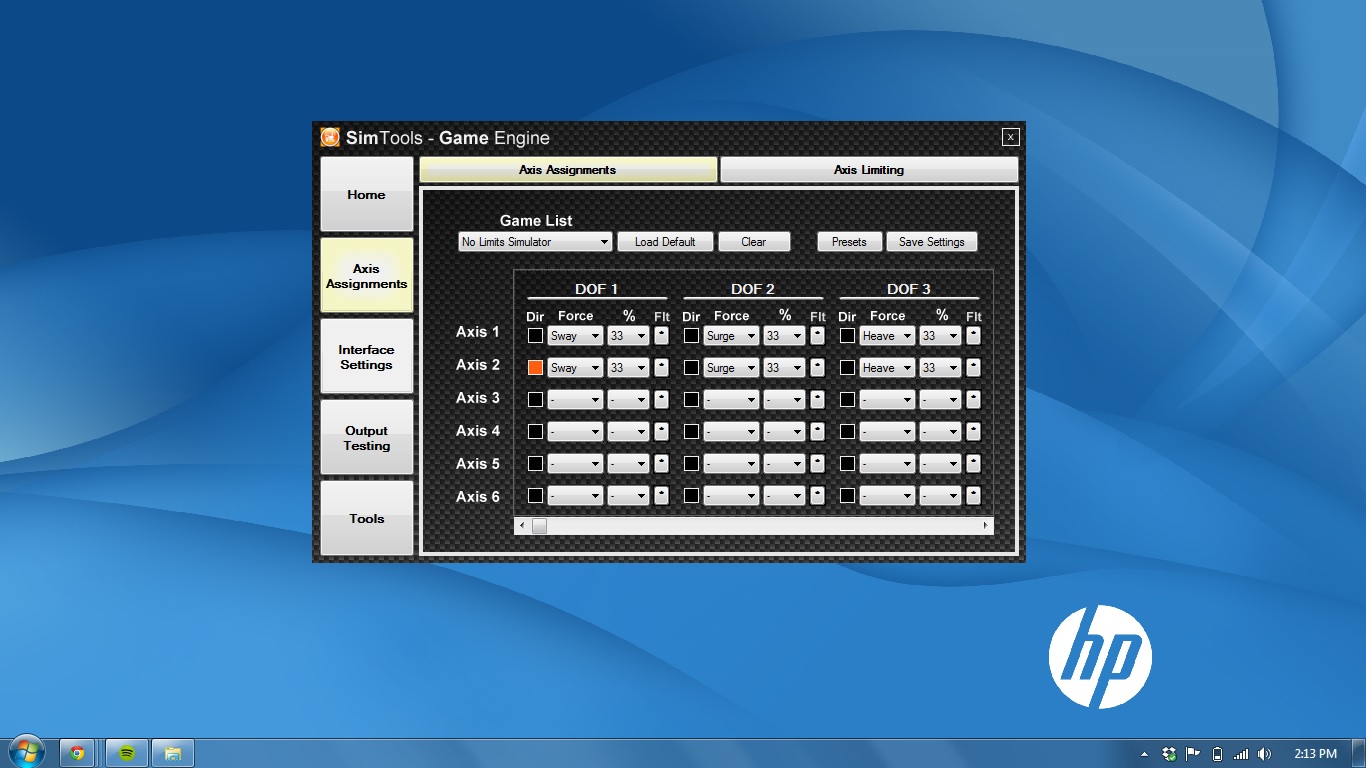

    Hi noorbeast,
    thank you for your reply.
    I am still trying to figure out how to set up the interface.
    Is it possible to get the Game Data Input in a graph format?
    force vs time perhaps?

    The interface settings is how SimTools interfaces with your hardware and there are handy presets for common setups. Perhaps you can explain exactly what it is you have and are trying to do.

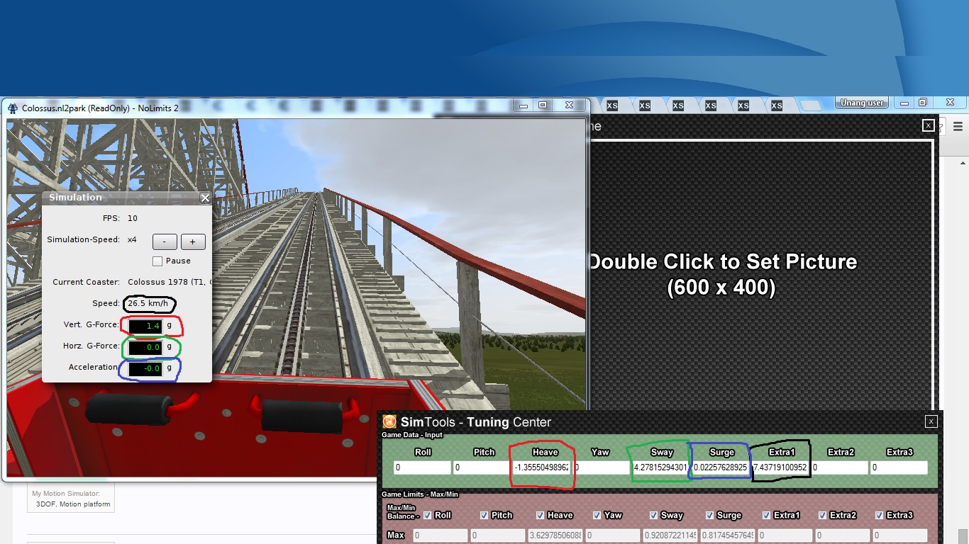

    Thank you for all your help.
    I am now able to see the values for the Game Data Input.
    I have read from one of @value1 post that you should run the game first
    then run the SimTools and it worked. Now, I am just concerned with the discrepancy in the

    So Speed is in [km/h] while Extra1 is the same value in [m/s]
    Vert. G-Force is the same as Heave. 1.4 vs 1.355. This is a rounding error.
    Aceleration is the same as Surge. Again 0.0 and 0.02 is a rounding difference.
    Horz. G-Force is the same as Sway. What is not shown in your screenshot is the exponent of Sway. I'm sure the value is -0.04 or so.
    (Sway might be -(Horz. G-Force) because of force convention reasons)

    regarding my question about plotting the force and speed values vs time.
    is it possible?
  13. value1
    Jan 9, 2011
    2,184
    Zug, Switzerland
    14,750Coins
    +3,322 / 11 / -1
    The plugins do not log telemetry data. However you can write a little program that logs the data you receive via the description
