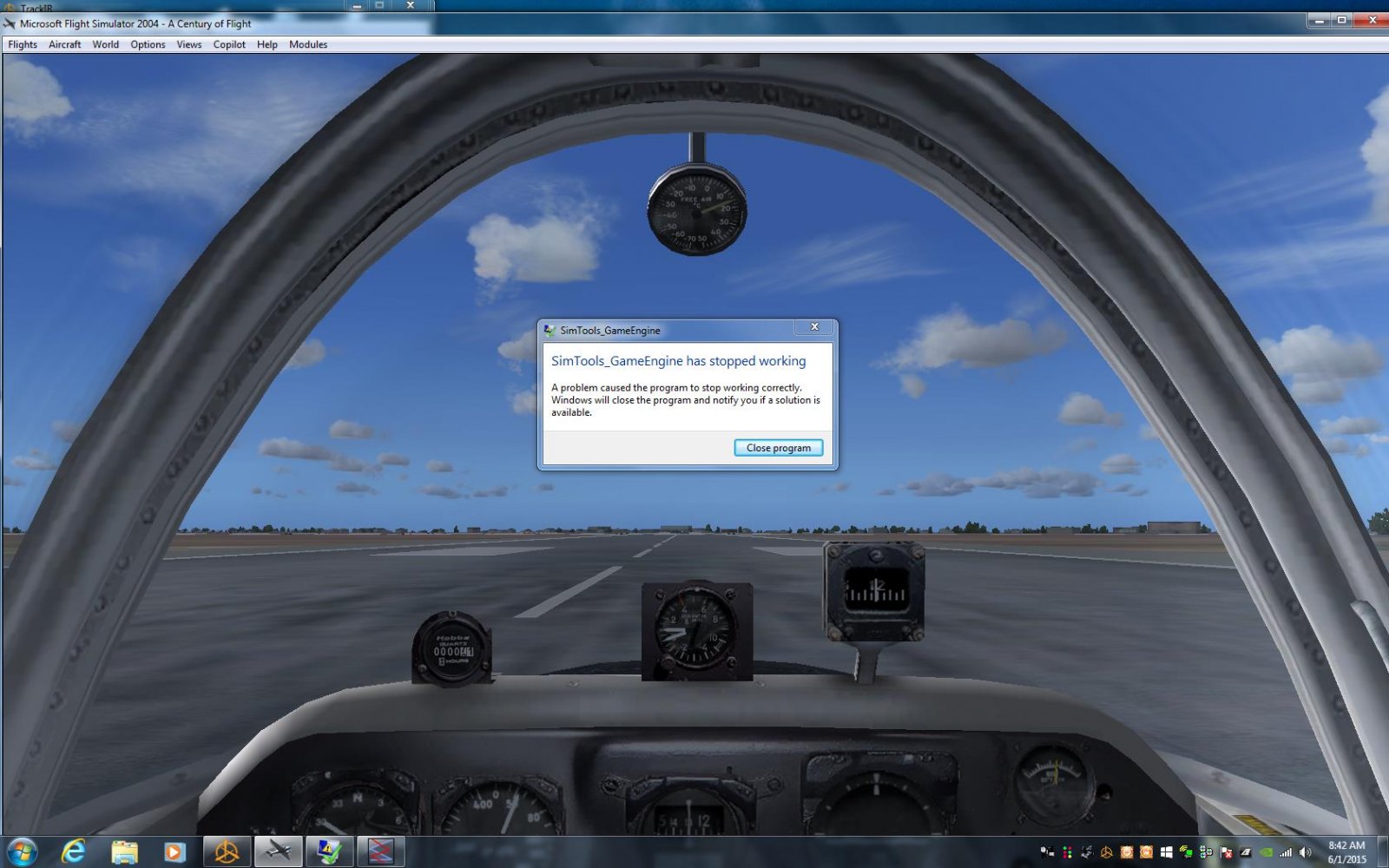

    I’m having a problem with Flight Sim 2004 and I am running Win7 64. The game engine keeps shutting down. I’ve re-installed Win7, and all of the necessary Flight Sim 2004 equip. joysticks, rudders . I even tried reinstalling sim tools 1.2 and 1.3 several times. Still the same.
    On the other hand I’ve got a lap top running the exact same set up and a fly hours at a time with no notification!

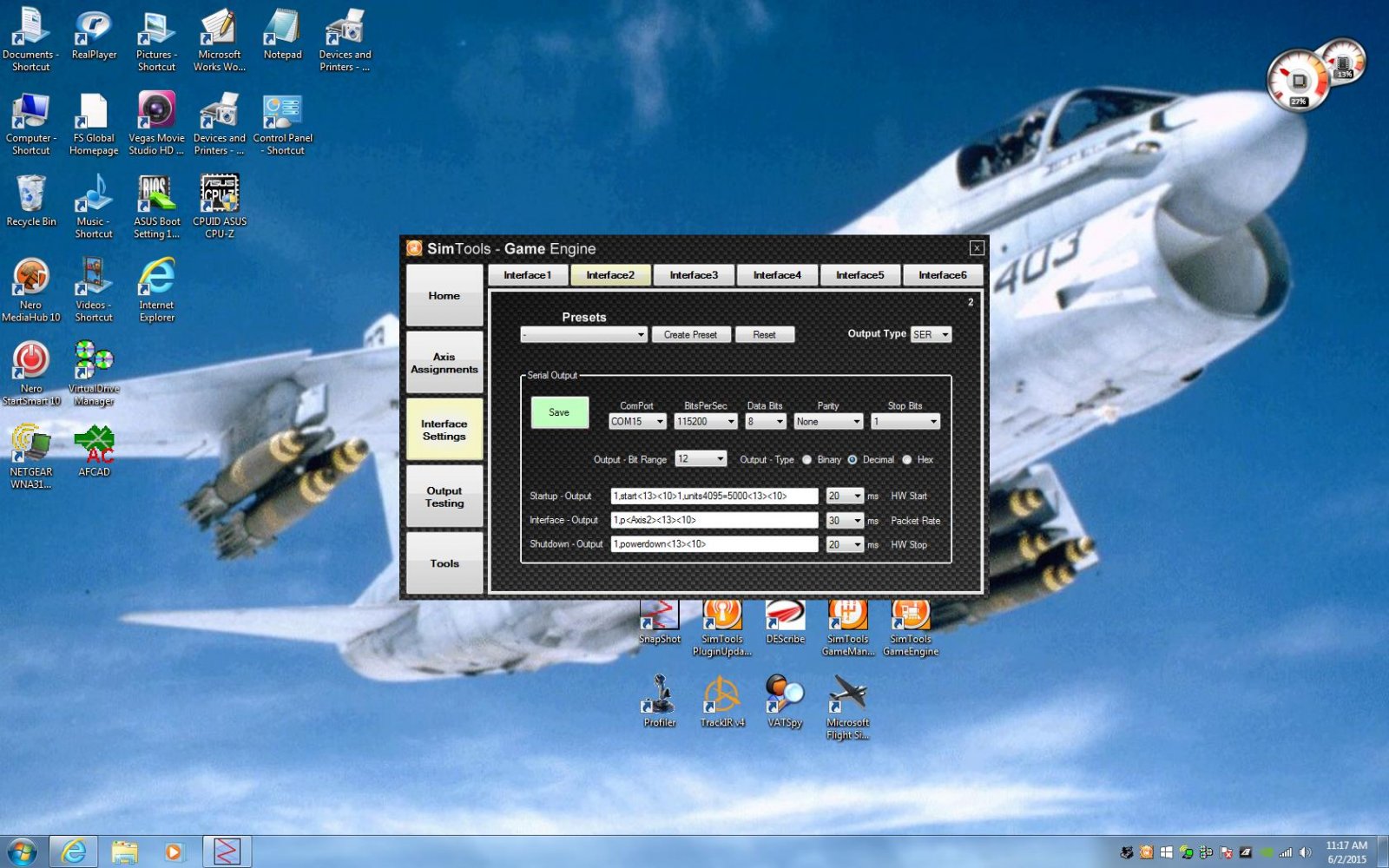

    Forgive the miscommunication. I'm using serial communication. The photos should tell the story! I'm using Dimension Engineering devices: Syren 50 + Kangaroo 2 + DeLink per axis. Also have FSUIPC placed in my modules.

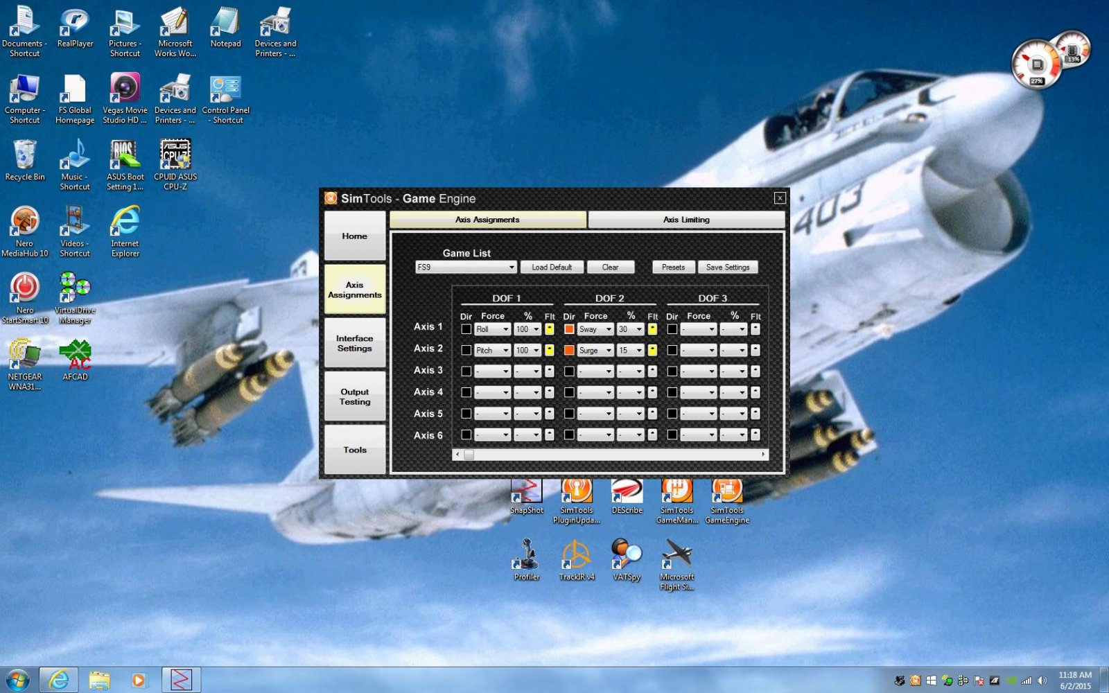

    Is your rig a traditional 2DOF or something else?
    Are you following the manual: http://www.xsimulator.net/simtools-complete-documentation/
    I ask because you would normally have the same axis, say pitch, on DOF2 for both axis in the Axis Assignment tab, with the forces running to extra columns, like this:
    but yours are set like this:

    My simulator is based on the joyrider concept! A basic 2 dof, one axis for pitch the other for roll.
    Just to clarify, the game engine is shutting down! Not the game manager or Flight Sim 2004.

    I believe the situation is resolved.........I think. In Game Engine, I had the Axis Assignments at 100% . Roll and pitch, surge, and sway all at 100% I turned roll and pitch to 20% and 10% and it works.
