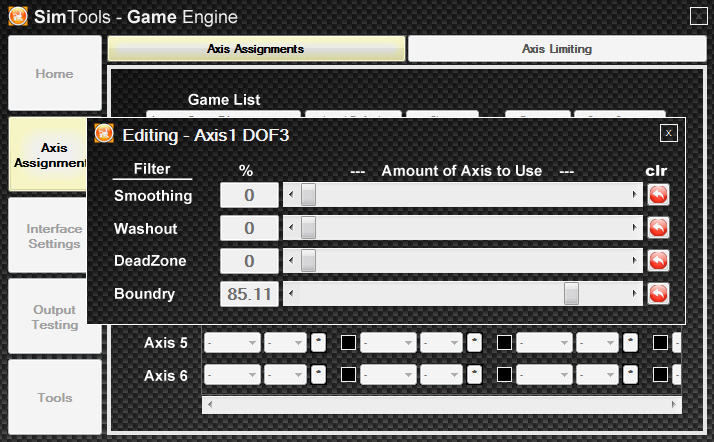

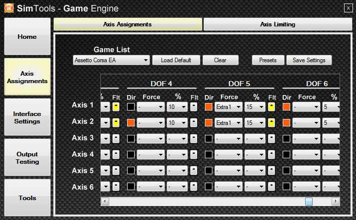

    Meanwhile I have to change the values of the Game Engine 1.2.0 directly by editing the cfg file using a text editor. First issue (screenshot 1):
    Every time when I start the game engine the "pitch" and the "roll" axis are faded out but the values are present in the cfg file.
    SOLVED by a fresh install.
    Second issue:
    Probably there is a bug of the sliders, p .ex. the smoothing slider ("heave") does not hold a position (seems to be always zero after closing the extended menu) but the value within the cfg file is correct.

  7. yobuddy
    5,282
    49,198Coins
    +5,093 / 18 / -0
    @Pit,
    It looks like you may be trying to use a single DOF (say roll) more than once for a single axis?
    You may notice that you can't select roll 2 times for the same axis assignment.
    Once used, it removes the 'Roll' option from the remaining DOF dropdown box's for that axis assignment.
    I know you said you only edited the file after something didn't work, but just for the sake of conversation...
    if you were to manually edit the file and use the same DOF more than once, or even use the wrong case, it could cause this. There should be no need to edit any files with SimTools at all, that just would be unfriendly.
    My suggestion is to do a clean install of SimTools.
    (Uninstall and select Yes when it asks to 'Remove old Settings and Files?')
    Then reinstall SimTools and show me how to reproduce the error if you can figure out the steps to do so?
    If there is an error, I certainly fix it!;)
  8. Pit
    3,012
    30,438Coins
    +3,089 / 31 / -0
    @yobuddy I have selected roll once only and the other "empty" axis is pitch.

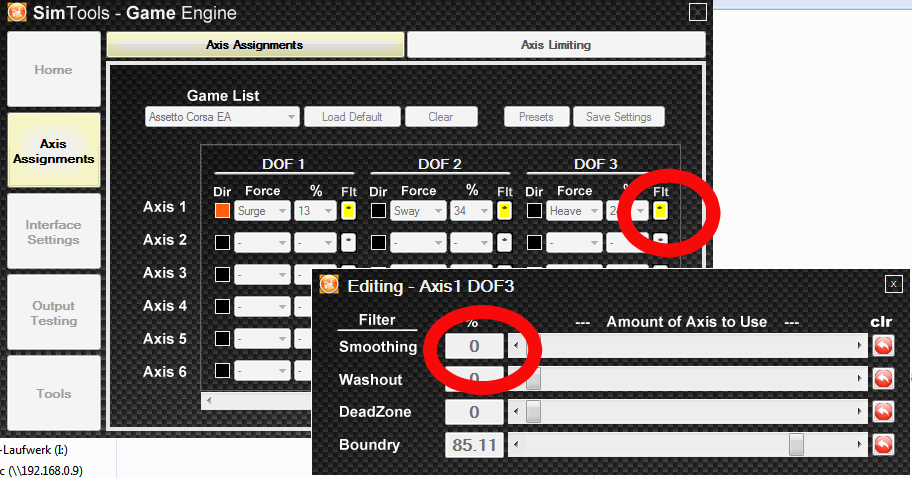

  12. Pit
    3,012
    30,438Coins
    +3,089 / 31 / -0
    @yobuddy I made a fresh install and the pitch and roll axis are now present. The second bug still exists, for better understanding I attached a video. Thanks for helping.

    To be confirmed: The smoothing slider of heave shows zero, but Simtools set the correct values in the cfg file. Due to I made a completely fresh install, all values set step by step, I think SimTools could have an issue.
  14. eaorobbie
    20,431Coins
    +1,684 / 23 / -2
    Can confirm same issue here too, Well done @Pit
    As soon as you change to a different game and go back all the settings on the filter for heave reverts back to 0
    Sorry for being a little heated on other subject, manual editing of files is not needed and strong recommended not too.
    Only tested AC like you have, have not tested any other.
    So it is a bug.

  16. yobuddy
    5,282
    49,198Coins
    +5,093 / 18 / -0
    bug is noted and will be fixed in the next release...
