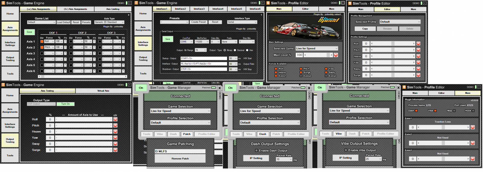

    Hello.
    What I want to ask is that my GameManager has an error!
    I have confirmed that the motors in the GameEngine are moving.
    However, the angle of the motor was 0 to 90, not -90 to 90.
    I want to solve this problem.
    And I turned on the GameManager and turned on the GameEngine and the moment I turned on the game.
    GameManager will continue to run but the motion platform will not work.
    I am really embarrassed in this situation.
    one more I would like to ask again.
    I downloaded a game plug-in other than LSF
    Even if I put it on Simtool PluginUpdater, it is not added to the game list in GameManager.
    Do you have to buy licenses?
    Thanks for reading it.
    This article is being translated into Google translation.
    Because English is strange i am sorry,
    Thank read you everyone.

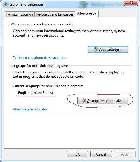

  4. yobuddy
    5,282
    49,198Coins
    +5,093 / 18 / -0
    Try this buddy,

    d
    Is changing the language to English a problem?
    21,030
    147,878Coins
    +10,879 / 54 / -2
    I agree re the Language settings @yobuddy has indicated.

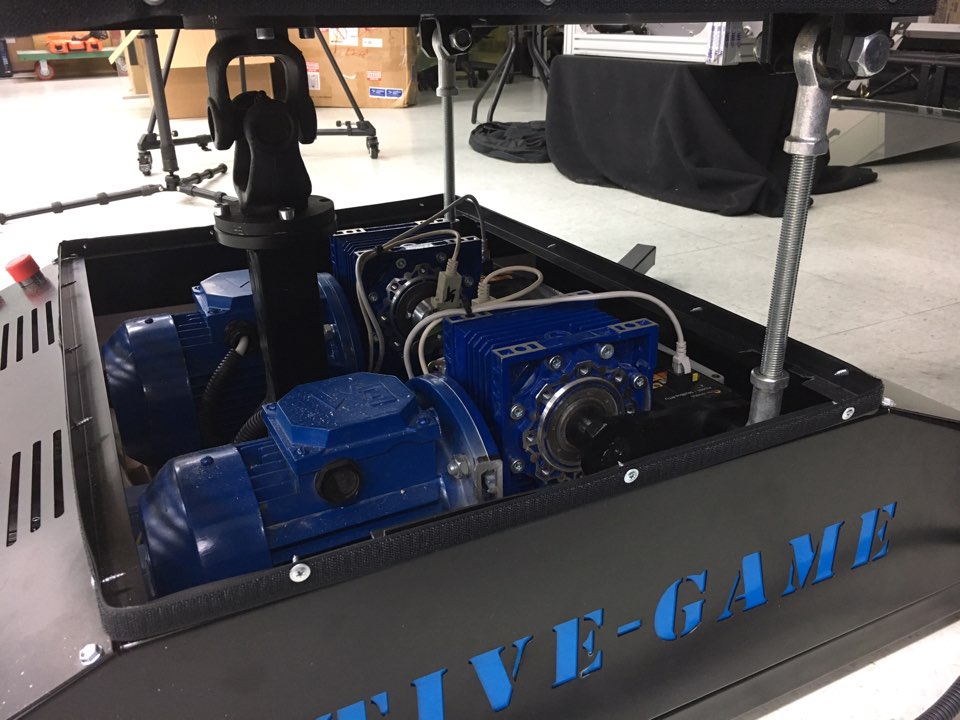

    It would also be useful to know how the actual hardware axis work, from your settings it looks to be two seperate axis. What configuration is your simulator and can you please post a picture of it.

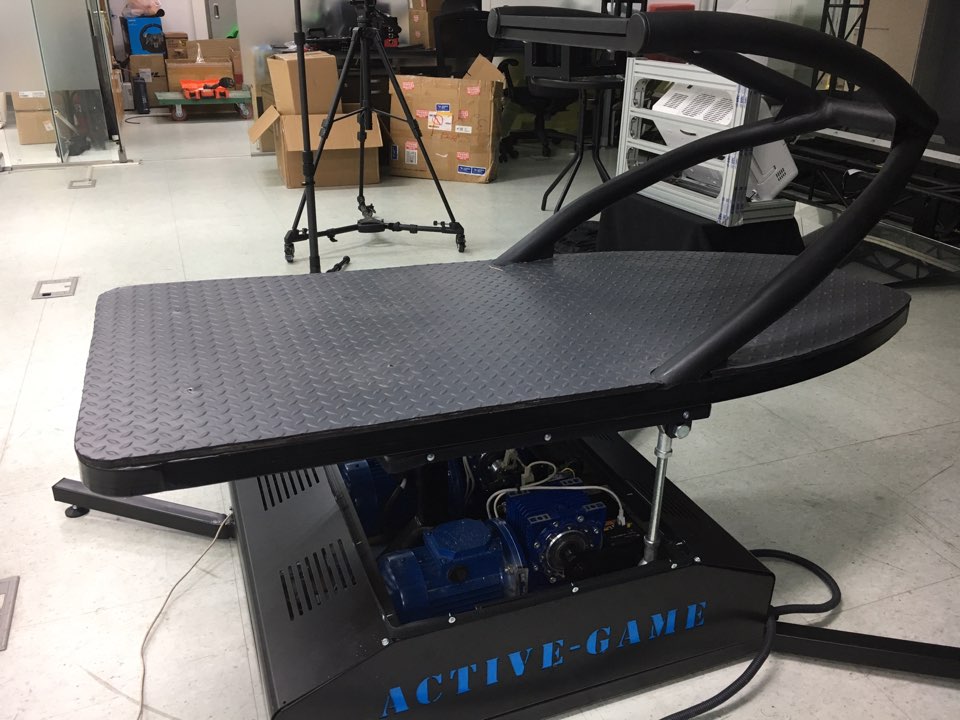

    This is my motion platform.
    I will change to English and restart my computer.
  8. yobuddy
    5,282
    49,198Coins
    +5,093 / 18 / -0
    Depending on where you are from, your local ascii table may only cover half of the needed traveled on your actuators.
    (meaning half the ascii table is missing)
    If you set the PC as I showed above, I know you getting the full ascii table as intended.
    Once I get all the apps out, I will go back and re-look this problem over.
    There is just so much to do still, and I try to do the stuff that covers the most people.
    But I won't be completely satisfied until I knock it out.

    Looks like a nice simulator @kjjcard!,

    I am proud of my motion platform! HA HA!

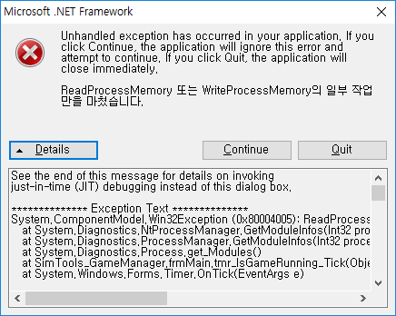

    Fixed a problem with Simtool GameEngine.
    The motor works very well at -90 to 90 degrees.
    However, the problem with Simtool GameManager has not been solved.
    If you click Continue with this error message when you start the game, the motion platform will not move.
    Click Exit to quit GameManager.
    If you click Continue, this message will disappear several times.
    Contents of the first message.

    Given the characters in the error it seems that there are still language setting issues: https://www.xsimulator.net/community/faq/simtools-language-setting-bug-change-to-english-local.233/
    Once you get the hardware working you will need to sort the Axis Allocations.
    The Dir boxes being checked orange or not determines which was an axis moves and a 2DOF can still simulate sway, surge, heave, roll and pitch. This is how SimTools normally expects each to move: https://www.xsimulator.net/community/faq/which-way-to-set-simtool-axis-movements.230/
    Once the Axis directions are properly set you can create and refne motion profiles for each game, see here for the steps involved: https://www.xsimulator.net/community/faq/steps-to-create-a-motion-profile.228/

    ReadProcessMemory & WriteProcessMemory are not functions in SimTools.
    So I wonder how its throwing these errors?
    Hmm..
    thinking...
    Are you able to update windows with the window updater?
    this error 0x80004005 is associated with a corrupt win updater is why I ask.

    Is it a new installation of win10?
  18. yobuddy
    5,282
    49,198Coins
    +5,093 / 18 / -0
    Looks like the framework is crashing..
    I just noticed this in the crash text you sent.
    xdFZySjlJvJuSyJCrKNFqiOVuiS <<<<---?????
    Assembly Version: 0.0.0.0 <<<<---?????
    Win32 Version: 0.2.1.0
    CodeBase: file:///D:/3DF_Arduino/SimTools/SimTools_GameManager.exe
    Are you able to run this buddy?
    https://www.microsoft.com/en-in/download/details.aspx?id=17851
