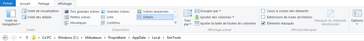

  7. TFOU57
    TFOU57 Member
    Mar 30, 2009
    164
    Thionville - France
    5,723Coins
    +16 / 1 / -0
    2DOF, AC motor, Arduino
    Noorbeast is right!
    If you do not manage to do this way is that you have not enabled the display of hidden files ...
    AppData is a hidden directory!
    Noorbeast a raison !
    Si tu n'arrives pas à voir ce chemin , c'est que tu n'as pas activé l'affichage des fichiers cachés ...
    AppData est un répertoire caché !

    Hello @TFOU57
    Finally, I did not go into the hidden files. My problem was different and it was resolved.
    However, be careful opening the hidden files well after the close because it opens the door to hackers!
  13. noorbeast
    21,030
    147,878Coins
    +10,879 / 54 / -2
    I don't really get why you think accessing hidden files opens the door to hackers. Other than script kiddies anyone capable of gaining access could do something like this from a cmd prompt to see hidden directories and files: dir C:\Users\UserName\AppData\Local\SimTools\ /a
  14. TFOU57
    TFOU57 Member
    Mar 30, 2009
    164
    Thionville - France
    5,723Coins
    +16 / 1 / -0
    Thanks @ noorbeast
    Impeccable !
    Right on target!
    That was what I was trying to do! ...
    A simple shortcut! ...
    I do not think to check the old DOS syntaxes!
    Thank you for the specified syntax for the shortcut
    I immediately made a shortcut on the PC desktop with your syntax and it works perfectly as I wanted.
    C:\Users\Propriétaire\AppData\Local\SimTools /a
