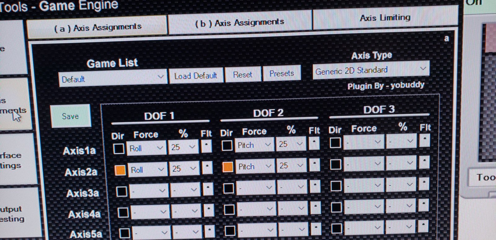

    Just checking some basics.
    Does SimTools work as expected in Output Testing?
    Try temporarily disabling your firewall and anti-virus to ensure neither of them is interfering with patching.

    Yes output testing is working fine
    Heres pics of my settings

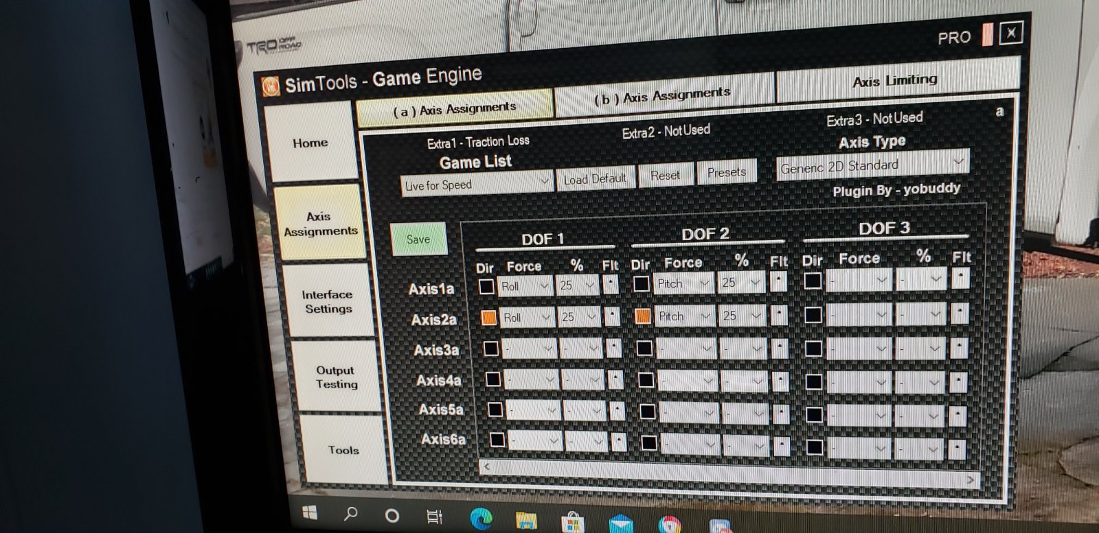

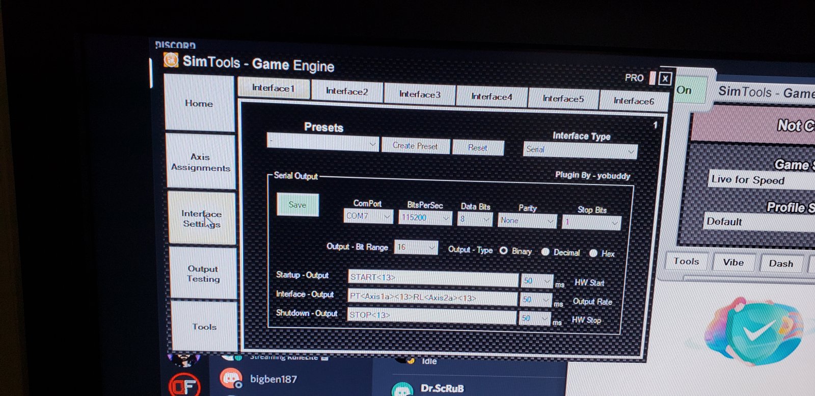

    Heres another settings pic

    If Output Testing works as expected have you created an Axis Assignment for LFS, as the one pictured is the Default profile?
    Some members hang out on the unofficial Discord here: https://discord.gg/tC5JFGP

    no i havnt yet.. anyone have any pics how it should look..?
    21,032
    147,890Coins
    +10,880 / 54 / -2
    The Default Axis Assignments can be copied as a template for specific game profiles, as a starting point, but it is important the Default profile is properly configured before doing so.

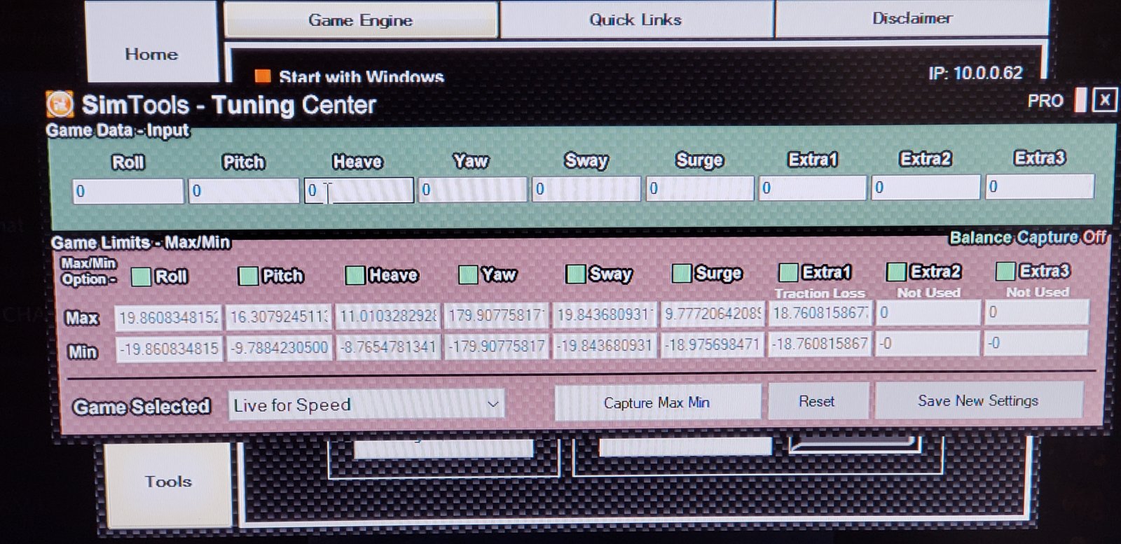

    Ive made it this far not sure how to get the info on The input
  16. noorbeast
    21,032
    147,890Coins
    +10,880 / 54 / -2
    If LFS has a proper Axis Assignment and LFS is patched correctly then game data will be displayed in the top green row of the Tuning Center when LFS is running.

    Heres what I have for axis assignments
