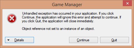

    2DOF, SCN5
    Hi! Guys,
    I am having the following error everytime GSC profile is selected on GameEngine, auto or manual...
    Details in the TXT attached.
    Tried to update plugin, same results...
    Any help is appreciated. Thanks!

    When I say profile, I mean game selection dropbox, anytime Gamestockcar is selected I get the error, it does not happen for any other game...

    Fixed, looks like the game manager profile got corrupted, I replaced it with another default profile and it all came back to work! :)
