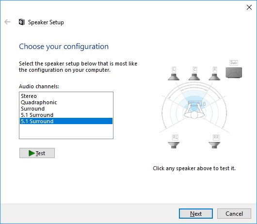

    1) Sound Card Setup
    GameVibe works by manipulating a quadraphonic speaker setup.
    There are a couple of ways to setup such an arrangement.

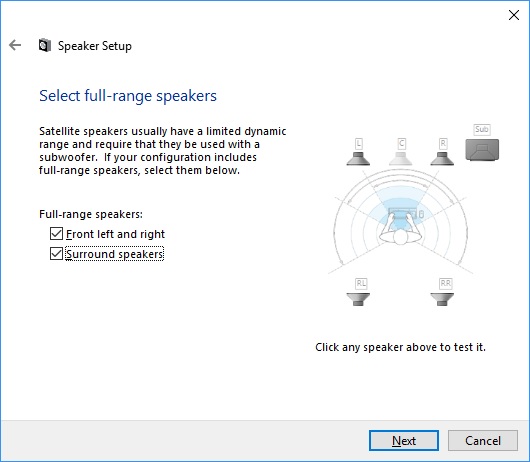

    Option a) Simply use ‘quadraphonic’ mode for output
    Here are screen shots of the settings needed to setup your sound card with quadraphonic speaker output.
    Select quadraphonic from the Audio Channels selection box.
    Make sure the checkboxes are checked ‘Full Range Speakers’.
    We do not want windows to filter the low frequencies as we are not running book shelf speakers.
    As we are driving a form of subwoofer and we don’t want the low frequencies to get clipped out of the audio stream. So please make sure there options are on.

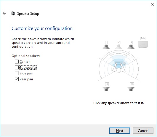

    Option b) Use 5.1 the surround mode with no base or center speaker. (Essentially configured for quadraphonic mode)

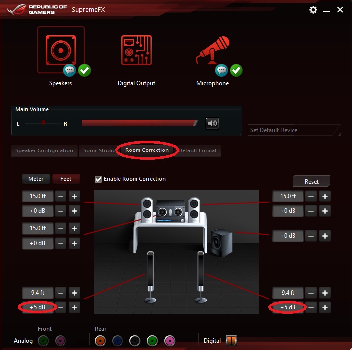

    I find that when you put your sound card in quadraphonic mode, sometimes the rear speakers are not as loud as the front speakers.
    With my sound card, I was not able to make the rear speakers any louder in Quadraphonic mode.
    So I switched to 5.1 and removed the center and subwoofer speaker from the setup.
    Accentually giving me Quadraphonic mode again but unlocking the room correction tab also.
    Re-configure the 5.1 output mode for a Quadraphonic sound system.
    And there you go.
    Back to a Quadraphonic sound system with quite possibly more options available for sound balancing.
    For my setup, I then went into the Room Correction tab and boosted my rear outputs +5db.
    This sounded pretty even when a tune was played over speakers or transducers.
    Depending on your sound card settings, you may or may not be able to even out the sound levels of the Front vs the Rear speakers or transducers. It’s better to find a resolution to this problem in the sound card settings, but GameVibe does allow you to address this problem in its settings, but be aware thou that you will loose some output volume when notes are played in some locations. (More on this later)
    Using the Volume Balancer on the Sound Card Settings page is a great way to test you transducers for equal output volumes. It will cycles thru different sounds all in all output locations.

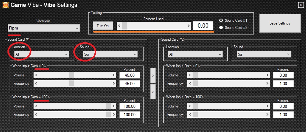

    3) GameVibe – Vibe Creator
    Now on to some fun stuff!
    Here you can design exactly how a sound plays and where it’s played from when it is used by GameVibe.
    Let’s take a look at the RPM Vibe settings.
    Here you can see that it is set to play from ALL speakers of Sound card 1.
    And it will use a Square wav to create its noise.
    To adjust how it sounds when it is played:
    - Click the ‘Turn On’ button in the testing group box.
    - Verify that the Percent Used slider is at 0%.
    - Adjust the ‘Data = 0’ input sliders to how the sound should play when input is as low as possible.
    - Slide the Percent Used slider to 100%.
    - Now adjust the ‘Data = 100%’ input sliders to how it should play when input is as high as possible.
    - Slide the Percent Used slider back and forth to see how it sounds.
    Click Save, RPM Vibration effect finished!

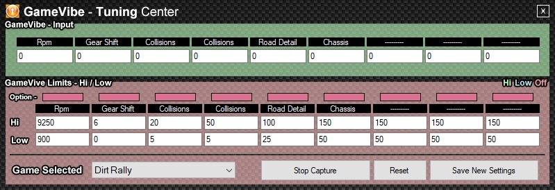

    4) GameVibe – Tuning Center
    The tuning center for GameVibe works much like it does in GameEngine, with a couple of exceptions.
    We now are capturing Hi / Low values, instead of Max / Min.
    The Hi / Low values tells GameVibe when and how to play our Vibration effect.
    Any incoming value that is below the Low value is equal to 0%.
    And anything equal to or above the Hi value translates to 100%.
    So you won’t here anything form GameVibe when the incoming value is below the Low value, and it will be maxed when the incoming values equals or exceeds the Hi value.
    Let’s Look at RPM for Live for Speed below.
    We have a 900 for Low and a 9250 for Hi.
    This means that the note will start to will play when the input reaches 900.
    And it will be maxed when the incoming values equals or exceeds the Hi value of 9250.
    All cars in the game will top out at a bit different frequency and volume.
    This provides nice settings for the whole game with a bit of a Vibe difference between vehicles.
    Btw, if I was capturing Turbo, I would set the Low to 1, so the sound would turn off when it’s not active.
    These numbers can be captured and/or edited live while that game is running, and it even has some options for capturing. You have the options to capture the Hi values, the Low values or No values at all.

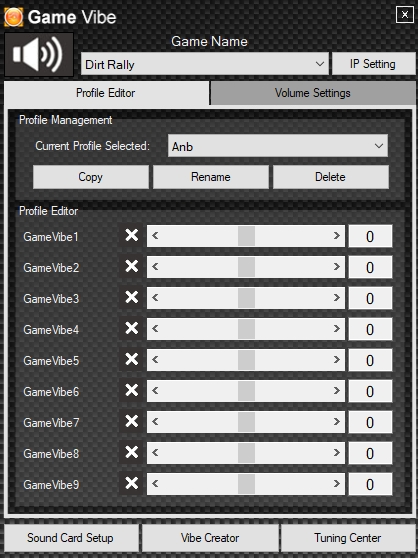

    5a) GameVibe – Profiler Editor
    On the GameVibe Profiler Editor page, we can create and edit profiles for different vehicles in the game. Sliding the levers adjusts the Hi / Low by a percentage of up to -50% to 50%. With these sliders, you can either make the Vibe less or more sensitive to the incoming telemetry data.

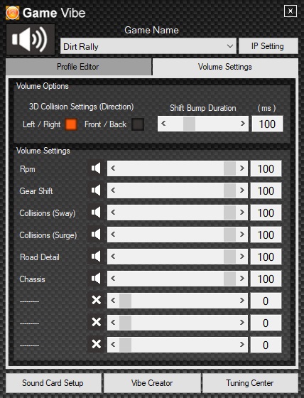

    5b) GameVibe – Volume Settings
    On the GameVibe Volume Settings page, we can adjust the output volumes of each of the effects that we can use. You may be tempted to want to run them all at 100%. But finding a good balance provides for the overall best experience.
    Remember that just like an axis of a simulator that can only stretch to 100% of its available length, your sound cards output volume can also only produce 100% output volume.
    This means that when we use a bunch of effect together on the same transducer, we need to level them off so there is room for all effects to play evenly. This can also be done live while the game is being played.
    This section also provides us with the ability to flip the Collision sound directions, should they play in the opposite direction that want we expect when played in 3D. We can also adjust the length of the ‘Shift Bump’ note that is played, depending on the type of vehicle we are controlling in the game.

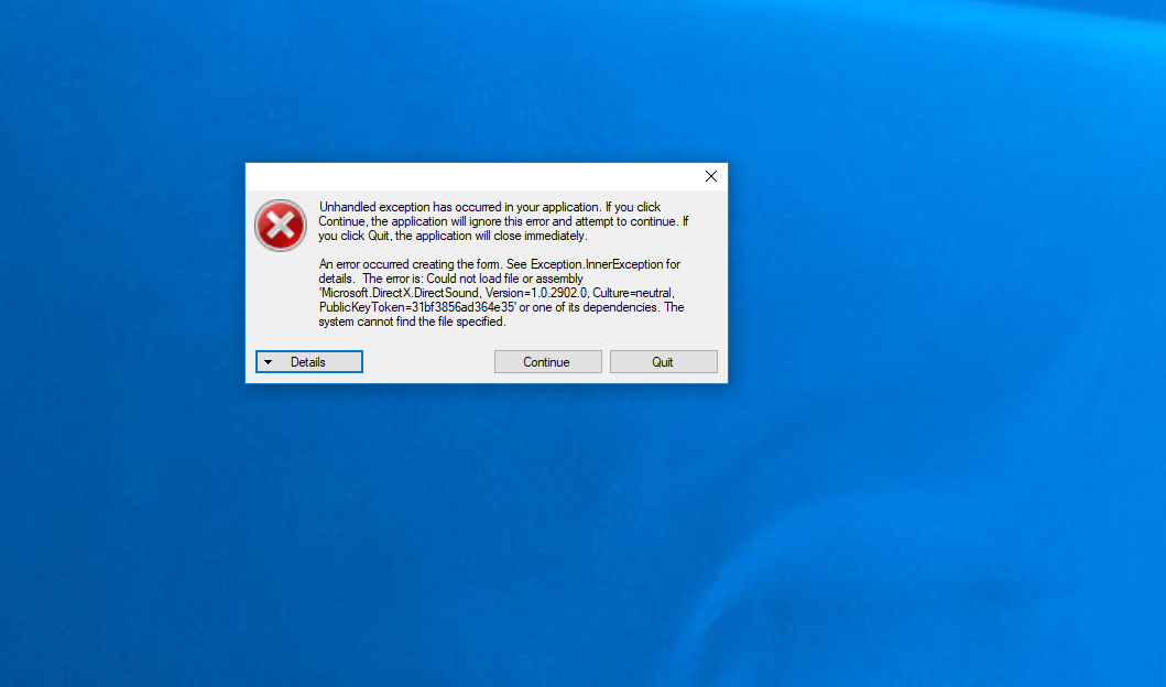

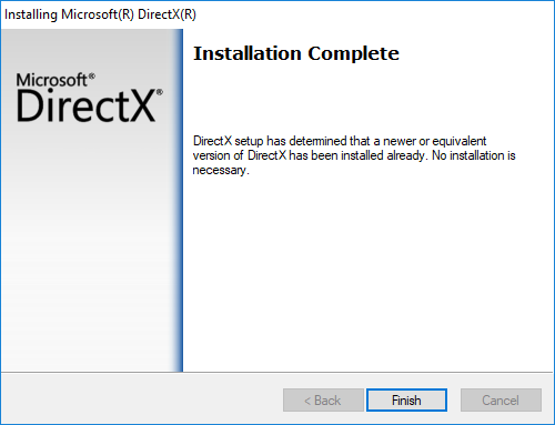

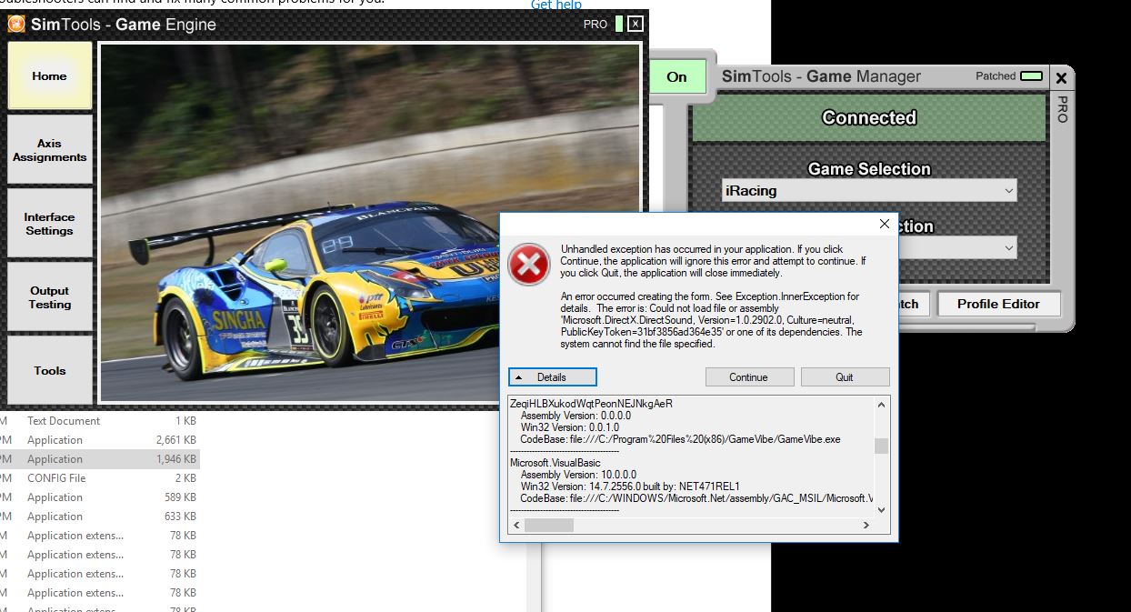

    fyi, GameVibe also silently install SlimDX so it can use its sound processing engine on newer PC.
    So if you see it installed, that is where it came from and is required to make GameVibe function in most cases
    Also, I believe DirectX is also required to be installed (which really should not be a problem in most cases)

    First let’s put the game in ‘window mode’ so we can also use the Tuning Center easily.
    Before we launch the game…
    1) Let’s Press the Capture Max Min button.
    2) Set the RPM column to capture the Low values of the incoming Vibe data.
    3) Change the Current low values of Rpm to zero. (Highlight the current Low value with your mouse and press ‘0’ on the keyboard.)
    4) Now let’s launch the game and as soon as you’re on the track, pause the game. (press ‘P’ on the keyboard for LFS)
    We should see that the Low value for RPM has been adjusted.
    Subtract 200 from the value and click “Save New Settings” to save the new Low value for Rpm.
    5) Now switch to capturing Rpm Hi values.
    Preceded to Un-pause the game (‘P’ on the keyboard) and rev the car up as hi as it will go.
    Now Pause the game again and look at the new Hi value for Rpm.
    (I suggest bumping it up a bit if in a slow car and visa-versa for a fast one)
    And click “Save New Settings” to save the new Hi value for Rpm.
    6) Press ‘Stop Capture’ as we are finished with the Hi/Low limits for Rpm.

    Road Detail
    Road Detail can be used in two different ways.
    I prefer to use it for road surface feedback, but you can also tune it in for bumps. (For bumps tune it like you would for chassis)
    For this one I 'live capture' me driving the car at about 50% as hard as I normally would.
    Pause and take a peek at the low values, it should be a number that the car does not have a hard time hitting.
    And for Hi values I would say just go hit a jump or some bumps etc..
    Now take the Hi value and multiply it by 5 and click “Save New Settings”.
    The idea here is we are looking at making road surface noises and not a huge bang from a bump or a jump.
    (Using the live profile slider for Road Detail can really help tune it in nicely once you have some your Hi/Low values setup)
    Collision
    For this Vibe, set the capture for the Low value and then drive the car on the track at about 80% strength swerving back and forth, gassing and breaking etc.
    Don’t need to do it for long.
    Pause the game and multiply the Low value by 3. Then take your new low value and multiply that by 10 for the Hi value. (It’s a good place to start)
    Tip: Raise the Low value if you don’t get collision thumps when you should have.
    Tip: Lower the Low value if you are getting collision thumps when you should not be.
    Tip: Increase the Hi value if all collision thumps sound maxed out with every collision.
    Chassis
    For this Vibe, set the capture for the Low value and then drive the car on the track at about 80% strength trying not to hit anything.
    Be sure to swerve and gas and break a few times.
    Now pause the game and save the setting for the low value.
    Set capture to the Hi value and find a nice curb or two to run over.
    Maybe cross a field or drive in the grass a bit.
    (You’re tying to find the limits of what a normal bump would be when racing.)
    Pause the game and click “Save New Settings”.
    Tip: Concentrate on what one corner is doing for setup on a 3d setup.
    (If you get one corner working correctly, and they all will.)
    Tip: If you’re getting a lot of bumps from normal driving, Increase the Low value.
    Tip: If all your bump sound maxed out, increase the Hi value.

    When I try to run Game Vibe I get an error:
    I checked the DirectX version installed (DX12) so I am not sure what to do, for information my system is:
    Windows 10 64
    GTX1080ti
    Intel i7-5820
    On board sounds card - MSI X99S
    Sound card for vibe (just installed) - Sound Blaster Z
    Simtools - V2.2
    If I try to continue, after I select anything the program locks up. No doubt I have done something wrong but please let me know how to get GameVibe working as I am keen to try it out.
    Many thanks,
    David
  17. gary furnival
    gary furnival New Member
    Nov 13, 2017
    united kingdom
    - 85Coins
    Game vibe working my 5 buttkicker lfe all fine in tests i guess with the plugin profiles are updated this could be better than simvibe which i own. Good work hope Elite Dangerous and DCS support gamevibe soon as Simvibe never will.
  18. bowling
    bowling New Member
    Dec 12, 2017
    Thailand
    - 5Coins
    run gamevibe get error too same Bacon2002.
  19. yobuddy
    5,282
    49,205Coins
    +5,093 / 18 / -0
    • Informative Informative x 3

    It was never going to be that easy (at least not for me anyway):
    Any idea how to fix it.
    Thanks,
    David
