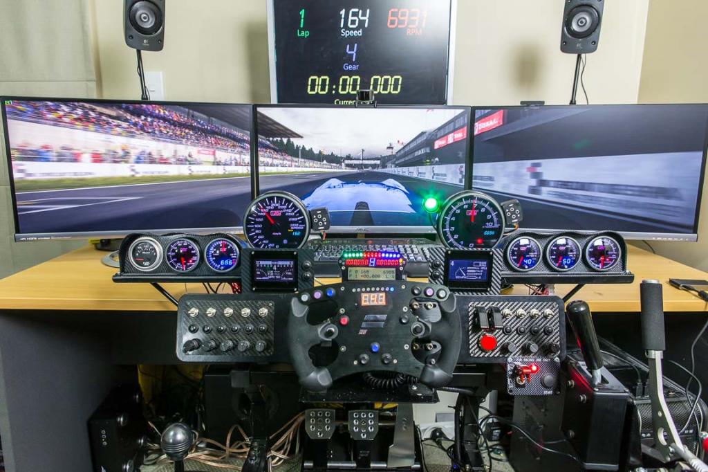

    @bsft I use a Sim Instruments dash and it is not compatible with Sim Tools
    @value1 I would really love it if someone could convert the Simtools plugin to use Extradata=3.
    Everyother program that I know uses Extradata=3 so I can use a UDP proxy to get everything going. But Simtools uses Extradata=0 and the UDP packet isn't compatible with any my other programs.
    All these programs use Extradata=3. EK Sim SLI max, Dashmeter pro, Z1 Dashboard, FanaLEDs, Symproject SimDash, Sim Instruments, Sim Commander and many more. and Simtools is the only one that uses Extradata=0
    At the moment I have the choice of running just my seat mover using SimTools OR running FanaLEDs for my wheel lights and Sim Instruments dash, Symprojects Sim Dash for my gauges and Sim Screens and Sim Commander for my Sim Vibe, GS-4 and fourth screen.
    So I am not using my seat mover with codemasters games because I need to turn off all my other gadgets.
    Here is a photo of all my other gear running in F1 2013. All the codemasters plugins would need to be converted so it would be a pretty big task.
    and in Grid Autosport
