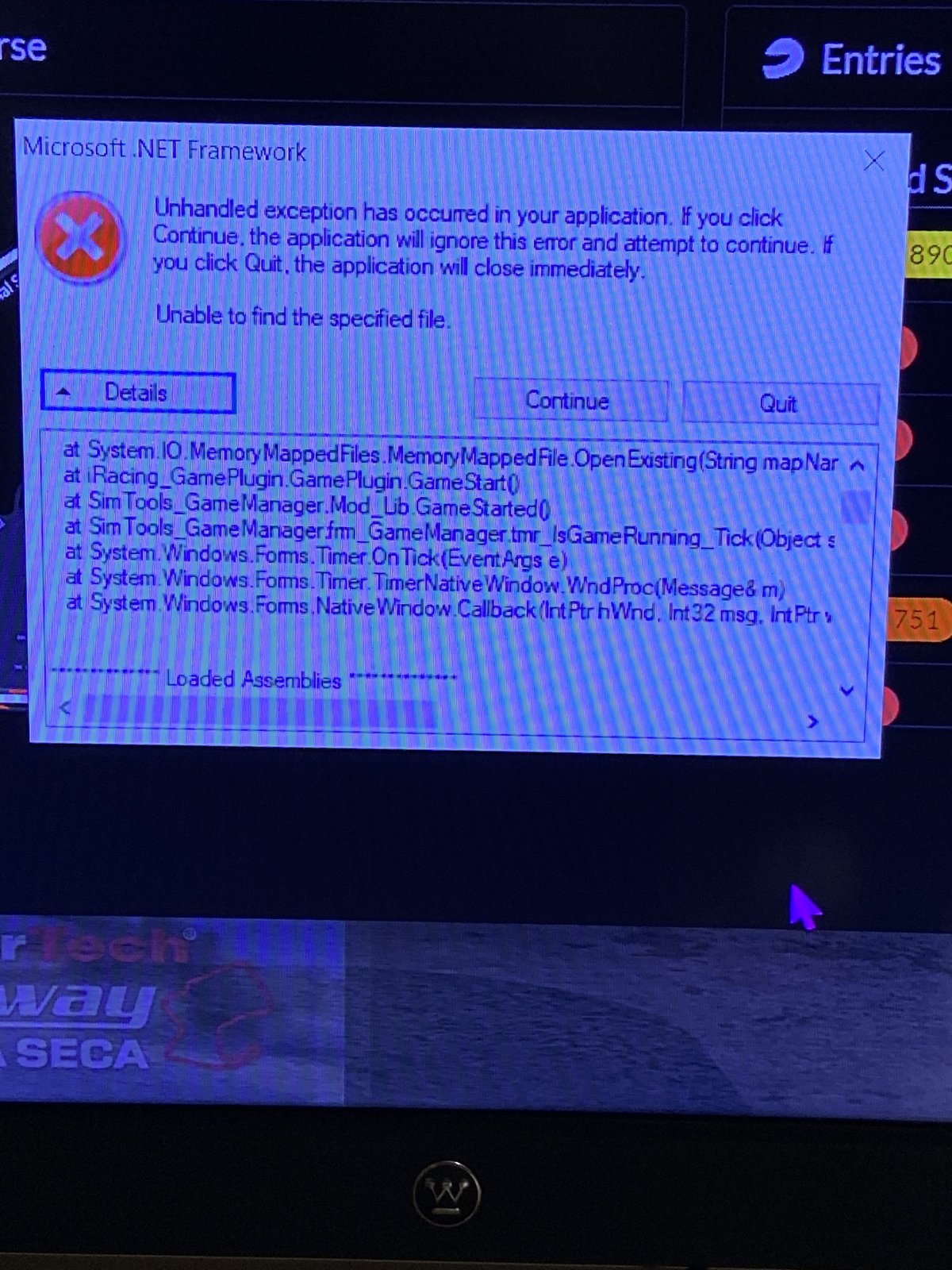

    I got my dof so I applied for the 250 coins for the downloads that you gave me, got in downloaded the iracing plugin dragged it in the game engine preset installer. It say it won't install it cause it is not a sim tool plugin? Any I getting it from the wrong place? Thanks

    I have been having trouble the last week or so, having to reset the game manger, I keep getting and exception error from game manger. in order to get everything working I have to shut both off again and restart them some time it starts and some times it does not. I have reinstalled the game manger and game engine but still still get the error. I say something about the plugin. Could the iracing plugin not be uptodate with iracing or what? thanks for your help Oh I just have reinstalled the exc file, I did not remove the program from my computer. maybe I should do that?

    Can you please post a picture the shows the full error message.

    System.IO.FileNotFoundException: Unable to find the specified file.
    at System.IO.__Error.WinIOError(Int32 errorCode, String maybeFullPath)
    at System.IO.MemoryMappedFiles.MemoryMappedFile.OpenCore(String mapName, HandleInheritability inheritability, Int32 desiredAccessRights, Boolean createOrOpen)
    at System.IO.MemoryMappedFiles.MemoryMappedFile.OpenExisting(String mapName, MemoryMappedFileRights desiredAccessRights, HandleInheritability inheritability)
    at iRacing_GamePlugin.GamePlugin.GameStart()
    at SimTools_GameManager.Mod_Lib.GameStarted()
    at SimTools_GameManager.frm_GameManager.tmr_IsGameRunning_Tick(Object sender, EventArgs e)
    at System.Windows.Forms.Timer.OnTick(EventArgs e)
    at System.Windows.Forms.Timer.TimerNativeWindow.WndProc(Message& m)

    i GUESS I don't know what that is?
  19. noorbeast
    21,032
    147,890Coins
    +10,880 / 54 / -2
    Try the suggested .NET reinstall, @yobuddy can check out the error message and make any other suggestions.
  20. yobuddy
    5,282
    49,201Coins
    +5,093 / 18 / -0
    What game plugin is it buddy?
    Its complaining about not being able to find a memory mapped filed.
