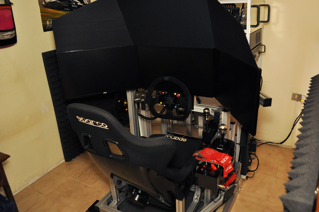

  6. dedraro
    dedraro Active Member
    May 1, 2015
    104
    105Coins
    +65 / 0 / -0
    This is my current cockpit, I'm will show you in detail the topic of the assembly 4dof,
    my idea is to create something similar to that by Willaupuis,
    but with aluminum profiles 8020 as the rest of the structure, and with the right and left motors so as to reduce the height of the "box". I made a little montage, red lines are the link between the motors and the seat structure.
    plus a base with one motor for the TL. What do you think?
    I tried to look for BTS7960B 68A, both on ebay and on aliexpress but I could not find them anywhere, can you advise me where to buy them?
