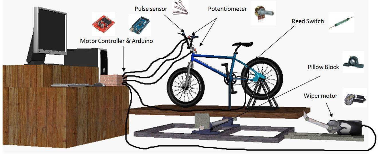

    Hi! I'm using Simtools and developing my own simulator and got confused with the 2DOF arduino code of @RacingMat. My simulator is only 1 DOF (pitch) and uses 1 motor.
    I am confused with some conditions in the code like the condition of direction. Also the function NormalizedData().
    Please help. Thanks! :)
    Ralph M.

    i think you can use 'pitch' for motor movement
    the function convert numeric characters in hexadecimal value; es. the two characters 2F (2= 0x32 or 50 dec and F= 0x46 or 70 dec) are converted in hex value 2f (47 in dec)

    This part is where I'm confused with.
    Code:
    int NormalizeData(byte x[3])
      int result;
      if ((x[2]==13) || (x[2]=='R') || (x[2]=='L'))  //only a LSB and Carrier Return or 'L' or 'R' in case of value below 16 (ie one CHAR and not 2)
        x[2]=x[1];  //move MSB to LSB
        x[1]='0';     //clear MSB
      for (int i=1; i<3; i++)
        if (x[i]>47 && x[i]<58 ){//for xA to xF
          x[i]=x[i]-48;
        if (  x[i]>64 && x[i]<71 ){//for x0 to x9
          x[i]=x[i]-55;
      // map the range from Xsim (0 <-> 255) to the mechanically authorized range (potMini <-> potMaxi)
      result=map((x[1]*16+x[2]),0,255,potMini,potMaxi);
      return result;

    hello!
    Like @soraz explained,
    - you will only use 1 motor
    - in Simtools, it will be linked to Pitch effect (go to FAQ to see the pitch roll and other definitions)
    - with the motomonster, you will only use 1 output
    - with Arduino, no need to modify the code!
    - yes, it is used to convert hex from Simtools into decimal for arduino.
    After reading and re-reading the manuals and quick step by step guide, you'll master this building!
    yours
    Mat

    Oh! I thought I will have to modify the arduino code. I will not modify the code. I will just upload it to the
    arduino and that's it.
    Later on, I will also do my 2DOF simulator. But for now, my developed game supports pitch only.
    Thanks my friend! :)
