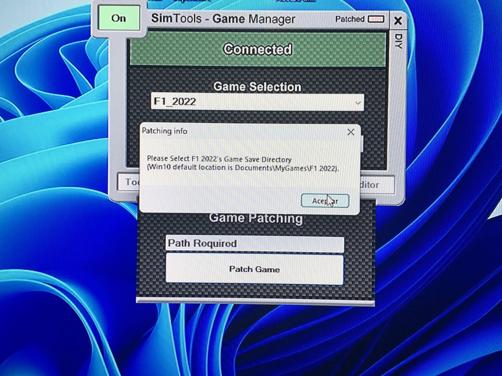

    Hello very good to all I would like to know if someone could help me with this problem please.

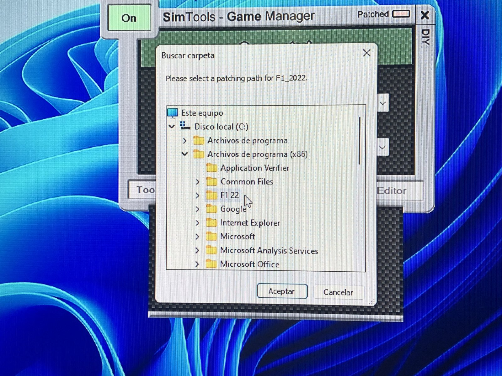

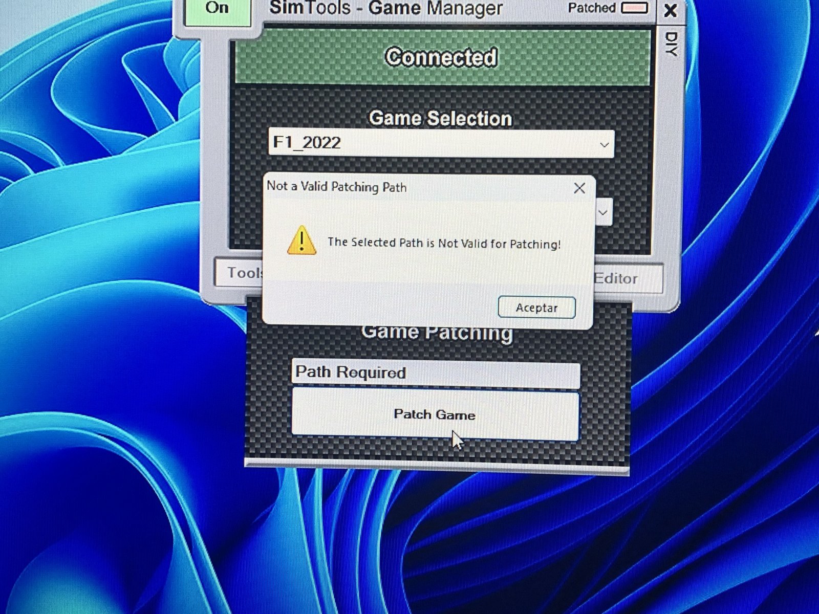

    I'm trying to install several plugins for different games but I always get the same error and I don't understand what I'm doing wrong.
    Thanks and i hope you can help me.

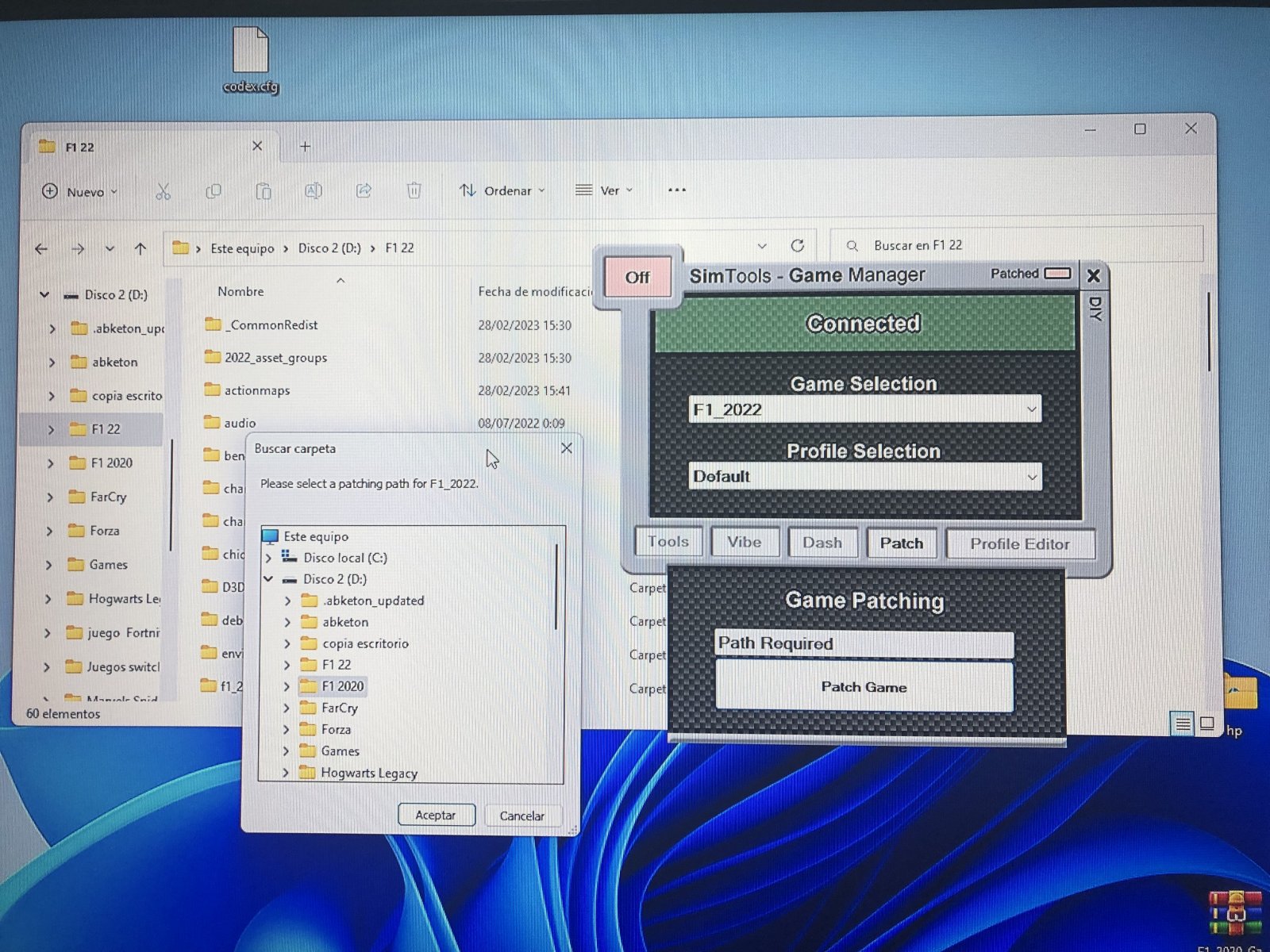

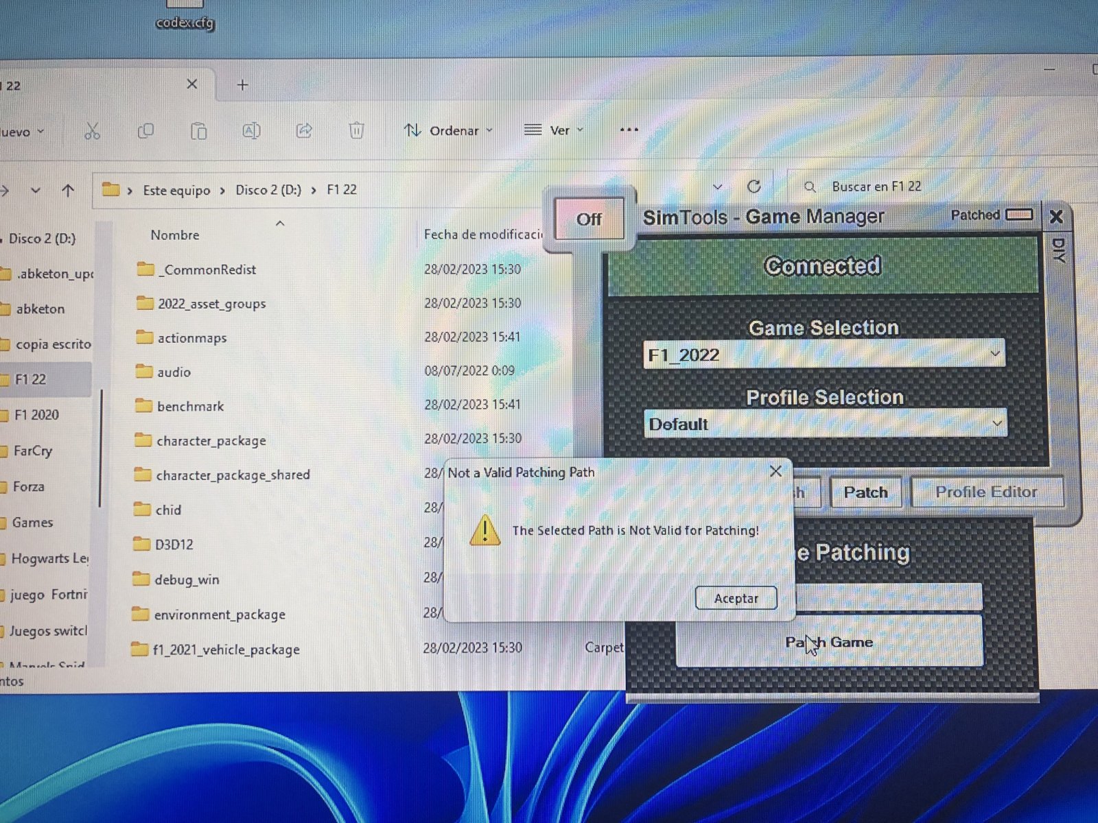

    Yes, I know but
    I have it installed on another drive and search for it manually and get the same error with f1-20 and f1-22.
    I have not been able to test other games to see if the same thing happens

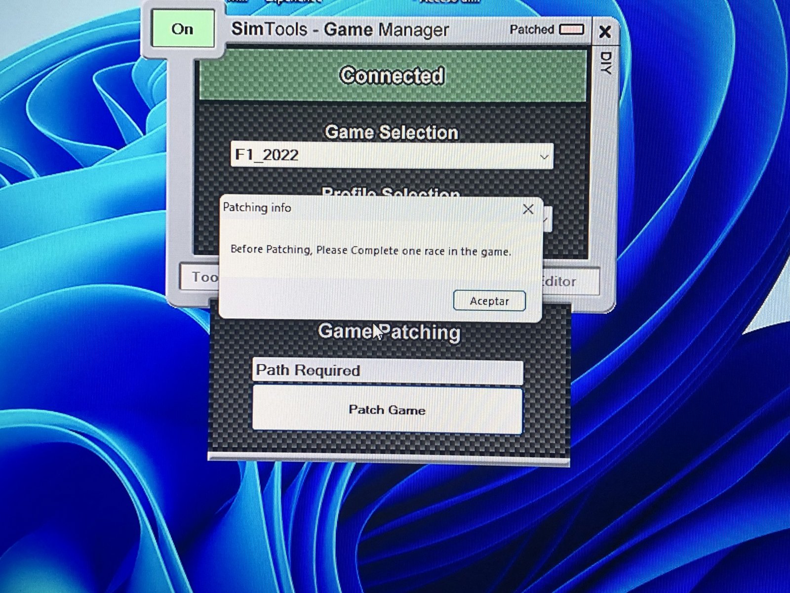

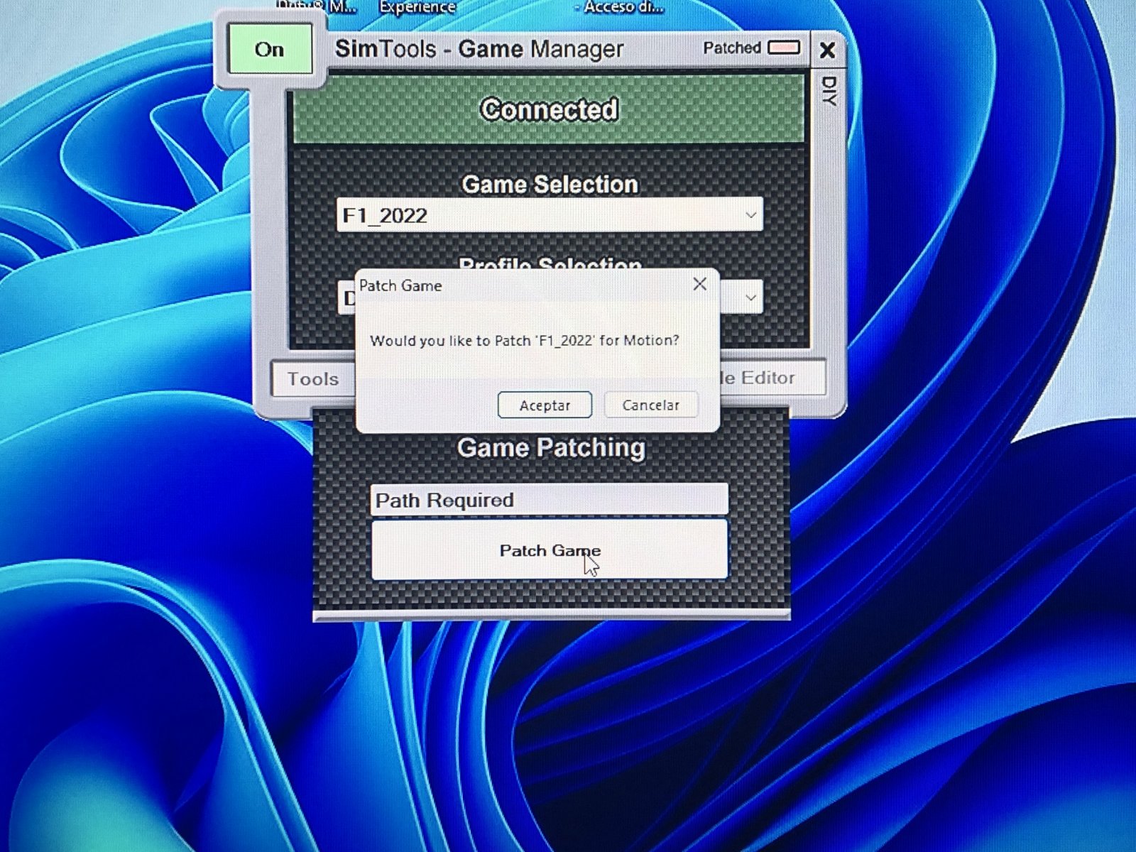

    I have uninstalled the F1-22 and I have uninstalled it again and same error.
    I send screenshots of the entire process and how I search for the folder manually and at the end the error appears.
    I am not able to find the key as a last resort I am about to uninstall simtools and reinstall.
    My system is Windows 11.

    Hi @Yuki76 ,
    If your on a 64 bit machine, you should be trying to patch the game in "Documents\My Games\F122" for example.

    Solved Thank you very much
