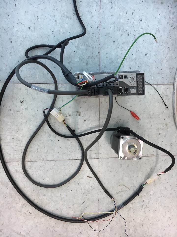

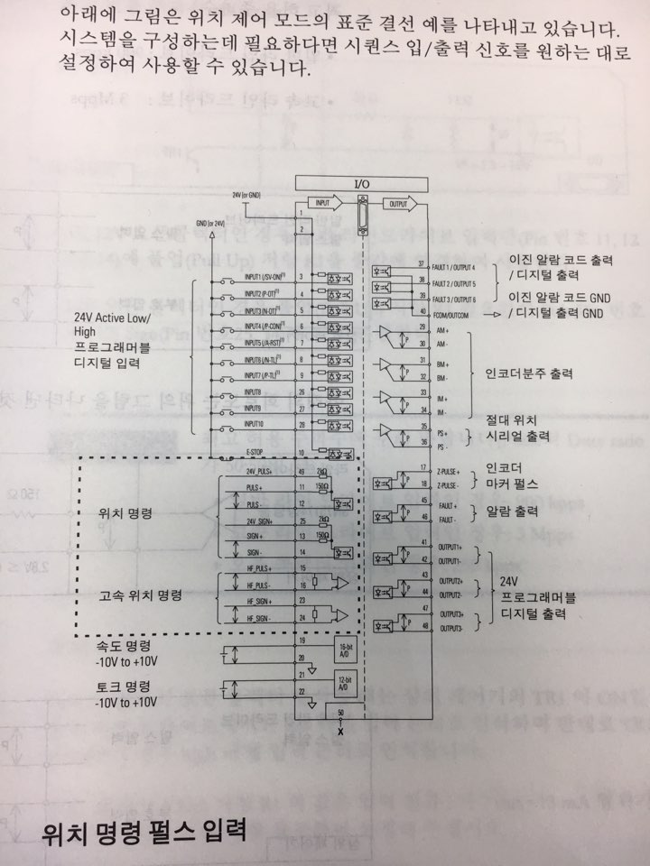

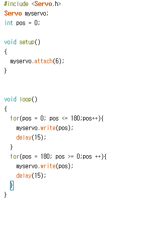

    I want to connect Arduino to the motor drive now.
    What 's on the picture.
    Blue / white is 11 numbers12, which adjusts the plus value.
    11 where pwm controls.
    I connected number 12 to gnd.
    Is there a problem with my behavior?
    It does not work.

  3. Mmcool
    Mmcool Member
    Jun 26, 2015
    67
    USA
    1,174Coins
    +19 / 7 / -0
    It needs to sink the pwm signal via 24v. You will need a uln2803 driver perhaps for this to work as the pwm output from arduino is 5v...
    Is that a stepper motor?

    No.
    My motor is a servo motor.
    motor model : csmt-04br1ant3
    motor drive model : scd5 single axis
