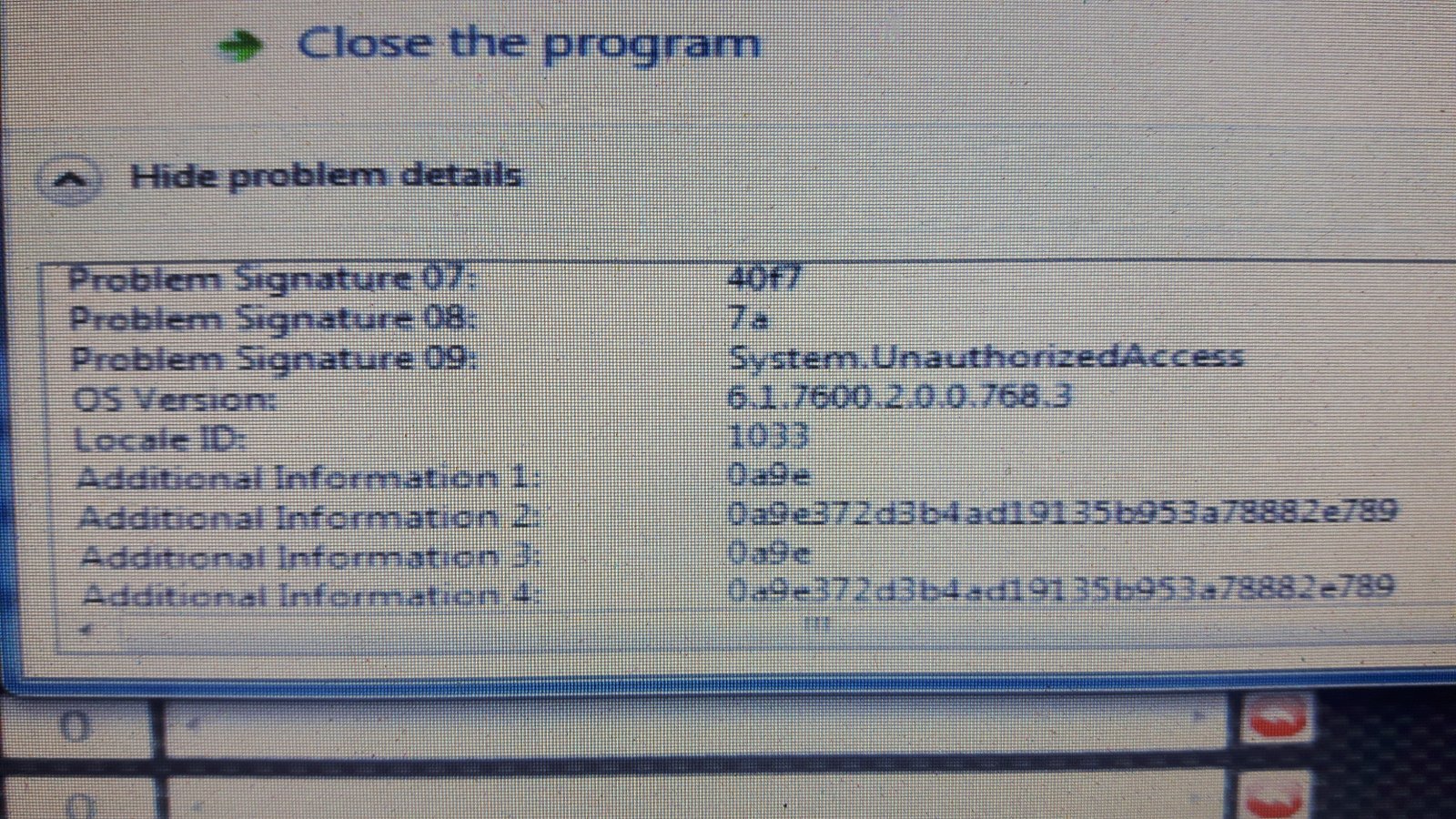

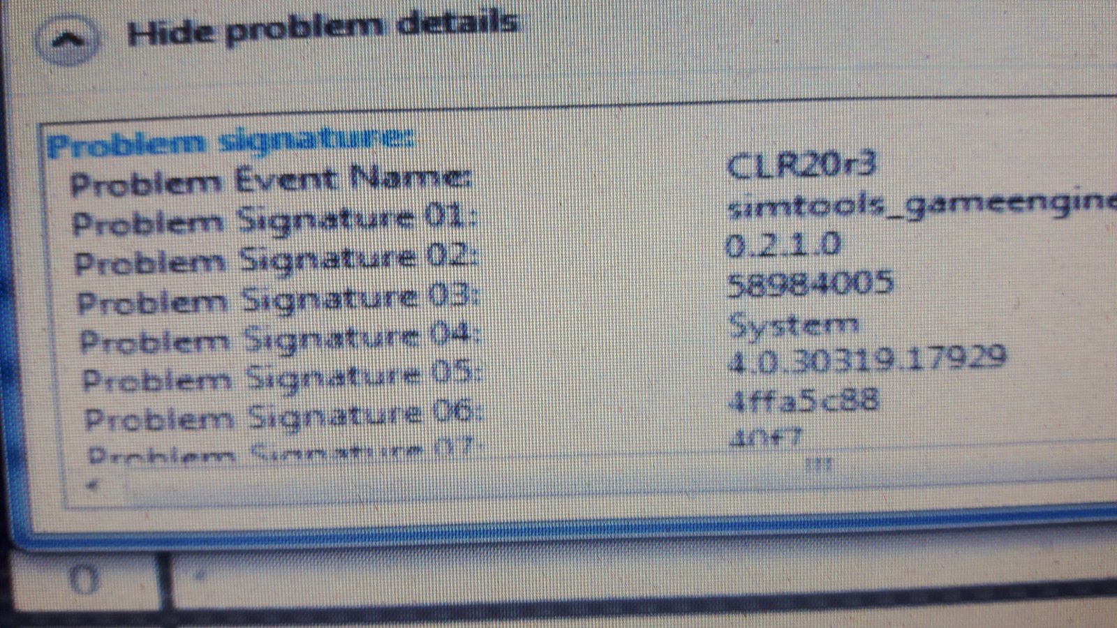

    Hello I am lost ,I have read every other post with the same issue I have but with no success. I am using 2.1 Simtools on a second pc. No problems with receiving game data , the output testing works fine I get motion on all 3 actuators. But soon as I run NLC or Project cars I get motion for 5-10 seconds then 2 short beeps on the Motion PC and I have to reboot the Motion pc to get my Comport back. I have built a whole new motion PC win7 and it still crashes the same as the old PC . Attached pictures is the error code I get when it Crashes.
    Changes I have tried are. net framework 4.5 uninstall and reinstall. Short USB cable with Ferrite Chokes. complete removal of Simtools and reinstall.
    I use Thanos AMC1280 card . I also use Ians BFF software for Prepar3d v4 with NO issues what so ever on the same comport.
    Any Ideas what I have wrong. it is definitely something with the comport but what is confusing is BFF software will run all day with no problems. 20180122_125247.jpg 20180122_125356.jpg

    This sounds like the issue I had years ago on Dirt... Definitely game software issue. You see on the logs, what crashes is the game engine with violation access to a memory part, perhaps of the game motion output.

    I Run OUPUT TESTING . I can move the sliders back and forth gently not to fast I can do that all day with movement on the Actuators with no Crashing on simtools.. But soon as I go fast like a quick jerky motion that's it Simtools stops and crashes. That is what happens in a game ex; NLC start gate and rolling up the hill just fine ,as soon as it starts going down hill fast- crash.
